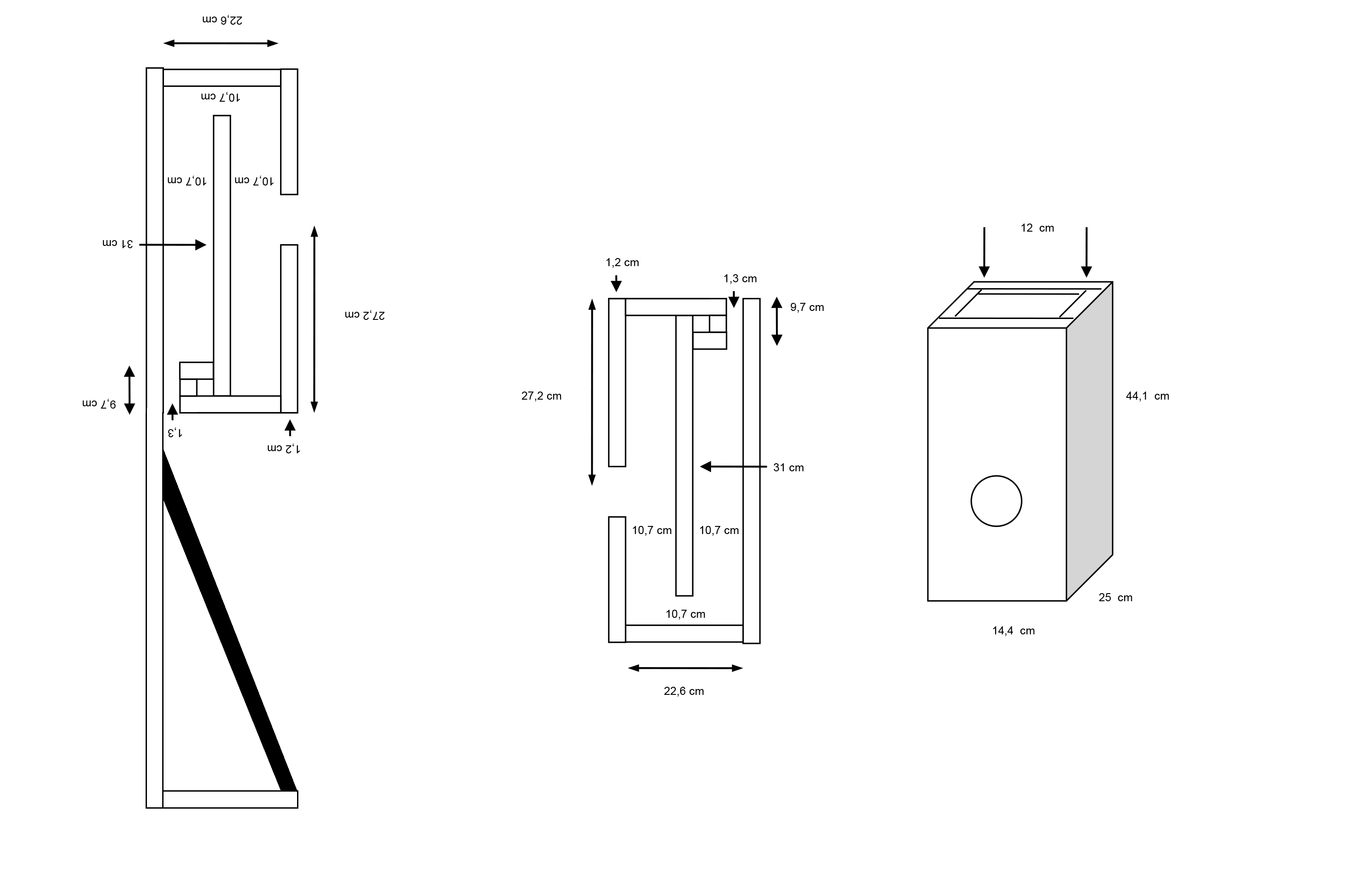

Hi , it would be a bad idea later add a ' mouth' in Tabaq ?
Change the tune ?
Changes the frequency ?
any help
best regards
