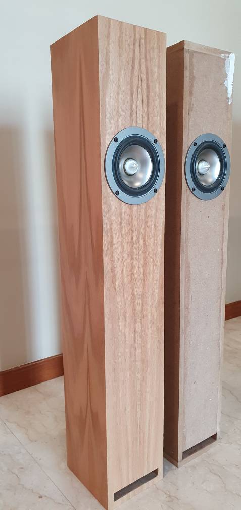

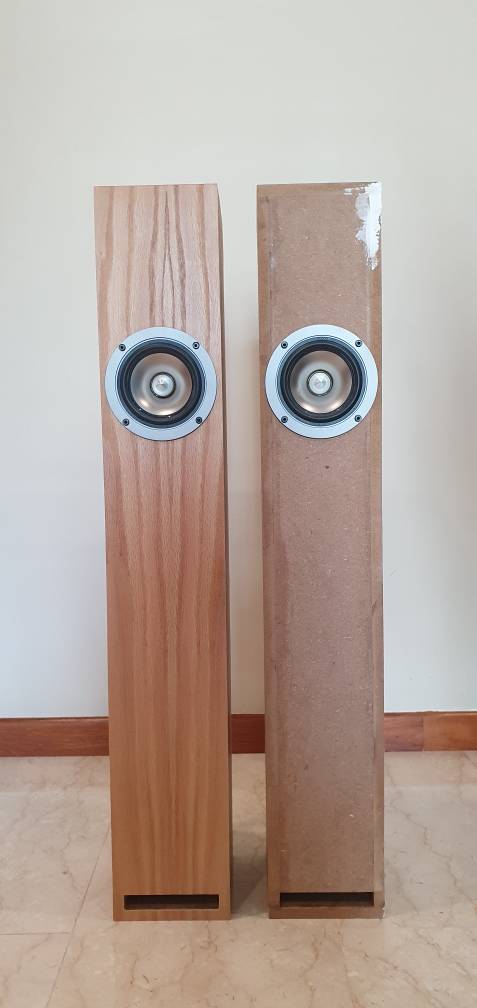

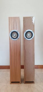

Finally finished veneering one of the speakers. Had a good learning experience. Thanks Bjorn for sharing your design with the community! I might leave the other side as-is so that i can call them Beauty and the Beast. ;-) 20200809_144631.jpg 20200809_144725.jpg
