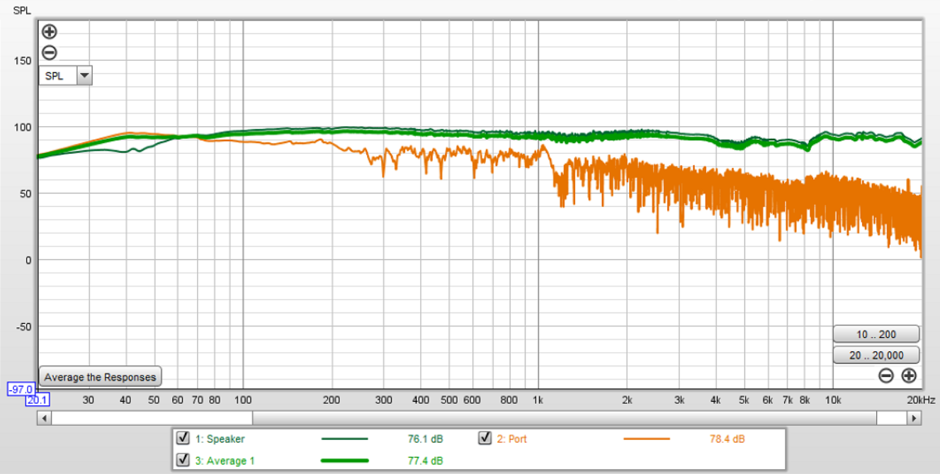

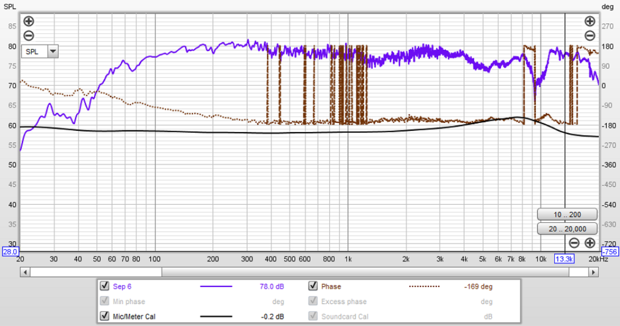

Hi guys, I just received my mic, so today I tried to perform a measurement for the first time.
I attached the measurement of my TABAQ Large with the W5-2143 (mic at 10 cm from the speaker), without and with BSC (1mh + 8ohm).
Can somebody help me understand what are those phase spikes? If you have any suggestion regarding the measurement please let me know

First of all, 10 cm is not a good distance. If you want a near field data, use like 1 cm, then also measure the port at 1 cm, then sum them together. Don’t believe the near field curve above 200 - 300 Hz. If you want the far field data, standard distance is 1 meter. Don’t believe that one below 200 -300 Hz.
The phase curve you have got is very close to -180 degrees angle. Every time it hits the -180, it jumps to + 180. That looks like spikes, which are not real. Once you move the mic to 1 meter, it may go away. However, it may not. A lot of mics invert phase, and looks like yours does too. Try to invert the polarity at the speaker connection to the amp, and see if that brings the phase angle close to zero.
Good luck!
Vadim B.

Thanks a lot for the info Vadim.
I performed the measurement as you said. Combined driver+port SPL is attached, the phase was behaving the same.

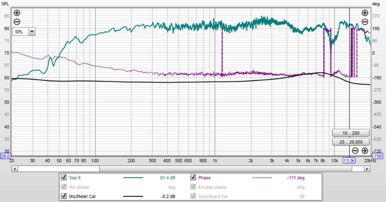

I inverted the polarity and measured at the speaker again and all those phase changes are gone (as per second screenshot). Does this means that I should connect this speaker with inverted polarity? I noticed that in this case I have a drop of ~2db at 45hz.

Hi, Cyruz. No, this only means that your microphone is inverting phase, which is quite common. You can re-wire the mic cable to invert the phase, but that could be complicated. Just remember to invert the phase of the speaker, while doing measurements, and you will be fine. Much easier that way.
As far as listening, that's a huge can of worms, I don't wish to touch at this time. Let's just say that my PERSONAL preference is to listen to my speakers in positive phase. Some people could disagree. Some amps invert the phase too. Some records are in inverted phase...
Vadim
