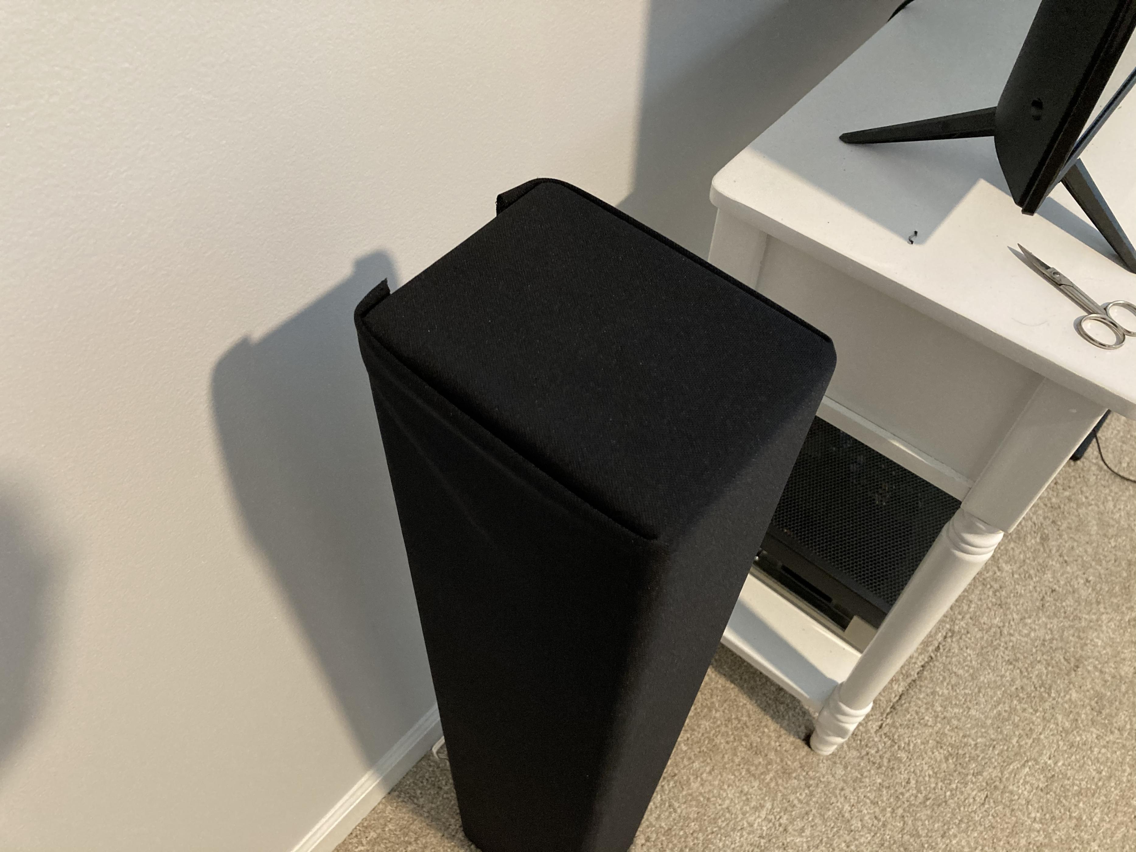

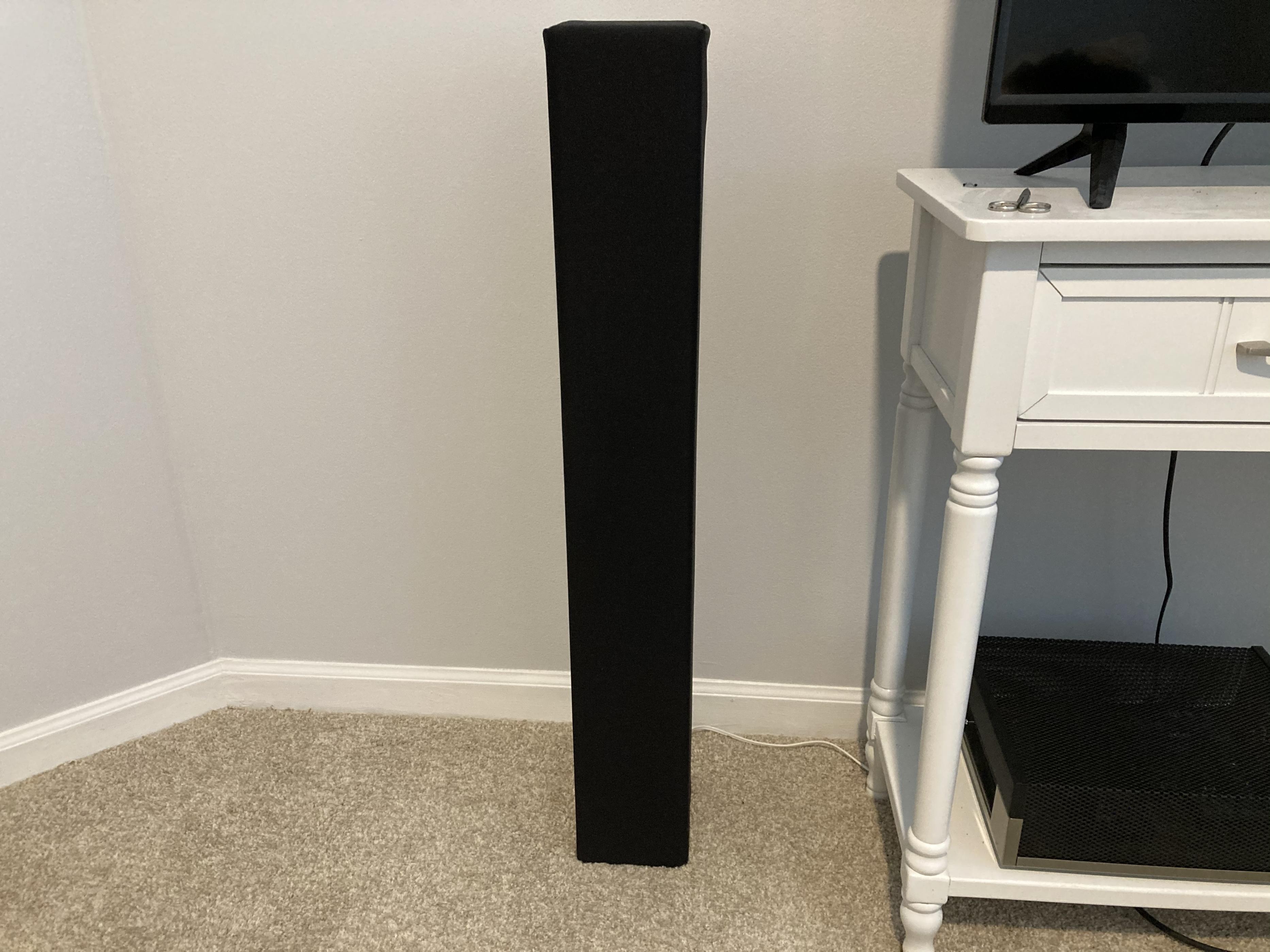

I think I passed the finish line on this build. My last bit of tinkering was adding the BSC, filling in the Faital Pro frame with silicone, and wrapping 3/4+ of the speaker in fabric. Again, many calamities occurred, including me sticking my thumb right into the dust cap. It's amazing how much abuse drivers can take. I picked the hardest way to install the BSC. I wish I did it when building cabinet. The fabric fold at the top of the speaker sucks--it is what it is.

So there is a raised rim around the edge of the driver frame. When building, I had to recess the driver so the rim was flush. I took silicone and filled in the channel around the rubber gasket and the channel between the driver frame and the cabinet. Now there is a smooth 45 degree (kind of) slope between the driver gasket to the cabinet. The theory is that smooth transition eliminates baffle step issues. I realize this is a bit obsessive. I would take a picture, but the fabric is in place and it takes a ton of messing around to get the fabric to sit correctly when only held in place via tension between glaziers points.
You could leave the BSC outside the cabinet.
I know. I am a masochist and it looks so pretty.
Thanks for the details. Maybe obsessive, but it is a good idea. Even if it does not make a noticeable difference in the sound, at least you sleep better. I am busy with my TABAQ's using 4FE32 drivers and might even do the same. I was also thinking of actually removing the rubber gasket, since it serves no purpose mounted with the back against the baffle.So there is a raised rim around the edge of the driver frame. When building, I had to recess the driver so the rim was flush. I took silicone and filled in the channel around the rubber gasket and the channel between the driver frame and the cabinet. Now there is a smooth 45 degree (kind of) slope between the driver gasket to the cabinet. The theory is that smooth transition eliminates baffle step issues. I realize this is a bit obsessive. I would take a picture, but the fabric is in place and it takes a ton of messing around to get the fabric to sit correctly when only held in place via tension between glaziers points.

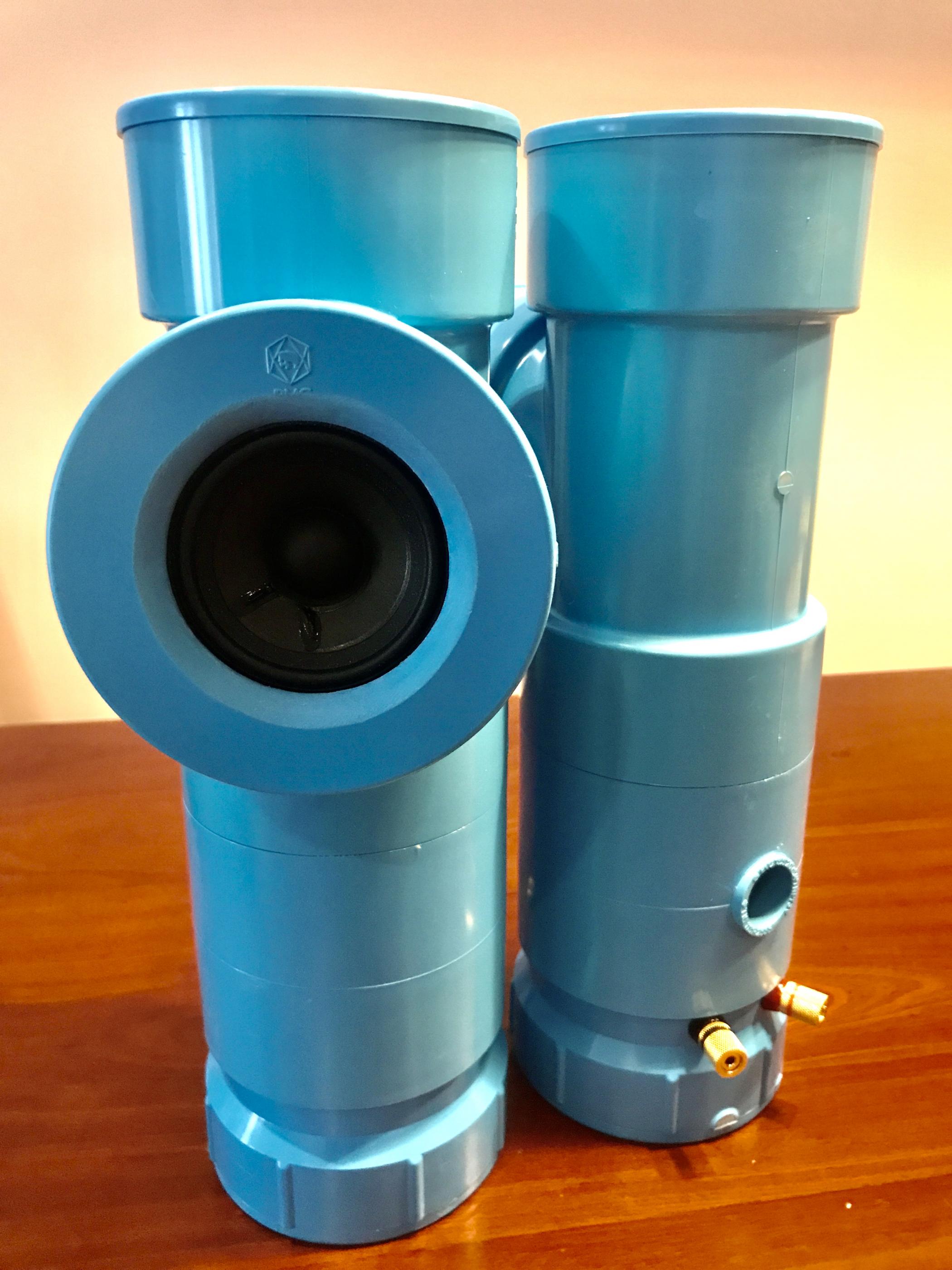

I've been playing with 3FE25 in a "bookshelf" speaker made from 100mm dia uPVC pipes and want to add a longer pipe. Tabaq is what came to mind.
If I invert the enclosure the driver would then sits about the right distance from the top (20 and a bit cms) and then with pipe added to the bottom I can then get them about the right height above the port.
Question: the cross section area is going to be ~76cm2 rather than the ~128cm2 in the box plan. Thus, volume will be less.
Is it the volume or the length of the TL that is more critical?

Enclosure to port area ratio in Tabaq. 128cm2:16cm2 in Tabaq. I guess if you can keep the ratio of enclosure area to port area similar, it should come out somewhere near. If not you'd need to fiddle with the port length. Or model it in LA or Hornresp.
Your CSA is almost half of what is needed for the TABAQ. And you don't mention the length, but in that picture , it seems much less than 80cm.
A little off the numbers in the plans will not affect too much, but halving them will certainly do!
Looks like you really love do the hardest way, if you think that the 4FE32, 35 and so on are born to be mounted in car dashboard, then we find is an amazing driver for Tabaq, problem is this ugly mounting frame, so please look around in car part shop and you will found lots of gasket 4 inch size that fit the Faital Pro without the risk of ruin the driver, you are in US so I think you can find it in your local market, I personally had to buy those gasket in Aliexpress because here in Philippines nothing like that is available and if you still can take away that fabric looks very bad to me, sorry if I tell you 🙂...all the best
Thanks Irishpatrick. I'll also probably do a similar thing to mine when assembling them.😉
I would caution others. I chose silicone because it could be removed if I needed to remove driver. However, it was a pain to work with (and not get any on driver) and it looks ugly. My plan was to cover speaker in fabric, so that didn’t matter.
