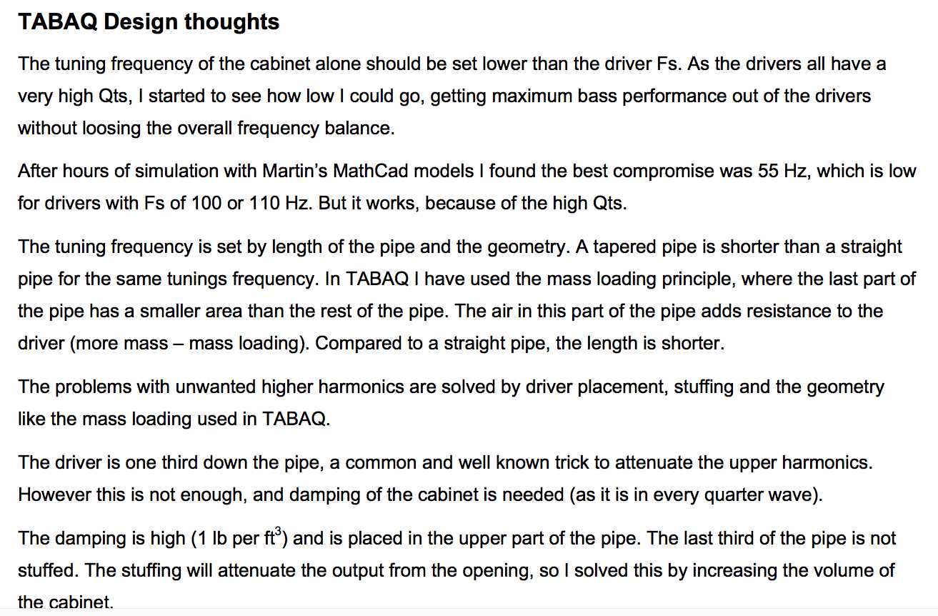

Yes, that's the exact thing I am asking. If translating it to online/offline calculators, what K coefficient should I use? Default is ~0.7 for simple round vent in the middle of the speaker baffle. The picture in my first link suggests 2.2 due to the reason you said, but if calculated with that coefficient the results are somewhat strange: very very short slot ports are suggested.
Of course, if some smart mind says that info in this picture is wrong - case solved. Or even another reason... I am just calculating wrong.

...It may be, if my question was about the MLTL. The question was about TABAQ, but i can ask the same question about any box design with slot port, which has slot port of all speaker box width. I will not over complicate asking about proximity to the ground etc.
It is dead simple: if I want to simulate/calculate vent tuning, what K(or k) coefficient I have to use? Closer to 0.7-0.8 or 2.2?

May I ask to calculate vent tuning frequency for me of the default TABAQ? With any online/offline calculator available.
Thank you.
Thank you.
I would ask Bjorn to do it for me on this thread. He did the original calculations with the MJK software, which I don't have.
I have not seen MJK software, but from the all the result sheets over the web there are no port correction factor. We are here on our own.

Translating to nothing........ Per the chart, a shelf vent has a 2.227 'pipe' end correction, though without access to my own calculator based on measurements, not on pipe end corrections per se, I can't say how accurate it is other than it's my understanding that the chart has been vetted/well proven by others, both pro and DIY.
Re when does a reflex, which is presumed to have a uniform particle density air mass 'plug', change to a 1/4 WL resonator [MLTL, etc.], is when simmed using accurate pipe/horn theory, the 'visible' and/or measured turnover point is when the reflex calculated alignment is 'stretched' to a high enough aspect ratio [pipe compression ratio [CR] to my way of viewing it] that the vent is becoming too long for a given vent area [Av], i.e tuning [Fb, Fp] is 'creeping' lower due to increasing 1/4 WL pipe action increasingly damping the vent with increasing CR.
I currently only have Hornresp
loaded, which has no shelf vent option and otherwise WRT accuracy only know that it's good enough when the vent is a reflex [hole in a box], be it just a box or some type of MLTL and one pipe vent MLTL recently done by 'Scottmoose' in MJK's software for comparison.
All that said, historically it was recommended to start with too large and or too long a vent and do final tuning in-room and IME, many times I had to tune each cab individually for best overall in room performance; though admittedly I'm from the era of 'acoustic solutions to acoustic problems' since highest practical acoustic efficiency was a primary goal, whereas today with ~affordable, high SQ, all encompassing DSP, cheap high power; speaker design has become mostly moot in [casual] DIY, consumer HIFI/HT apps.
