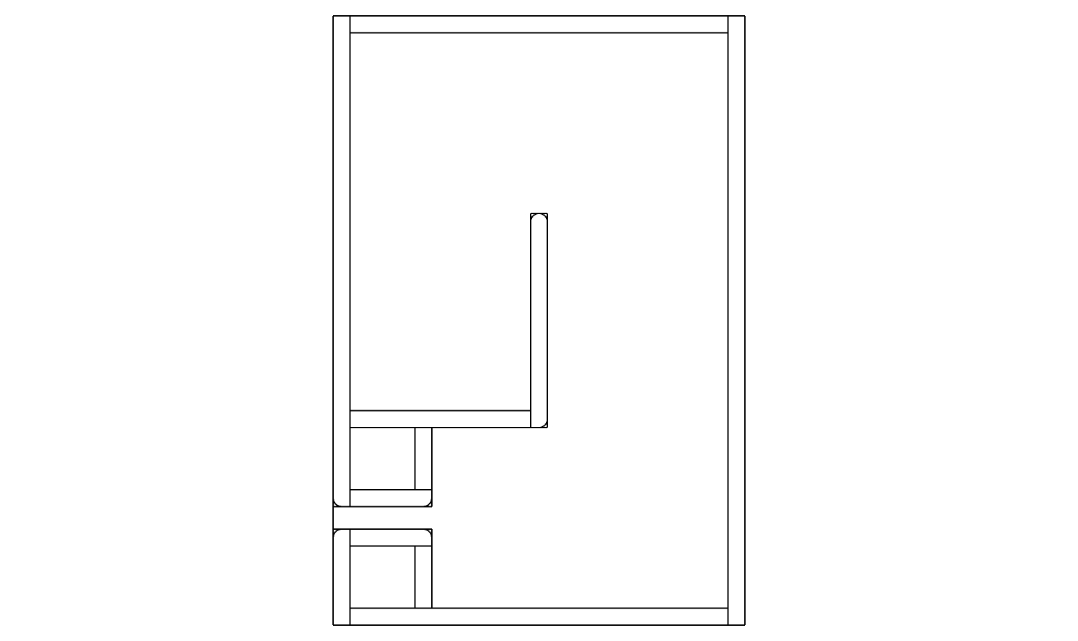

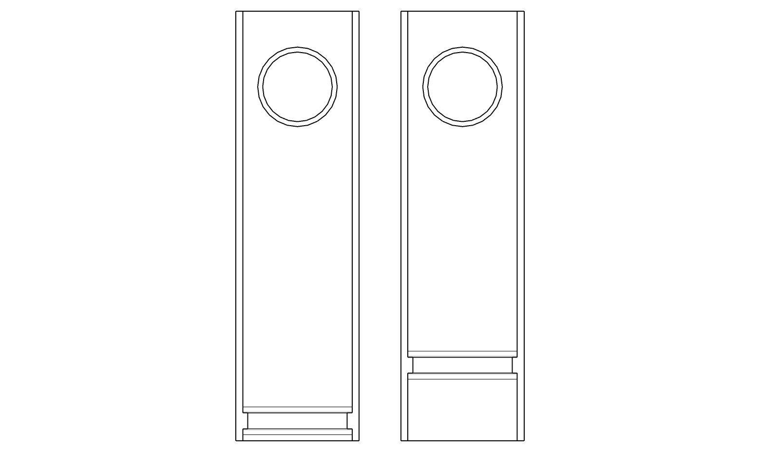

So, I'm doing some sketching this morning. Thinking about the possibility the build my TABAQ on a baseplate (or foot) for 1) reduce risk of tipping 2) increase the height with maybe an inch or so and 3) create a room for BSC underneath that is fairly easy accessible. But would this change sound? Reduce low end response?

There should be difference, but how much depends on many conditions. Personally think that smth like 5cm in your case will make difference, but not that much to change the overall signature. 30cm will be far different.
Maybe filter built into back plate will work better?

I doubt you will hear any changes by putting the TABAQ on a 1 inch base.
And look at the commercial offering from Bjorn. The vent is much higher than most TABAQs built around here... and much higher than 1 inch.

Turn the vent vertical. It will raise the driver the length of the vent, and allow room for BSC circuit behind the vent.
The vent already has a 90 degree bend, as designed it's at the beginning of the vent. Turning the vent would put the bend at the end of the vent, but resistance shouldn't change appreciably.

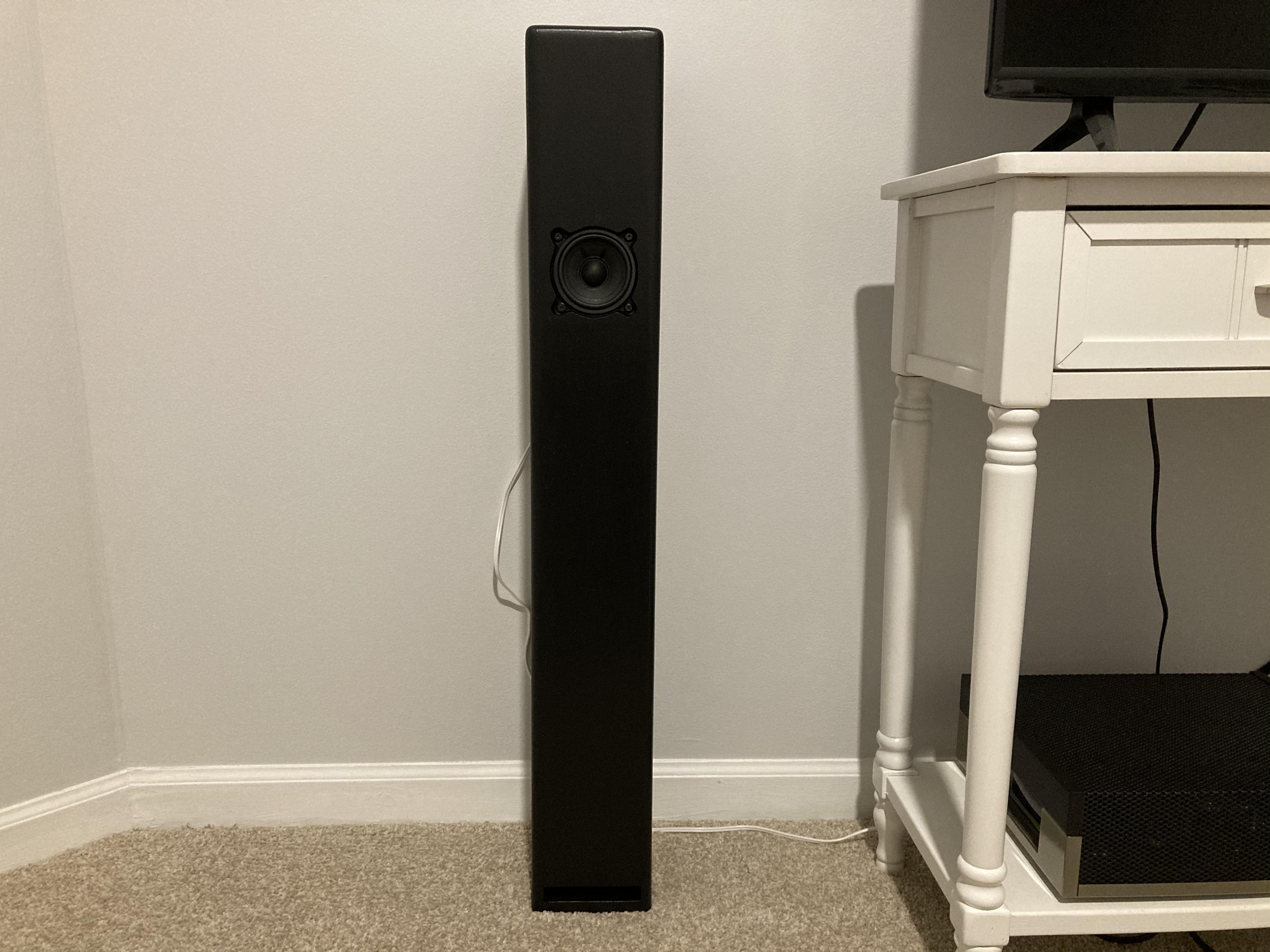

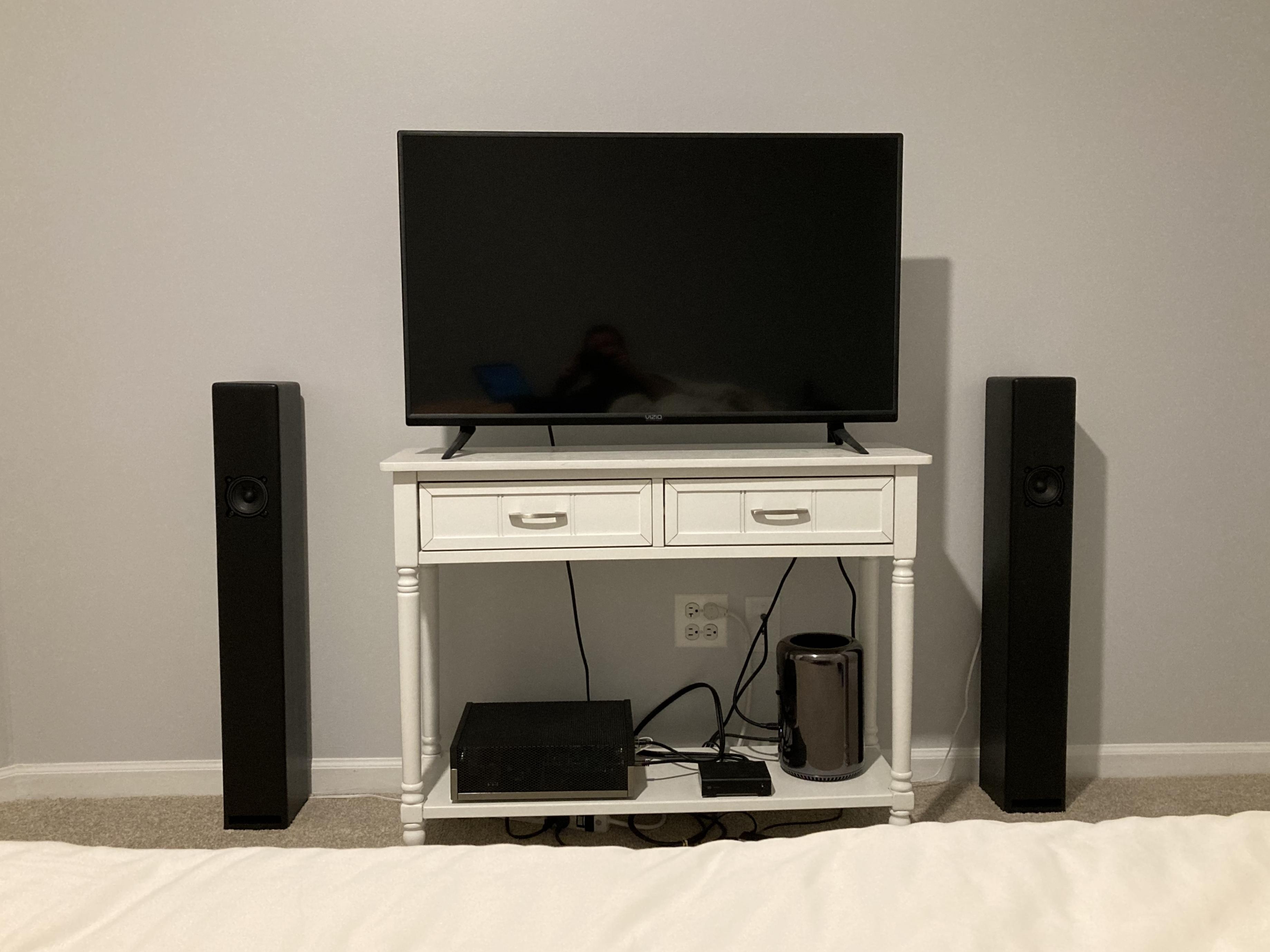

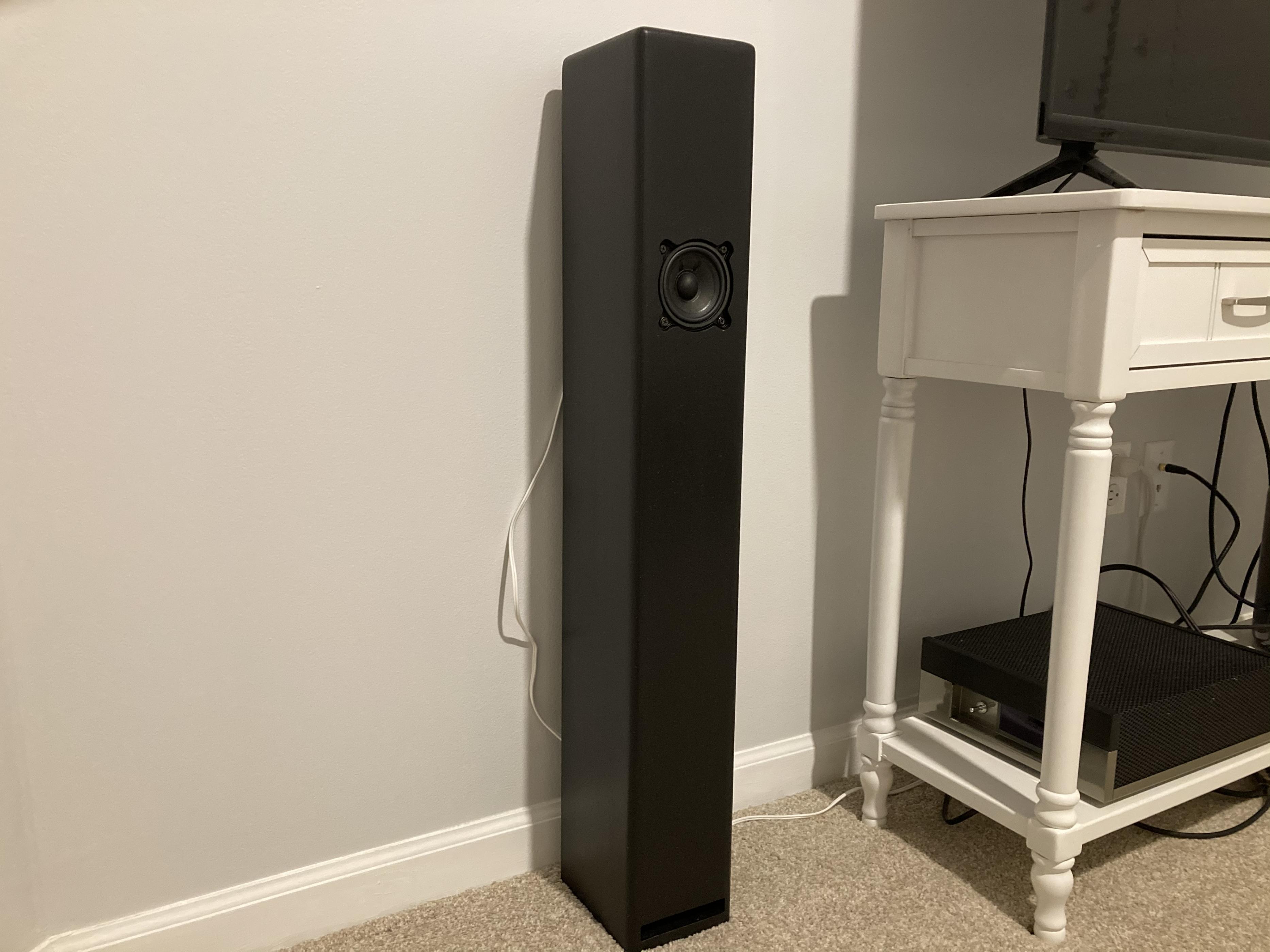

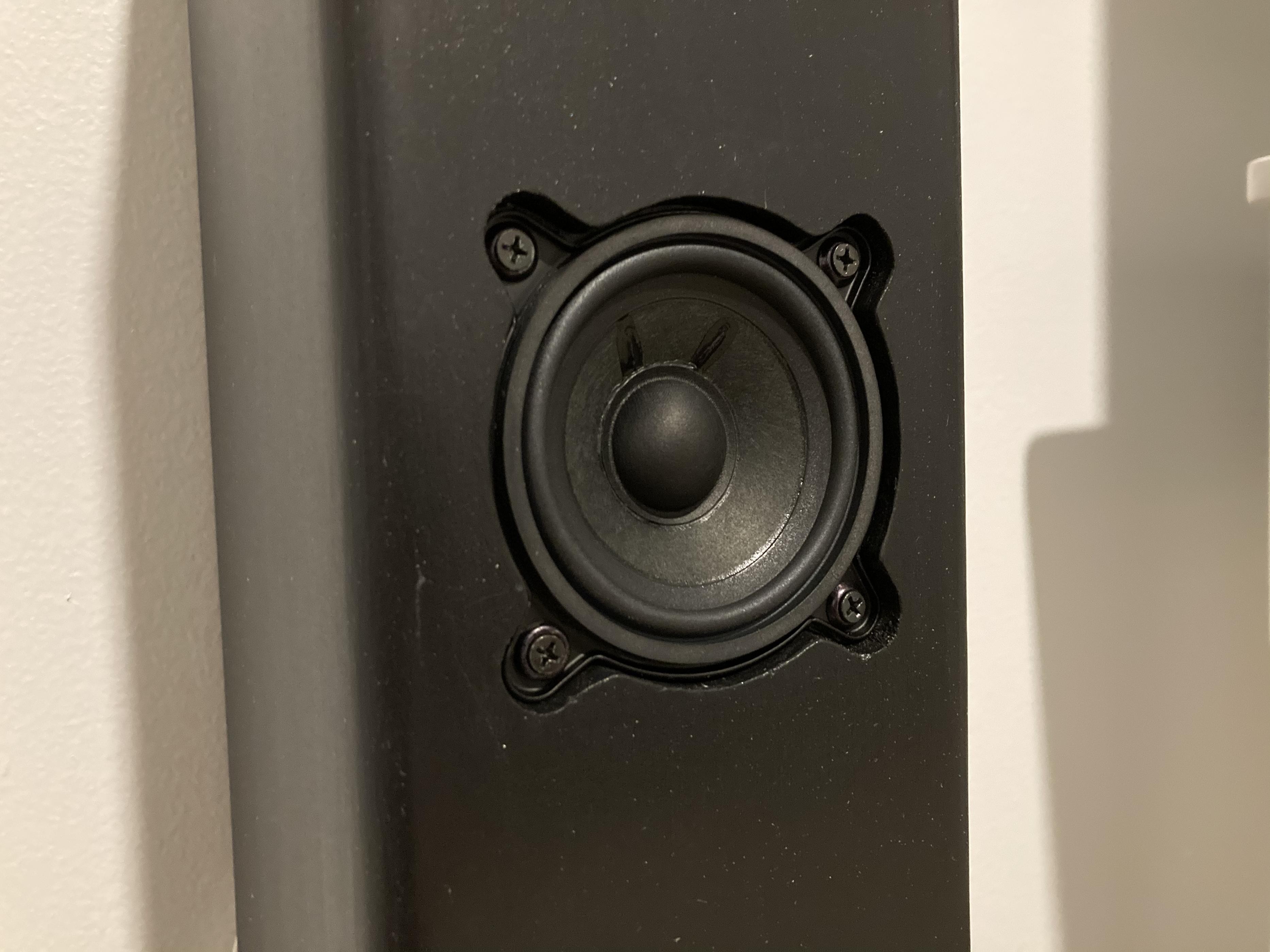

I kinda finished my speakers. The binding posts aren’t oriented correctly on a couple (ridiculous mistake). So I will probably open back up and fix. This design is the vertical port using a brick inside the reservoir to weigh down. It took forever, though I was adhering to mm level precision. At one point I dropped a 3/4 assembled speaker, essentially knocking it over onto a concrete floor. The darn thing tried exploding on the top of the side facing up. Luckily it split along the joint. Glueing back together solved it. I may add cloth to entire speaker... or not.
I’m letting them break in. The speakers are plenty loud with sufficient bass for my tastes/circumstance. I’ve only had a set of B&O RL 60.2’s in the same system. The B&O’s has more slam due to actual woofer. Though they had a poor sound stage and required placement at ear level for listening. These babies lack the slam but soundstage far better. The midrange doesn’t compare with a Maggie. I’m wondering what more or less stuffing might do. I will only open back up once more, anything more is asking for trouble.

They came out beautiful irishpatrick - despite some mishaps. I like the rounded corners and the rebates for the drivers are perfect. CNC I assume, or some excellent router skills. Hope you enjoy them more after the drivers have loosed their muscles a bit. Are you using a BSC?
Rebating a Faital driver is certainly not the easiest.
The rounded corners are indeed quite nice, too.
Because you are the builder, only you will notice the little flaws. Everybody else will marvel at these.
