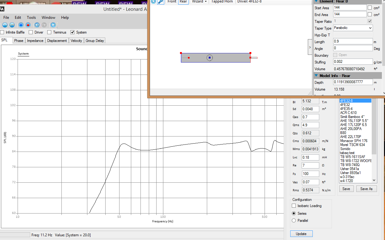

While I love the Faitals, I was sure I had tried to sim them before and wasn't a fan in the TABAQ.
I'm glad they do work in your room, but I'm pretty sure they would not do so well in mine. See, my room has a suck up node at 65Hz.
Looking at the sim, there's a drop at that point, so, that might become a chasm in my room. On the other hand, if your room picks up at 65Hz, then you'll have a good sounding system.

I have a fast check and can't find any design around this speaker only with the sim from Perceval. After couple successful built with RS100-8 and TC9, I really would like to give this speaker a chance since I have a pair sitting for nothing.
Would appreciate if Bjorn, Perceval would give some ideas and or design for me to try. Size is not a problem.

I looked at the W5 again, and I'm sorry, but the TABAQ doesn't help with this driver.
It performs exactly the same as a regular ported box, if you're looking for a nice sounding curve.
So, for the W5-2143, that's what I would suggest. A simple ported box, 15 litres, and tuned to 57Hz, so a 5cm diameter vent, 8.4 cm long.
F3 comes at about 55Hz.

The W5 will need a larger volume than TABAQ.
I can try to sim in a couple of days.
