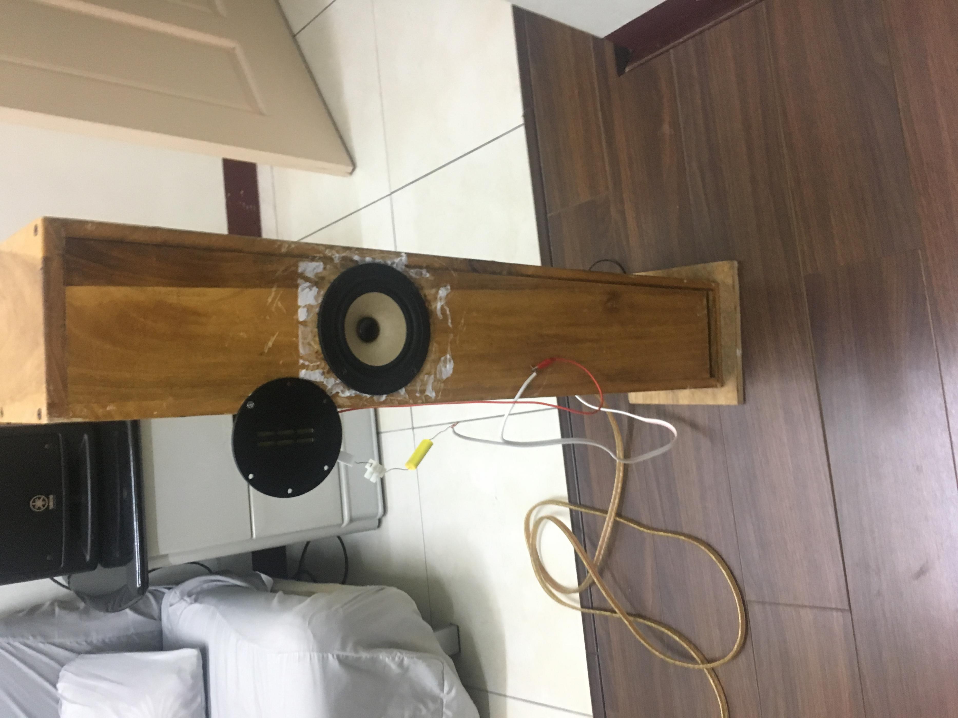

I don't have the CX120, but I have been trying some tweeters with my TABAQs "test enclosures" . They are enclosures I use to test if sims do translate well . And at the moment, trying to add some air to 4" drivers.
The CX120 will need a XO, 2nd order if you go high enough, or 3rd to 4th order if you want to cross a little closer to their advertised bandwidth .
You could use the zma and frd files from Dayton as a starting point with XSim to come up with something, until you actually get the drivers in the TABAQs and measure them personally to input that into XSim.
Just had a quick look at the CX120, it doesn't look bad, but it is not as clean as I was expecting. It looks a little like the original TB used for the TABAQ design, the W3-315c.
If you can get it, the W4-1720 looks great, but would need a tweeter on top, the 1720 is a woofer.
I'm not saying the CX120 will be bad, it should be ok in the original design. It will depend if your room picks up frequencies around 50Hx and boosts them. If not, then it should be fine. If your room boosts frequencies between 65Hz and 120Hz, then it should be great.
