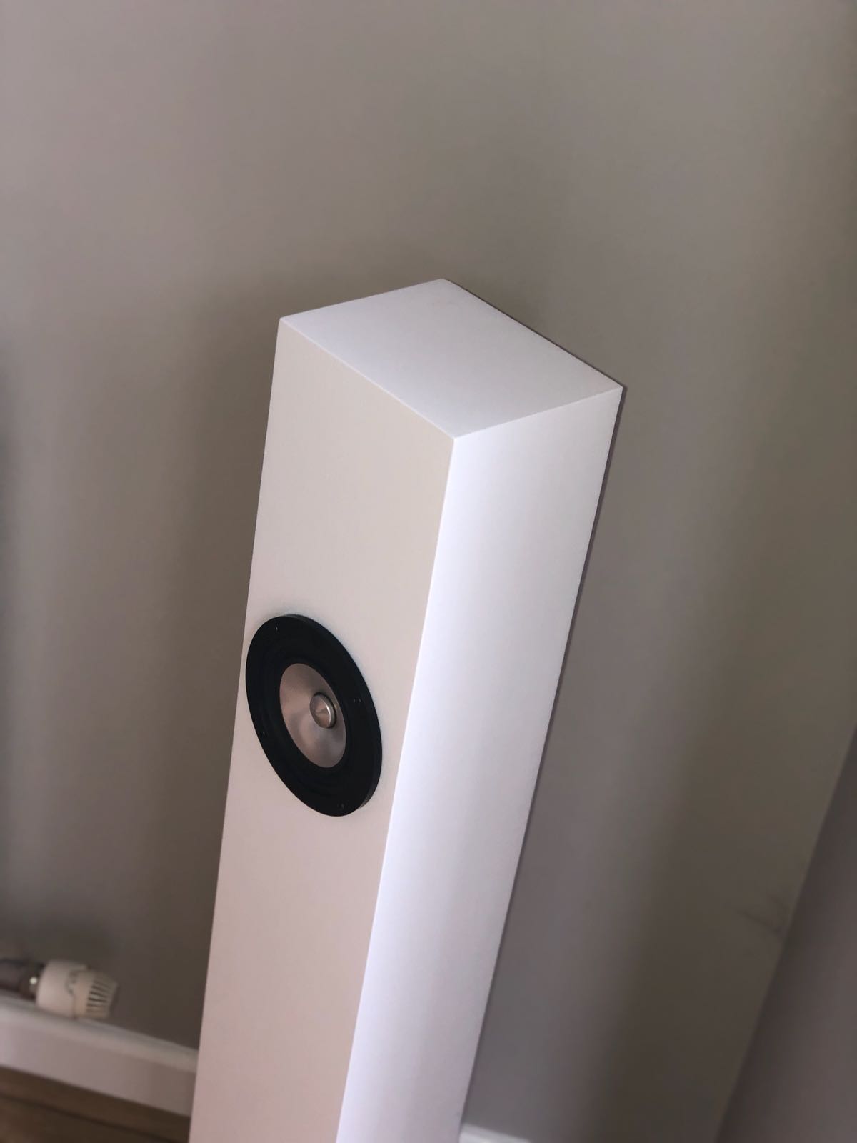

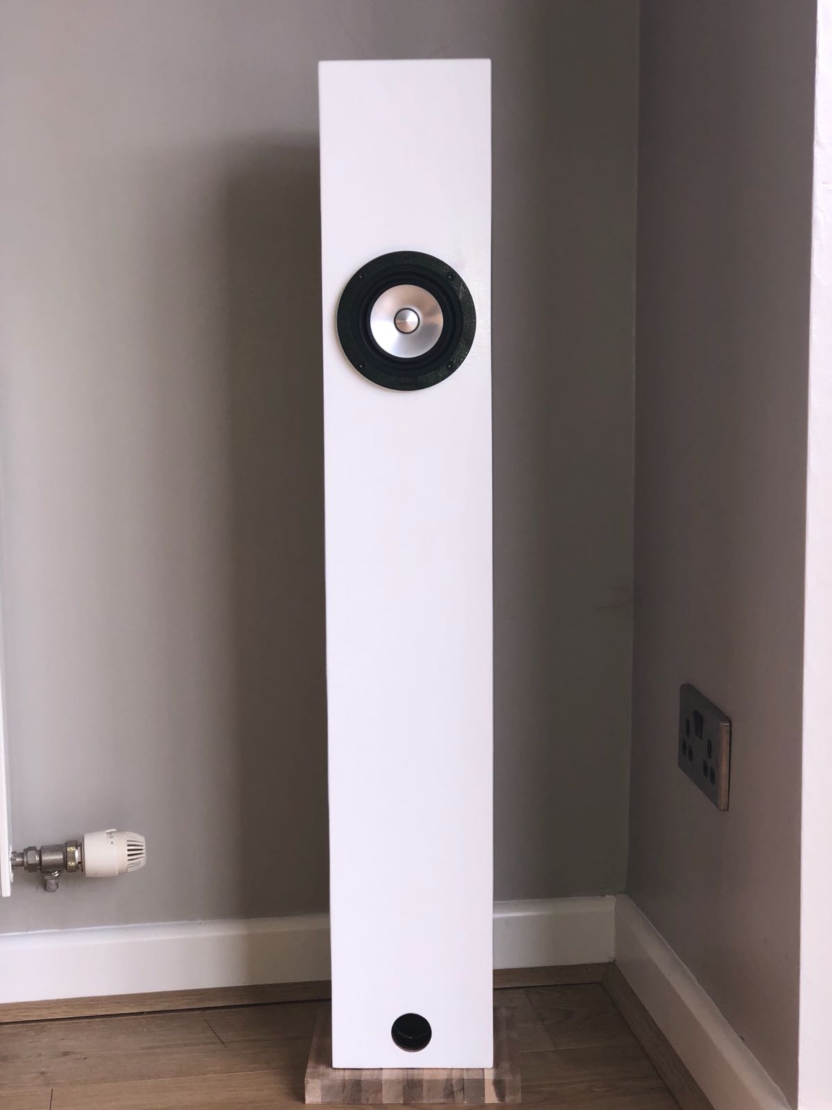

Well I finally finished my Tabaq's using Mark Audio CHR70.3 drivers. I still need to add a finish to the plinths
I'm enjoying listening to them so much. I'm no expert, but they have exceeded my expectations with the sound they produce and I have managed to finish them to a decent standard. I have WAF!
Thanks to all thread contributors!
Regards
Chris

Quick question about stuffing, i have tre cabs more or less assembled without one side attached as per Bjørns document. I am planning to use rs100s and 70g of stuffing, do I tease it apart and fill the top 2/3 or simply mash it in unteased?
Chris, very nice!
Silas, after I weigh the stuffing, I pull it apart to keep about the same density throughout the first 2/3rd.
