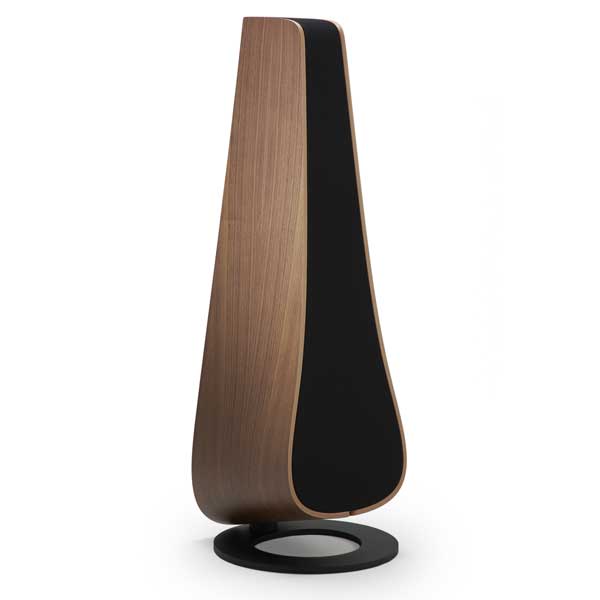

I am going to put them in a test box first and break them in see if I need a BSC etc.. If I like the sound and get them working the way I like the next step is to build to the dimensions of the TABAQ with a bentwood enclosure and get them sounding the same or better then the test box. It will be a challenge which I like and will take a bit of time. I may be totally out in left field but worth a try.
Something like a Davon Solo, but my own design which I am working on.
