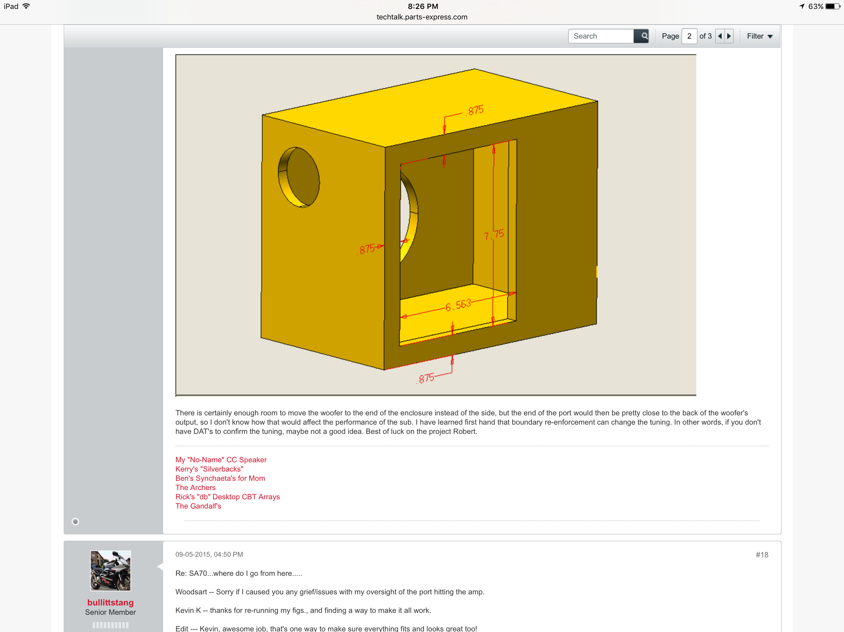

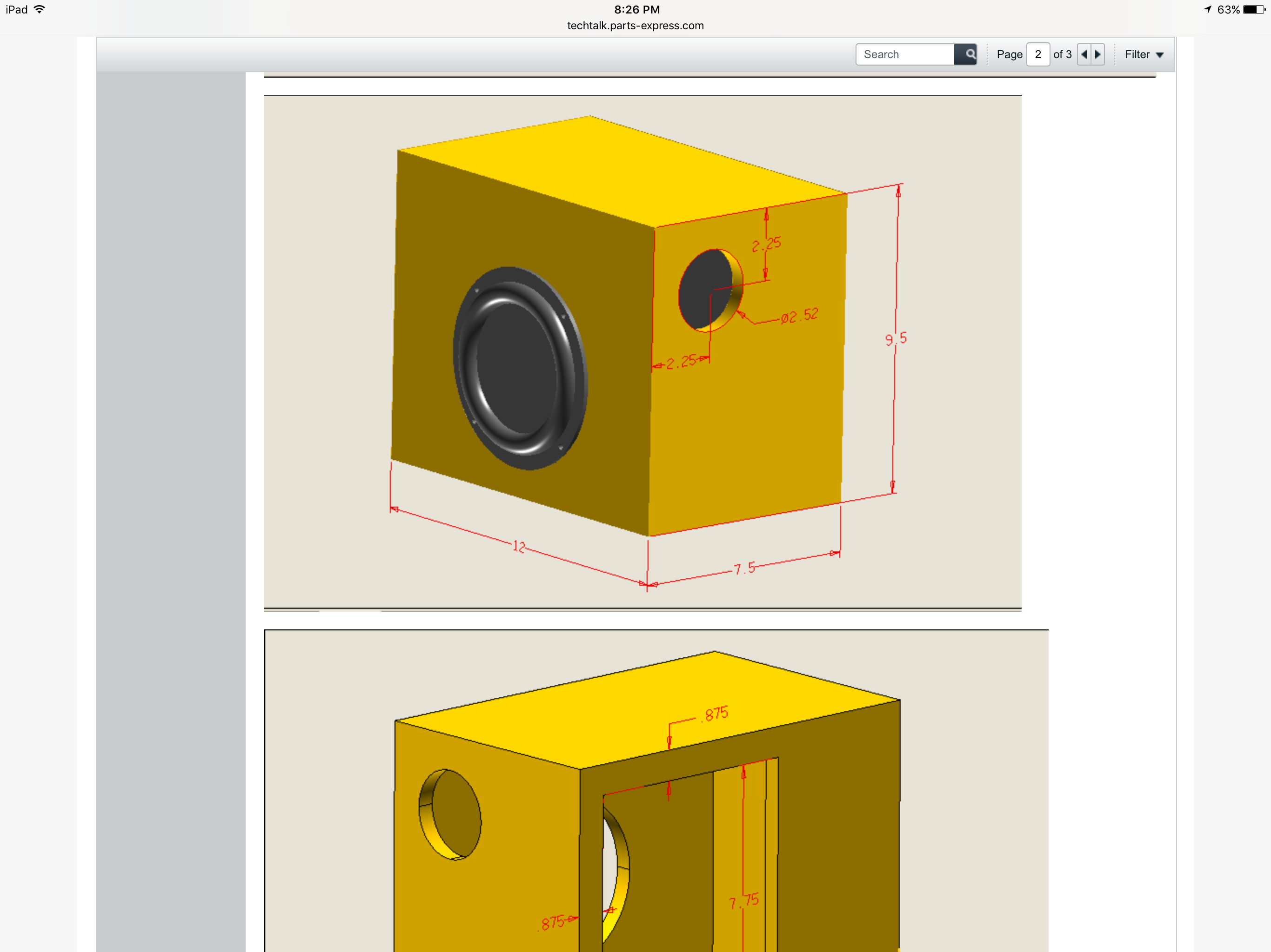

My system with the original design of TABAQ uses a small sub (Paul Carmody’s design). I used the design that allows a plate amp in it. The sub works really well with the TABAQ and so much so that in some recordings the house can vibrate a bit. Takes a bit of time to find the correct overall setttings on the amp, as well as where the best spot in the room for it. The TABAQs are hooked to the amp and the sub is connected to the DAC.
You can find my setup here; Kevin's fab sounding IQaudIO / MoOde based 2.1 home system - IQaudIO Limited
The attached images shows the design for the sub I used.
Hopping this doesn’t complicate things

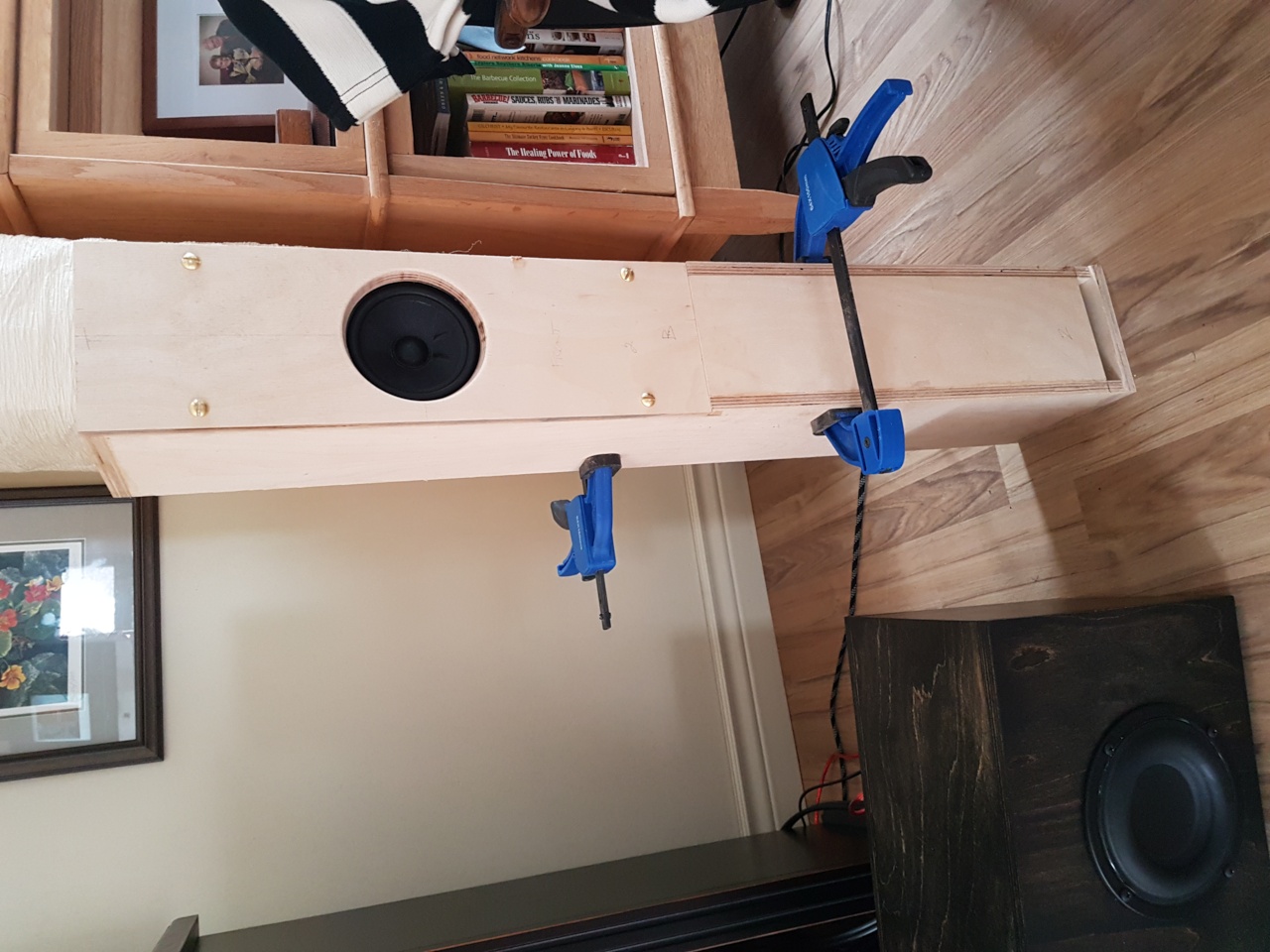

The title is totally worthy of this build as I am astounded by what I hear. I finally have been listening to my second build of TABAQs with the FaitalPro 4FE32 8ohm. Life got in the way and it took me a while to get to this build, but the wait I guess is worth it. My first build was with the TB W3-315E and I was quite happy with those. IMO the FP’s put the TABAQ in a whole different place. I don’t have the software, or mic to test these yet, so I am using my ears and have made the changes needed to make them sound where I like them. I will test them eventually.
Good, very good highs, and the mid-range is much much better then the TBs. Bass is there a bit more then the 3” but it sounds more solid. The sound stage is fuller and wider as well. I have listened and worked with these for the last 4 days and they keep sounding better. I have a sub hooked up as well. I haven’t measured SPL yet but they can be loud.
I hooked them up to my Pi/D amp/dac setup and they performed really well. I have them now hooked up to Dayton A/B amp with a Pi/Dac and it is a warm full sound. One thing that is quite apparent is voice, much cleaner, clearer. I heard lyrics that I couldn’t quite get with the TBs.
As you can see I mounted these on the backside of a removable baffle. Hardest thing was to get the precise placement for the screws to meet the inserts. I am very happy with the sound now, and will be taking then into the shop to finish them off. The removable baffle is going to be exotic wood, which I have I just need to thickeness plane the piece down to meet specs.
When I have them all done I will post a pic or two.
As of now they have 64 grams of stuffing in them and a 4Hz BCS. Personally I cannot see myself needing a tweeter with these, but a sub does definitely add the bit that is missing.
