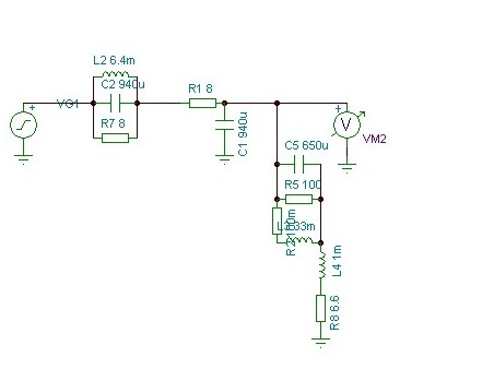

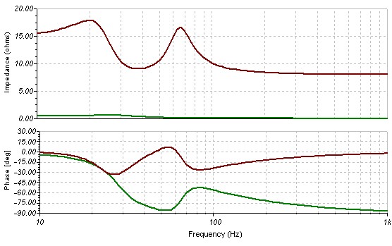

Is such a narrow band of very low impedance going to be a potential
issue in the real world? Maybe an amp will want to shut down if told
to play a very loud 90hz sine wave, but otherwise... any problems?

If your referring to post #59 that is purely an illustration, not real world values. Post number #43 though is a serious amplifier load.

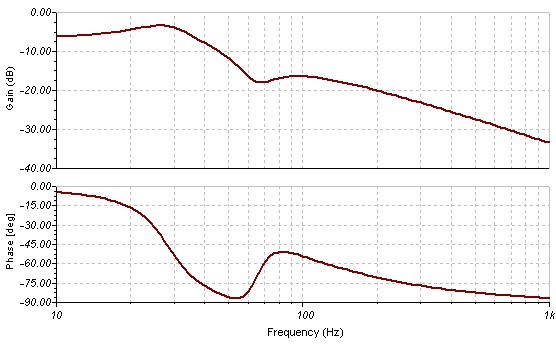

Just messing around, that is not a good circuit.
In fact a simple series resistor for low Qts drivers works quite well,
with a very easy load. Because Qts is low the impedance peak is
very high and so you only lose < a dB at the drivers resonance.
Probably the way to go for valve amplifiers.
Effect of 6.6R series resistor on voltage drive for modelled driver :

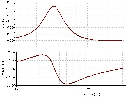

Hi Mr. Maynard,
I'd like to have an clearer idea how to tune this circuit. So I made some simulations, too. (I know they are far from perfect, but I need a guide.)
I've used SPICE and spread sheet by myself. And the 2 were very different and looked very odd. I won't post them because maybe I got them all wrong in my own spread sheet or also messed up the setting in SPICE... (the circuit looks simple but the mixed relations between transformer, C, L, and load make it so complex... )
According to SPICE, the inductance of the transformer winding plays an important role in the available lift down low. How does this reflect your experience? (You didn't recommend transformers with any particular winding inductance.... )
And, you mentioned the LC tunes the cut, not lift. (I got it now!) So, I can understand decreasing the C, but why did you suggest me enlarge the inductor? That lowers the cut frequency, doesn't it?
I'd like to have a cut around 100~150Hz, what would be your suggestion on LC combinations?

CLS said:why did you suggest me enlarge the inductor? That lowers the cut frequency, doesn't it?
The series tuned C+L values you are using (C too high, L a little low) are forming a tuned circuit which loads the amplifier without allowing the driver to optimise LF output.
The C tunes the cut frequency and your 10,000uF tends to form an 'all pass' section in parallel with the transformer, even for bass.
