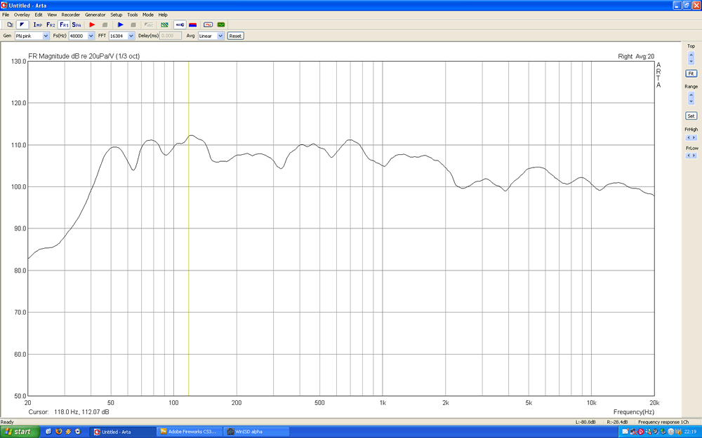

ErikdeBest said:In the meanwhile I will keep reading (and rereading) SimontY thread on dipole design and T-bass. I really like the way SimontY is developing the thread, lots of information and getting better!
I guess I'd better update that thread then Erik, I did a lot of work last night! I'm glad someone's reading. I need to make the transition between woofers & mid 2nd order now, as I can't remove the excessive mid output from the woofers any other way. Lots to say but this isn't the place as, basically, I think the T-bass part is doing its job wonderfully.
The attached pic might be interesting though - not a bad response for the actual listening position I think. No electronic EQ, all passive. The 50hz is probably boosted by measurement hum pickup.
Simon
