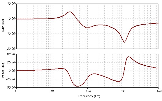

And what is the frequency of the boost peak of the "original" 6.4mH + 470uF*2 ?
If I want to locate the boost hump at 25-60Hz range (reduce 100Hz and up), how should I begin? Try different values of chokes would be quite difficult for me🙁 I'd like to settle this first and play with other factors if possible.

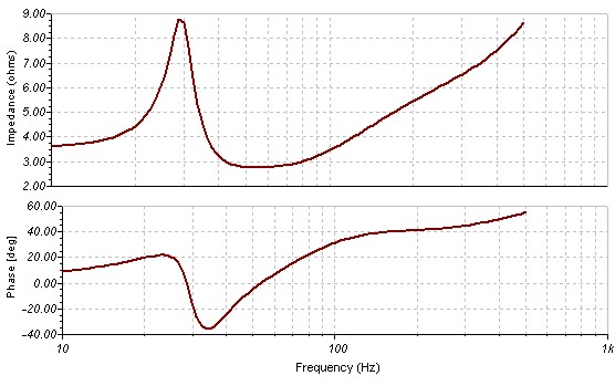

Wow looking at sretan's graph, its very polite to say "loading is a bit vicious" Now I understand why there are reports that use of this circuit can trigger amp protection circuits. If I understand the graphs correctly, the load drops to just over 1 ohm between 40 and 50 Hz and is accompanied by a phase shift.

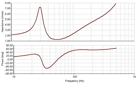

And WOW! the load is approching 1 Ohm!!
So, I'll try to move the gain peak to mid20~low30, and boost it a bit higher

I repeat - there is not a boost peak.
The transformer and choke lift the LF below and around driver Fs.
The listed C and L tune a dip to the driver(s) circa 100Hz for open baffle usage, but also load the amplifier where driver Fs otherwise does not.

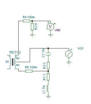

I have noted playing with the sim low resistances are needed.
I'm not going to argue with TinaTM's impedance meter.
Impedance may be a little higher with real component losses.
1.5R in series should stop it blowing up amplifiers.
🙂/sreten.

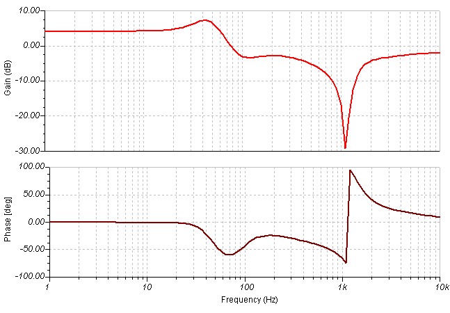

Hi Sreten,
I wonder if you have a Zobel on the LS driver for that last simulation.
Level should drop a little after the notch with one fitted.
Cheers .......... Graham.

The zobel is in there for both graphs in post #42 and post #49.
It does prevent some peaking after the notch without it.
I cannot see why levels above the notch should be lower.
🙂/sreten.
no zobel, 1R series (100R notch damping resistor)
Hi Sreten,
In real life the driver output would be reduced above whatever 'breakup' frequency the notch is tuned to.
Also the driver with Zobel becomes a potential divider in series with its chosen series inductor plus capacitor, so some electrical reduction too without excessive phase change with respect to the mid/FR driver.
Cheers ...... Graham.

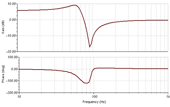

Its an interesting circuit. See attachment.
If you consider the low frequencies and then the high frequencies,
you should be able to see a phase inversion, which means at
some point you will get a cancellation notch, around 90Hz.
Reducing the 1R resistors makes this very apparent.
As well as the phase reversal there is an ~ 6dB gain change.
It is a form of elliptical / cauer filters and can be done actively.
🙂/sreten.
