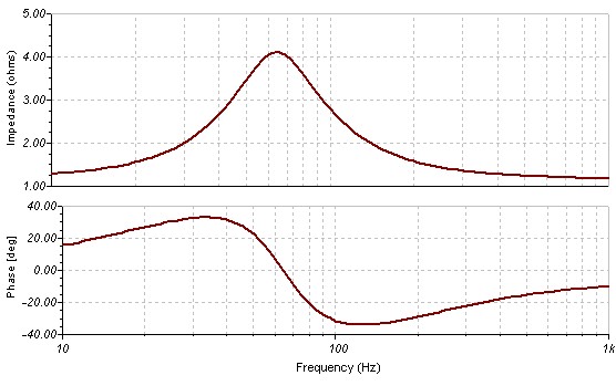

sreten said:Hi,
For anyones information: the source impedance driving the speaker.
(Standard circuit but midrange notch filter components omitted.)
As its not voltage drive (low source Z) driver parameters are changed.
🙂/sreten.
Hi Sreten.
That is similar to what I published/reported in another Forum before opening this diyAudio thread.
The effective source impedance in series with driver impedance was one of the main aspects I studied about this circuit.
Where there is maximum LF boost from the transformer the circuit impedance is lower, and thus there is maximum transformer generated increase in amplitude.
Around and above driver Fs - where circuit transformer output is falling - there is increased series source impedance, though this arises where the driver impedance is also higher.
Notably this allows low Q drivers to develop a higher Q and thus increased output, though this where the drive is reduced.
HOWEVER. This impedance peak *does not develop until after the first half cycle* of LF input waveform, and thus it also prevents the LF driver from transducing/storing waveform energies which would (and do) otherwise 'muddy' LF reproduction.
Thus the driver receives initial drive amplitude which can be matched to counter coil/cone/air mass resistance to motion with a suddenly starting waveform, and this is why drum reproduction sounds so much more lifelike than I've heard with any other combinations of more conventionally driven drivers/baffles/enclosures. Just clean bass !
The illustrated impedance peak then returns to a low value where the upper bass output amplitude has been much reduced, but not phase shifted !

Hi UnixMan.
You've got it.
The T-bass circuit acts in two ways, with the circuit L and C chosen to match the driver characteristics + mounting requirement.
Using a series resistance will not do the same job due to power/sensitivity loss, whilst the transformer actually increases sensitivity by stepping up voltage where the driver impedance is still high.
If you get a chance, do try the circuit.
It will work with any sized driver, and even with enclosures.
Cheers ......... Graham.

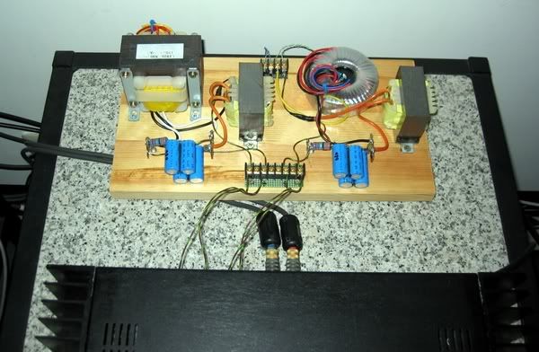

Update
My progress is slow😱
For convenience of modifications, I made a T-bass mockup on a peice of wood and placed it behind the amplifier. (Eventually I dug out my good old Hafler which has been in rest for quite some years... )
Chokes are EI type, together with transformers were picked up from various "junk" yard (my own and other's old part bins... ). The toroid one on the right is apparently undersize with only 0-6.3-12.6V. (Well, this is a mockup... and my new 400VA toroid ones have just arrived.)
Now the choke is 4.2mH, cap is 700uF with series 3R3. The impedance with driver in free air stays slightly under 2 Ohm in the range of 60~120Hz, with a 'peak' of 10 Ohm at 28Hz. (On baffle, the fs should drop to low 20's, but not measured yet.)

The baffle was originally designed for a single 8" fullranger, which was posted here last year. I added tweeter WG and 18" woofer to make it a 3way.
Low and mid-high are actively xover at about 160Hz (maybe a little higher acoustically, I have not measured it yet)
At first the woofer overwhelmed the midhigh. In addition to the flooding bass, the woofer produced more midrange than the midrange
My DIY pre+active xover is not so easy to tune (as turning some nobs), so it took me another night to work on the circuits to tune the gain and xover frequncies...
Last night, after some fast pink noise sweep and fine tunings on the upstream EQ, this new system began to sing beautifully. Not perfect at this stage of course. However the fullrange coherence is very nice. I like the bass a lot 😀
The baffle is 3/4" ply (bad quality) with only minimum supports to stand upright on its own. Now it seems too flimsy to accommondate a heavy 18" woofer (and the air it pumps). The whole baffle was shaken at some bass slams, and squeaked! 🙄 I have to work on it later... Even so, the overall sound is still very pleasing.
Of course more tuning is needed. To be continued....

Back to the T-bass, last night I hooked up the new 400VA toroid transformers (with 28V-0-28V coil, 0.4 Ohm DCR and more than 500mH inductance). It was very late when I finished the job, so I could only play it quietly. In such low volume listening, I can't tell the difference. I like overkill anyway😀 Now the T-bass board is heavier than the amp
It seems I can not escape from all these irons. With tube amps, I uses a lot of them. Now with SS amp, they are still here! A lot of them! Funny.
On the other hand, I noticed the impedance of the transformer winding is peaked at about 2kHz, and then drops. How so? Is it because of too much parasitical capacitance? It's quite different from 'normal' chokes with simple exponential rise curves....
