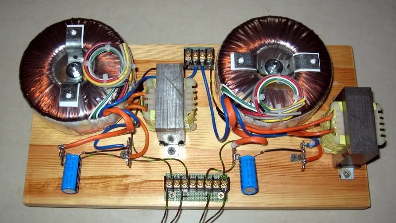

I re-routed the feedback of the amp to the 'normal' output point last night. And it's obvious the mid to lower bass got stronger (more output). I don't have equipment for precise measurement for this. My gut feeling is it gains 2~4dB across the bass range (maybe even more, I don't know). I guess this would be the effect of 'tightly feedback from the load' -- drive the load regardless of load change.
Sound quality wise, there's no surprise. By only a brief listening, I felt it just delivered more output, with almost equal solidity and authority. In fact, the bass was too much, and I ran out of adjustment range on the upstream EQ. So the overall balance was too bass-heavy, thus hard to verify the true 'sound quality'.
Guess it'd be a good thing, though -- more bass output with all others being equal. It kind of means more positive effect brought by the T-bass circuit.
Now I'm going to change the amp for mid-high to get more gain and balance the whole system...
By the way, this is the picture of the new 400VA toroids:
The size is 11.5cm in diameter, total "800VA" capacity in there. Meantime, I think the power transformer in my little old Hafler is just 300VA or so....

Nice breadboarding there CLS.
I don't see any resistors with the toroidal version though; this can lead to too much or overpowering bass.
Resistors are essential to tame the first half cycle boost which can make drum and bass guitar picking seem overemphasised and eventually tiring.
Do try one ohm starting values in series with each of the capacitor and choke and listen to the way only those who actually construct the circuit can hear that first half cycle compensation actually arising.
( An effect which simply cannot be revealed via textbook sinewave frequency response sweeps nor be evaluated by conventional software !!! )
Yes the 400VA components are large, but you can get output to below 25Hz on OB with them, and with 18" drivers maybe even a respectable 20Hz.
Cheers ........ Graham.

Thanks Graham🙂
Yes, the 'no series resistor' version above (with only 470uF) was indeed a little bit over -- by ears and by impedance scan. It's impedance showed the lowest point of 1 Ohm at 100Hz (28 Ohm peak @ 18.8Hz). It supposedly sucked the most current at around that lowest point and produced chest punding midbass. RTA proved this. I had to add some more attenuations on EQ to calm it down, so it's a waste.
Later, by some simple calcuations and comparisons of the reactances of C & L, I tried bigger C (1800uF) with 1 Ohm resistor in series (still no R with choke). This broadened and flattened the boost and extend lower. The impedance scan showed the lowest point moved to 50Hz (same low 1 Ohm!), with a much tamed peak of only 10 Ohm @ teens!
(The woofer itself on baffle shows 170 Ohm @ 19.5Hz, after T-bass'ed, it's 5 Ohm at the same point. What a difference here! )
That was obvious audible and also proved by RTA -- a good move of making the boost flatter and lower.
On the other hand, I dug out other amp for mid-high to replace the previous beloved 0.7w single stage 6S45 spud amp which was not able to deliver sufficient gain. For leveling the fullrange balance, I attenuated A LOT in the bass range by the upstream digital EQ. As mentioned, it's a waste of gain and also some loss in resolution.
With more gain on mid-high, the adjustments on EQ were dramatically reduced. This helped a lot in alomst every aspect. The mid-high got more energy and livelier and the bass can also give its best shot without holding back -- a big and overall improvement.
Jumpy & lively bass has been mentioned too many times. I heard 'new' things in recordings! Like a child with a new toy, I dug out more and more CD and DVD, played them eagerly. Those recordings I thought with muddy bass are now SO MUCH better. And those already good are now even better, I'm thrilled. (but of course there're still some bad recordings proved to be cureless).
I must say this is one of the biggest upgrade in my whole audio life (20 years now).

Hi CLS,
I 've seen some of your walls, sorry, I mean OB's🙂
How big is medium for you? More over, what about the difference with T-bass versus eq.
I have maybe a stupid question. Most T-bass circuits I've seen are 110V's. Will it make a difference with 240's?-impedance of coils?
I have been searching for toroids on internet but have not found specs regarding impedance of the windings. Lundahl was the only specified so far but jeez, they are pricey... Anyone have suggestions of web stores in Europe? Meanwhile I will have a look here in Brno tomorrow... If I find suitable toroids, it will not be so expensive as buying new drivers also. They will come later when Mammon is back.
Peter
Now I'm so happy with a pair of mid size OB
Peter
Peter
No because you use the secondaries not the primaries.
The secondaries do not change for 110V and 240V.
🙂/sreten.
(P.S. make sure you insulate the rather lively primaries ....)
Hi sreten,
Doh, the first post showing the circuit got me confused
http://www.diyaudio.com/forums/attachment.php?s=&postid=1622325&stamp=1222862646
Thanks,
Peter
Thanks,
Peter
Hi Peter,
The OB I'm using now is measured 120cm H x 90cm W, with 1 x 18" woofer, 1 x 8" mid , and 1 x 8" WG with 1" driver. I believe it can be narrower and keep most of the performance (at least in my little living room, I guess).
For the previous EQ'ed OB bass, I used shallow 1st order active xover between low and mid at about 160Hz, plus some EQ to make it reasonably flat. EQ for bass has 2 parts: one is 6dB/oct low pass start from 40Hz (for compensating the baffle loss), the other is 'fine tuning' on digital EQ, adjustments were mostly in the range of -6dB ~ +3dB or so.
It played very low and loud without problem, but it was just not very coherent with the mid-high. Sound from the bass alone was clear enough, but gentle, even light as a breeze, not very heavy-footed as the size suggested. Bass notes stop quickly enough, as it should be for a low Q woofer without box, but I got a feeling that the "startup" was not quick enough. So the sound lacks the sense of punch or jump.
Actually I was quite disappointed when I got it built. I've tried to make it tuneful as much as I can, with various methods of either an engineer or an 'audiophile'. Eventually I thought to myself, maybe this is it. Well, I'm done.
Until I tried T-bass.
I heard the difference right at the first mockup version of T-bass, and that was way way way out of the optimum. It is the sense of convergency of timing -- the timing when mid and low start. Once they are focused, the overall sound change a lot. Mid to midbass to low bass sounds are often combined together as multiple overtones etc. When they play coherently, the sounds come out as micro explosions.
Listening to T-bass these days, it keeps reminding me of horn bass. They have similar intense and solid punches. Very fast rise and fall, start and stop. I think a bass horn gets the gain accoustically while T-bass obtains similar result by sucking extra current from amp.
I love bass horn a lot, just can not use it in home. Now I'm not sorry for that any more.
