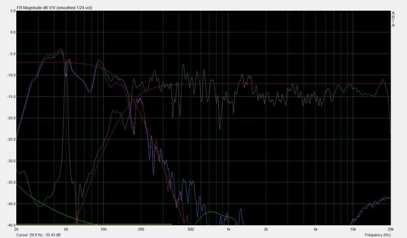

So I tried T-bass on my Beta15s with the component values I had (44v secondaries instead of 18-40, 10mh instead of 6.4, and 470uf instead of 940uF). WOW, pretty much as Graham described, evening out the dipole roll-off but with more ‘punch.’ Stand-up bass has more texture and drums have more impact—sweet!
Just for fun I ran the Beta15s full open all the way up to ~2k and topped it off with some KSN1188s I have lying around. Hmm, not bad! I did a quick measurement with my Ultracurve + ECM8000 mic and noticed that the 1.6k peak was still there. The notch missed a bit and was centered at 1k with the 1.6k peak still prominent.
I played with some sims in Ucap and changed the 10uF cap in the 1.6k notch filter to 2.8uF and that killed the peak more effectively both in sim and measurement. Wow, I couldn’t believe I was getting such good sound going through a transformer and huge coils!
Just for laughs I tried using my simple gainclone—not as much impact as my bigger amp but as long as the volume’s not too loud, not bad! Then for giggles, I tried my 1.5 Decware Zen tube amp—again not as much impact but more bass than I’ve ever gotten out of the little beast! I may try to make a T-bass system based on it for my basement room.
I’m now trying some different tops for the Beta15s; Audax PR170MO, Fostex FE164, Eminence Beta12LT, FE103, FE83 … we’ll see which one sounds best. I’m noticing a big shelf below 400Hz on all of them (baffle step on a 16” baffle?!?) so I may try to crossover there.
I’m sold on the T-bass! I may try fancy DSP later but for now this is where it’s at! So what’s the process for tweaking the T-bass circuit? Would you suggest free air or in-room/listening position measurements? How do you model the transformer (I can’t seem to find transformers in parts list for Ucap)? Are they just two massive coils? Which parts to upgrade/change first?
Looking forward to making this even better!
Cheers and thanks for the help,
Jeff

I have changed the C series resistor to 4.7 and indeed I got the missing balance back(s. below) - after some more listening I can tell that this is definitely the best bass I have ever heard from my system !
The change is also definitely a qualitative one: I have now pretty much the same frequency response as before, but it sounds so much different !
So in my case:
- Alpha 15A mounted in shallow Y-dipoles(depth about 25 cm, largish rear opening - close to U)
- C=680uf, series R=4.7 ohm
- L=Intertechnik ferrite 6.8mH, 0.26 Ohm, series R=1 ohm
- trafos:2x29V 200VA
Here's a frequency response measurement in room - measured in the middle of the room, you can also see the difference between 2.2(dark) and 4.7(lighter) resistors:
and isn't this exactly what I have been saying for so long.
The frequency response tells you nothing about the reproduction -
this because the steady sine response arises after all changes have passed and settled down to a measurable level.
Steady amplitude measurements tell you nothing about the coherence of dynamic amplitude , phase and thus timing responses which are so relevent within music reproduction !
Those who don't hear this difference simply cannot appreciate it !
