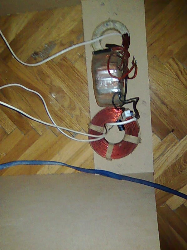

I 2 have finished my T-bass circuit. So far it works very well with Alpha 15''. However, i am using very sensitive alnico oval driver so i need extra 3db louder bass. T-bass brought some gain, but not enough.
Bass improved very much in depth and have more transient response with "groovy" sound 😀
I am using ~350V toroidal trafo with ~35V secondaries.Choke is 6.7mH and i connected 2x1500uF in line. Resistor in line with C is 1.5R. I removed resistor in line with choke.
Third ,small choke is 6db bass crossover but i don't know what value is it. It is just enough to tame mid's a little.
I drive whole rig with Zen-Mod's Babbelfish J .

Hi chakija,
Your first pic with the choke and toroid flat beside each other was just fine.
The magnetic fields were already at right angles and the second pic is wrong !
However your capacitors look small. Do go for low ESR 40Vdc rating or higher.
Also your choke might be a good air core but the resistance is probably high. Better use suitable ferrite or iron core, or sometimes the secondary of a 15 to 24V transformer will do at about 3A -check with an inductance meter.

Graham Maynard said:Your first pic with the choke and toroid flat beside each other was just fine.
Yes, because the toroid is wound different.
I returned trafo in previous position...Strangely, it sounds better this way 😀 .Graham, i will try to change capacitors with those u suggested.
