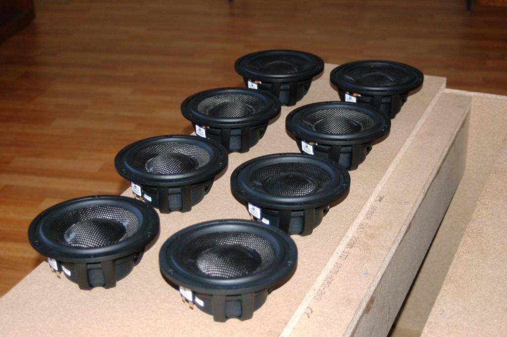

Can I ask about the "6 pcs. Acoustic Elegance TD15M in OB - midbass from 60 - 500 Hz" please?
Is OB short for open baffle?
Were the TD15M originally meant for a sealed box?
Did you put the TD15M in a sealed box?
If so why change and how does it sound?

Yes, open baffle.
Would never reach such a waterfall with a closed midbass system
At a slightly earlier stage, when there still was some trouble with the midbass, but pretty good control over distortion
..... Yes, open baffle.Would never reach such a waterfall with a closed midbass system
Your waterfall is a thing of beauty. Its so clean. So OB mid-bass reduces resonances? Seems obvious now I think about it. Thanks for the tips.
The waterfall is so good it makes 34Hz loom large. Is that from the eight PD.2450 resonating, or the six AE-TD15 or something in the room?

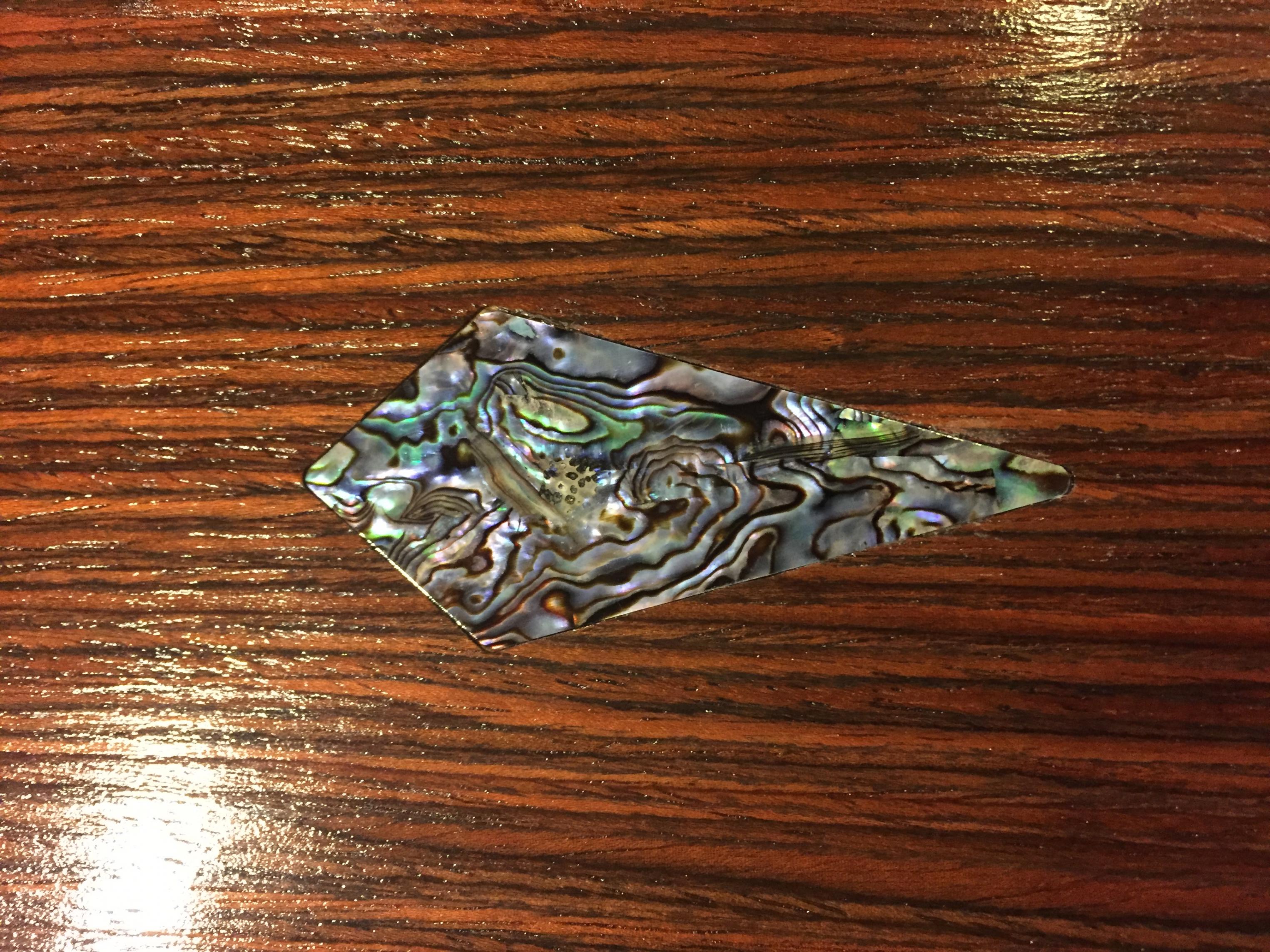

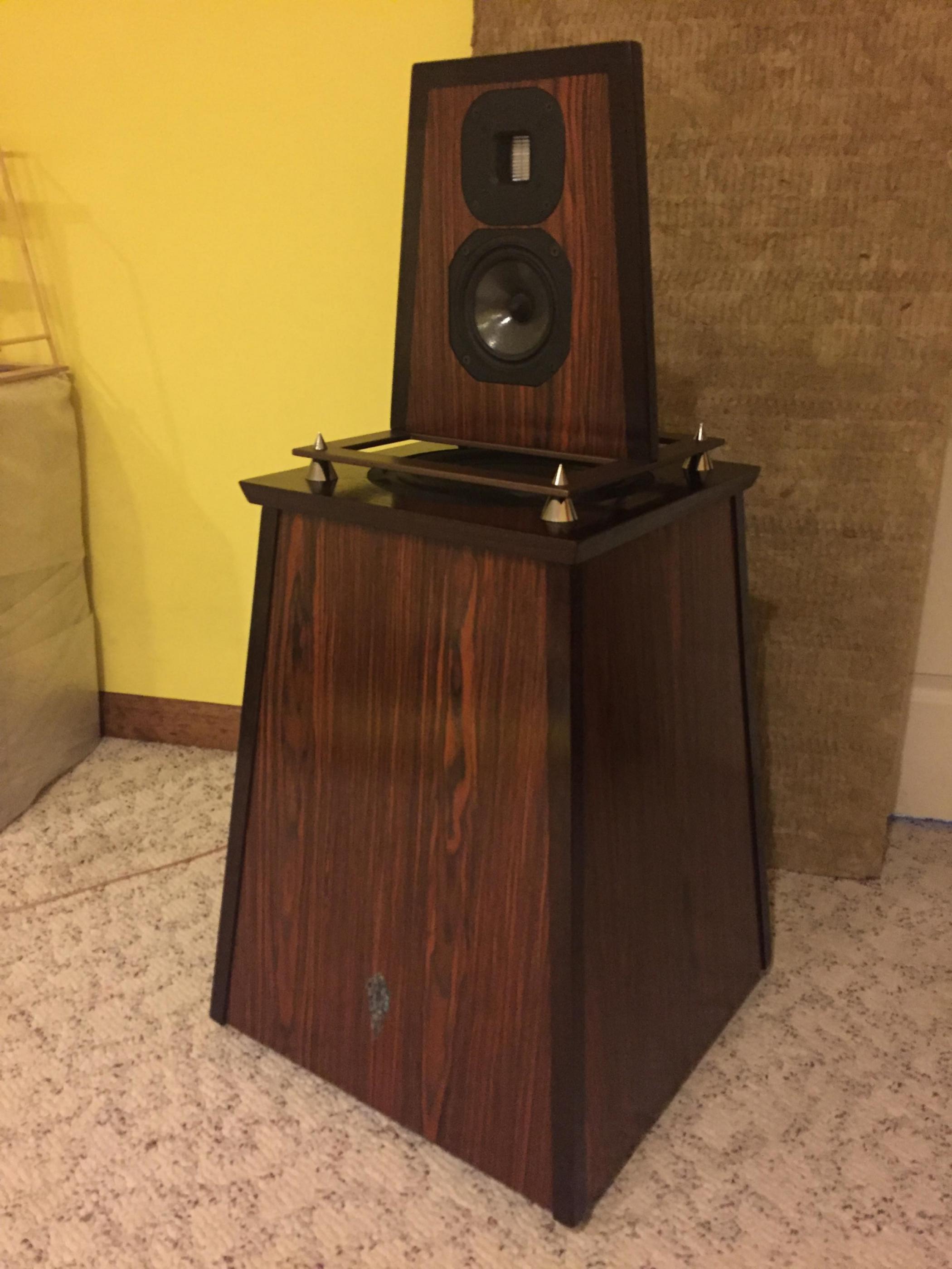

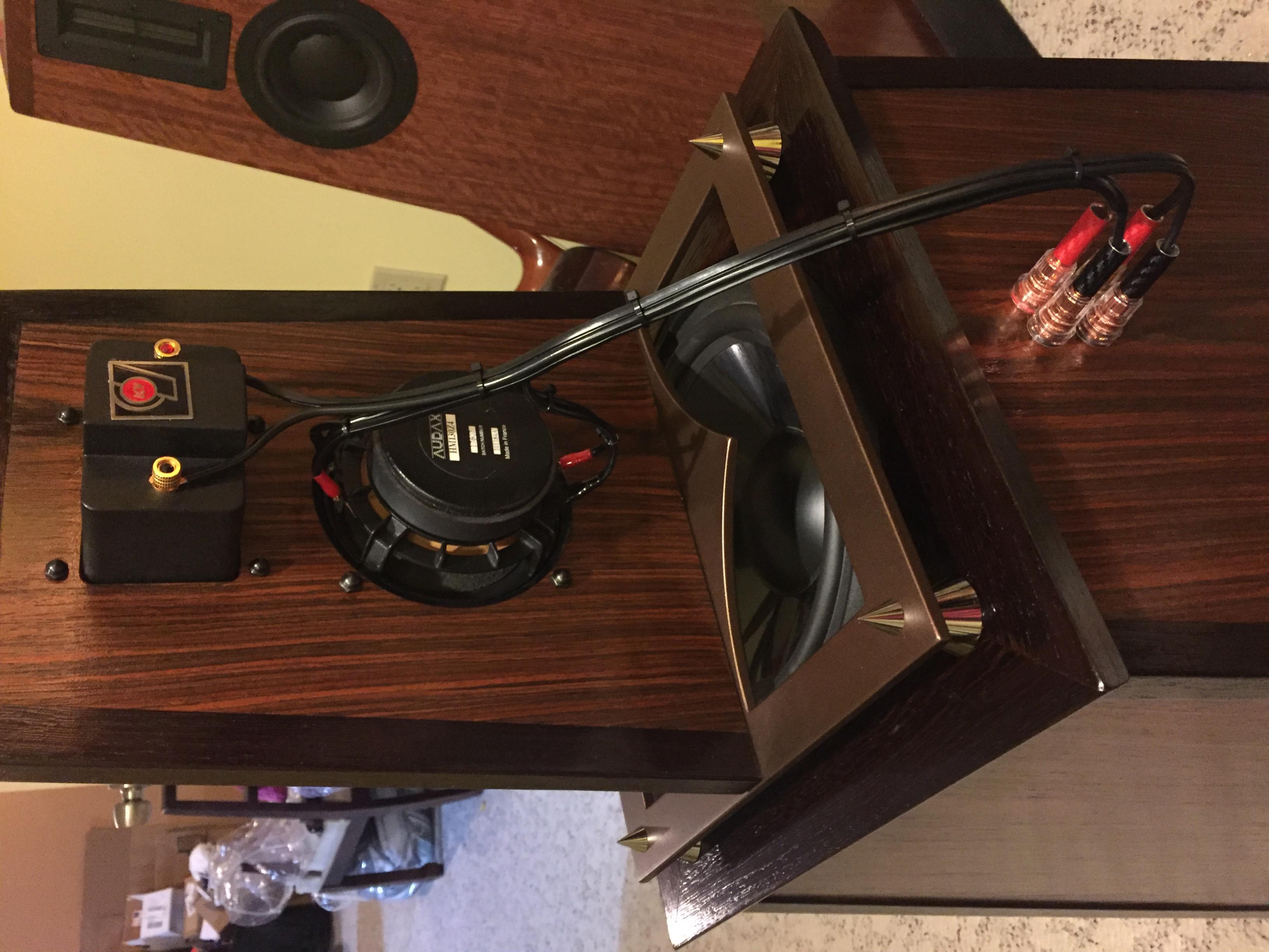

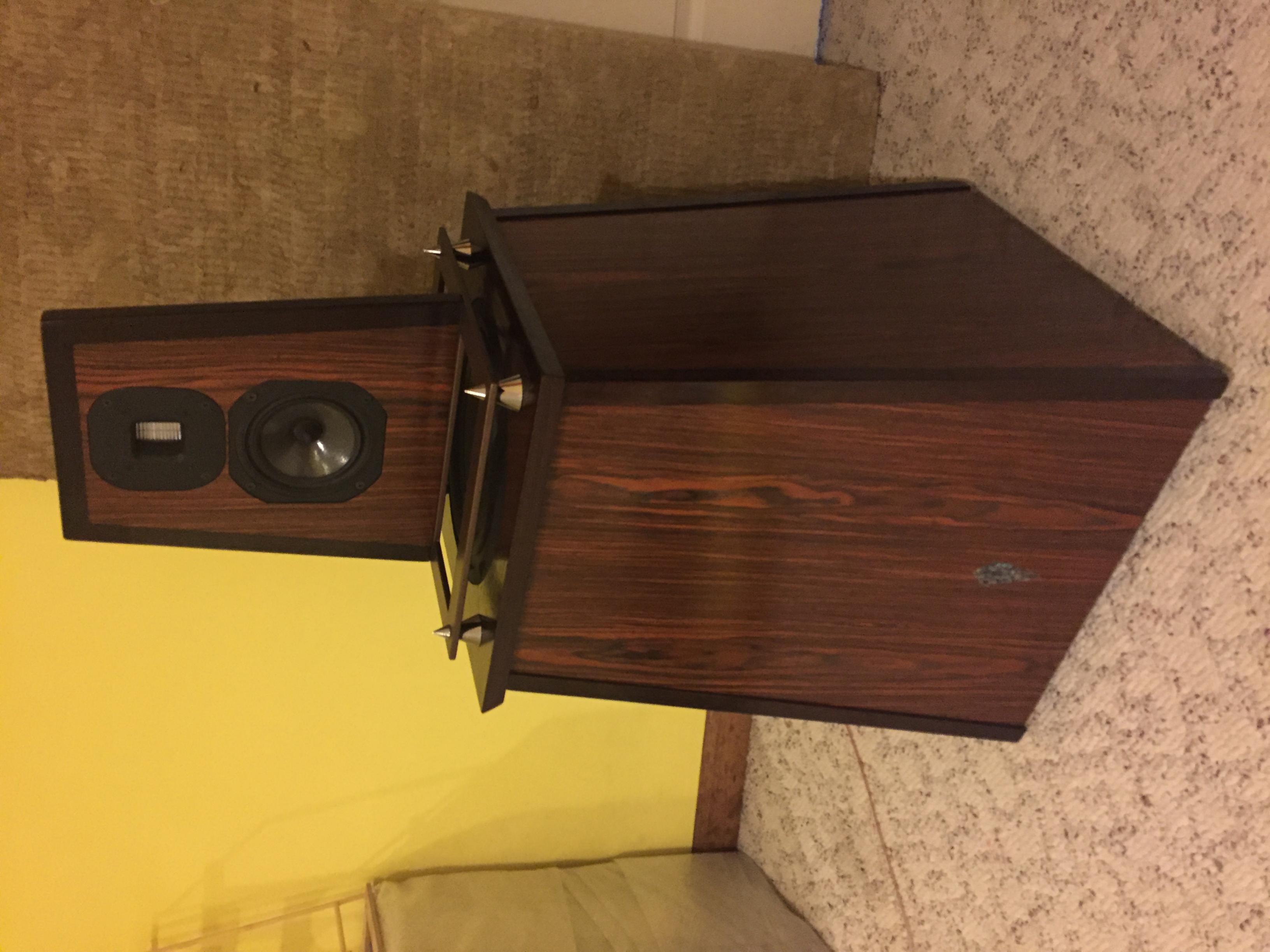

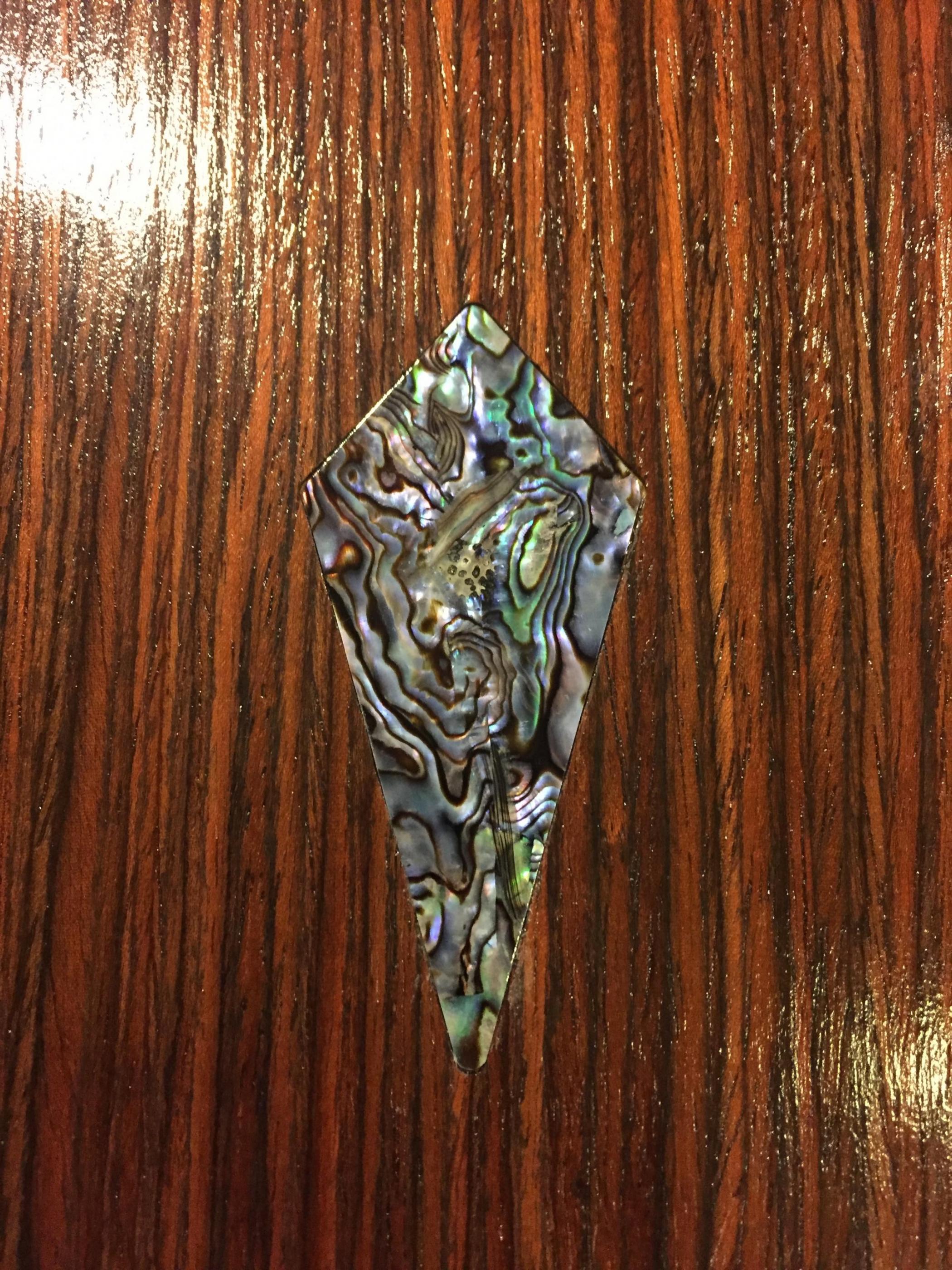

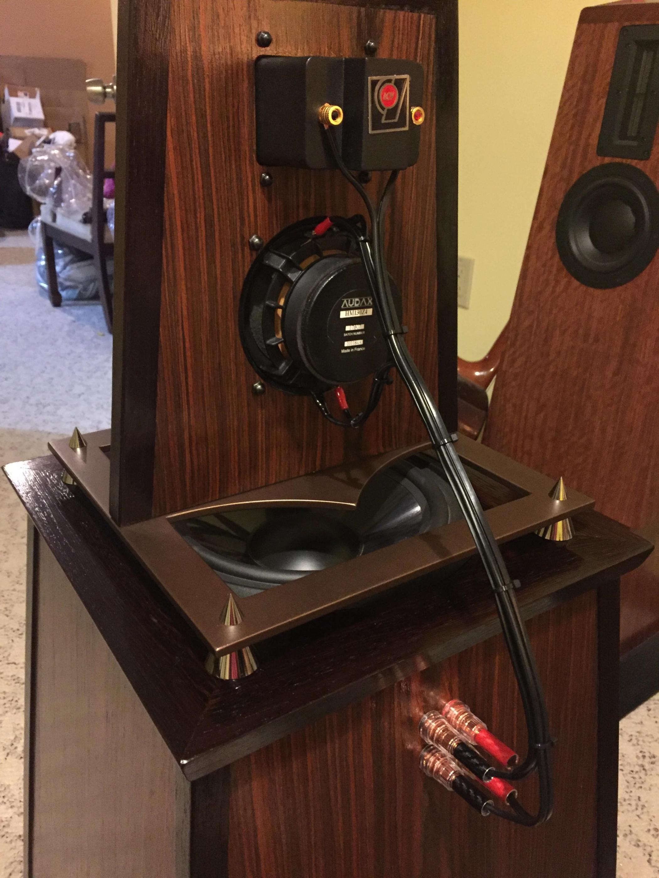

Finished this project last week. The drivers are LCY108 tweeters, HM130Z4 Audax mid-ranges, and Aurium Cantus AC250F1 woofers. The woofer is in a sealed enclosure and the M/T above it is OB. The series crossover is at 300 and 4k. Wood used is Rosewood veneer and Wenge, finished with 4 coats of Waterlox. Sorry about the pics, wish this had a way of rotating them.
The Windows Image Viewer has that option.
You have to rotate them before uploading them to the forum.😉
Congratulations for the monster.... : 🙂 😱
Oh wow, sorry, not the best at stuff like that. I feel I can build a heck of speaker, though! Thanks for flipping them around for me.

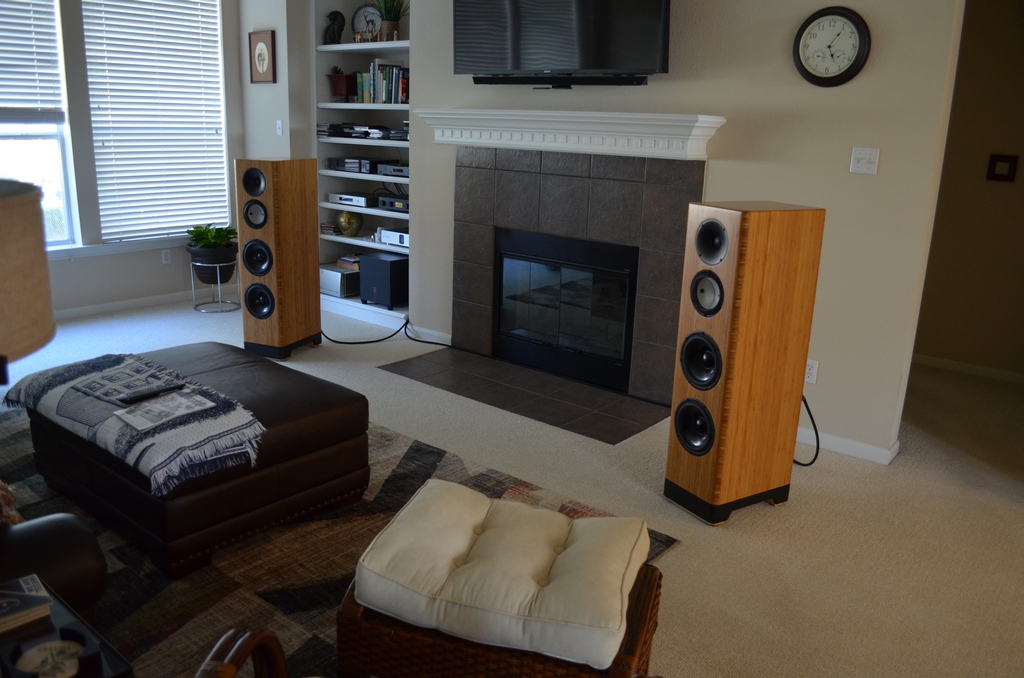

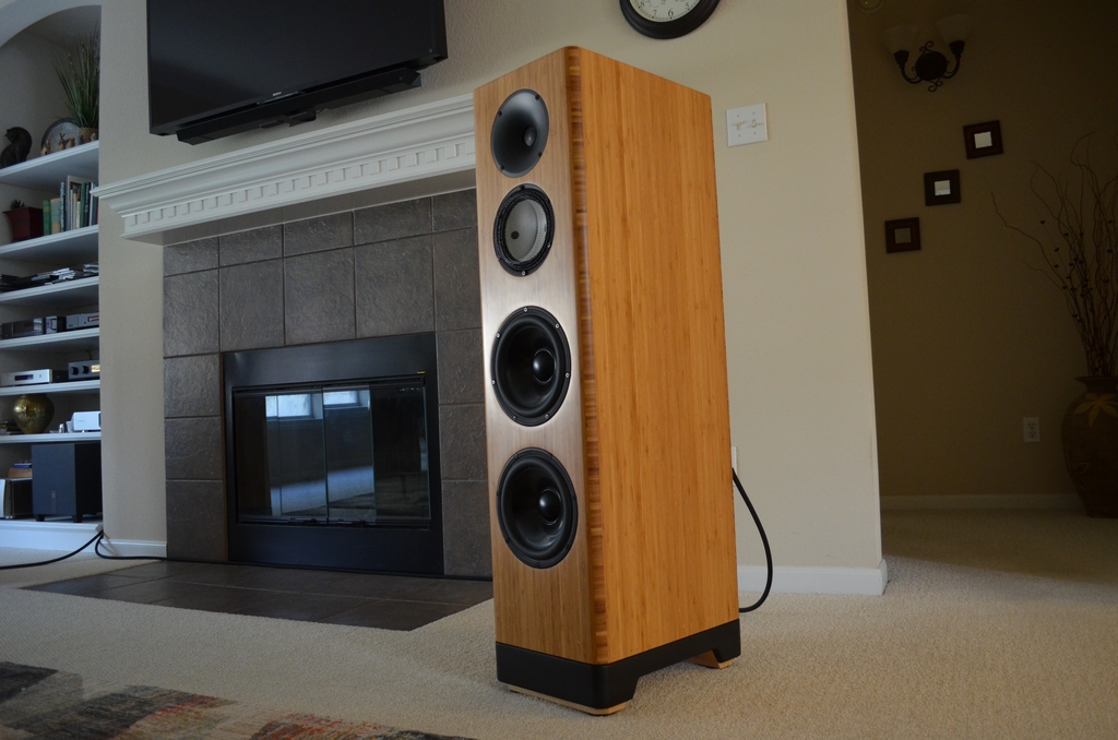

SSA-WG speaker project
I completed my speakers that I have been working on for quite some time.
A few details;
Name:
The SSA-WG is a 3-way Scan-Speak Accuton WaveGuide project.
Drivers:
Woofers: 2x Scan-Speak 22w/8857T00 (parallel)
Midrange: Accuton C173-6-090
Tweeter: Scan-Speak D3004/6640 mounted to a Jantzen Waveguide

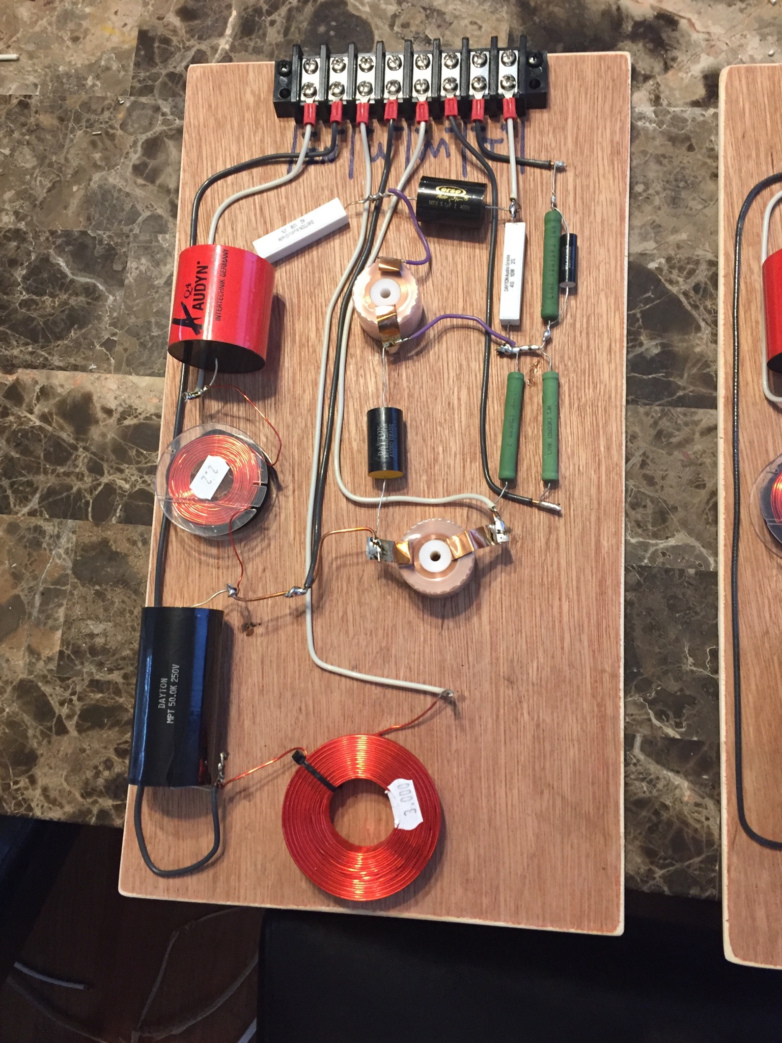

Crossover:
Duelund with approximate crossover frequencies of 300Hz and 2150Hz
Details can be found linked below
Introducing the SSA-WG
It was quite the journey. It was my first design from scratch. I used Soundeasy for crossover design. Learned woodworking skills along the way.
They sound very good.
Here's a few pics.

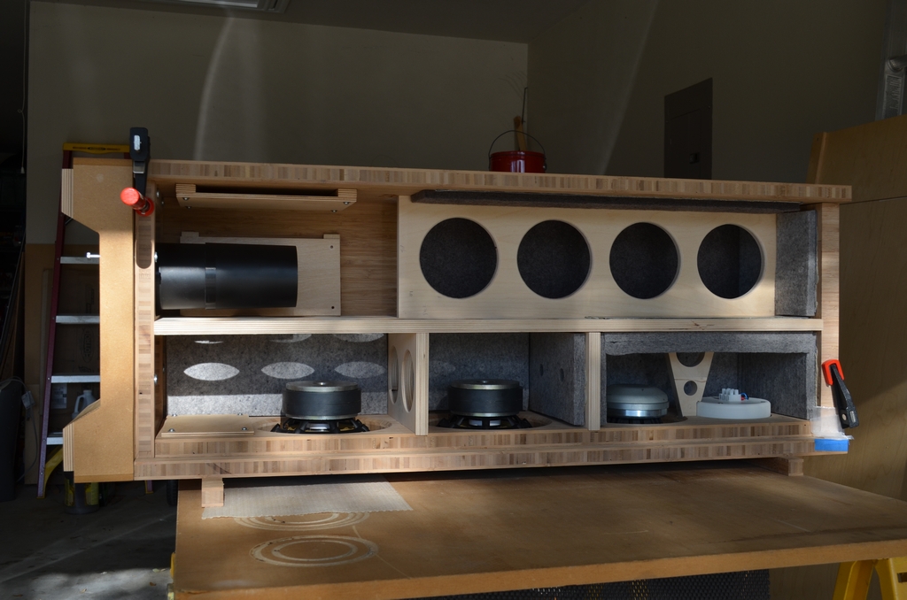

Thanks Dave, I don’t think bamboo has a grade like Baltic birch...I could be wrong. I used 1” thick cross laminated vertical grain carbonized bamboo ply. There were some small voids on the edges I filled with epoxy. Hearing from others it’s kind of hit or miss on the consistency.
Scott
Scott
It does, it comes in horizonatl, vertical, and stranded varietes. I do not recommend the horizontal, probably not as good (but not as pretty) as good BB. Vertical is what i find most used, stranded thou is better by a long margin, and has a much tougher surface as far as collecting dings goes.
dave
dave
I used the vertical type and that's also what I have seen most used. It's very hard, you need good sharp tools. Really no dings during the build. Here's a few pictures. The top is stacked end pieces to highlight the bamboo ends. I find it an excellent material for speaker building.
Thanx,
We have used both vertical & stranded, the stranded is something else. The vertical is still very good.
dave
dave
