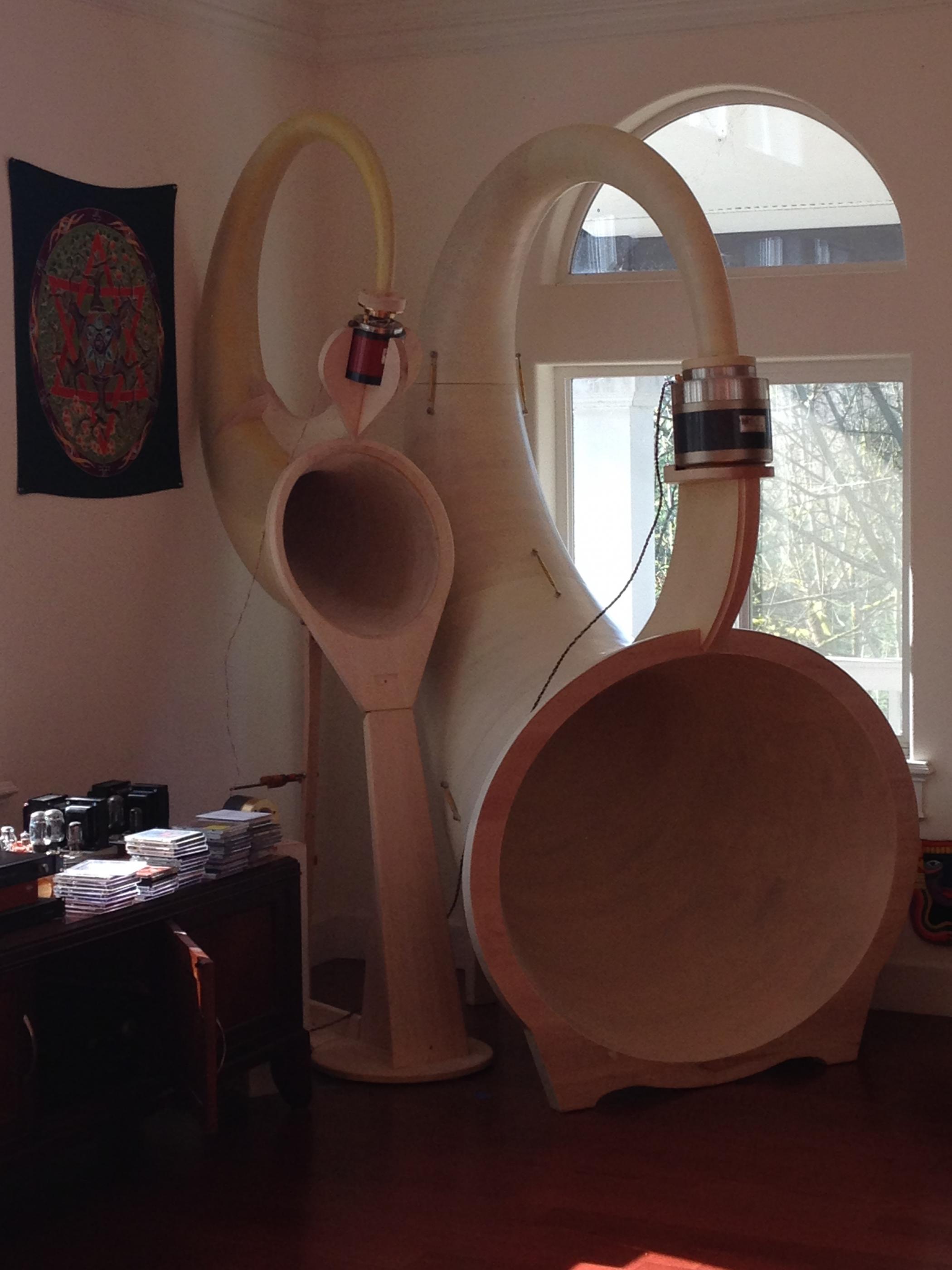

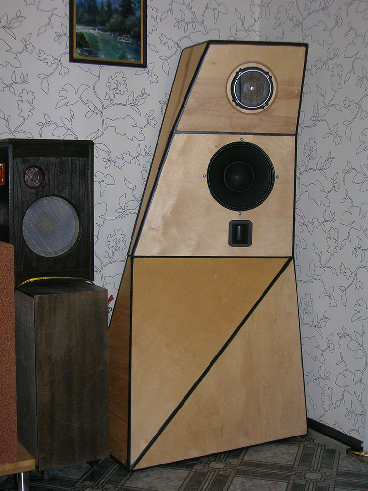

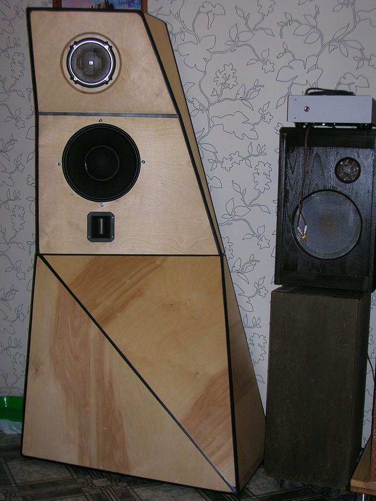

Here a three way horn system I'm fabricating. The larger horn is a bass/mid bass unit (50hz to 250hz), the smaller horn in the upper left is the midrange unit (250hz to 6000hz) and the tweeter horn is a sweet sounding Fostex.
The midrange horn is paper mache. The bass/midbass horn is solid maple. The drivers are Ale.
Amazing work. But the horn mouths, shouldn't they be bigger? I use a hoen from 440-2000Hz and the mouth is about 80x50cm. Any measurements?

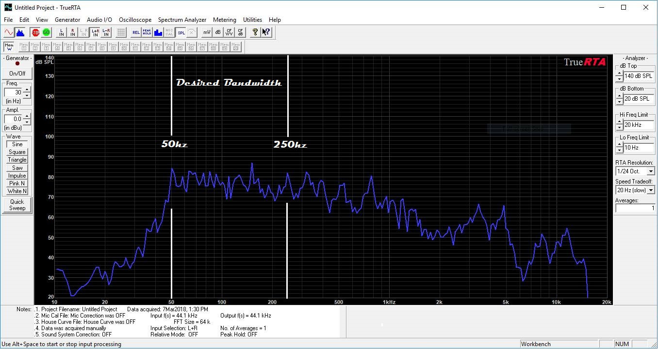

Here's an RTA of the bass horn. I don't have one of the midrange, yet.

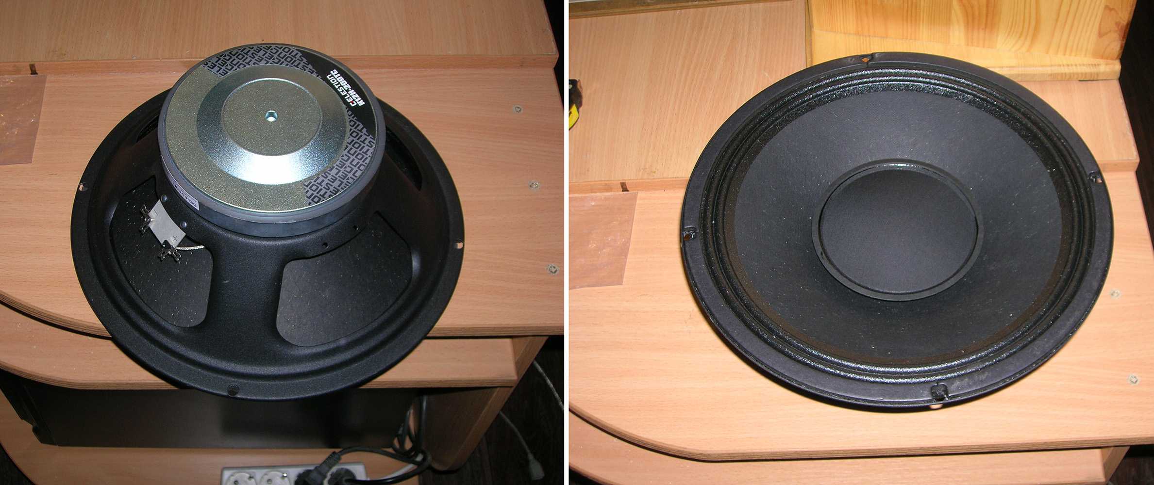

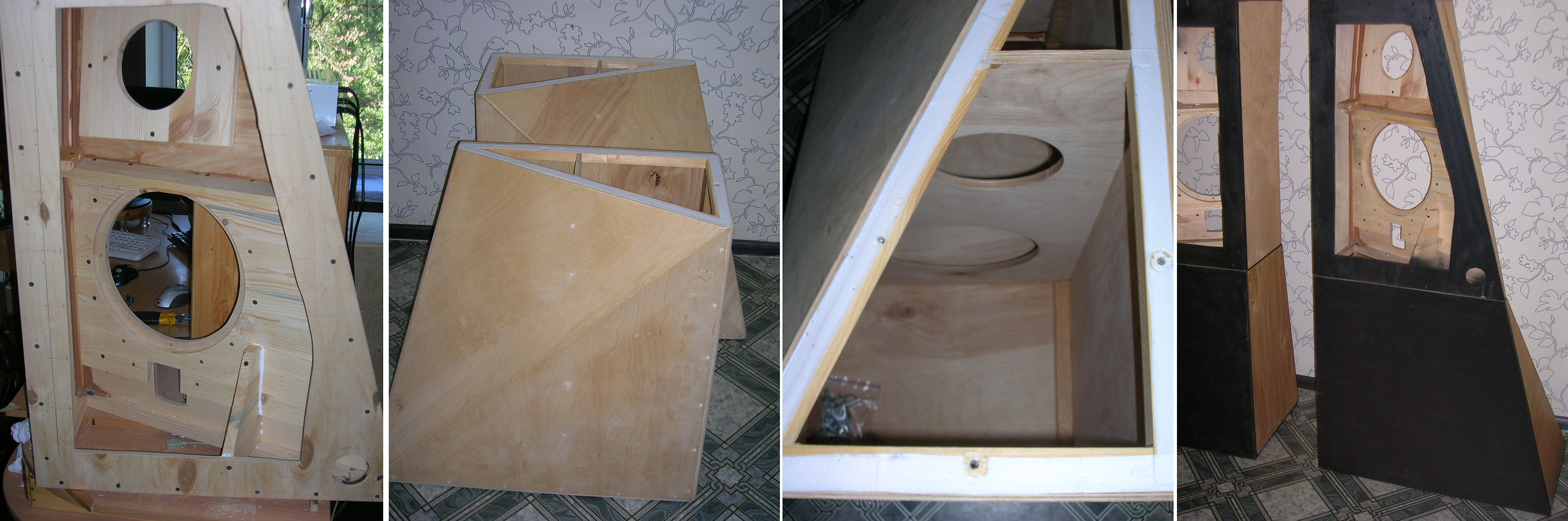

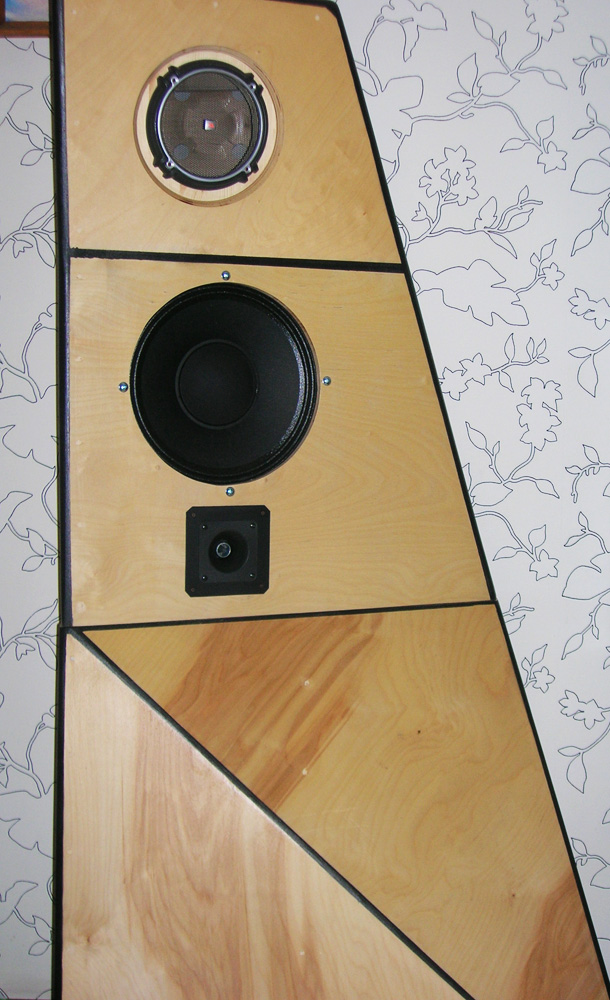

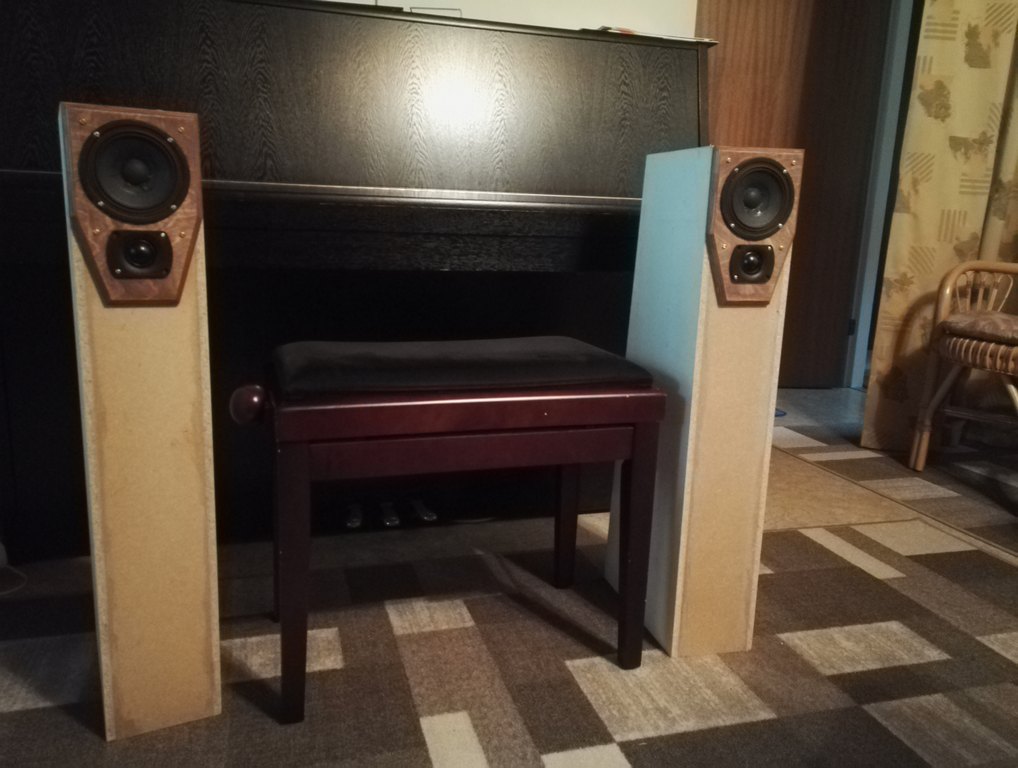

Celestion K12H-200TC (on a full range) + Fountek NeoCD3.5H (above 10 kHz)
Bass reflex, сabinets 190L.
Amazing construction!
How did you fabricate that?
Do you have some pictures of the process?

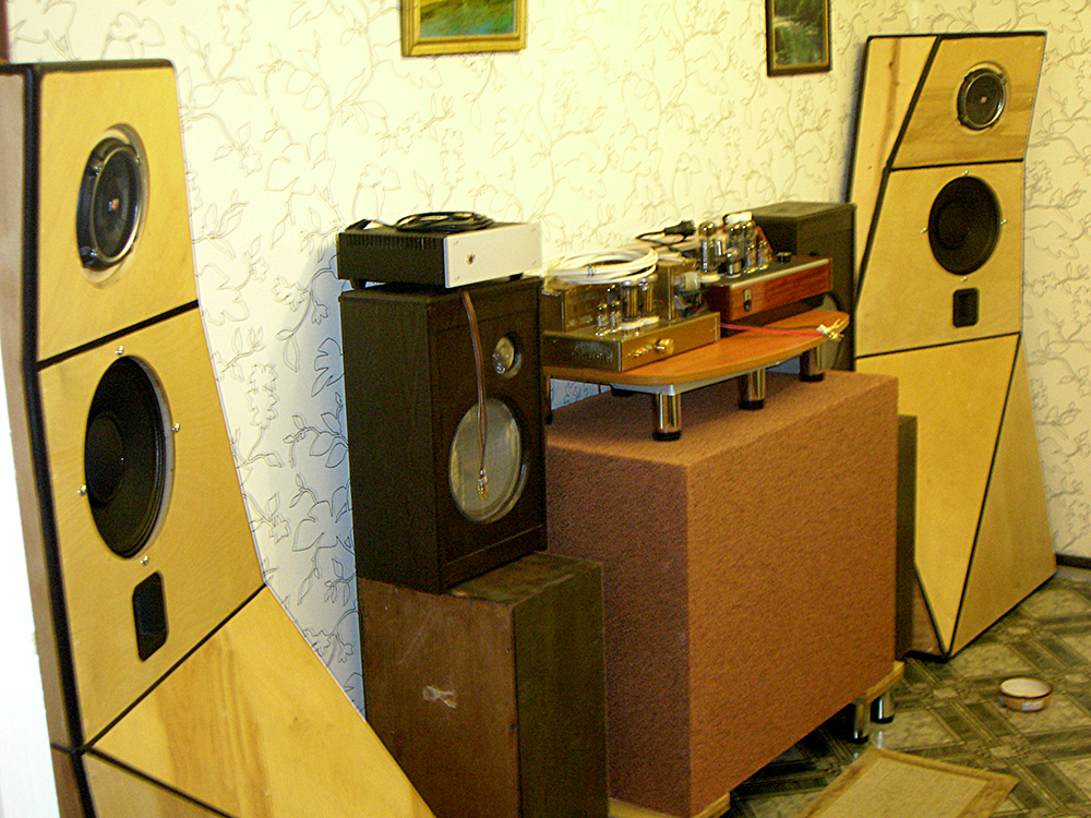

2 ways / full horn.....
Nice work. The floor concrete bass horns with Altec 515 sound great. How low do they go?
Looks like a lot of work. Well done.Celestion K12H-200TC (on a full range) + Fountek NeoCD3.5H (above 10 kHz)
30 Hz -3dB, 50 hz 0dB
At the moment, the system uses one TacT RCS and two TacT 2150s. The filters are located in the DSP of the amplifiers.
As they malfunction a little, today I'm going to try a Benchmarkk DC1, a crossover Rane Ac23, a Crown XLS 1502 for the bass and a Hiraga 8w for the medium-acute.
30 Hz -3dB
