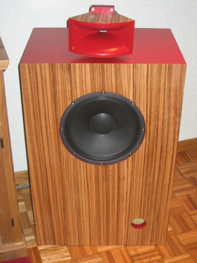

BigMacX said:
Here's a pic of my speakers, built with some help from people on this forum. No prizes for guesssing what they're copies of....
Pics
Mac.
Really nice speakers !! 🙂 It must sounds very great ! 😉
The tweeter is the Foal TC120 TDX or TD5 ? I use the TD5 on my Focal speakers, and I heard everywhere that the TDX was better...
The mid unit is a SEAS driver, isn't it ? (P17RCY/P ?) How does it sound like ?
The bass units seem to be some Peerless ?
What about crossover ?
Vincent
