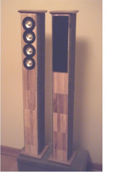

My next diy step
Some things just logically follow others. My earlier system (posted to this thread) just used one wide-band driver per side. This system uses four per side in a transiently aligned array. The core of the enclosures are extruded plastic fence posts (5 inch by 5 inch and one-quarter inch thick). Three sides are covered with glued on carpet. The front baffles are glued on parquet. I just wanted to get away from the look of monolithic wood. The next step for the wood front baffles are to align the little pieces of wood with a running bond. The tops and bottoms are three-quarter inch oak. While the plastic fence posts vibrate differently than wood, by themselves they are not better. With the laminations, the construct is less resonant than three-quarter inch MDF.
While I will never achieve diy perfection, more of the driver parts are of my construction than previously posted. Next step here is to make my own baskets.

Dont they look the same ???
yeah pictures mark picture 😀 lol

I've seen those 7V-style 4-driver mini-arrays being done for quite a while now. Don't you get insane comb filtering? What is the theory behind these that helps it not sound like crap?
Greetings,
A few details about my earlier, narrow tower, 4 unit verical arrays. On an earlier system posting I showed the modified (really remade) W3-881S. That remaking was part of a project to build my own 2-inch cone driver. The drivers pictured here are mid project prototypes. They are constructed from a structured poly substrate with a powdered metal veneer.
The "7V" style (what does "7V" refer to?) 4 unit vertical array is physically aligned not to comb filter to the highest reproduced transient at the listener position. The top and bottom driver in the array are stepped forward just a little bit (at my acceptable tolerances a critical measurement) . At the listening position (sitting), the 4 drivers are coherent. They even measure coherent at a 200 kHz sampling rate. The drivers have long since given up meaningful reproduction by 100 kHz, but there is no comb filtering. There is interference above and below the listening position, but it is only at the very highest frequencies and the off-axis response of the driver is down in the region of interference. The drivers are also matched octads. There is virtually no difference in performance amongst the eight drivers (1 db or less). This makes the measurement of the far field array performance an easy task. The arrays also sound no different than one unit at the listening location. Except, of course, that they will play more loudly than is good for my ears. And when the music and recording is good you want to keep turning the sound level up until it is as loud as it will play. Playing loudly is the only reason to begin arraying these little, nearly full-range drivers.
The posting, however, was really about the array alignment, the cabinet construction, the parquet front baffles, and one interpretation of DIY. Different looking, easily constructed since the core is a readily available extruded plastic fence post, and once layered, less resonant than typical wood construction. Just add a little baffling and some fill inside to break up coherent reflections and you have a superiour enclosure for very little cost and not much more effort.
Since that posting, my next step has been to construct a jig and to assemble three running bond parquet front baffles. Now I just have to cut them to length and veneer them to the front of some enclosure cores. The next step beyond that is to use woods of higher contrast, use some cross grain sections and begin to mosaic the front baffles. Carpet selection, of course, is a matter of aesthetic taste and is easily accomodated. They do, however, look too much like a scratching post and so may not be suitable for households with cats.

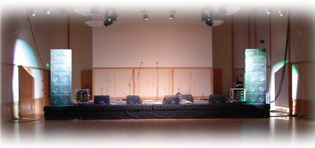

Here is one of my rigs
you have more? lol.. wow.. that looks nice. You in a band or do you sell setups like that?
MarkMcK said:The "7V" style (what does "7V" refer to?)
Seventh Veil (A member here, and apperantly the name of their company), aside from that no ideas 😕
I was referring to the 4-driver mini array that I first saw widely used by Seventh Veil, first in the System IV and then in the Nonsuch 4.
