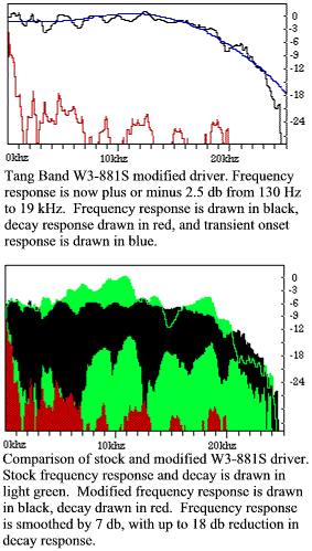

The stock W3-881S has some problems. Most egregious is too much unit-to-unit variance in performance. The driver’s frequency response needs to be rated at plus or minus 6 db. Yet the 12 db of total frequency response variance is never the same from driver to driver. Beyond that, the common characteristics are a rising response peaking between 8 and 12 kHz and then generally rolling off above that. Onset response is not bad, although showing unit-to-unit variance and showing the rising high frequency response. Decay response is not nearly as good.
Despite these flaws, the W3-881S was the best of the small diameter cone drivers I tested. Because of their price, now well over $100 US each, I do not include the Jordan 53 or Bandor drivers in a comparison with the $14 US W3-881S.

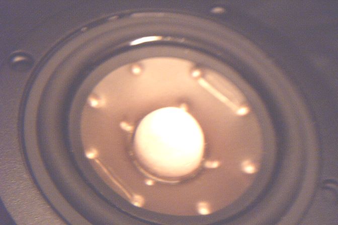

Polypropylene is a marvelous plastic. Its semi crystalline structure allows one to manipulate the characteristics of this material as you can no other plastic. Combine this with the chaos theory and you can devise techniques to control cone resonance with only small changes in beginning conditions. For me, this meant heating small sections of the material to slightly below the melting point of polypropylene and dimpling the surface at critical points. This modification, accounting for over 80% of the improved performance, consists of 16 small dimples whose combined area is only about 2 % of the total area of the cone. The custom “phase” plug and two small beads of glue measuring 5/8 inch by 3/32 inch near the outside edge of the cone completes the last 20% of the improvement.
After modification, the driver’s frequency response, even using the highest resolution testing and no smoothing, can be rated from 130 Hz to 19 kHz plus or minus 3 db. Many of the drivers will measure plus or minus 2.5 db. Of course, when no driver varies by more than 6 db, there is less unit-to-unit variance.
While the flat and more consistent frequency response is important for tonal balance, the real improvement comes from decay reduction. From 7 kHz to 20 kHz, the decay reduction is close to a 20 db improvement.

W3-881S mod
I hope Dave was talking about my little system when he asked for a driver close-up.
Once the drawings (I hope to have some help from a 3D CAD pro this weekend) and writing is done, I plan to submit a manuscript of the modification procedure to AudioXpress. I don't want to go into too much detail until the manuscript is accepted for publication. If it is rejected, then much more detail will be available immediately. Otherwise, die temperature, dimple placement, and plug shape are all serious but not critical items.
Well, maybe they do tend more toward critical. It does take a modicum of skill to properly stress the polypropylene skin during dimpling and the plug profile that Tang Band uses is not the optimal shape.
From the attached picture you can get a good idea of the dimple placement and where the two glue lines are placed on the underside of the cone.
I apologize for the fuzziness, my focus depth is really shallow at this distance.
