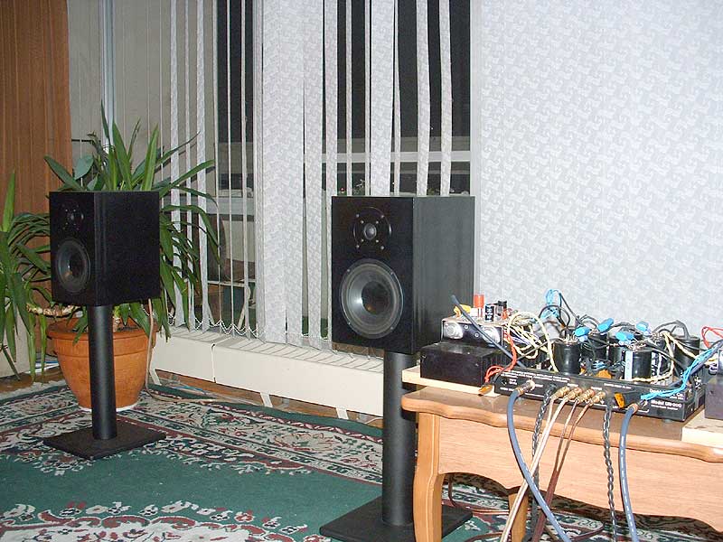

Here are AR (audioreview.com) DIYs from Ed Frias. Broke my a$$ making the 3/4 mdf piano finish cabs for these babies. These are my first and the only ones (so far).
Sound comparable to $1000+ speakers on the market. Spent: ~$300
On the right is a Hafler DH200, now upgraded with dual-mono PS and Musical Concepts PA3-A driver boards, Blackgates, etc
Cheers
Alex
link to the pic here

I'm sorry Alex but geocities doesn't accept direct links and we won't be able to access the picture with the link if it is not properly stored in a webpage.
yep I just realized that,
however, if you click on the link and then in the newly opened IE window, get rid of the "http://" part of the pic's URL, the pic will load up.
So thats the workaround. 😉

yes but its over transfer limits, email me koolscooby AT zoominternet DOT net the picture and i'll post it on the web for you... (on my server)...

EDIT: Hmm, the pic in my original post seems to load up now! - very strange - sometimes it works, sometimes it doesnt

With a little moderator intervention... the pic is now embedded into the didyaudio database 🙂

No problem, it goes for anyone, if you need pic/pics posted, email them to me 😉...
http://picturehost.koolscooby.net/pictures/For Members of DIY-Audio/DSCF0107.JPG is the one for this post
[edit: looks nice! 🙂]

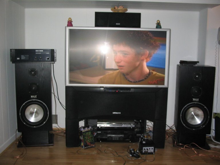

DPW666, may i ask wht drivers you have in your main speakers, they look lie AV12s in the bottom and vifa D26 tweeters but cant see te mids clearly, what are the and what are all your XO points..
very nice by the way.
regards
michael lane

Hi Michael
You were right on the tweeters. They are Vifas D26. The mids and subs are made by the same canadian company. You can see the subs and specs at www.maxspeakers.net . Look for the Caliber series. I have the 12" 4ohm model. You wont find the mids on the website but they are very good quality with an aluminum bullet dome. Tweeter is cut at 3400hz midrange at 500hz and sub has no crossover since the power amp already has a lowpass filter set at 500hz. The box is made out of 1"mdf. We cannot see well on the pictures but the edges are rounded. Is finished with those rolls of vinyl that looks like real veneer and gives a "store bought" look. Total volume of box is 2.2 ft cubic with a rear 4" x 8" port giving me about a 38hz tune but I don't remember well. I should redo a simulation in winisd.

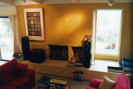

Here's a picture of my main system - a Cambridge Audio A500 integrated amp and D500SE CD player (interconnect Audioquest Topaz), feeding Monitor Audio MA-202 floorstanding 2-ways and Mirage BPS-150i subwoofer.
Note Beatles shrine on/near right hand speaker!

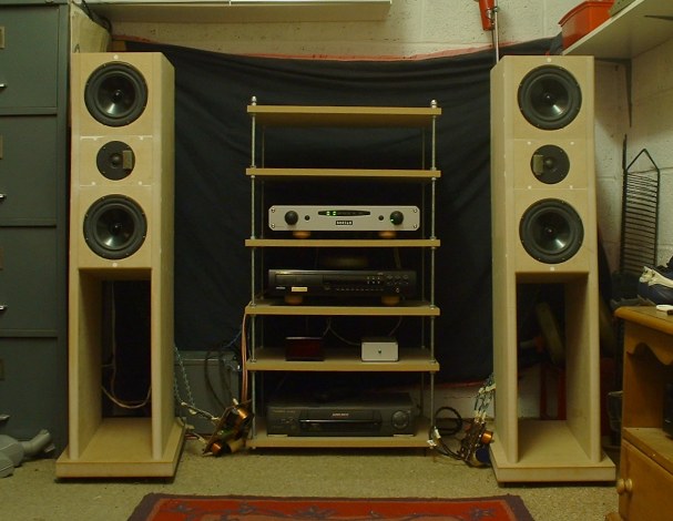

I'm slightly ashamed to show my system, because its all such a mess!! I never finish anything, as long as it sounds good, but surely one day I will find the motivation to paint the speakers...
Seen in the pic is:
amp - Roksan Caspian (with added psu caps)
cdp - Marantz CD63ki with new opamps, clock, damping etc..
speakers - Seas Pontus kits (x-overs are becoming external, as seen!)
cabling - Kimber 4PR and 4VS (internal) and Crystal-Cu IC
mains - iso. transformer for amp, cap filter, stripped out Belkin w/braided cord
Not in pic - ported 250l Tempest sub (~20-50hz), cinema stuff...
The sound: finally quite happy, because rewiring with Kimber has removed the harshness I suffered. There is just a slight richening and over fatness at the bottom end, but that's ok 🙂
