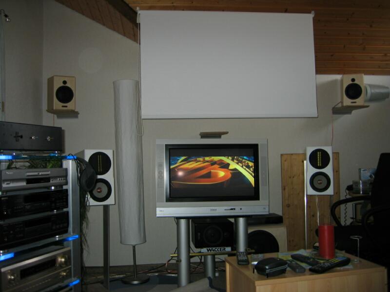

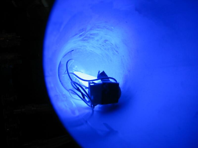

my current setup
I'm German Student,
This is my actual setup, now I'm almost pleased. I investet lot of my hard earned money and many time in it.
All Speaker's are Selfmade with the exeption, that the front Maestro was rebuild, with orginal components from the German Firm. The Tower is made by myselfe to. The blue light comes from a neon lamp in the pipe at the back.
The white one for stereo with an own amp ( Sonus Faber Musica), and the other ones for D-Digital...
Greethings from Germany , Andi
I'm German Student,
Ps. for the nice finish, I need about 5 tries ( fist they were black , then ugly and now ... you see 🙂

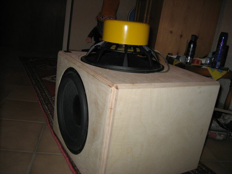

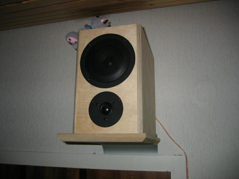

Raami's Woofer
Raami, does the front of your Woofer cabinet not start vibrating? Since it is only fiber/polyester, with air behind it, it may start vibrating along with the chassis.
Why don't you fill the space with sand or something.

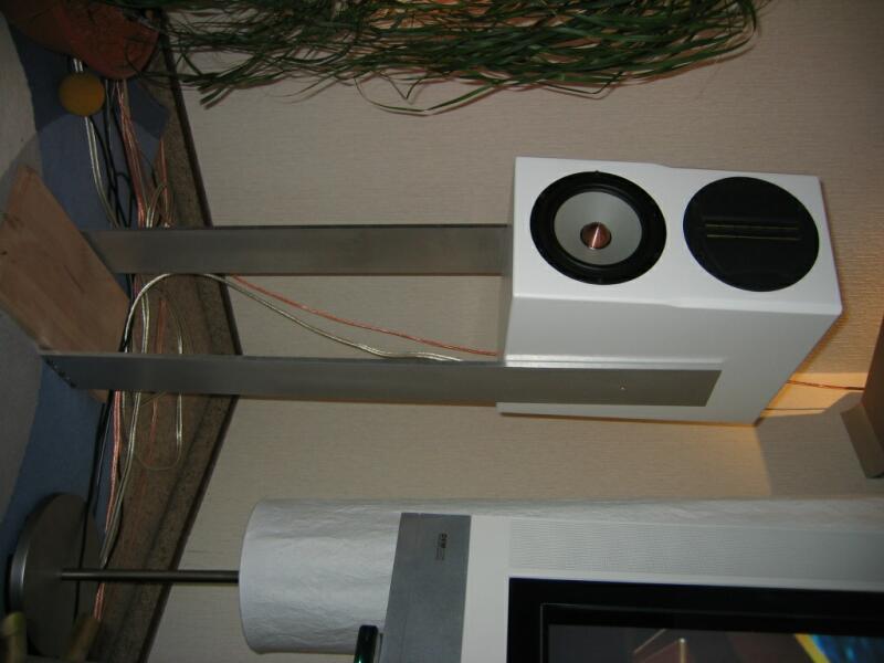

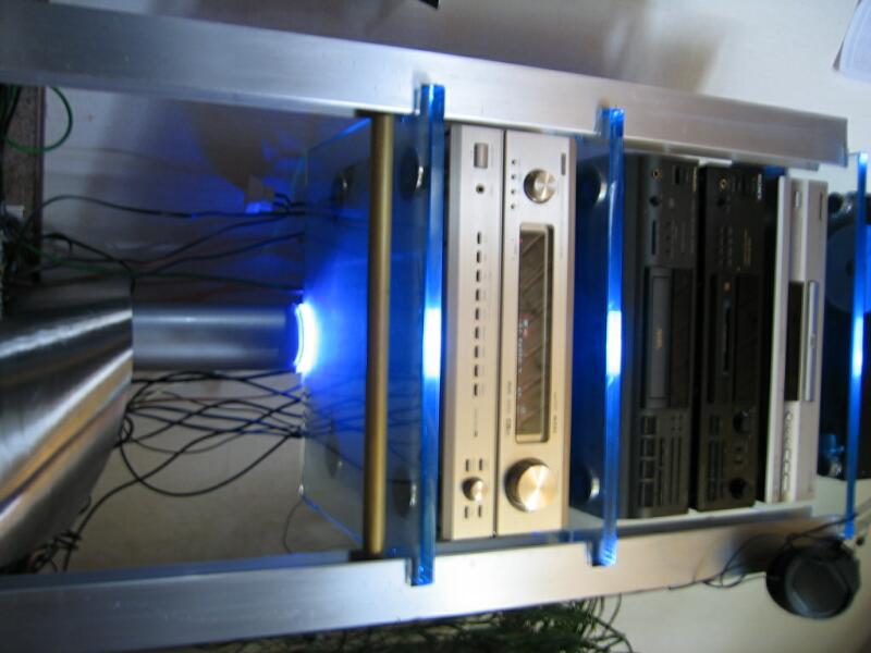

tab30,
I really like that rack! Do you have any more details or pictures of it? Any tips on constructing something similar?
tab30,
So, you have the two rectangular legs supporting the front and the single pipe supporting the rear? Are the pipe and legs aluminum? And the shelves are acrylic?
Re: Raami's Woofer
I had that same thought in my mind too, but I decided to try it first without sand. Result was that it doesn´t vibrate at all, because the fiberglass layer is quite thick and the layer is not be directed to sthraight pressure from the elements because of MDF wall. I have still possibility to fill empy space with sand, just by taking off both elements. I have also empty space in the bottom of the cabinet which I can also fill with sand. But anyway, time will tell what improvements I`m going to make because there is always something to improve!
And thanks for You all for motivating comments!
hotsyflotsy said:Raami, does the front of your Woofer cabinet not start vibrating? Since it is only fiber/polyester, with air behind it, it may start vibrating along with the chassis.

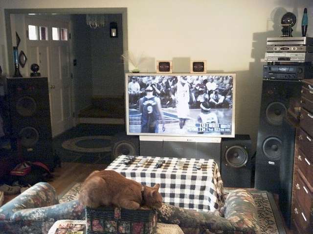

hi all! been lurking here for a while. just thought i'd post what i have done in the DIY world.
i have owned a pair of New Large Advents since 1977. last year i took them apart, and using parts bought on ebay i built myself a pair of double advents. the enclosures are 18 inches wide, 4 feet tall, 14 inches deep at the base, and go up vertically for 12 inches, then taper to 10 inches deep at the top. each woofer is in its own sealed chamber, one slightly smaller, and one slightly larger then the original cabinet. trying to avoid any response peak doubling. the tweeters are mounted near the top, side-by-side. i know, a terrible idea. but i mounted the outboard tweeters at about a 40 degree angle, facing the opposite side of the room. kind of an enhancement on the toe-it-in idea. makes for a very wide sweet spot. the components are wired up using the original crossovers, and the original binding posts are available on the back. i have wired them up in parallel, which the Kenwood VR6070 drives just fine.
for movies, i bought an advent audio focus center channel speaker, but i was not thrilled with it. so.... back to ebay! i bought two more sets of large advent parts, and built a center channel "system". two woofer modules, one on each side of the panasonic 53wx53 RPTV. and i mounted the tweeters in maple blocks, sitting on top of the TV. NOW movies sound amazing!
i painted the enclosures flat black, and then sprayed them with granite paint, black with white and grey flecks. very textured. very different. i made grills for the tapered doubles that hang in free space in front of the drivers, so you can not see the angled tweeters. gives the speakers some very interesting lines, visually. no grills for the centers yet, but they will just be stuck on the front of the boxes.
so far, so good. comments are welcome!
sm.
