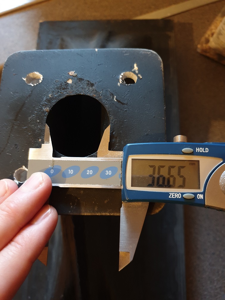

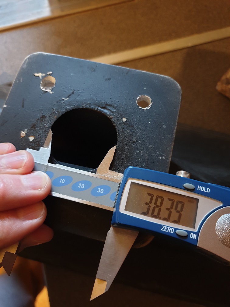

Just to clarify, you also think the 2450J is a poor choice both with this horn and with my proposed woofer set up? I'm genuinely interested in your thoughts 🙂
The actual aperture dimensions come in at: 38.4 x 36.7 mm.

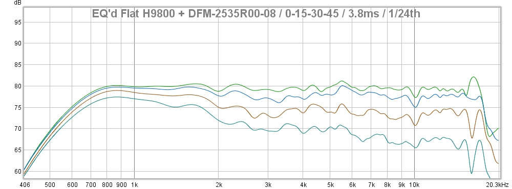

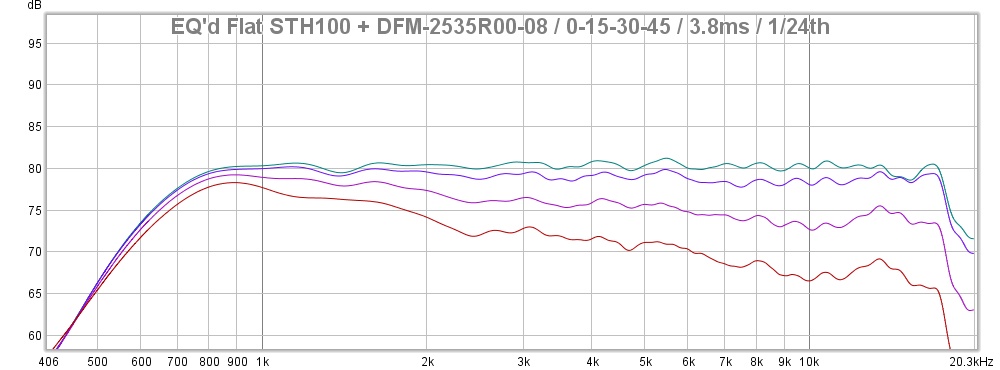

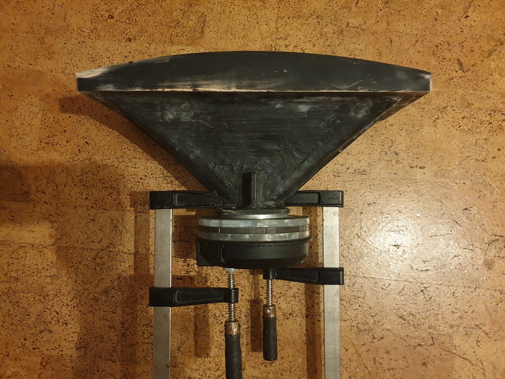

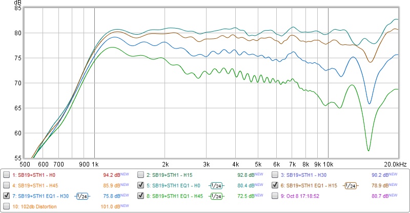

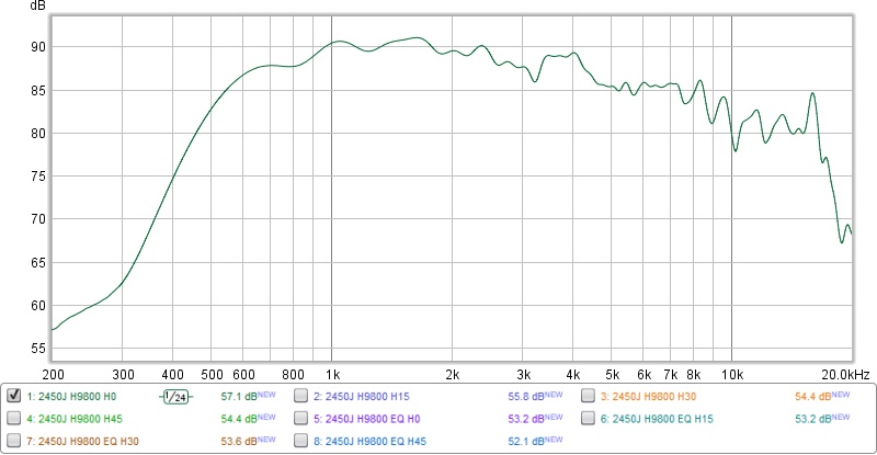

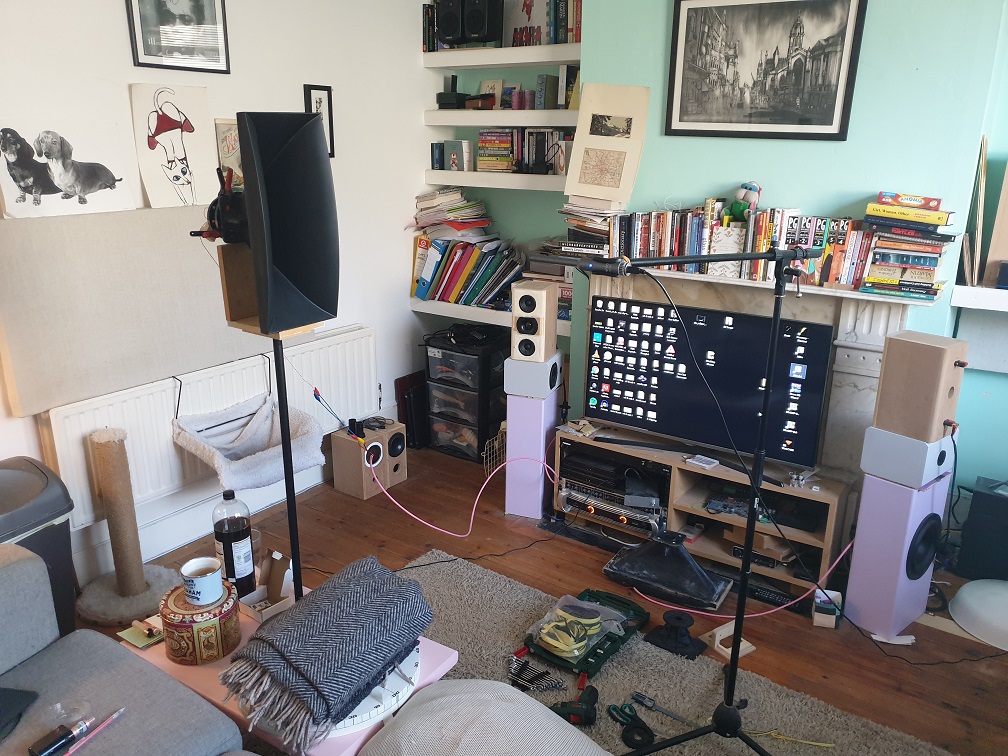

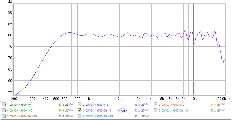

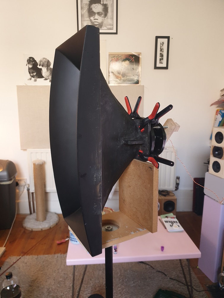

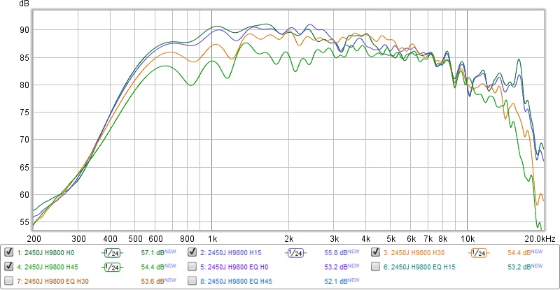

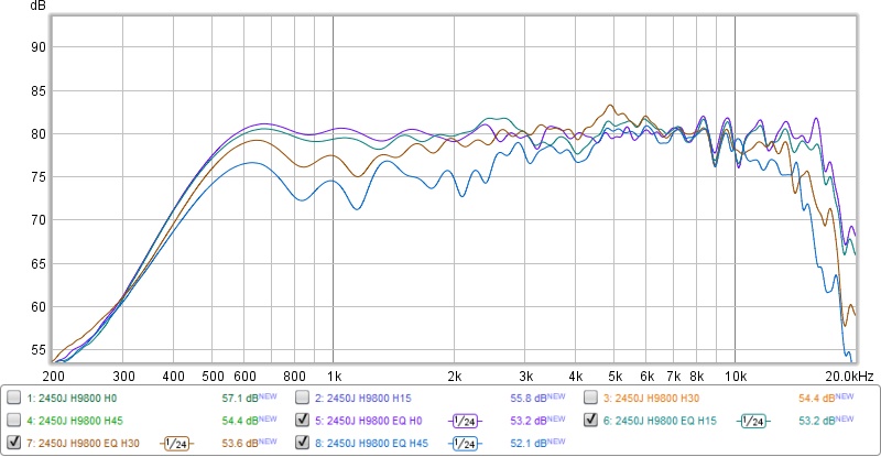

More Experiments:
2450J Snout Removed and mated to H9800 horn @ 1 metre (wife was working so I couldn't do 1watt) Gated at 4ms.
Clamped to horn.
Flatness is merely to provide information about off axis response.
Raw 0 Degrees
Raw 0-15-30-45 Degrees
EQ'd Flat 0 Degrees
EQ'd Flat 0-15-30-45 Degrees
Clamped to horn.
Raw 0 Degrees
EQ'd Flat 0 Degrees
Oh, OK. Seems like a 35.6mm ( 1.4" ) adapter could be a challenge to make work ( ie; smooth out the transitions ) .
Thanks so much for posting those.
Your measurement seems similarly confused ( in it's polar response > which was Horizontal I presume ?? ) to this ( Horizontal ) measurement made by POS ( of a H9800 driven by JBL 435Be driver) .
Orienting your horn vertically ( and then measuring horizontally for new polars ) should mimic the following response ( also from POS );
Polars ( as seen immediately above with such nicely delineated//separated polar traces ) will offer very good speaker imaging and that should go a long way to making your project worthwhile .

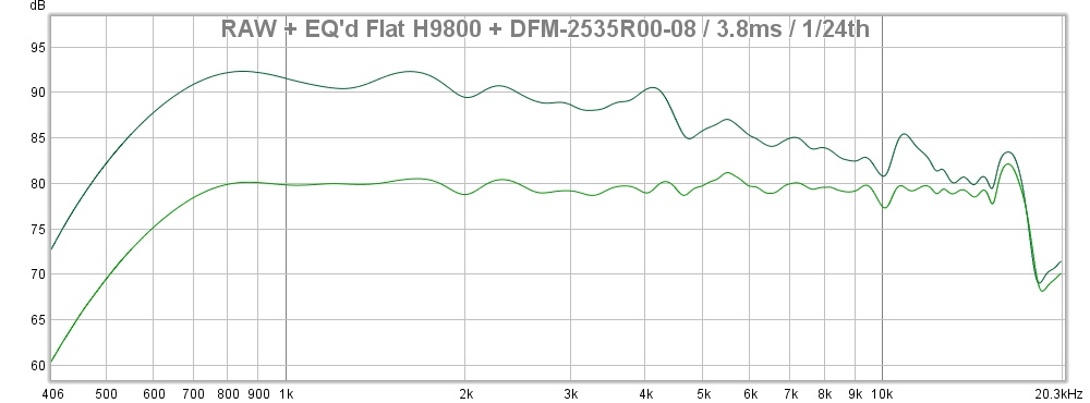

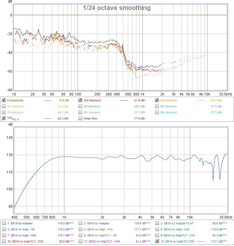

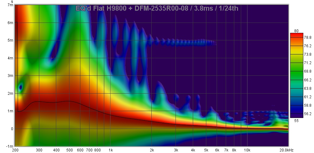

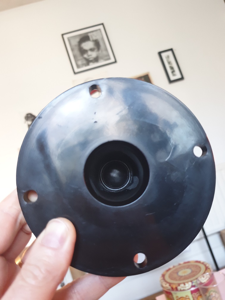

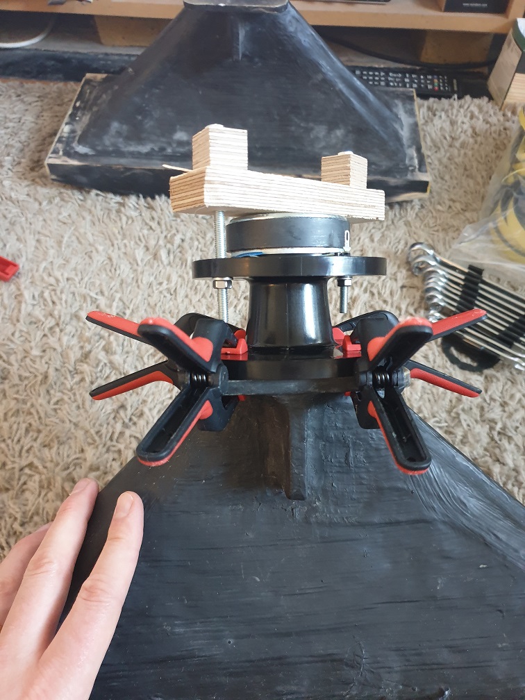

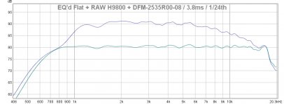

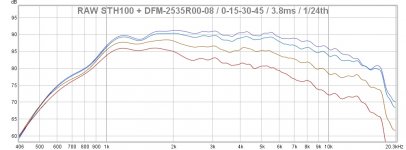

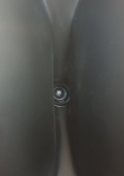

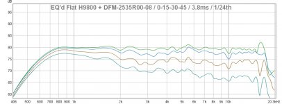

Hi all!
As I said I would lots of thinking has been done. I got rid of the 2450J drivers as I was beginning to make too many compromises and they are drivers for a master system - one which am I not ready to design and build from scratch.... yet.
Sooooo.....

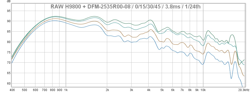

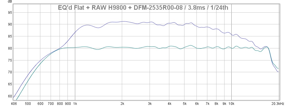

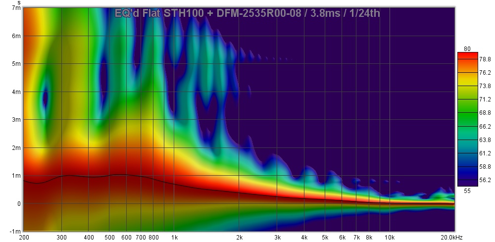

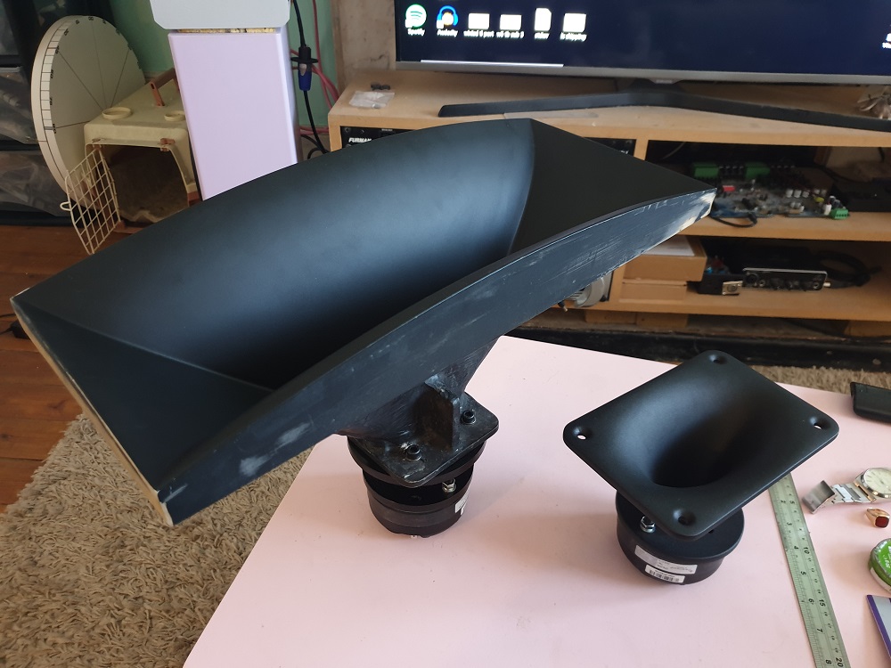

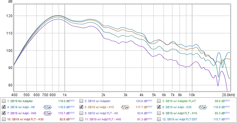

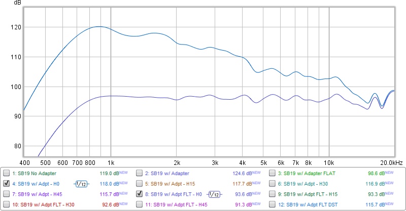

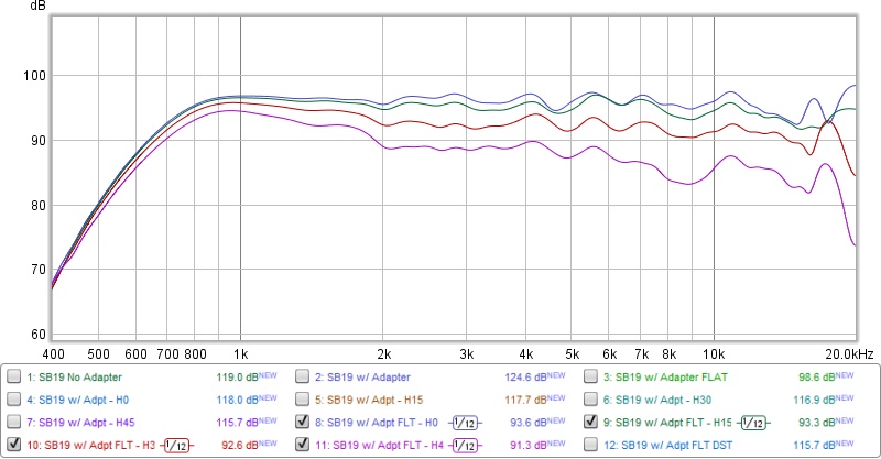

I took Earls advice and got hold of some 1"-1.5" adapters and ran an experiment. Previously I have horn loaded the SB Acoustics SB19ST-C000-4 19mm tweeter on a Faital Pro STH100 horn and had good results. This is following PatrickBateman and his many experiments. The dip mid teens is due to the path length and reflections inside the throat, I am led to understand:
So, I thought, why can't I do this with the H9800s to make sure they provide the imaging I want before I stump up for comp drivers?
I got some very good results, I think. The dip has been pushed up a touch and is completely gone at 15 degrees.
I think what this points to is trying out the Peerless DFM-2535R00-08 which has a low FS of 745hz so I can cross around 900hz if I use a very steep filter. I'm a happy one today!
Thanks for the ongoing input from everyone!

Graham,
Nice! Real Nice!
Love the creativity.
Those are some wonderful results you're getting.

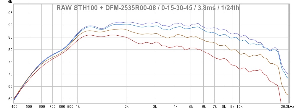

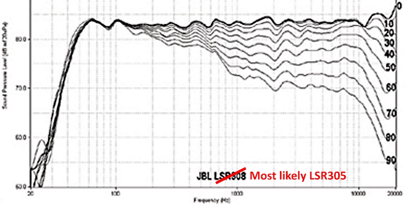

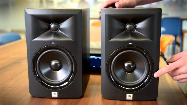

OK, so I have some thoughts/questions if anyone fancies giving there tuppence worth...

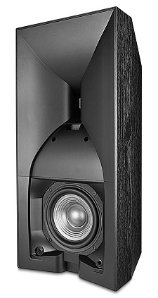

Having gone back over this thread a few times it was mentioned that JBL used specially designed woofers for directivity matching. I asked a little question on an FB group about how, if at all, is it possible to control directivity in this respect.
The answer was basically, no, unless it is horn loaded. Which made me think about the JBL Studio 530 of which I lusted after a couple of years ago. How do they get this woofer and horn combo to be cohesive? I think it must lie partly in the wave guide/horn profile that surrounds the woofer. I can't find any measurements of it, though.
This is also achieved somewhat with the LSR305 budget studio monitor which has a crossover point of 1725hz and looks like this:
(Source: JBL LSR305 & LSR308 measurements)
Although the off axis response is not perfect and becomes dog-legged at 600hz it is still not a bad looking response. How are they achieving this and how can I achieve it with an 8"?

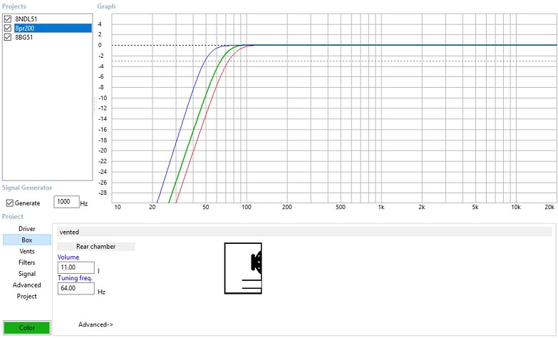

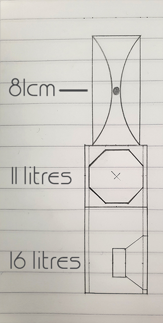

Secondly, I am starting to home in on the mid-woofer I am after. To begin with I can only afford one per side and my system will be comprised of modular stacked cabinets like this:
(Height will probably be a bit higher after cabinet feet, isolation, etc).
Top is the horn/CD combo.
Middle is mid bass (11 litre cabinet)
Bottom is the sealed subwoofer (16 litre cabinet)
Options for driver so far have yielded these contenders to be crossed over to the sub at 100hz:
B&C 8NDL51 (B&C Speakers) - Red curve - 10 litre bass reflex
Faital Pro 8PR200 (FaitalPRO | LF Loudspeakers | 8PR200) - Green curve - 11 litre cabinet
B&C 8BG51 (B&C Speakers) - Blue curve - 16 litre cabinet
The 8BG51 looks good but the box will be too big and it shows a jagged response after 1k which might prove problematic. The 8NDL51 has the right sized box but less low response and has the same jagged response after 1k. The 8PR200 goes lower in the right sized box and has a much cleaner response going up to 3k.
So far my feelings are with the initial plan for the 8PR200 but I am entirely open to changing this. Thoughts anyone?
Super sorry for all the words but no apologies for the pencil drawing when I should be learning CAD.

Does anyone know the depth of the M6 bolt holes so that I can order ahead of the time the appropriate hardware, please?
The depth of the threads ( on the Peerless Tymphany driver are @ 5mm ( which is the full thickness of the frontal plate that's glued to the ferrite magnet ).
I use M6 studs ( that typically ship with one of the many B&C or Celestion drivers that I also own ).
They look very much like this;
M6 Stud mounting pack
( I think that's what you should use if the long end works with the flange of that horn/throat adapter )

Battle of the Horns - H9800 vs. STH100
Data!
The CD's and woofers arrived so here is some data on the Peerless DFM-2535R00-08 on the two horns I have. JBL H9800 molded clone and Faital Pro STH100.
All taken at 75cm, gated at 3.8ms and smoothed at 1/24th.
H9800 + DFM-2535R00-08
STH100+ DFM-2535R00-08
As always all observations and feedback is welcome! 🙂
Data!
