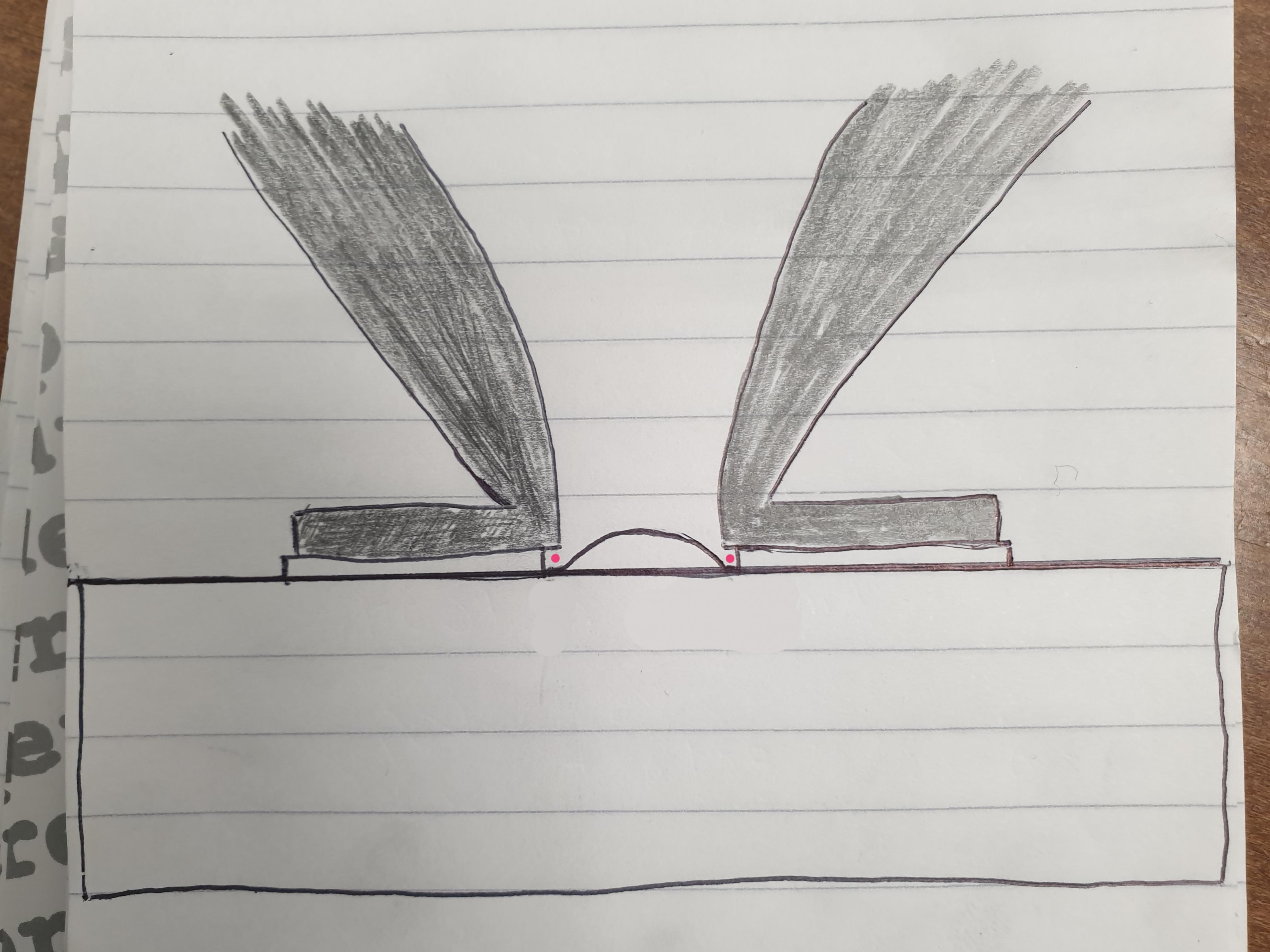

Let me get this straight, that is a 2" compression driver (opening) with an adapter to fit a 1.5" throat horn ?
Or is it a 2" compression driver on a 1.5" throated horn ? (No adapter).

2" CD with the beginning of the horn removed ("snout") to give access to the 1.5"ish aperture to the phase plug

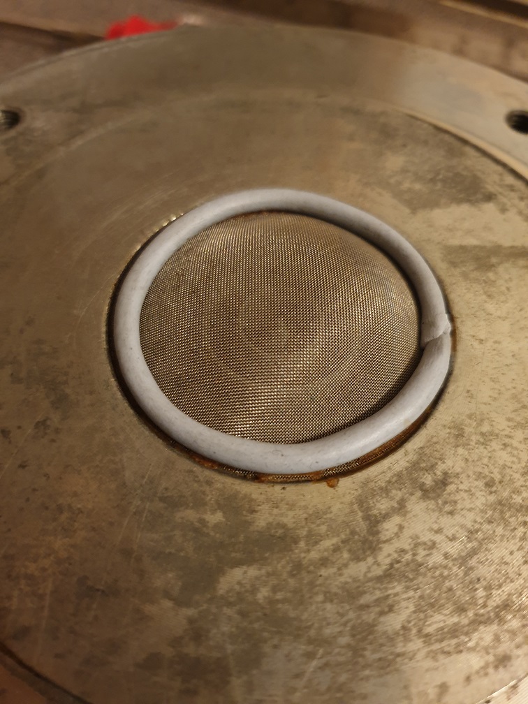

A close up of a JBL4365, hope this clarifies some things.

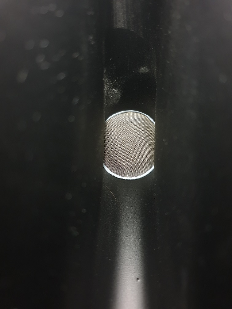

Thanks man! So the mesh isnt really required?
Well, first thing that stands out is the smooth surface, free of any room between driver exit and horn. I'm also curious if you can measure a difference between getting it smooth.
Isn't the distance from the diaphragma to the mesh around (guessing!) 3-4 inches, so around 7-10 cm? Then any problems should be around 344/0.07 and 344/0.1 which mean around 4.9 KHz and 3.44 KHz, or maybe multiples of it (9.8 KHz / 6.88 KHz resp etc).
Maybe someone here has more experience on what to expect?
I always remove the mesh for home/indoor use, telling myself it sounds as a standard speaker grille: better taken out the equation.

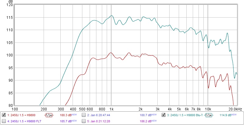

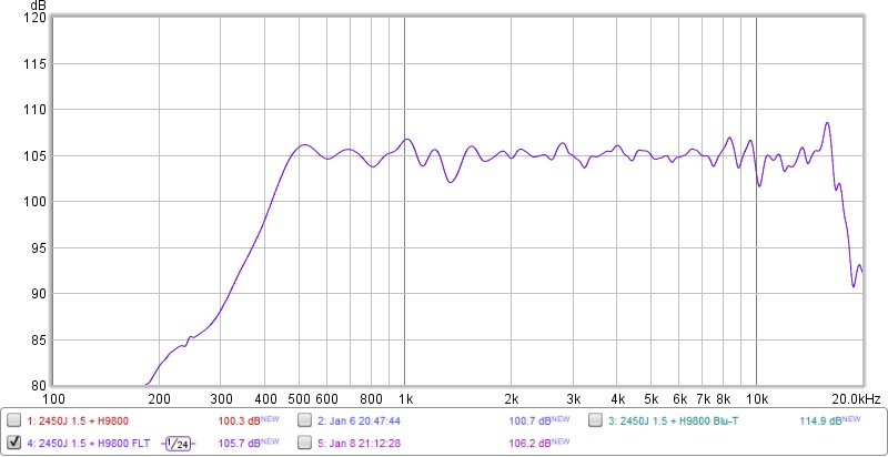

I got a chance to do a quick a dirty experiment with blu-tac this evening.
Turqoise/top response is with blue-tac seal.
Red/bottom response is as before just horn rested on top.
I know there is a way to go in terms of getting that mating between CD and horn perfect. Perhaps gasket tape applied to the horn flange will make a better contour especially if it is slightly too thick and forms a more solid gasket.
I EQ'd it flat for fun, it still looks choppy AF. Is this an acceptable response or am I edging closer to admitting I have bitten off more than I can chew?
This is mostly within +- 2dB and it is not from a glossy brochure but a real-life measurement, so I would say it is very nice.

Real Progress ! I would say.
It's fantastic that you are REW savvy and can monitor how your efforts pan out .

Looking good!
Cheers guys, I won't give up just yet then
I would almost say it's too straight for comfort
Haha!
Nice!
Hehe, I think the 105db line makes it look straighter than it is!

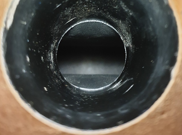

I'm am determined to get rid of the wiggles at 8-10k! I think I know what it is, a slightly misshapen throat that I may be able to file right.
Off axis measurements and a more secure mounting to follow this weekend!

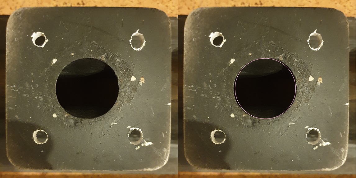

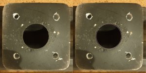

I have found the cause of the zig-zags at 8-12k! (I think)
When the cast of the horn was made it must have been in two halves and mated so when put together there was a slight discrepancy in the thickness of the two sandwiched together about about 1-3mm. Amazing job all the same but I wonder if I can rectify this?
As can be seen below I put a pink circle inside the perimeter of the throat entry and it shows a slightly wide-screened circle.
I butted the snout of the 2450J that I removed and mated it to this same throat entry and sure enough, there is overhang of 1-2mm.
Now, does anyone think it is possible to sand these parts to match the 1.5 circular entry needed? Or will I be tampering with sensitive geometry?

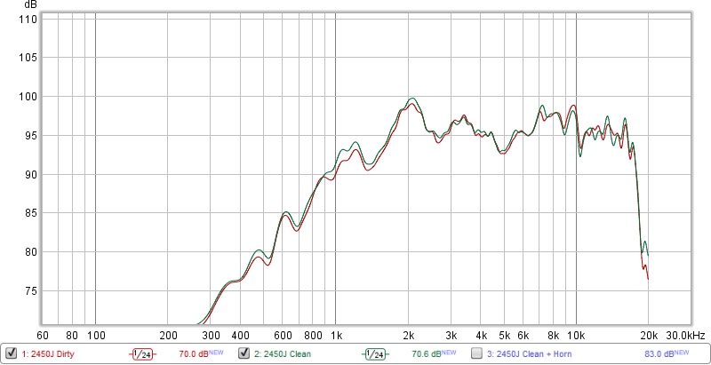

We haven't cleaned that off after advice from a JBL forum and I haven't had time to take apart the other but here are measurements of both at 30cm with no horn. How does agreement look?

1) Mesurements of Compression Drivers with NO horn make very little sense. They will be plagued by reflections from the poorly terminated "mouth" (the driver's abrupt exit), they will suffer from lack of proper loading at lower frequencies (with ensuing distortion), and they will tell you nothing about directivity. In a nutshell, they're a waste of time.
2) Using the 2450J from 1k to 18k is not ideal, i.e., it's NOT where they sound best. These are excellent MIDRANGE drivers, which really shine when coupled to LARGE horns and used over the 500-5k decade.

1) I`m guessing the objective of the measurement at that time was different.
I don`t agree that horn drivers "suffer" anything regarding home (living room) use. You could probably steep EQ it flat to 500 Hz, ring your ears and they`d never break a sweat. If there`s no horn, there is no unloading (from a horn). Nobody at home is going to put more than a watt or so in there, I hope.
2) It`s not the driver it`s mainly the diaphragm that doesn`t support that said smooth upper end (or you`re using e.g. the old jbl 2360 horn etc). The 4365 has a cross over point of 15 K, but has a magnesium diaphragm.

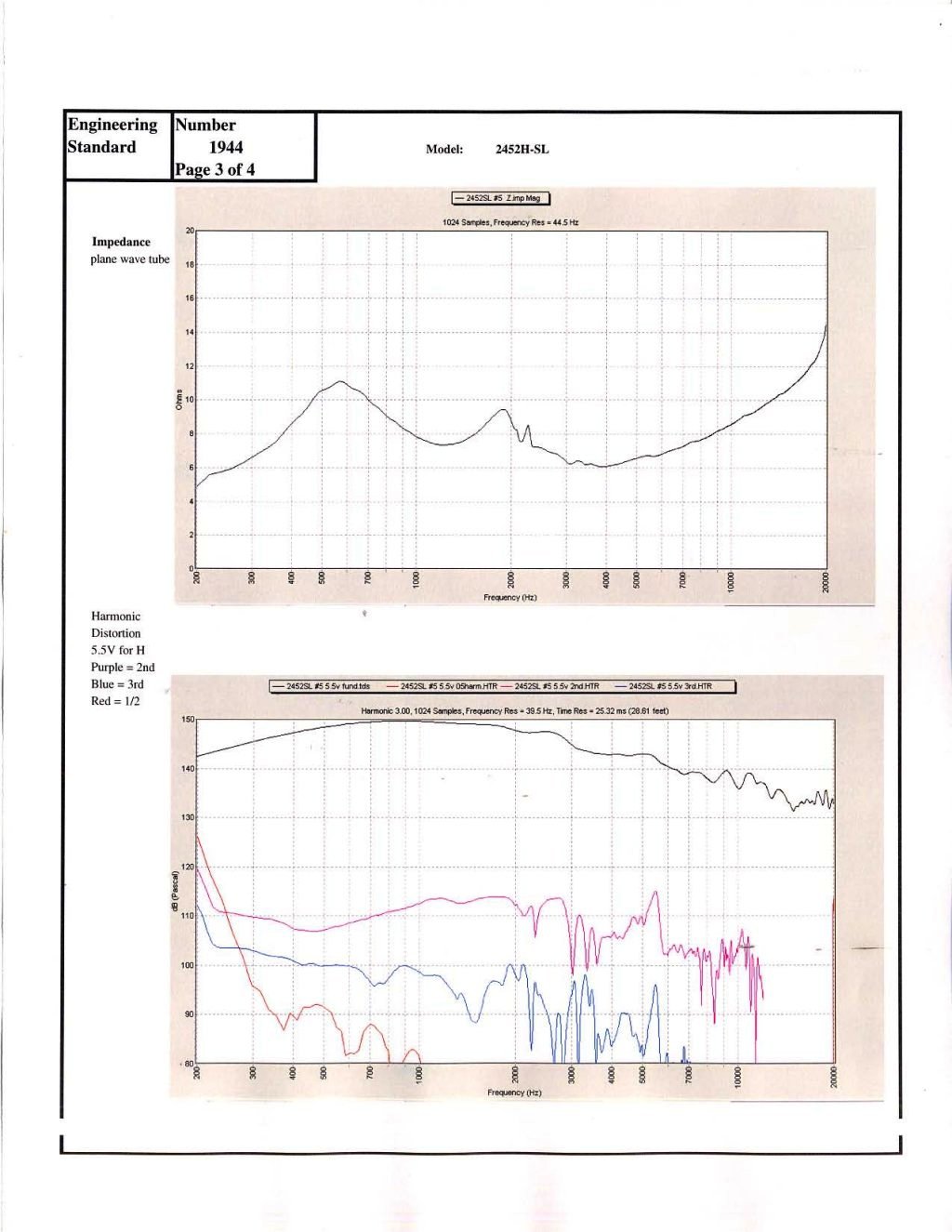

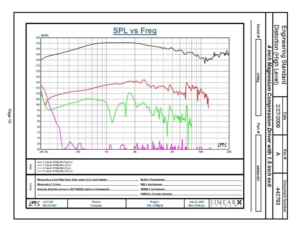

Yes and current high end drivers use aquaplas damped Magnesium or Beryllium diaphragms. The aquaplas helps smooth things out as does the non-ribbed versions. Here is a 476Mg and a 2450/2452 SL that uses a smooth coated Ti diaphragm. Both much better than the stock 2450.
And your right they needed above 20K response for their chosen market. I use a pair of 045Be tweters in my Arrays and I must say they are impressive.
