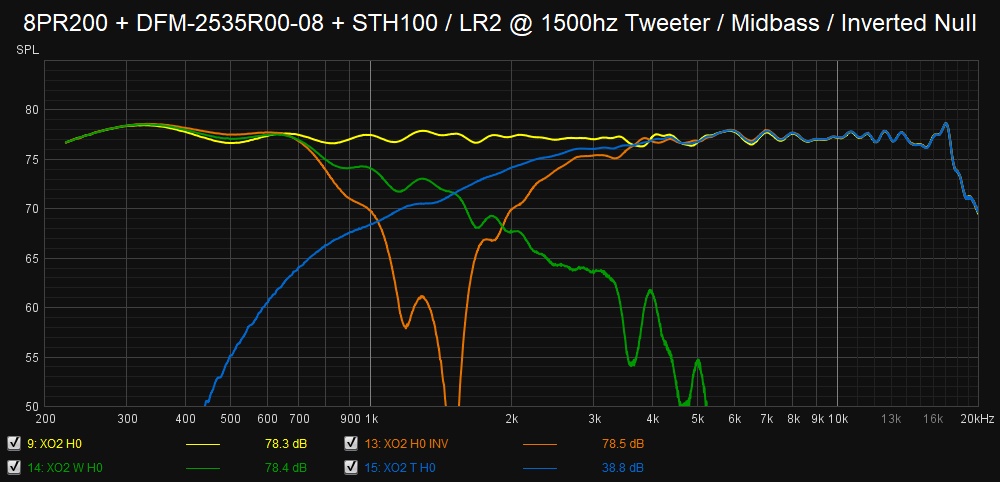

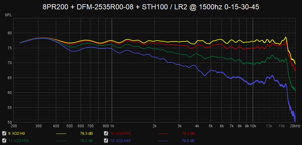

System Based Around JBL H9800 Horn
XO2 - LR2 @ 1500hz w/ 0.14ms delay to woofer
0-15-30-45 @ 1 Metre - I'm pretty happy here, I am sure the funny business at 500hz is a characteristic of the woofer as a shift also shows here on the data sheet and is below the point of baffle diffraction (?):
attachment.php

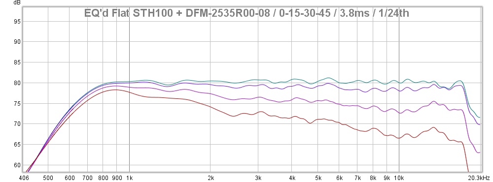

Midbass / Tweeter / Inverse Null - I really don't know how much stock to put in the inverse null approach as I can only achieve working responses when I apply delay to the midwoofer:
attachment.php

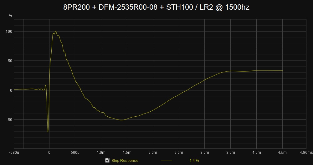

Impulse response - It looks just like the ones from the books so I'm happy!
attachment.php

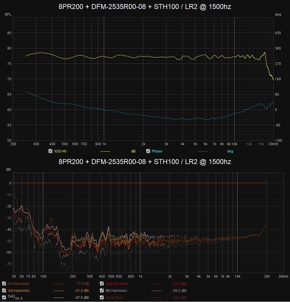

Phase and Distortion - Caveat: I am not entirely sure how to read phase, it looks smooth. I realise I have not given the system enough oomph to test distortion properly but it looks more even with this XO.
attachment.php

Hey, on your question on phase, I tend to look at group delay - it is quite useful for debugging anomalies around the crossover region - a flat group delay on both drivers makes for a more predictable response and might also help you identify the driver delay.
Not that you have any problems here - nice and smooth responses.
I’d be interested in knowing how you get such a nice low frequency measurement without issues with reflections - apologies if you have already described it in your post. I saw some outdoor pictures, which seems brave...
On THD, I’m just learning how to get meaningful measurements, but have a couple of observations:
- for loudspeakers, I’d be tempted not to measure relative to the fundamental. It has the effect of emphasising harmonics corresponding to a peak in the fundamental - which may mislead you into thinking there is an issue at a particular frequency.
- I’ve noticed your rising distortion at higher frequency is most likely measurement noise. I’ve noticed the same in my UMIK-1. It is worth increasing the level and seeing what happens. I’ve ended up measuring thd using nearfield measurements to avoid mic noise.
- you may know all this!

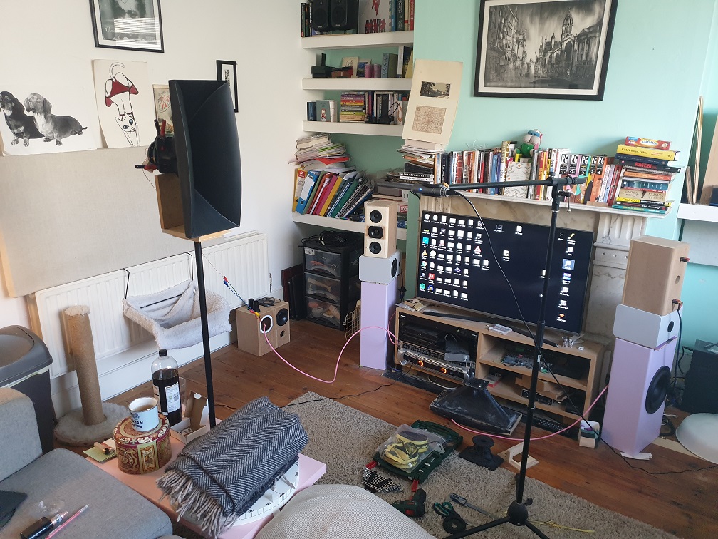

When you say low frwuency what do you mean? I generally gate around 4.5/5ms and completely destroy my front room to get it in the centre of a 3.5x4.25m room with a 2.4m high ceiling. I worry my measurements are a bit wiggly but it's what I have at my disposal.

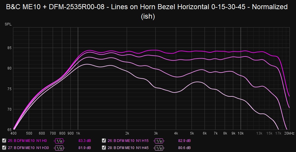

DFM2535 + B&C ME10 Horn
I thought I'd give another horn a go so here are my prelimenary measurements to see whats up. There is not indication what is horizontal or vertical orientation on the horn other than a couple of lines on bezel. Make of them what you wish.
ME10 90x60 Horn

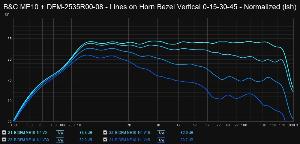

Bezel lines vertical are not too different from the STH100 horizontally, just a bit choppier. Horizontal is a different ball game.
attachment.php
attachment.php

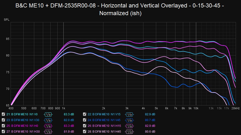

...and because it's pretty - overlayed.
attachment.php
Ah, that’s nice. I’m usually struggling to get clean responses below 1kHz due to reflections (except for “near field” measurement below 20cm). The luxury of a big room! How do you deal with the first reflection from floor-bounce?
Yeah, same for me. Mine have wiggles below 1k despite gating. It's a real sanity breaker.
I use a woolen blanket from your neck of the woods and sofa cushions for floor bounce. Nothing I can do about the ceiling. I have a few rockwool panels around the walls of of my front room which help imaging when in listening position but I'm wondering if I need to bother now I have a horn based system. The wife would approve.
Cushion, blanket and panels can be seen here, I have since changed to shottiing down the room not across and I move the sofa to the side.
