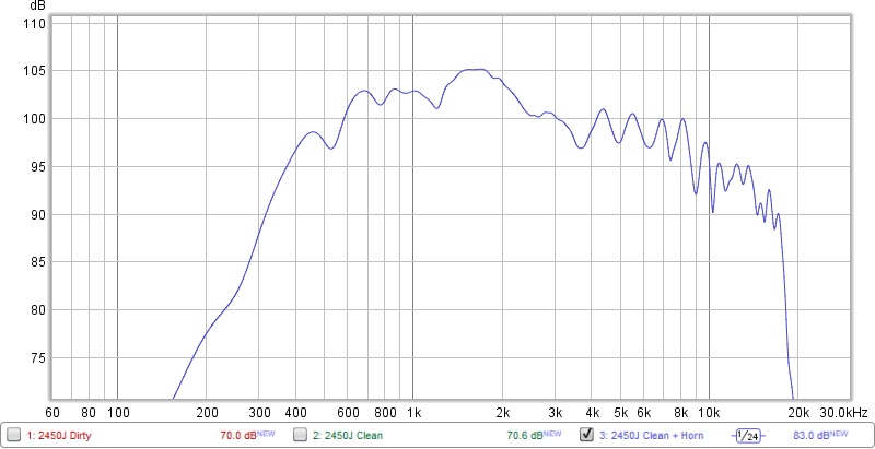

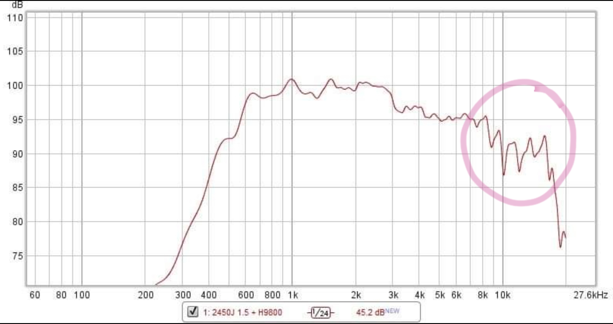

Hard to tell really.
I assume the drop @3 K shouldn't be so steep, then again it's a guess with measurements without baffle and semi fixed couplings of the driver to the horn.
Is the drop also there without the horn?
From recollection:
It should measure almost flat (6 to 9 dB total) from 600/800 Hz to around 10KHz, if measured from a foot/30 cm or so and without horn. Forgive me if I'm off on the top end by 2 K or so.
Either way: it should not have drops like those at 3KHz already.

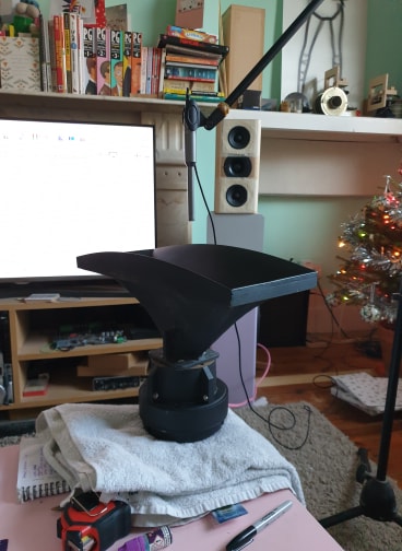

I have no idea how I'd attached the two together...

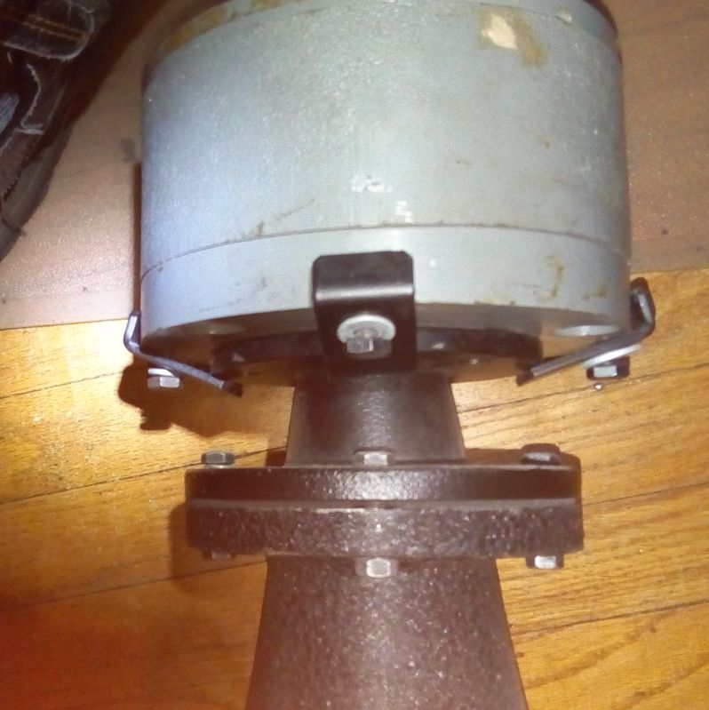

Use Woofer Clamps clamped to the 4 corners of the horn's driver mounting flange ( turned to be closest to the existing snout holes ).
Here's how I attach an ancient RCA 1.4" driver to a horn.
Called "McGivering"
Lucky for you there are quite a few JBLers willing to hand-hold ( as long as the project doesn't get too boring ).
Thanks EarlK, I needed this for a modified 2450 and 2384
No need to use some souble sided adhesive or anything?
The previously pictured 1.4" to 2" adapter ( NLA from Selenium ) has a very thin ( crushable ) foam face on each end.
There's no slipping what-so-ever.
Therefore, I would recommend making a gasket of some sort ( auto supply houses sell all sorts of gasketing supplies for the DIYer ).
( FYI, Eminence sells a nice affordable 1.4" to 2" adapter these days .)
> though it doesn't have any gaskets on it.
I wouldn't do that, The threads only extend the thickness of the bottom plate if you try to use longer screws you will pull the plate off the magnets and kill the driver.
Rob
Rob
Good Point Rob!
In the example I displayed above, the 1/4-20 holes disappear into the hollow magnetic structure of that RCA driver ( so there's no concern about driving into + cracking open the magnet ).
How thick is that plate ( not many threads I suppose )?
Threaded studs could be used on the outer perimeter holes ( so that the tightening force is only the nut turning down onto the already seated stud ).
Like this;

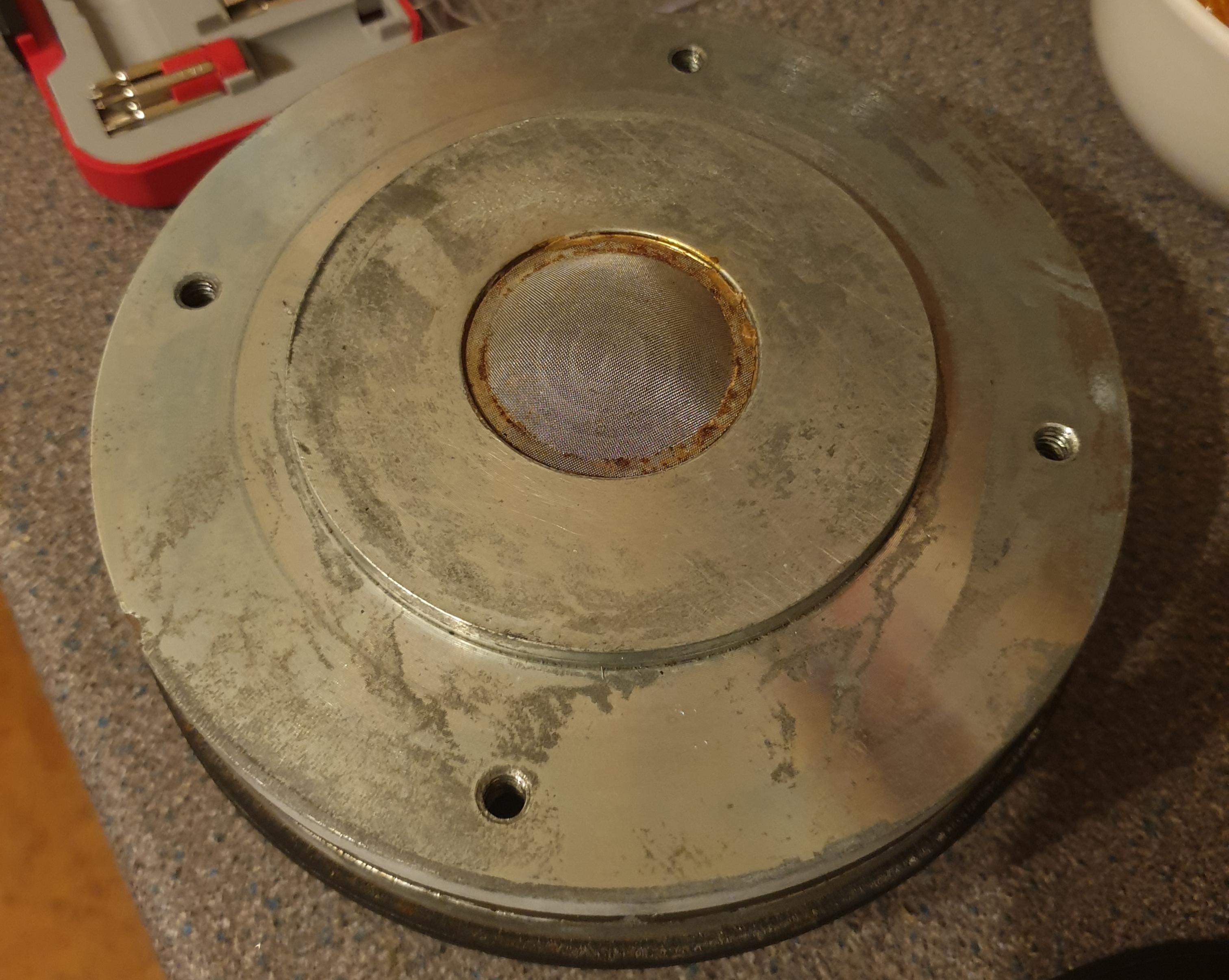

I forgot to add this image earlier.

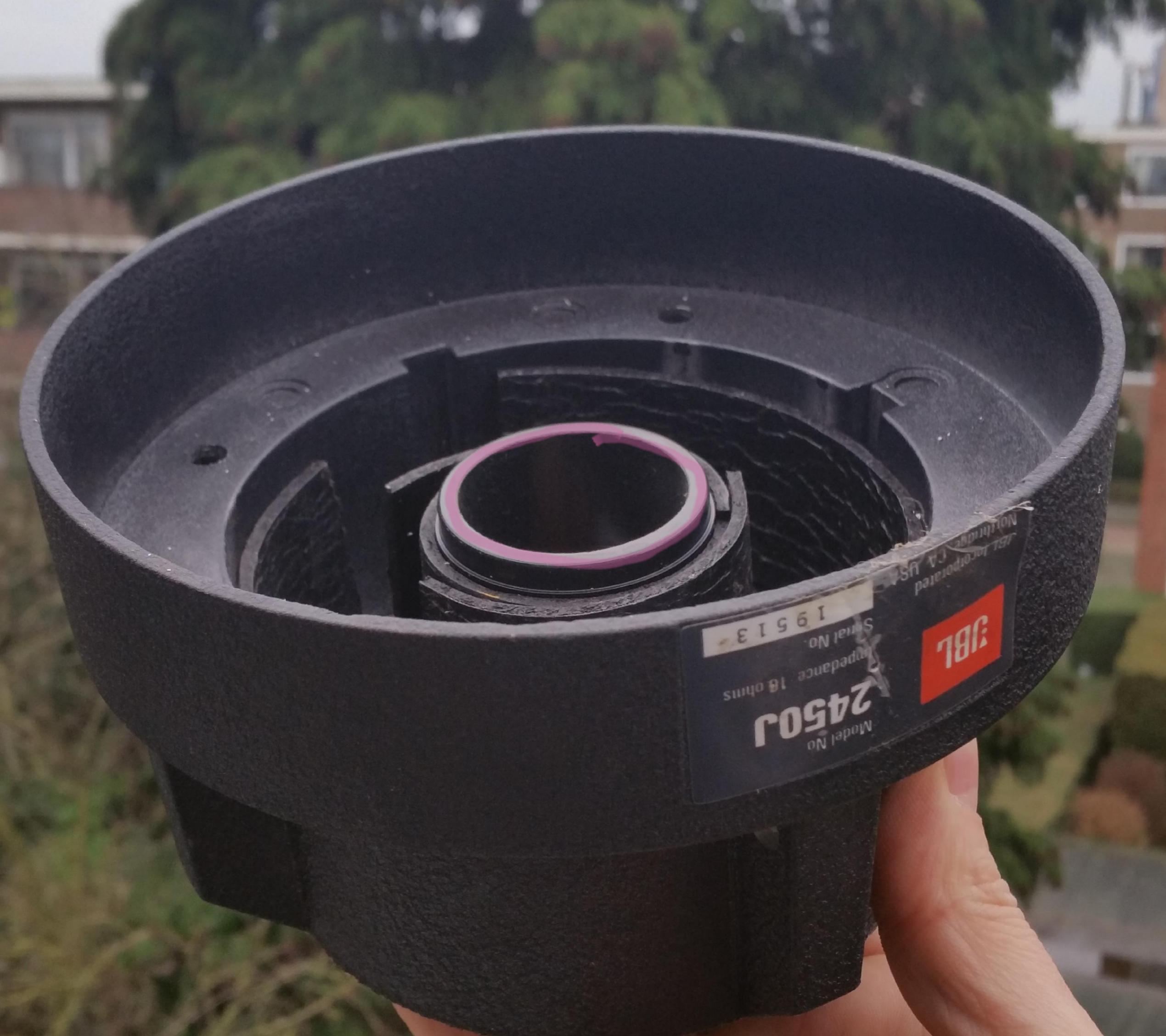

It appears that the SL has a flush/flat mesh whereas the J has a domed mesh which protrudes into the horn when I took this measurement. Perhaps a shim is needed. I can experiment with thick card, perhaps!

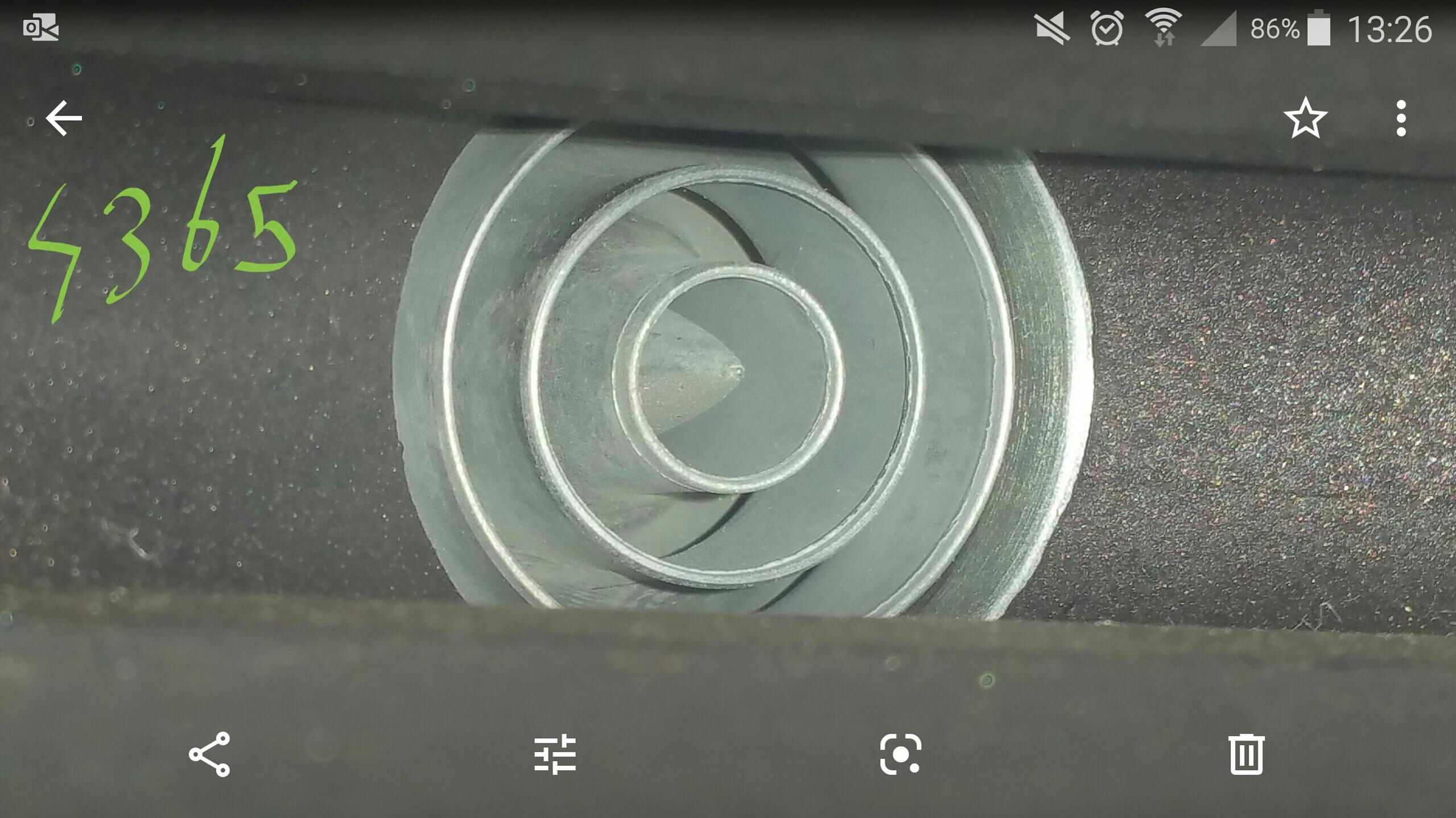

This gives you a good understanding on how the driver goes together. This equivalent to a 2451 and has the bolt pattern for your horn. No it's flush, thickness of the bug screen, and the if you look closely the raised circle is the flush mount without the 1/4 20 tapped holes.

There is an enlarged space around the screen for the throat to connect from the 2450J snout, tho. The screen is domed on this model but after thinking it does protrude in to the snouth throat original attached.
However, I remembered I did a measurement out of sheer curiosity the other day to see what the response looked like with the 1.5" horn rested on the 2" aperture:
There is a dip at 1.25k that is consistent with the drivers with snout but no horn as well and shows up on both. Although the craziness above 3K is due to the reflections and differing sizes of aperture it does show the dip sharp reduction in response.

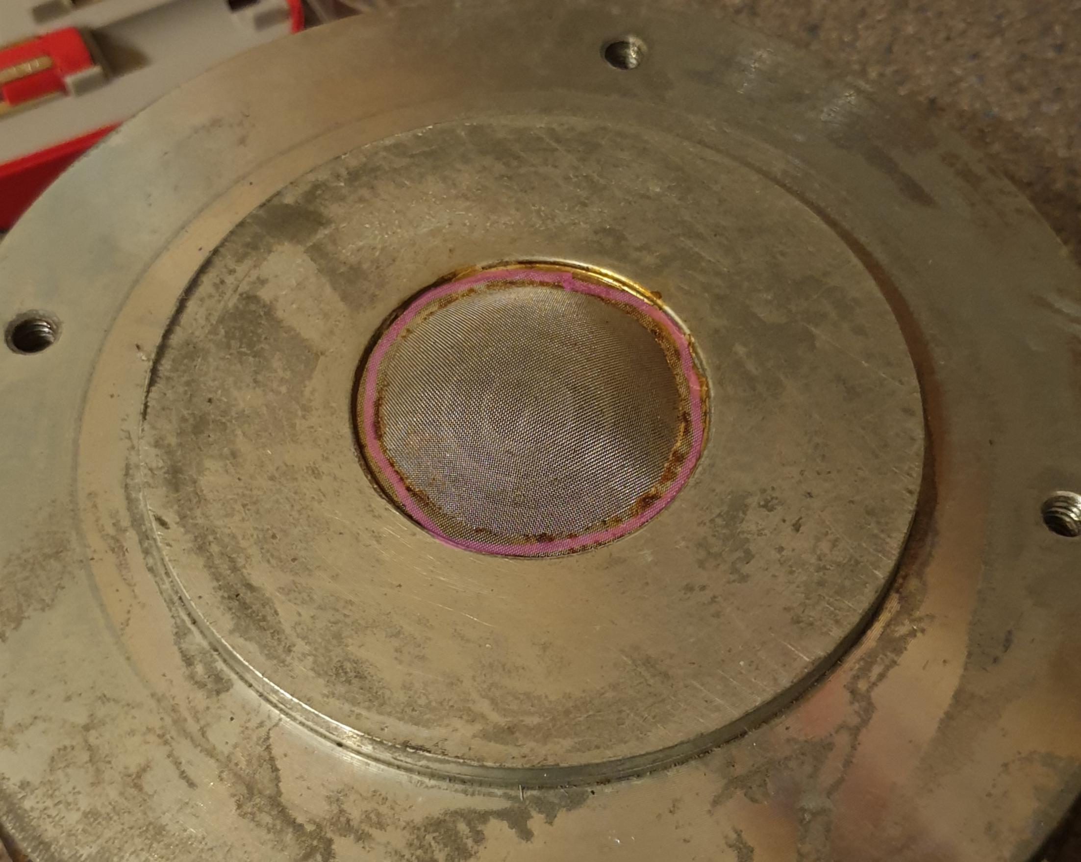

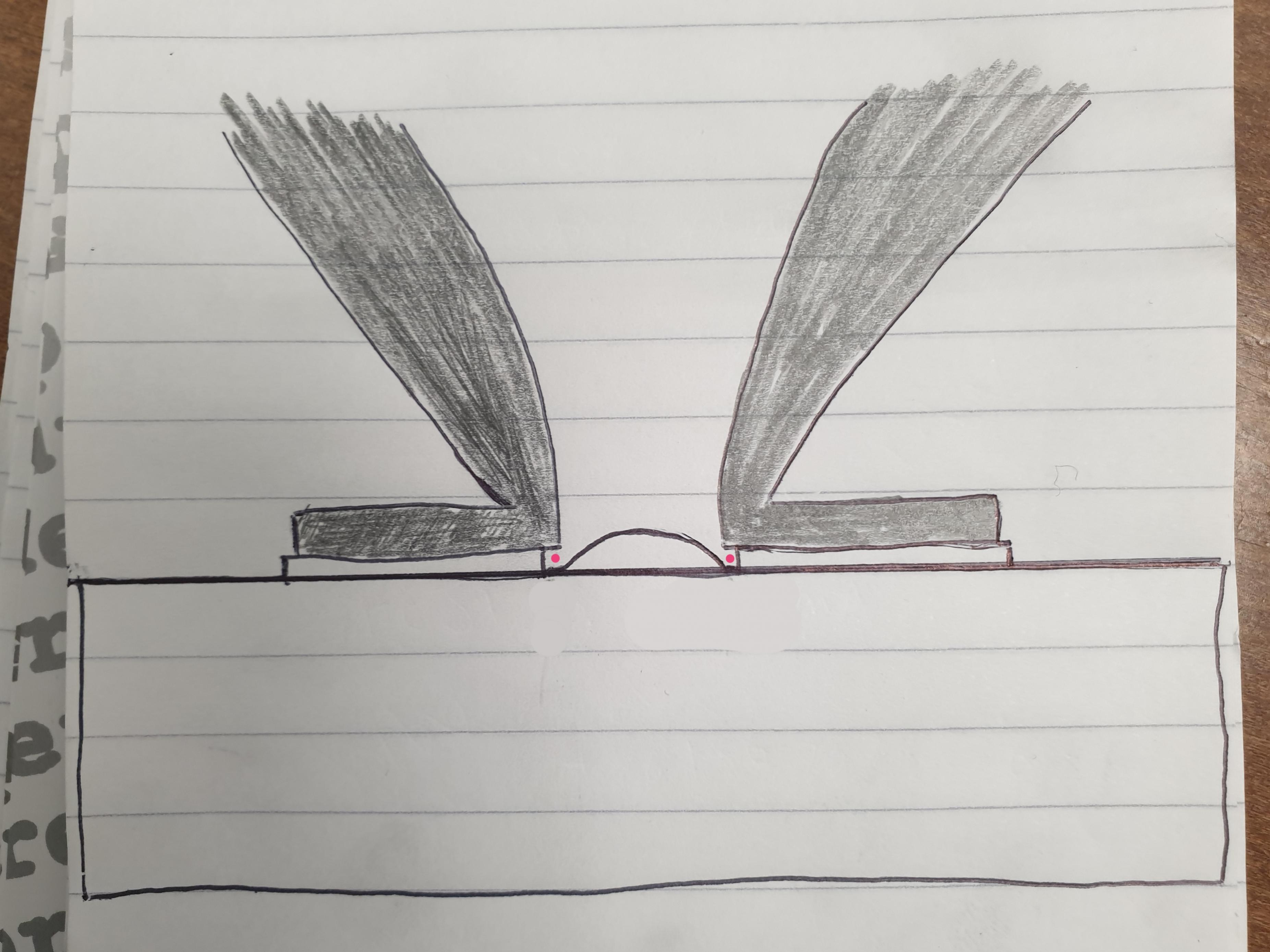

I've been looking at this FR all day at work and what I initially thought was breakup (combing from 8-9k upwards) is actually what I think to be a disruption caused by the mismatch of the horn to the silver plate. The original "snout" pressed down in to the recess around the mesh forming a seal and began the 1.5" throat. The problem is, I think, that there is now a void where this throat once was.
Here is a diagram marked with pink dots to indicate what I'm talking about.
I realised this after I noticed the similar pattern from the FR of the horn on top of the 2" aperture and the horn on top of the mesh.
How should I fill this gap? I was thinking maybe foam gasket strips on the horn flange that butts up. I dont want to put anything on the mesh that is adhesive for fear of pulling the mesh up later down the line.
I've marked all parts I'm talking about with light pink highlighter.
Annoyingly I wont get a chance to test this theory until the weekend but I will be able to clamp the CD and horn together and do some on and off axis measurements!
