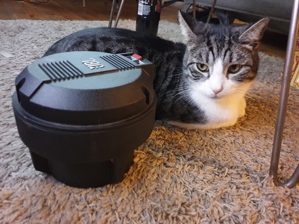

OK! Well, much like my other threads things have taken a turn.

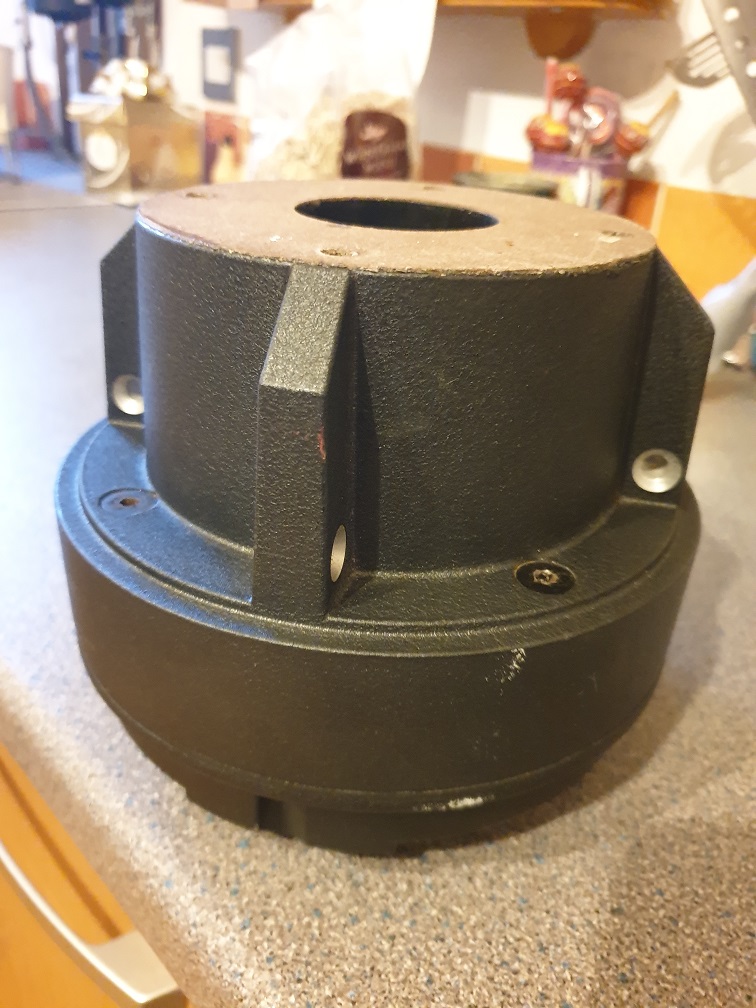

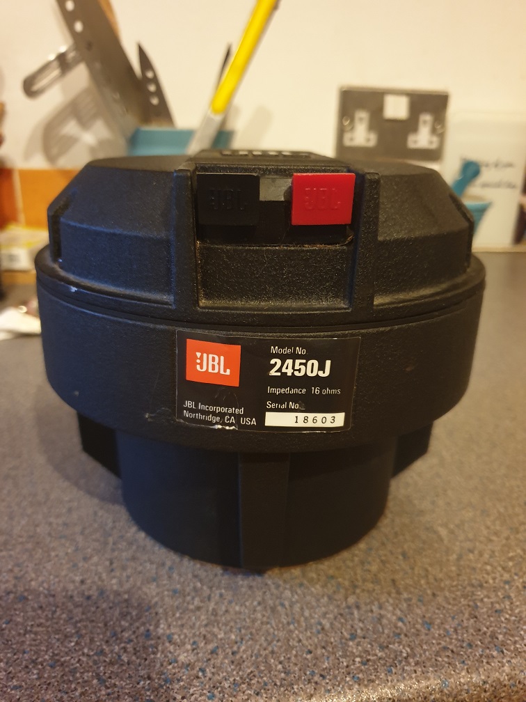

I found a pair of 2450J cheap and went for them. When I got home I realise they couldn't have their snout removed to make them 1.5" throat-sized so I now have two 2" throat drivers. These things are MASSIVE.
attachment.php
So, I'm sad as I am I can't use the H9800 horns 🙁

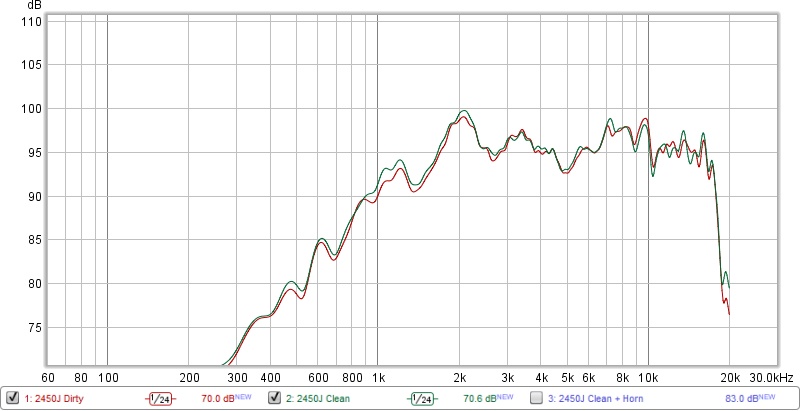

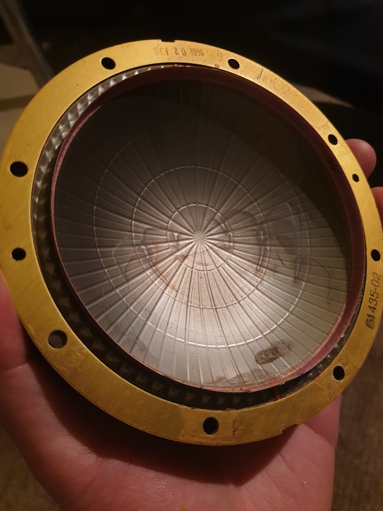

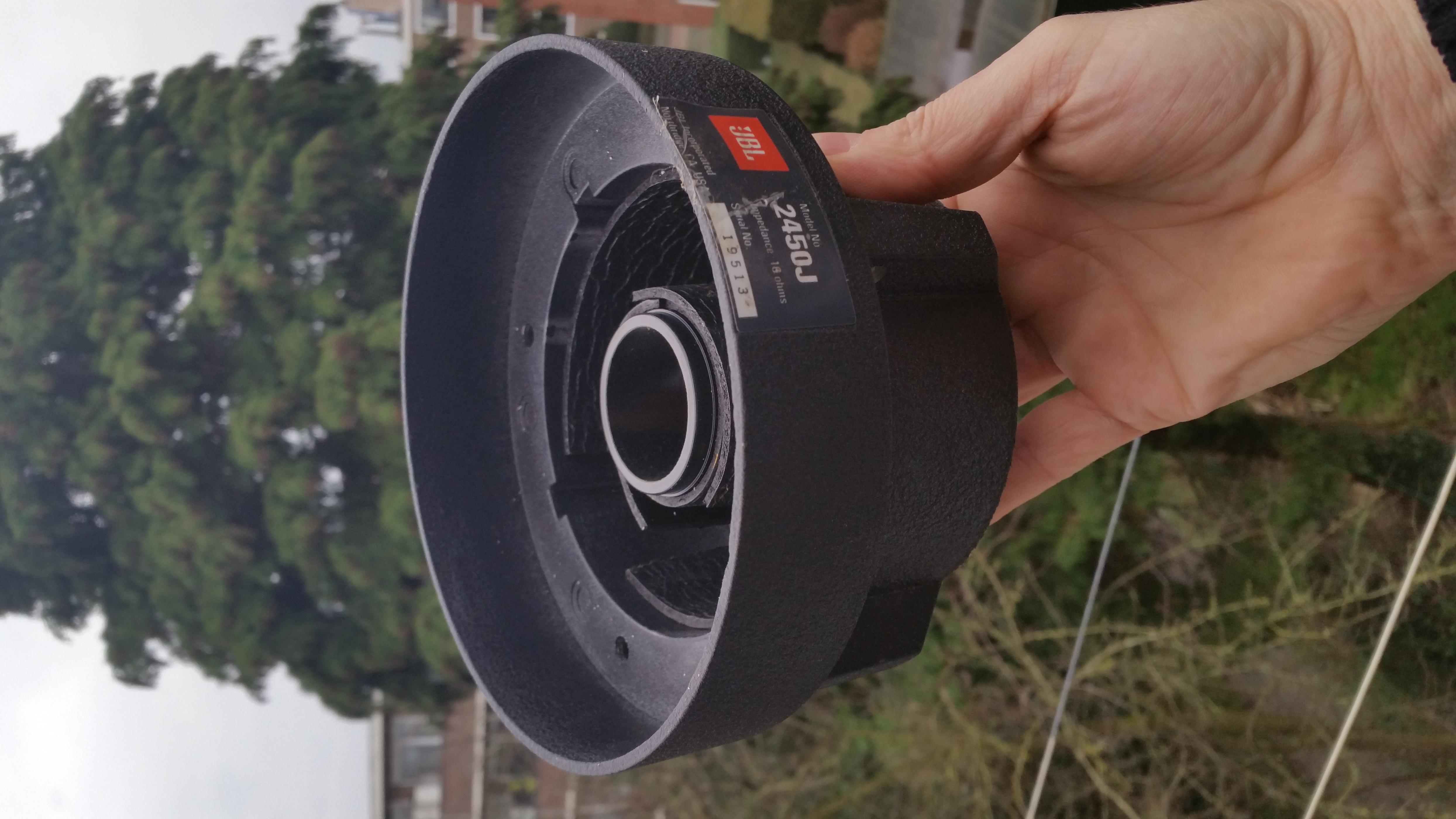

My friend disassembled them for me and cleaned the VC gap but we found some odd stuff on the diaphragm of one. We haven't cleaned that off after advice from a JBL forum and I haven't had time to take apart the other but here are measurements of both at 30cm with no horn. How does agreement look?
attachment.php
My current plan stands at:
2450J - 1000hz-18000hz ish
Twin 8" woofers per side - 100hz-1000hz ish (unless someone can really convince me)
Single Sealed SBA 8" sub per side 100hz and down
This will be until I can figure out a cheap UHF driver/horn combo. Thoughts?

That' s strange. I've never come across a 2450 that couldn't get modified from it's normal 2" exit to 1.5".
Are you sure? I mean is it glued or something?
I did experience the occasional screw that was a pain to get loose, but always was it detachable.
Be sure to clean thorough and check with a low sine wave signal (few 100 will do) if it's rub&buzz free. It might need more time than you think. I always let the signal run as I fasten the screws one by one. Maybe use ear protection, the signal level should be around annoying enough to want to wear them.
What stuff on the diaphragm are you talking about, black stuff, aquaplas, or something different? I would leave that on, or is only 1 of the 2 coated?

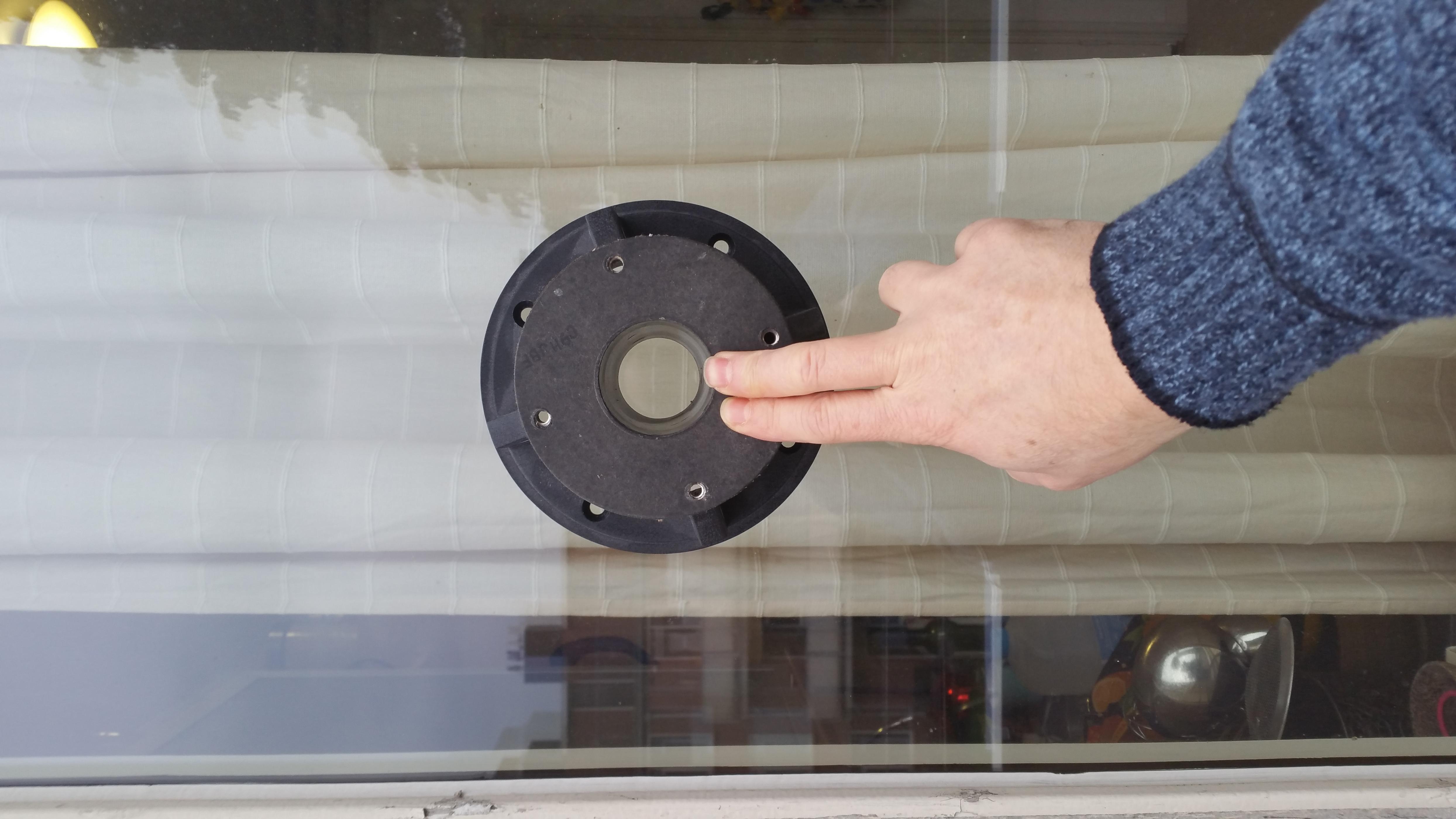

We looked all over but this does not seem to have a seam to remove anything. This is the 2450J, I got confused between the J and SL which is 1.5".
https://www.fullcompass.com/common/files/7952-2450JSpecsSheet.pdf

Here it is, and thanks for the advice re reseating. I will at least try and remove the rusty looking smudge - CAREFULLY.

First picture in your last post: you can see 2 screws (hexadiagonal), 4 in total on that side. Those are the ones you have to get loose. That's all!
Edit 2:
You'll be fine with 2 × 8"
Good luck!
Edit: or in the second pic of your last 3 pictures, same thing goes.
Hexadiagonal (5mm or so, Torx is doable as well).
It's just a 2450, they can be unscrewed for sure!
The titanium can be cleaned easily, cloth/paper and alcohol, maybe water is enough. Don't get it soaking wet of course.
Any metal in the air gap is best taken out with some sturdy adhesive tape: try and get it in as best you can, press and get it out again. Repeat...
The screws might be really tight, I had ones that I was afraid something was gonna break, you might want to use some oily substance to let crawl under there.

In as far as the bolts you mentioned go, we did try those but the only seam there is on the unit is for the diaphragm compartment cover. I can't find any info online of converting the 2450J to a 1.5. I believe you I just can't figure it out! 🙂
Cheers man, I'll give that a go.
Look at the 4 holes where the screws left and the other pic: see how tight the seam is.
It may look impossible but it can come off.
The "snout" can also come off rather difficult, after removing the screws. Sometimes it just does. They also go on in 1 way, not 4 as you might expect.

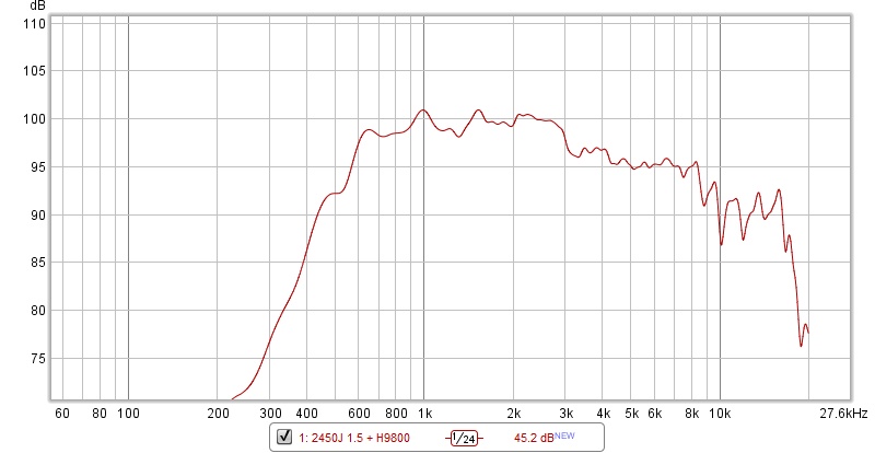

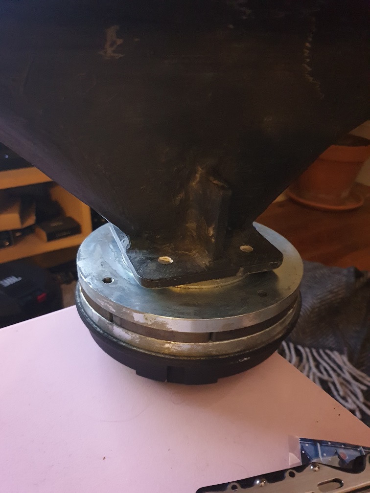

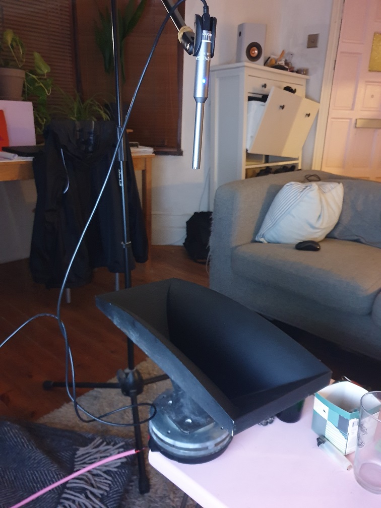

Right, I got it free with some fiddling!
This is FR with the H9800 just resting on top of the unit with the "snout" removed:
attachment.php
It doesn't look to bad to me, thoughts anyone?
The break up above 10k is now apparent!
I have no idea how I'd attached the two together...
