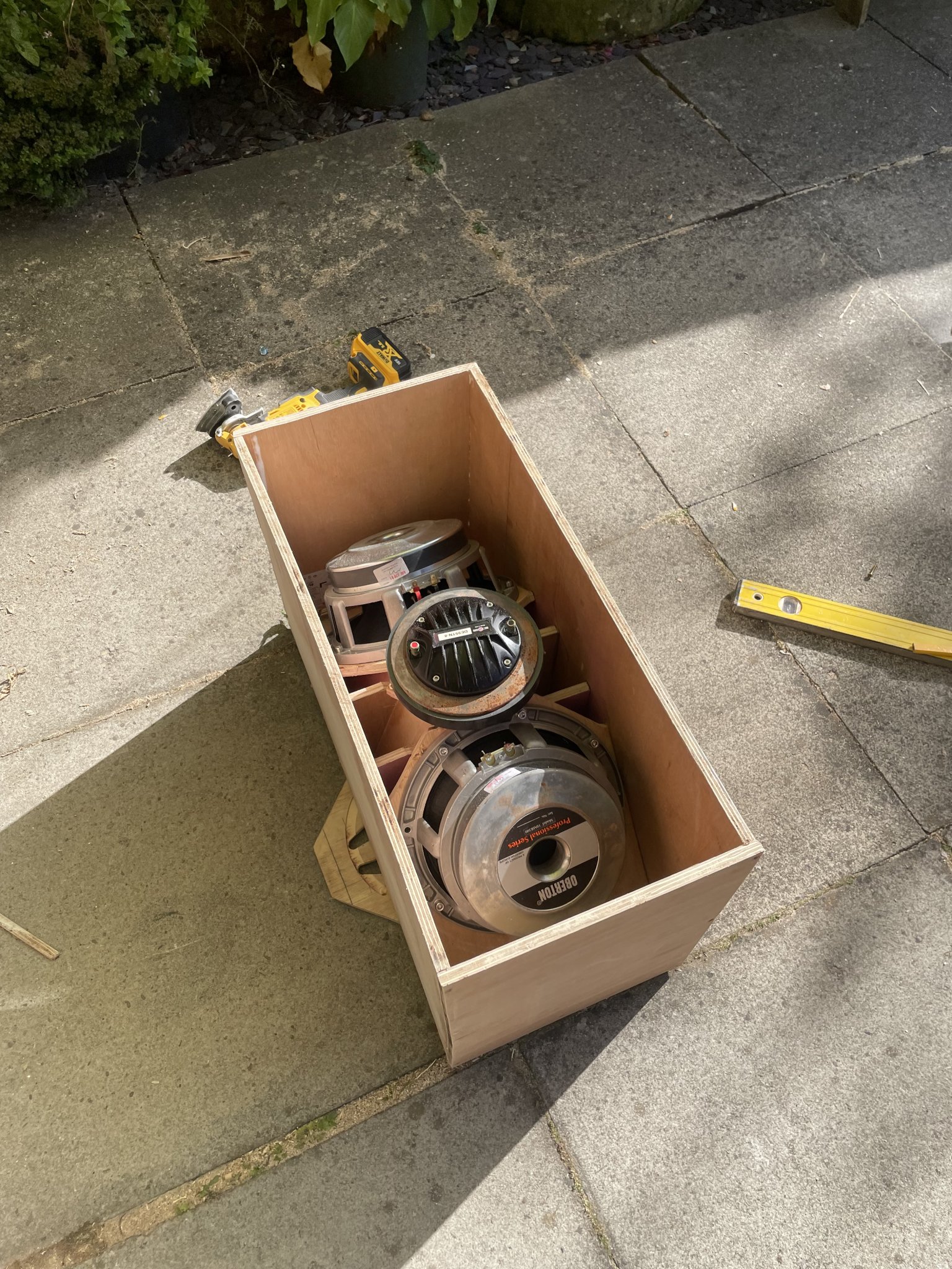

I'm going to go ahead and build one box using hand tools and see how it sounds. If the Oberton 10MB300 have a useful response then I'll build a couple of properly finished boxes in CNC. I'll post some pics up of the test box maybe later...
Understood, thanks for weighing in and freely sharing so much knowledge!That would reduce cabinet volume, reducing the low end output, and increasing heat, while the open ports would still have some pipe resonance effects, all undesirable features.

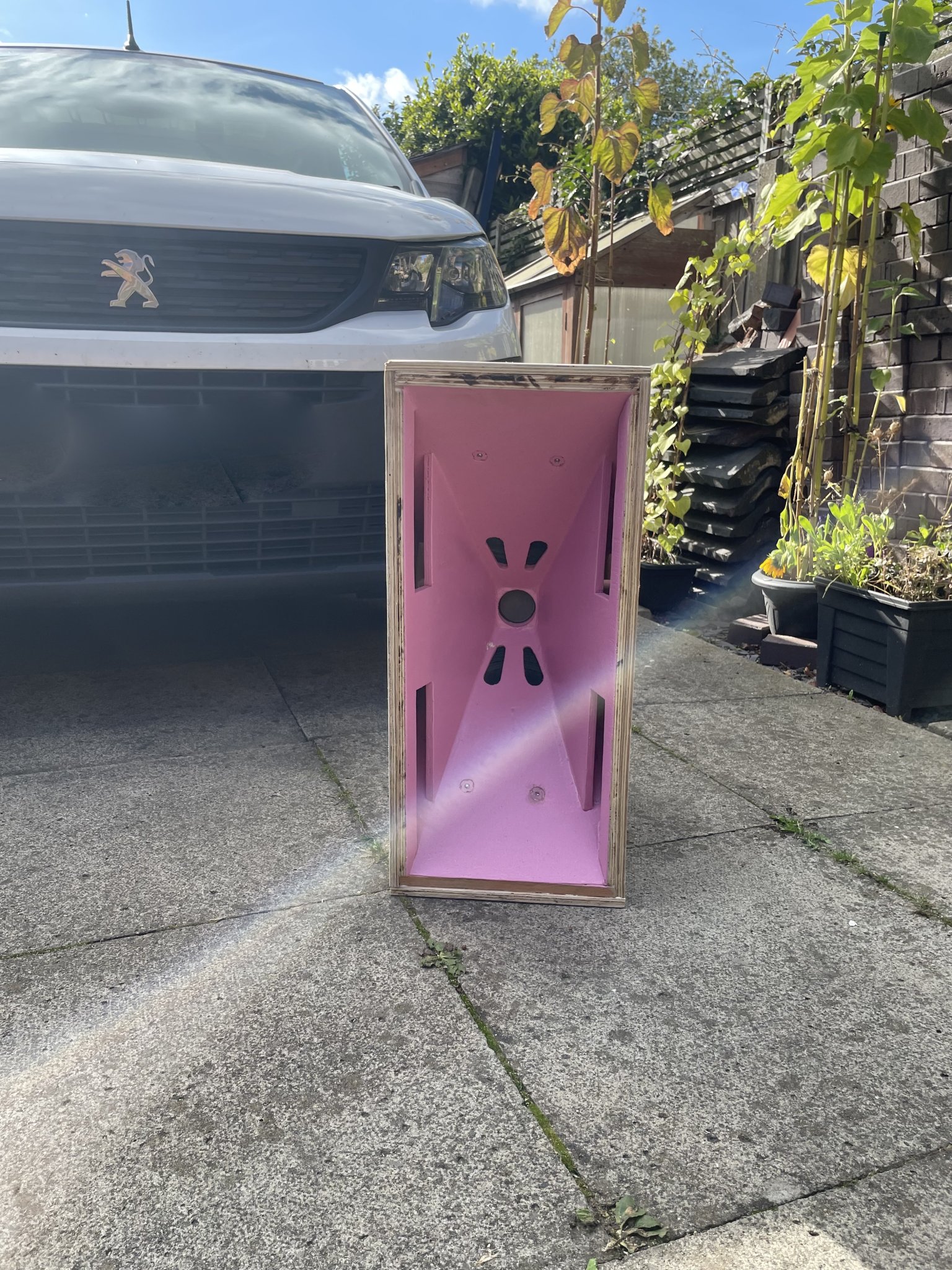

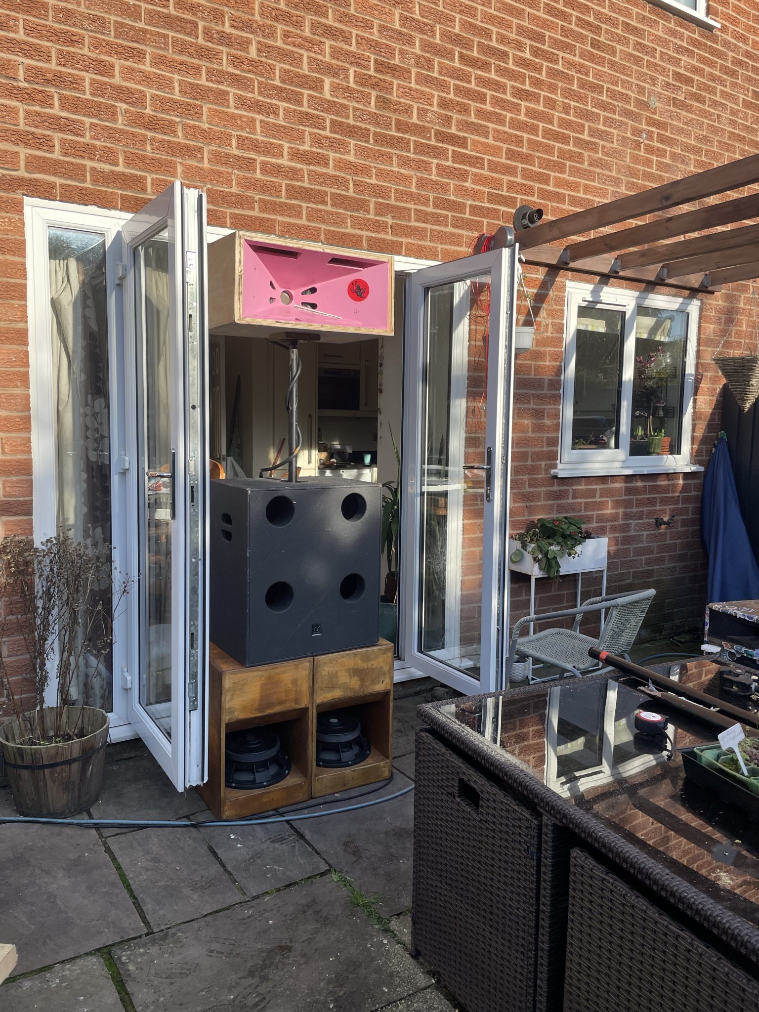

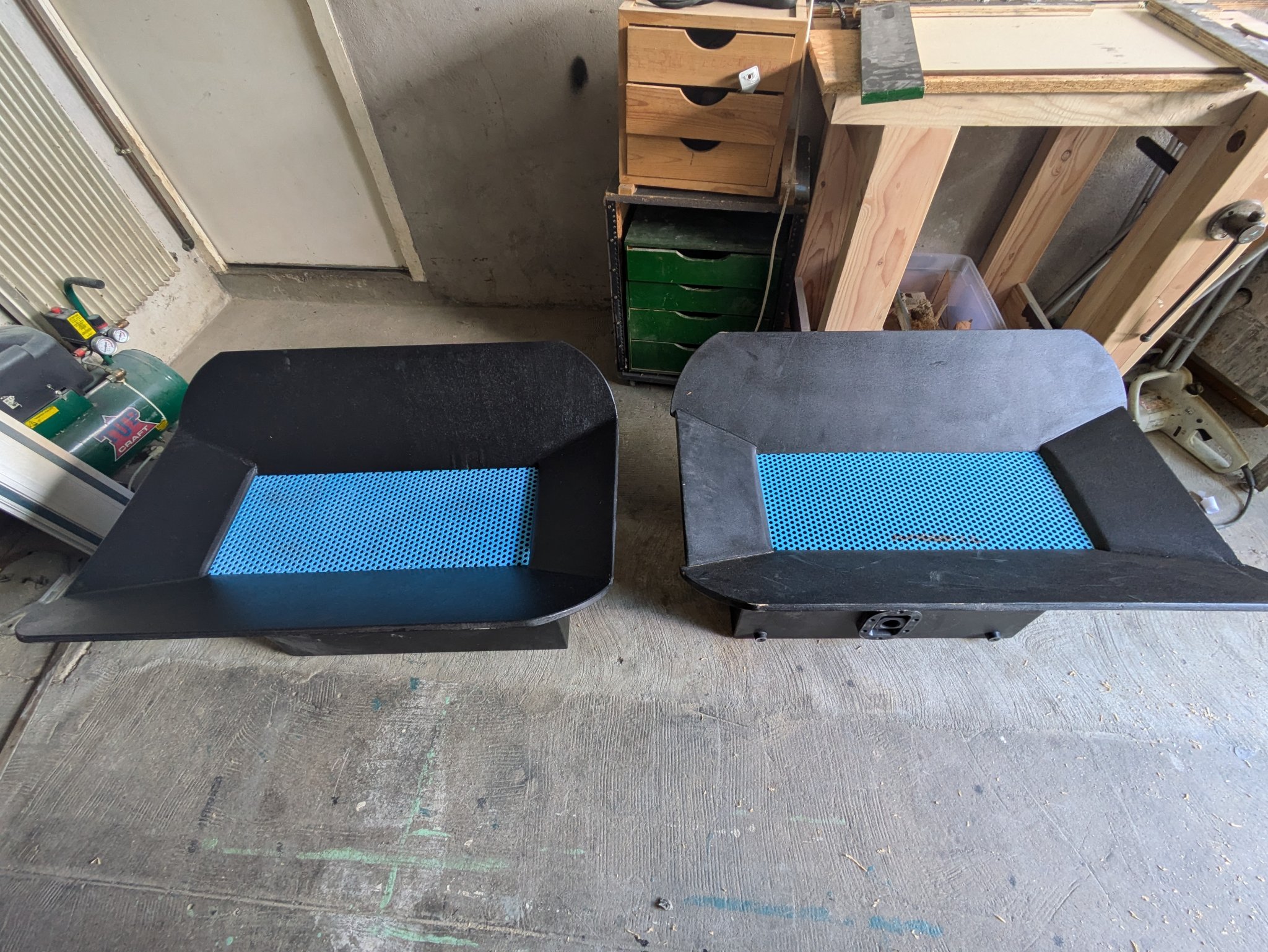

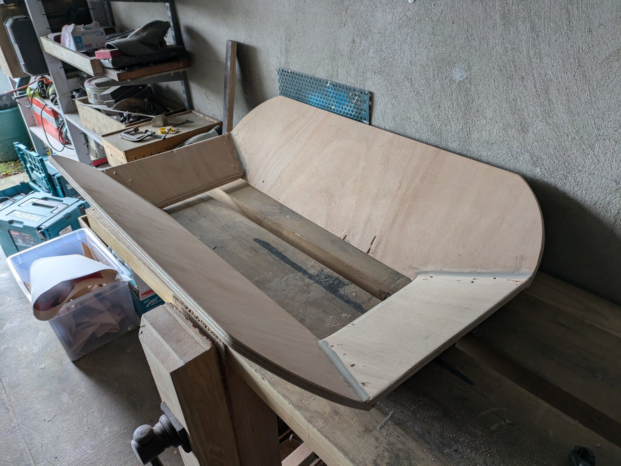

So made use of my spare time this weekend making a rough prototype box which I'll finish off this week when wadding and connectors arrive. Was good to get to know the plans and I'll definitely build a proper pair on a table saw in the new year and get a reference mic.
It’s a bit wonky and not quite the real deal but sounds well enough to keep us going for the time being.

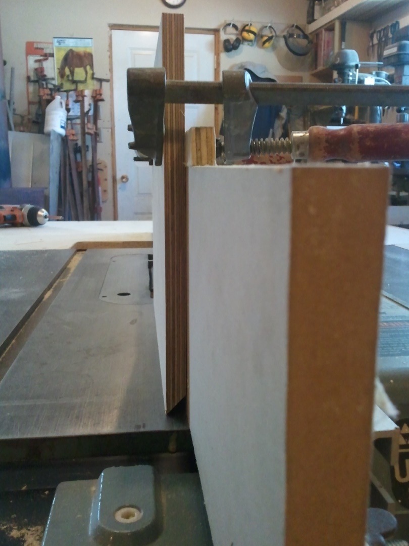

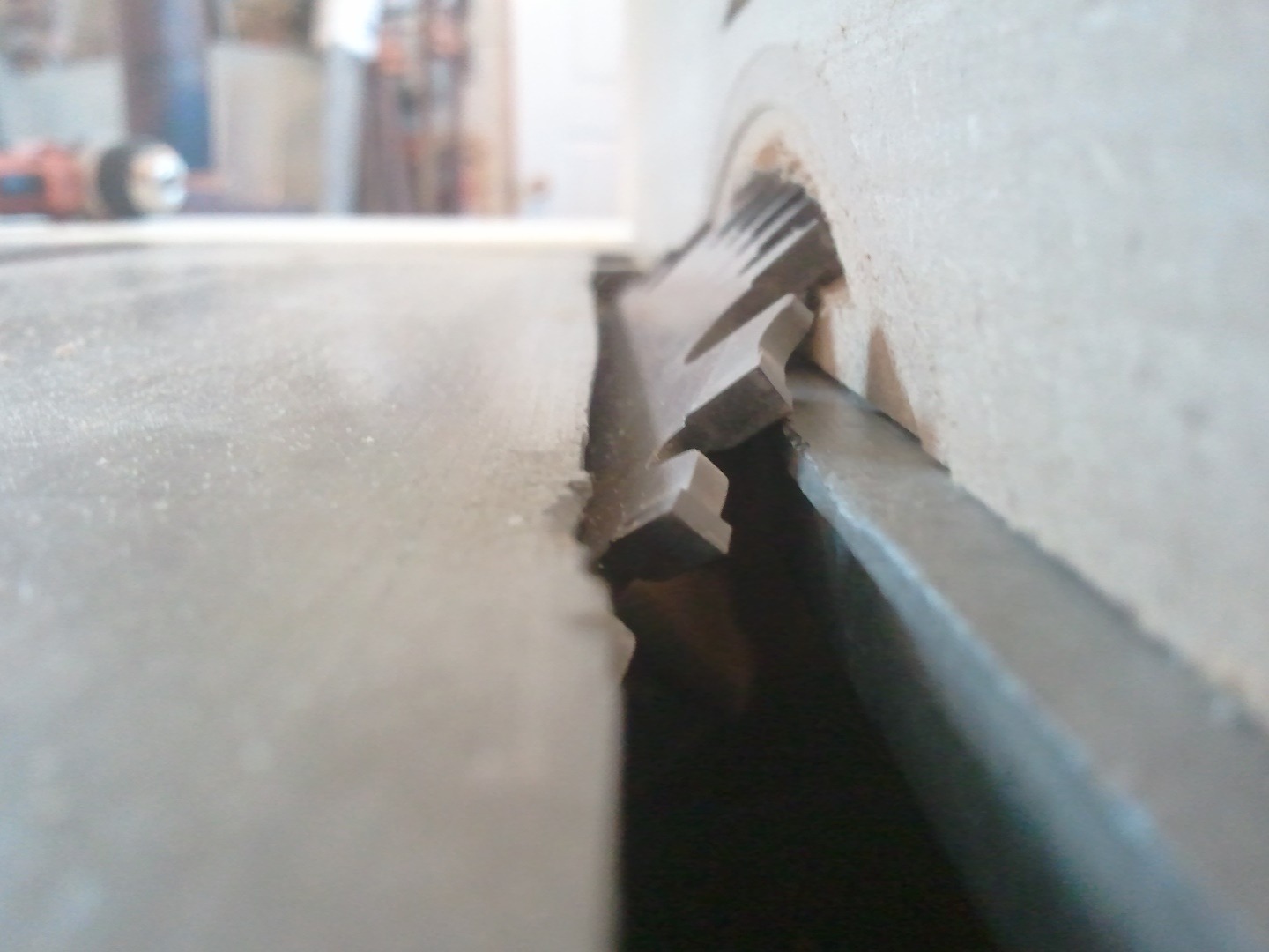

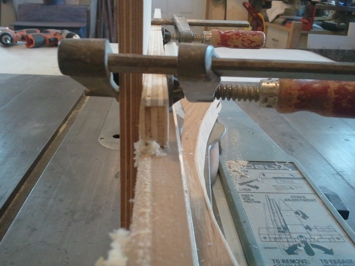

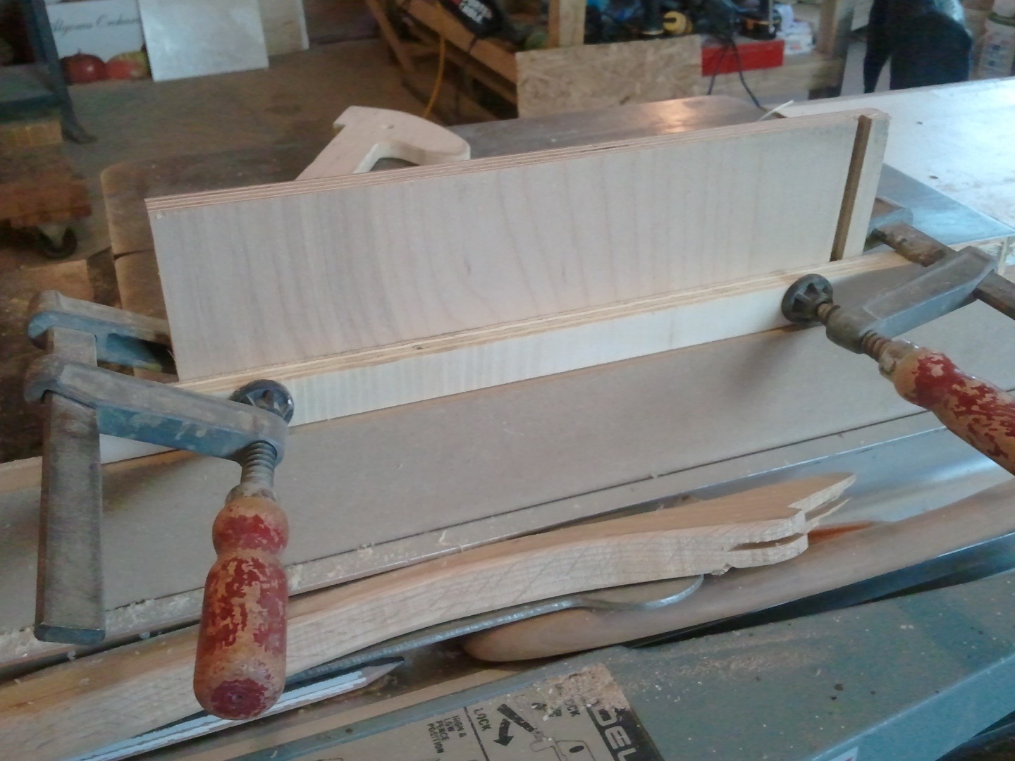

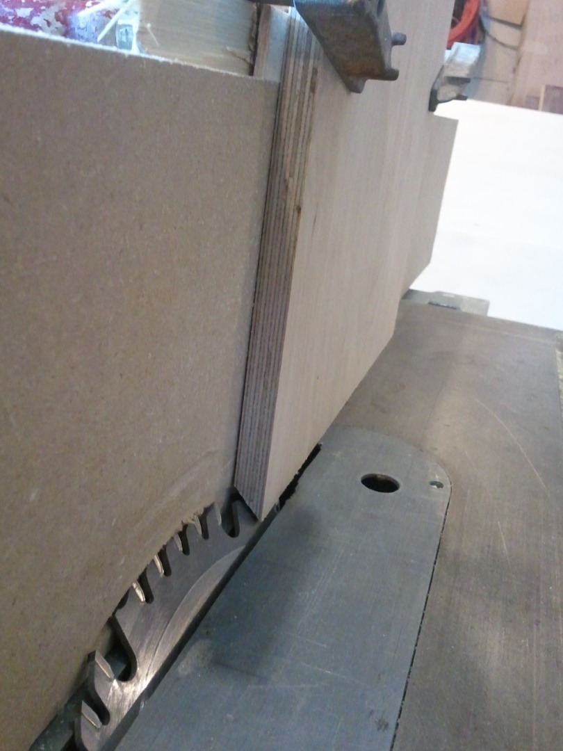

So I will share a little trick.
If you need to cut a secondary angle on the edge of boards. Such as the top and bottom boards of the horn in this example you can do it like this.:
https://drive.google.com/folderview?id=0BxsgqQl3NiLuTmxxdzFZaGtneGM&usp=sharing
The pics are in this file. I showed this little trick to someone a while back.
It requires a sacrificial fence, the MDF board with the wooden hook and wingnut in it.
And a little patience in setting up the angle and saw blade junction which is cut into the sacrificial fence a bit.
It allows you to put an angles secondary cut into any shape you choose. Even a convex round if you are patient with it.

See if you can figure it out.
This allows very acute angles to be cut, and still do it safely. Top clamps are clamping a guide board to the board that you are cutting so that it doesn't drop into the blade as you finish the cut.

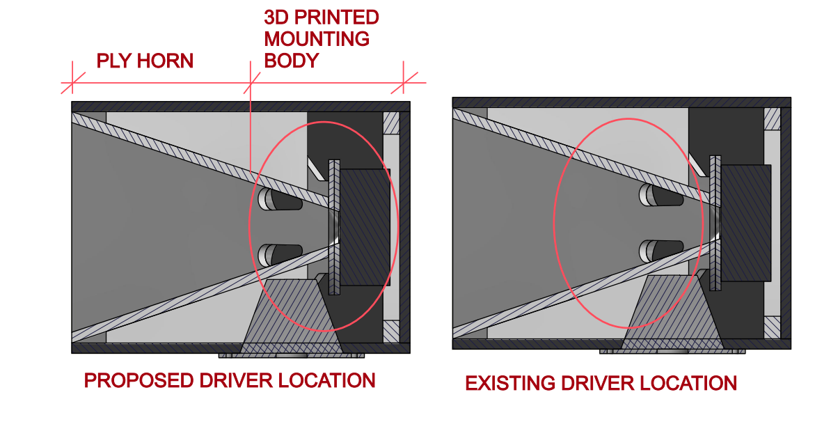

Art: At this point it seems like 3D printing this design is a thing now, and its making me wonder if your design still needs to be based on its original plywood construction method? For example can you see any benefits of having more organic fiberglass type bevels in the horn etc, now that this new medium is taking hold?
It would be really cool to see if there was a way to gain some construction efficiency, by 3D printing only a "central" assembly or "body" where all the drivers are attached, then transition to ply horn flairs, large or small versions.
Is there any restriction to the "length" of the phase plug exit path? For example if the length became long enough to effectively be called a "tube" or port if you will.. would there be a negative impact?
If not, then the LF drivers could be pushed back in depth, in the cabinet, and a central assembly could be printed more efficiently. IDK just a thought

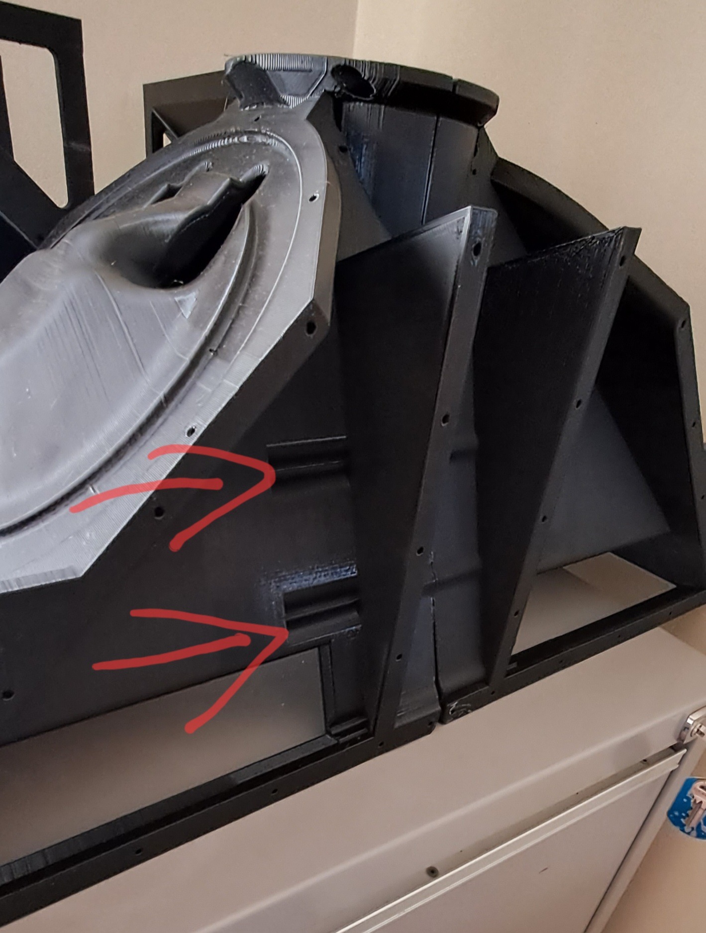

SynTripP horn 3d printing is certainly a thing thanks to Mr Speakers but for me at least its not been an easy thing with a budget home printer setup. I've found it quite challenging and expensive to tune and run - probably a lot harder than I realised. It also takes over three days to print a half so its reasonably inefficient as I think Mr Speakers warned at the outset all those posts ago. So the idea of more economical use of materials while allowing printed shapes which are harder to make in wood is pretty appealing.way to gain some construction efficiency, by 3D printing only a "central" assembly or "body" where all the drivers are attached, then transition to ply horn flairs
There are some very clever and resourceful folk on this thread, not least the talismanic Art Welter, so I imagine anything is possible. 🙂
The SynTripP two part conical expansion was based on relative ease of build with the relatively good polar response.Art: At this point it seems like 3D printing this design is a thing now, and its making me wonder if your design still needs to be based on its original plywood construction method? For example can you see any benefits of having more organic fiberglass type bevels in the horn etc, now that this new medium is taking hold?
Printed designs could be made with curved profiles with smoother and more even polar response.
I think combinations of 3D print, plywood and "bendy ply" could give the best performance/$$/ease of construction ratio for DIY MEH builds.

Pipe resonances as a negative impact come to mind, though I'm not sure I understand what advantage you are looking to achieve.Is there any restriction to the "length" of the phase plug exit path? For example if the length became long enough to effectively be called a "tube" or port if you will.. would there be a negative impact?
Art
The thought was if the woofers were moved back in the cab, then there would be less area to print. All of the tricky parts could be centralized and printed, and ply added for the horn and braces.
I dont have a top section view, but I believe that if the drivers were moved back it would require the phase plug openings to be extended in length, in order to fit the drivers around the CD.
As of now people are talking about days of printing LOL not hours..
These are brave folks putting the printing time in, but I cringe when I see a giant brace slab being printed. Would love to see "pockets" in the print that accept 90d ply ends for skillsaw simplicity of wood working, and have some kind of nice threaded inserts for easy wood to plastic interface assembly.
At what length and shape does a phase plug opening become a resonating port? And how to prevent that or even use it to your advantage?

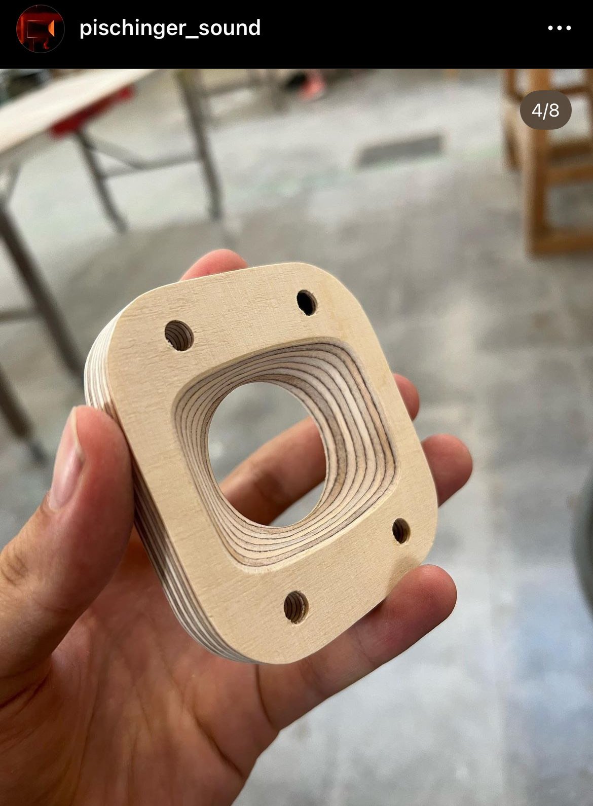

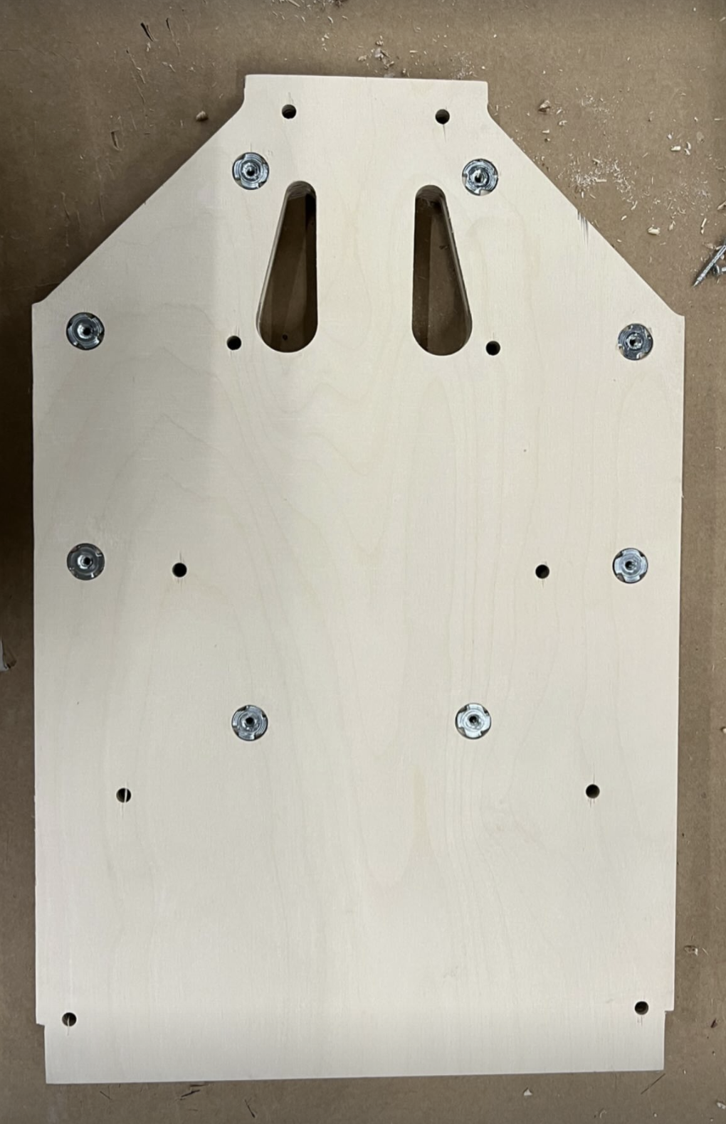

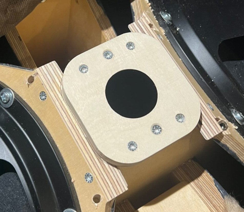

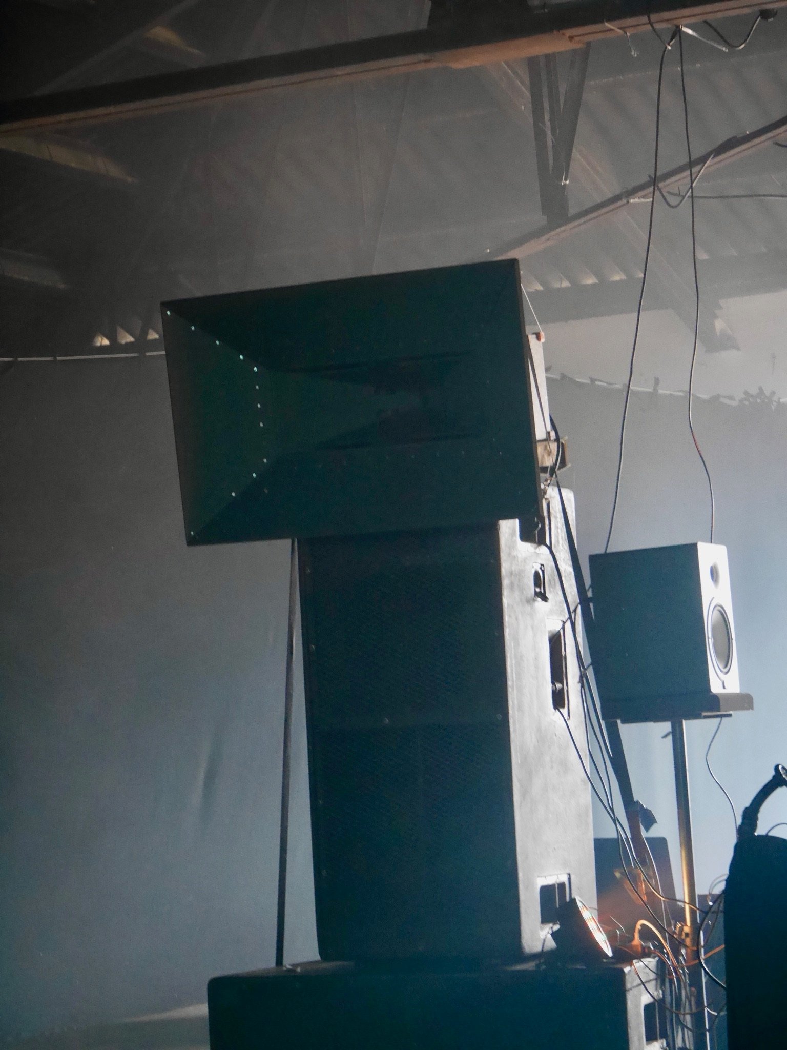

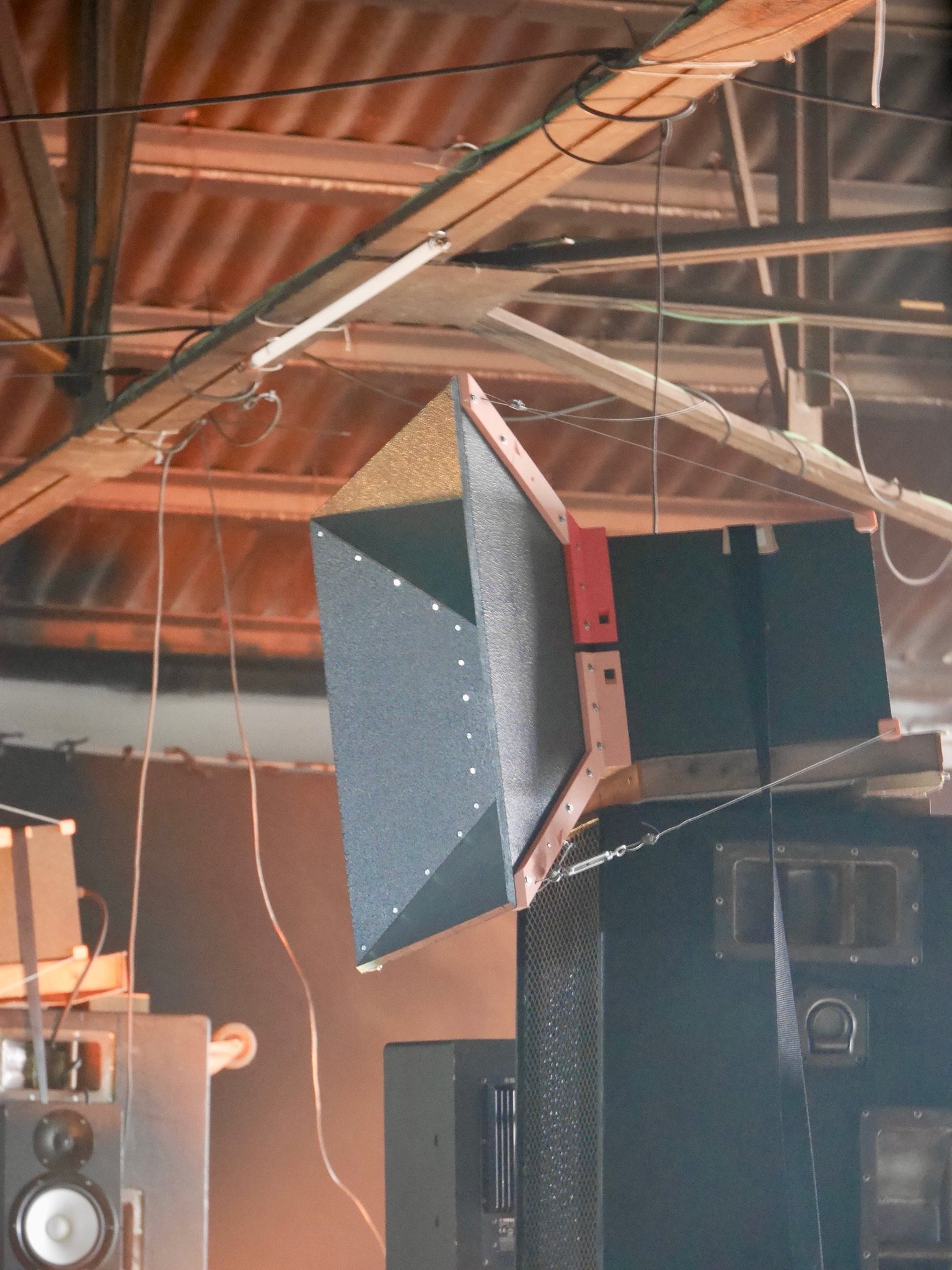

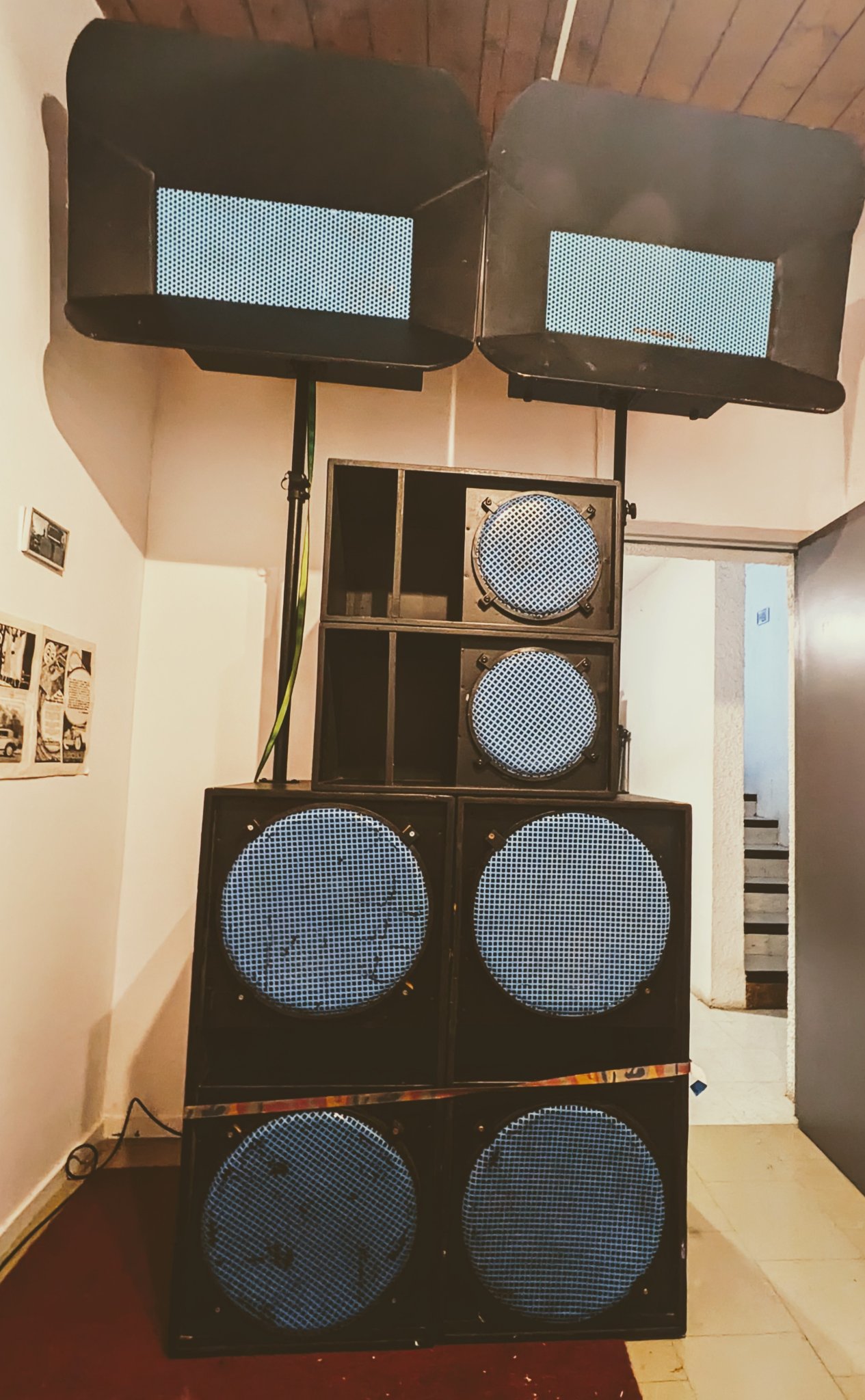

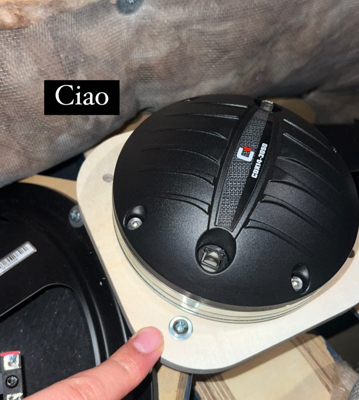

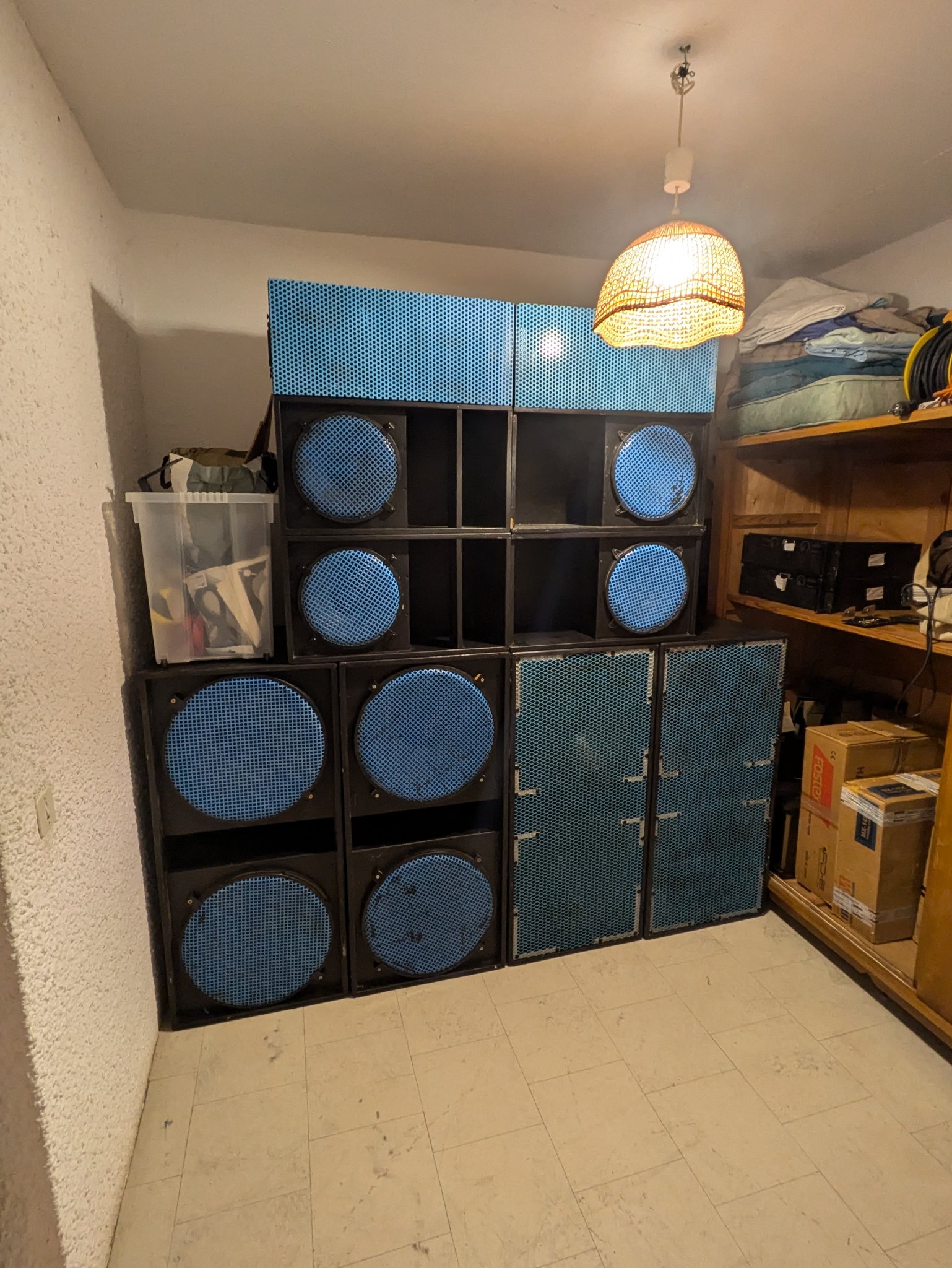

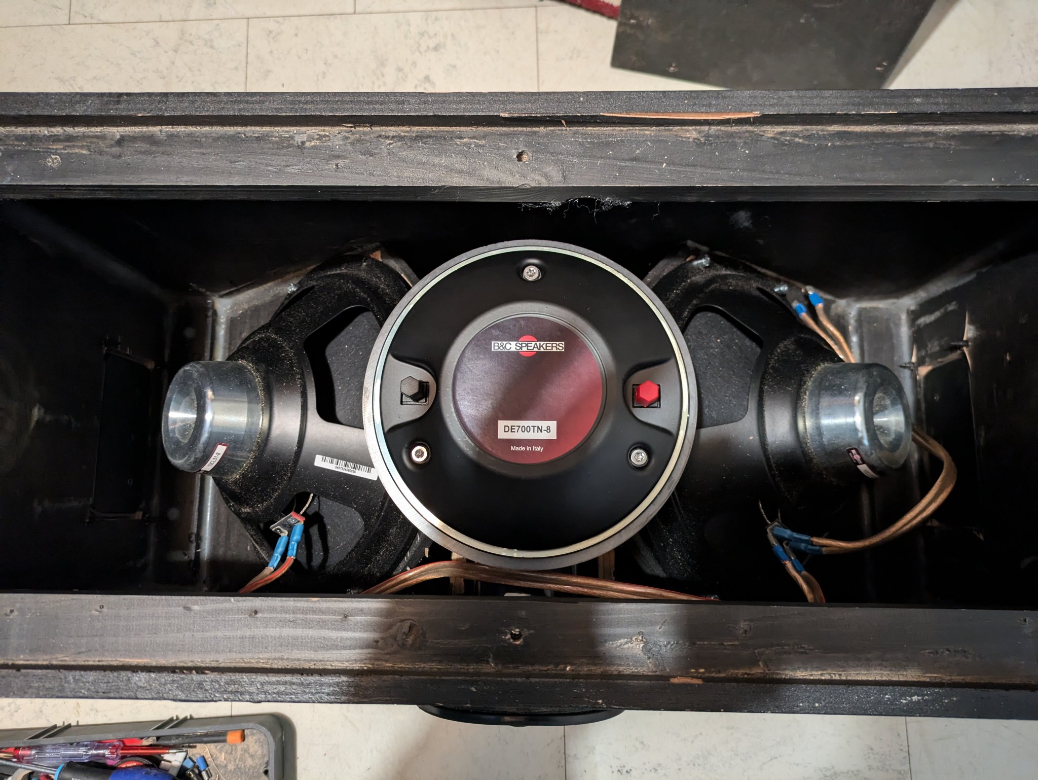

With no synergy speakers available in Barcelona at the time (end of 2022), I tried to build a pair.
I modelled the 3d in Grasshopper, which saved quite time when making adjustments.
After long hours of tinkering, I finally completed the pair.
When my friends organized a 10-hour music event, we played them, along with a borrowed 18-inch subwoofer. Genres were bouncing around bass, dubstep, dnb. The speakers’ directivity and fidelity were remarkable, even in a large, reverberant, acoustically horrible warehouse. The sound was just so real, dynamic, present yet effortless. Eh.. Wow...
Thanks Art!
I am massively thankful and inspired by your sharing!
I couldn’t have done it without the energy that dwells in this thread.

For those interested, I’ve organized posts into a set of instructions per speaker part. Feel free to explore:
Speaker Assembly Instructions

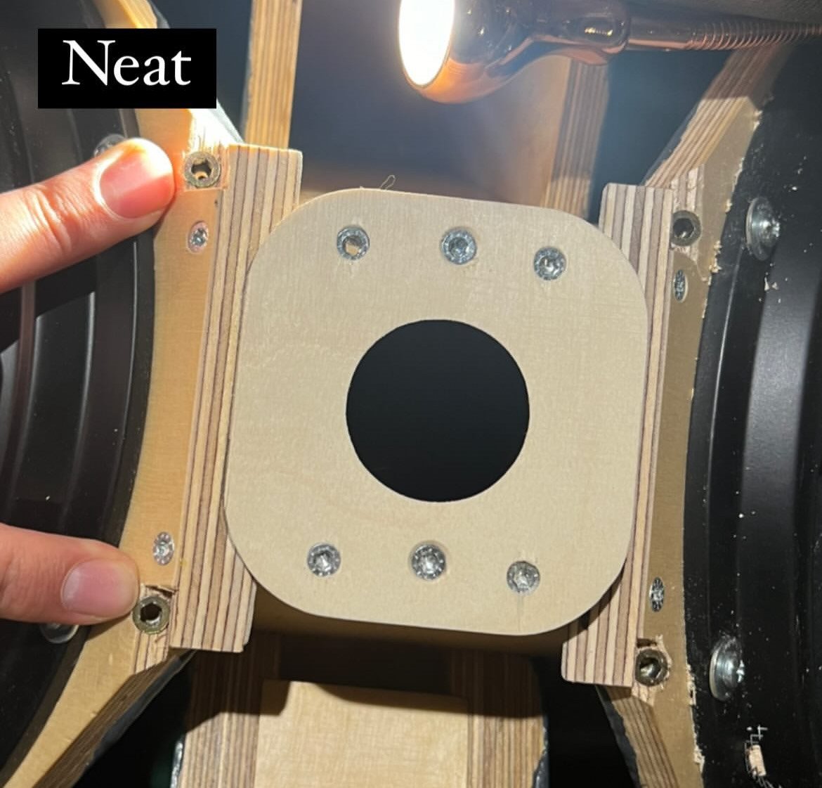

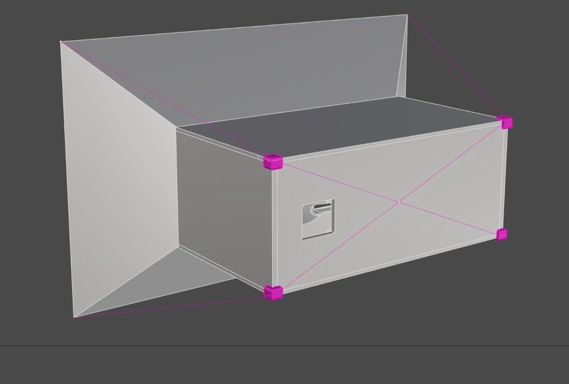

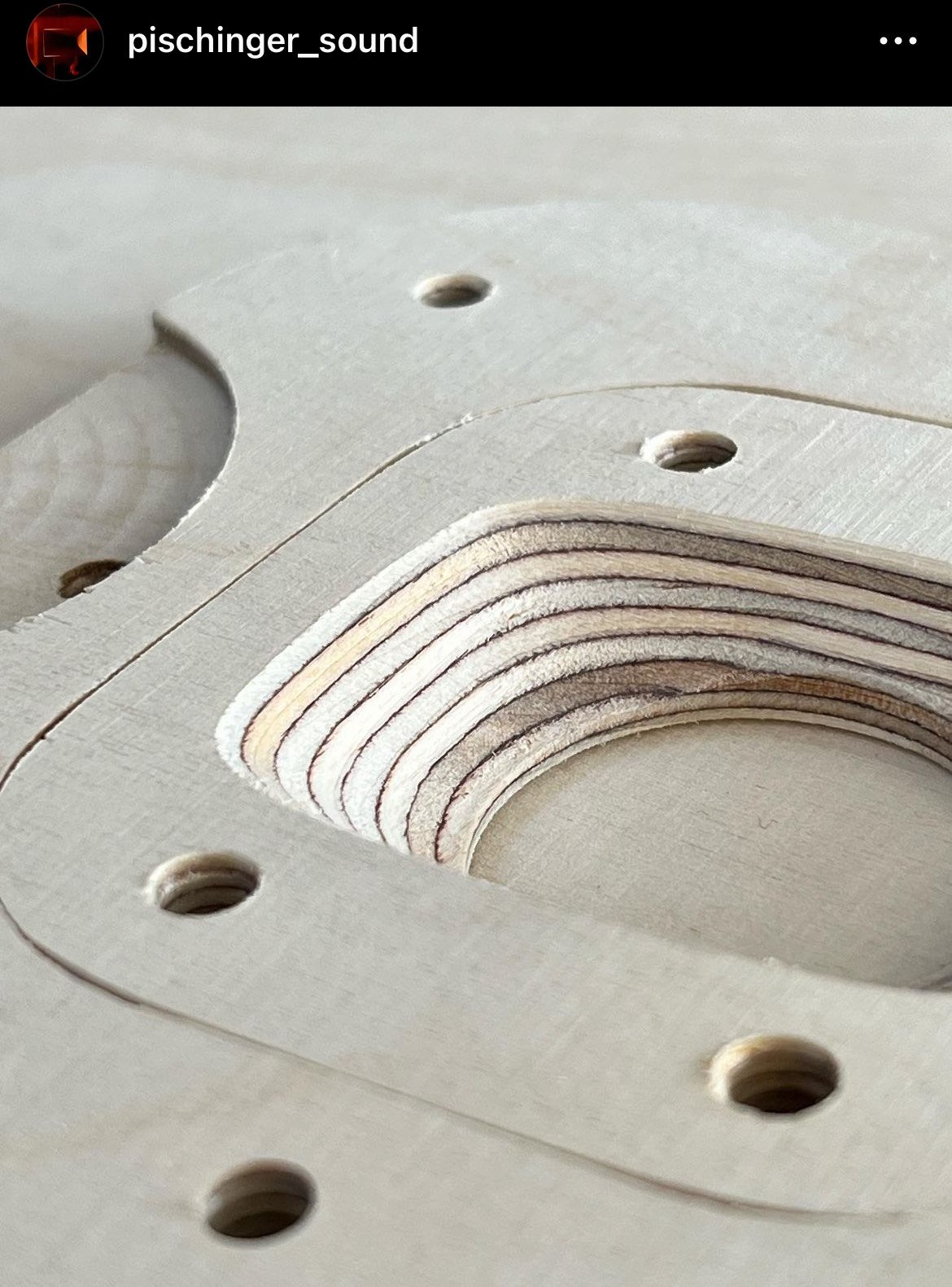

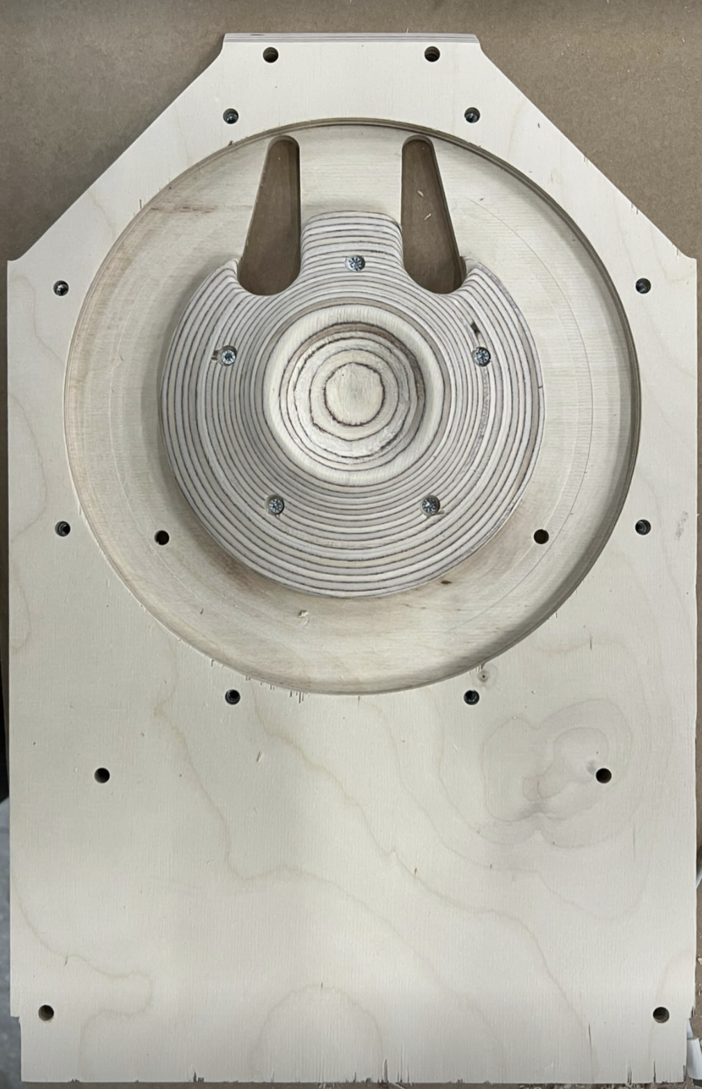

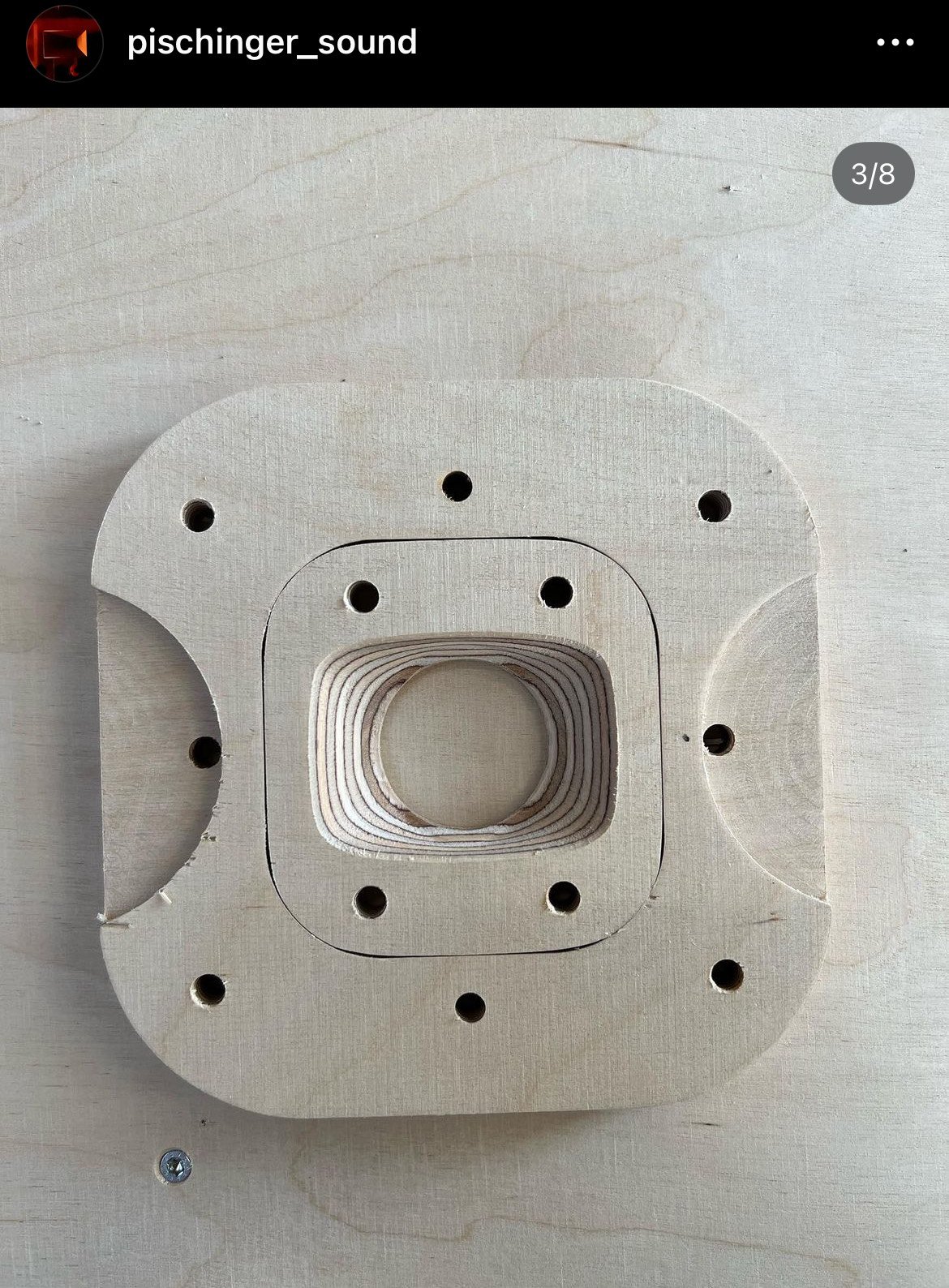

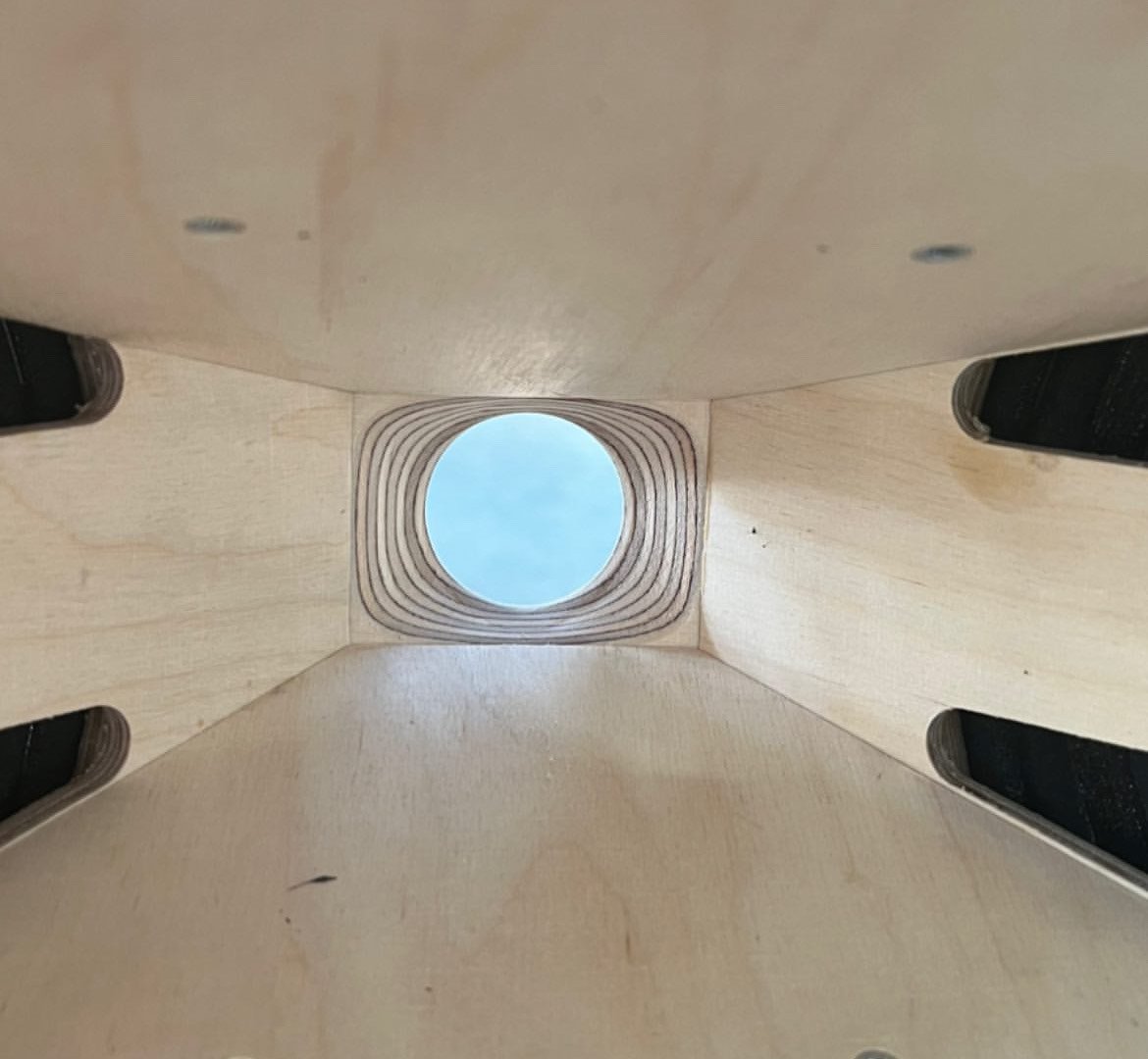

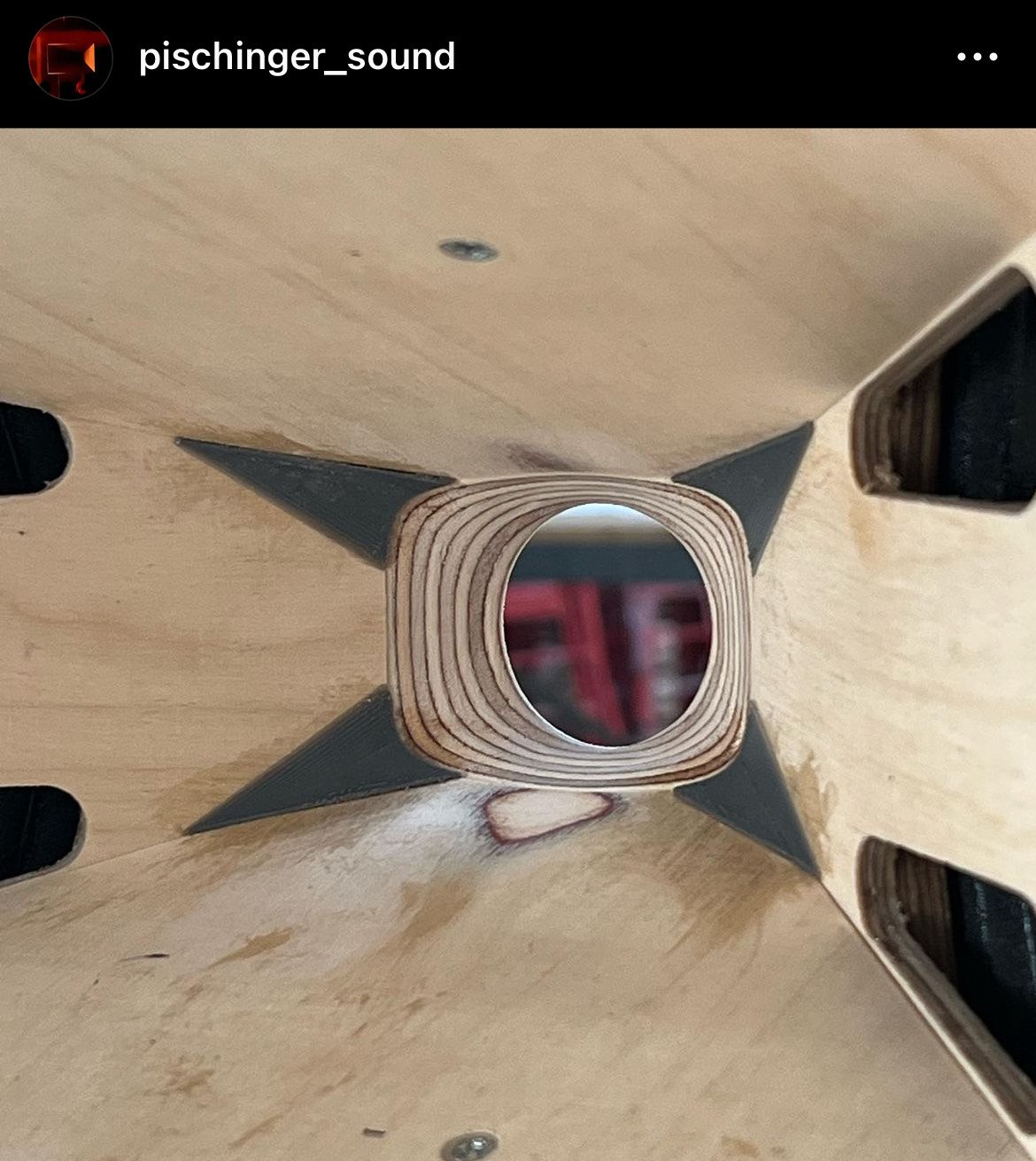

The hardest modelling part for me was the TAP so a couple more pics on it.
Paweł
Paweł
