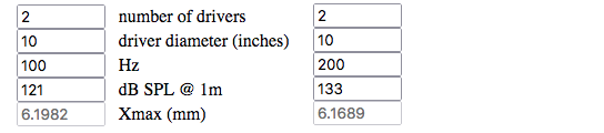

There is no horn gain at 100Hz, 2x10" can do ~121dB at 6mm excursion, while at 200Hz could do over 133dB, but would probably smoke the B&C 10CL51 after a short time at that level.

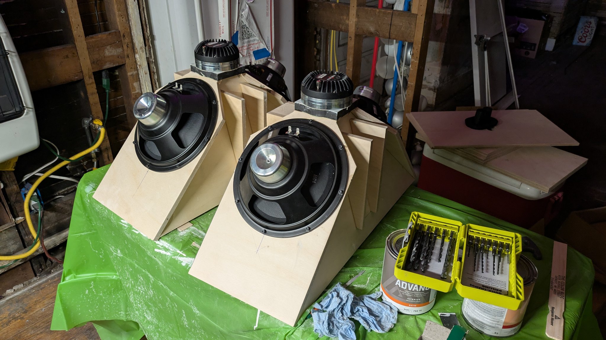

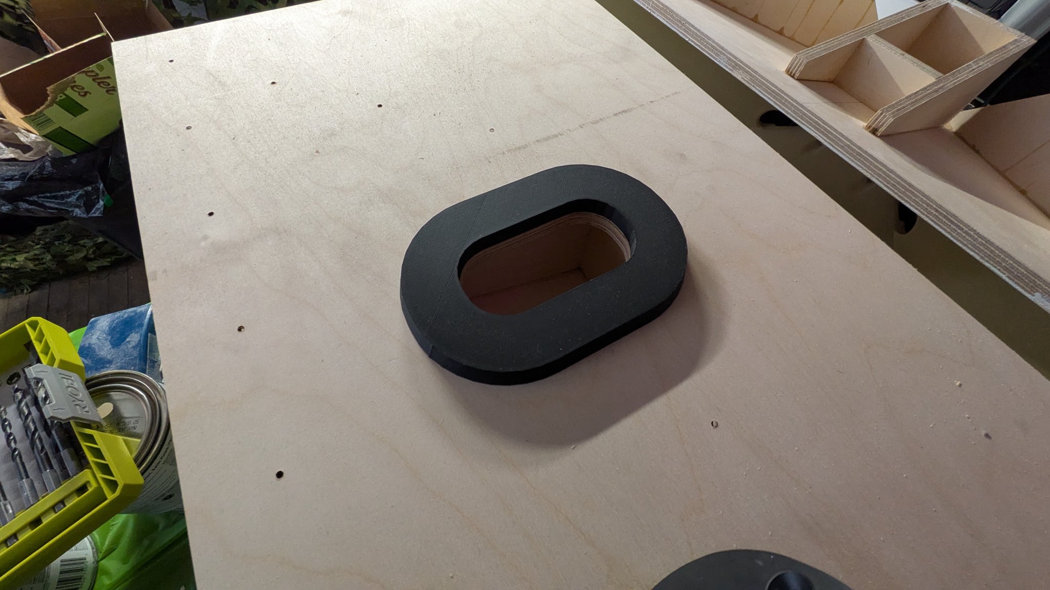

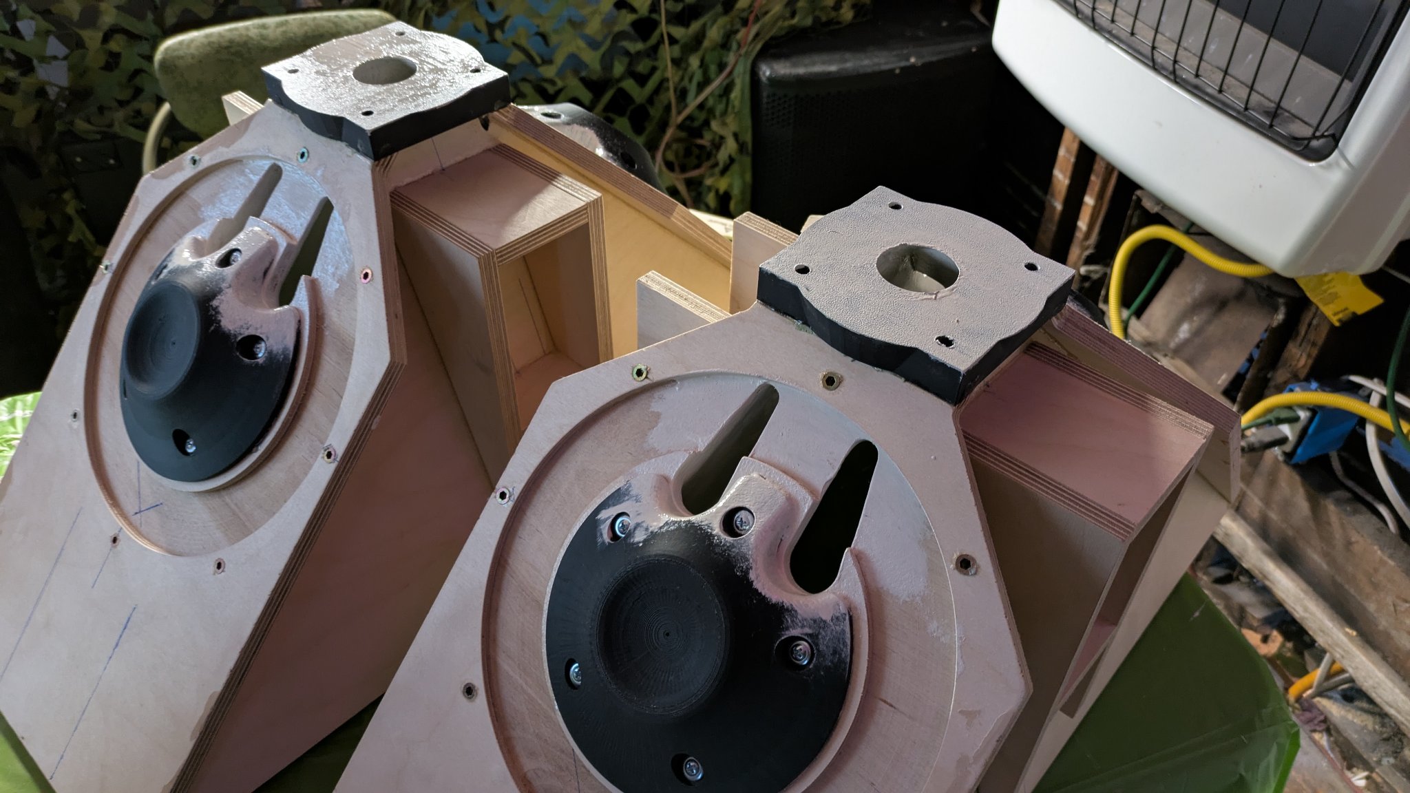

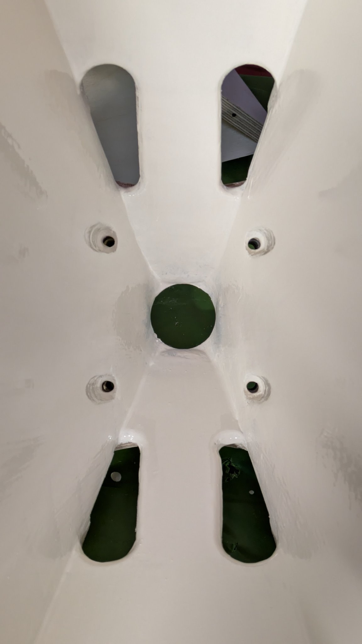

Build pics!

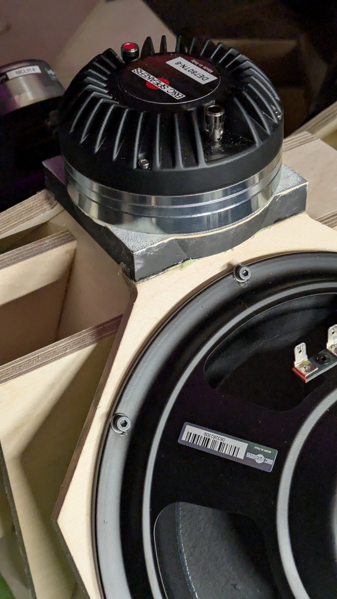

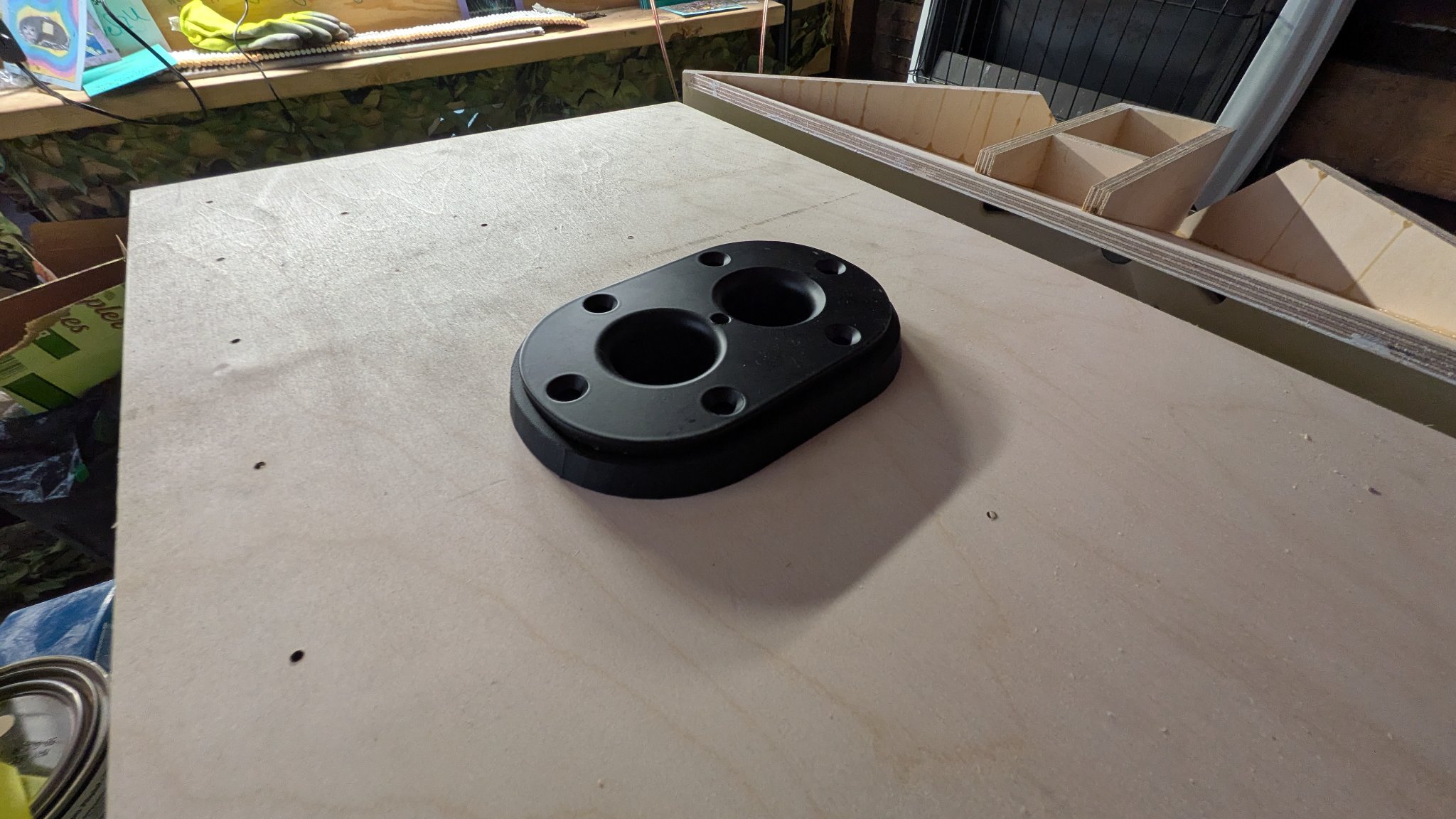

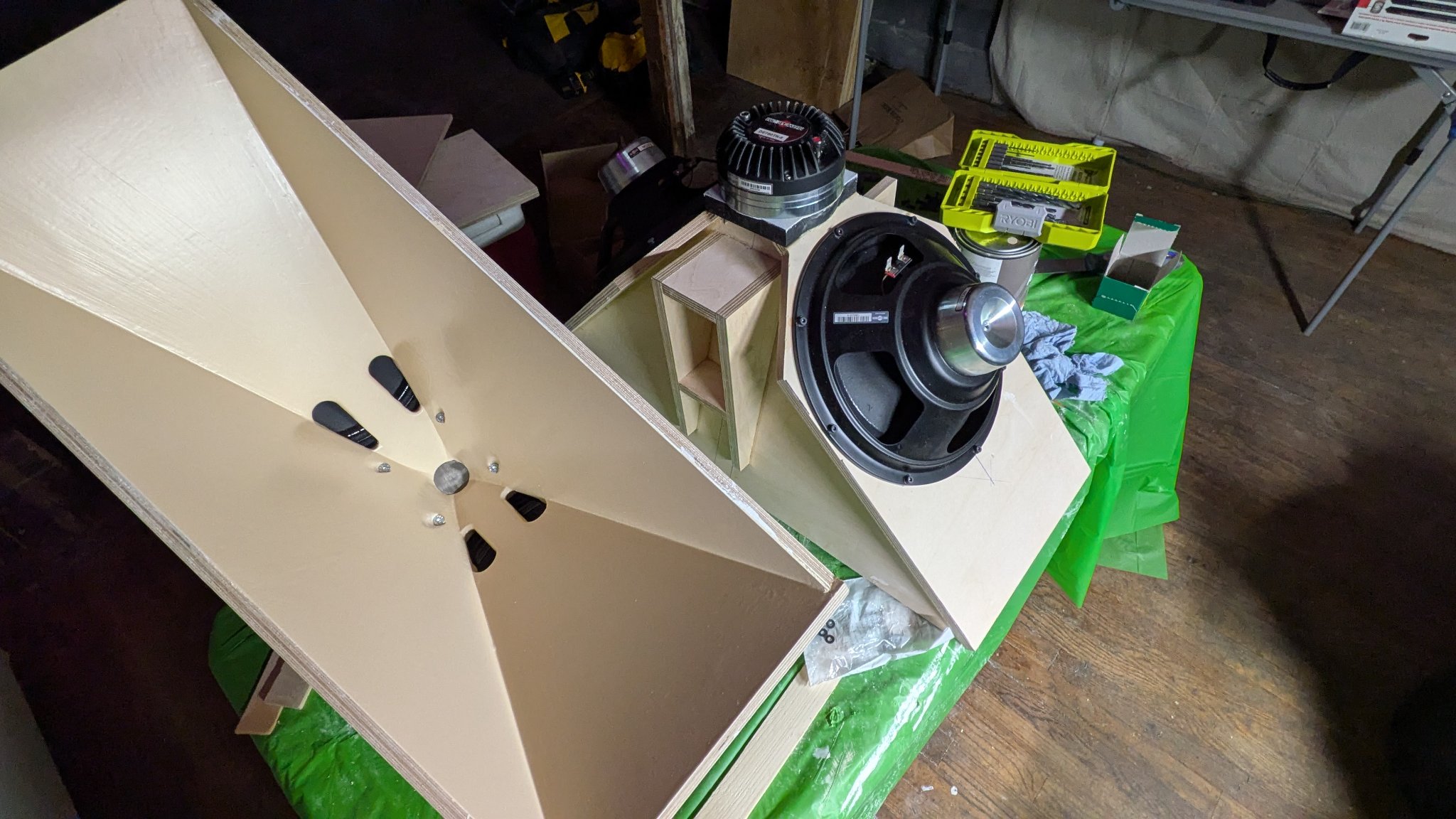

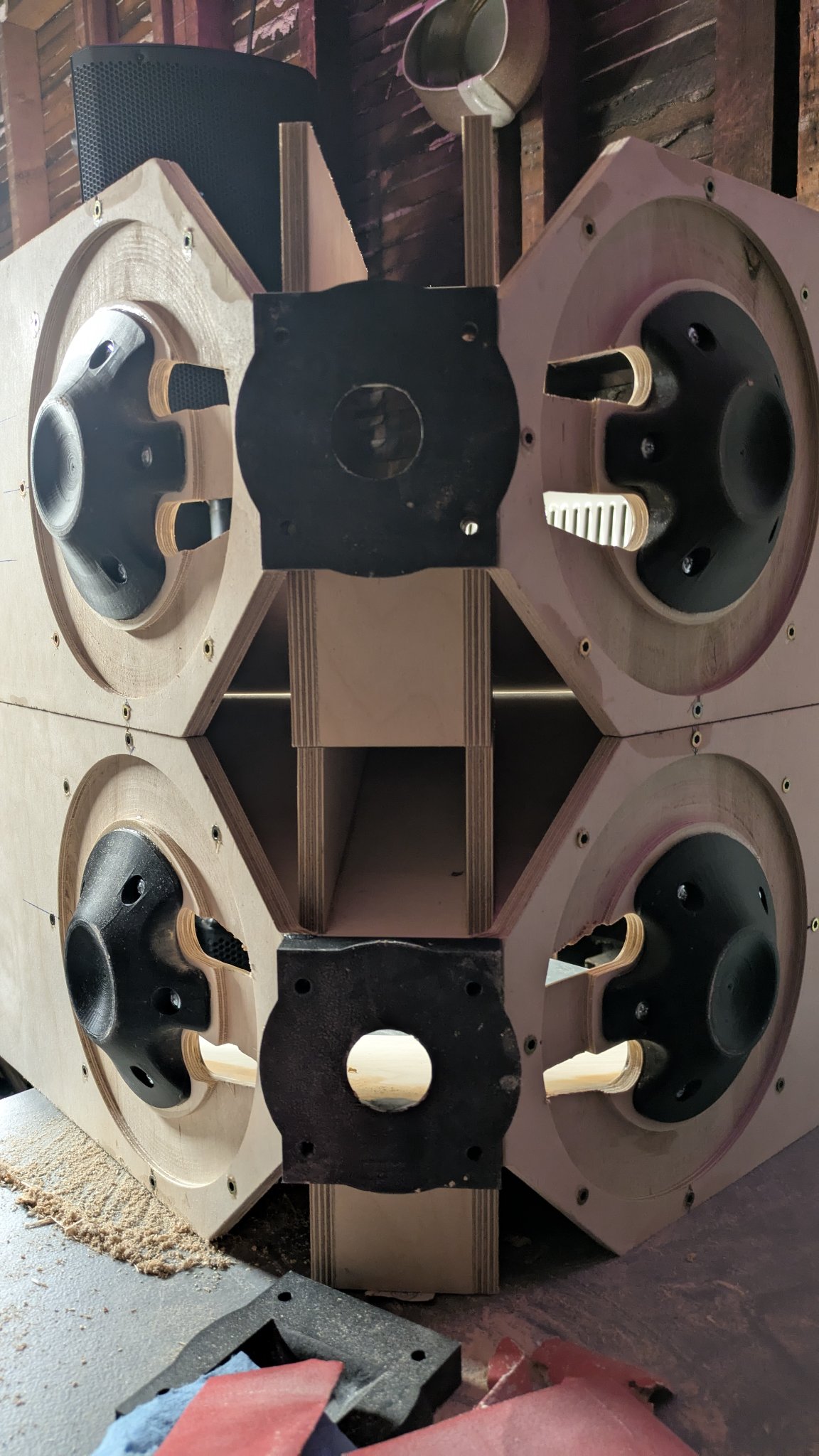

I modelled everything based on Art's dimensions, and generated my own cut sheet because I wanted to KNOW that everything would fit. So far so good.
3D printed the throat adapters, cone plugs and spacer for the pole mount (this needed a slight lift as it was hitting the back of the lower horn wall).
Next steps are to install baffle material on the inner walls (carpet underlay ok?), rout and drill for handles, fly points and speakon connections, and wire up before final assembly.
Stoked to have made it this far relatively smoothly!
I'll upload my 3D model and cut sheet at some point.
P.S. drivers are 10CL51 and DE780TN

The old-style felt/jute type carpet underlayment is very good for damping/absorption, but closed cell foam as is more typical now won't work for that purpose.Next steps are to install baffle material on the inner walls (carpet underlay ok?)
Your build is looking good!

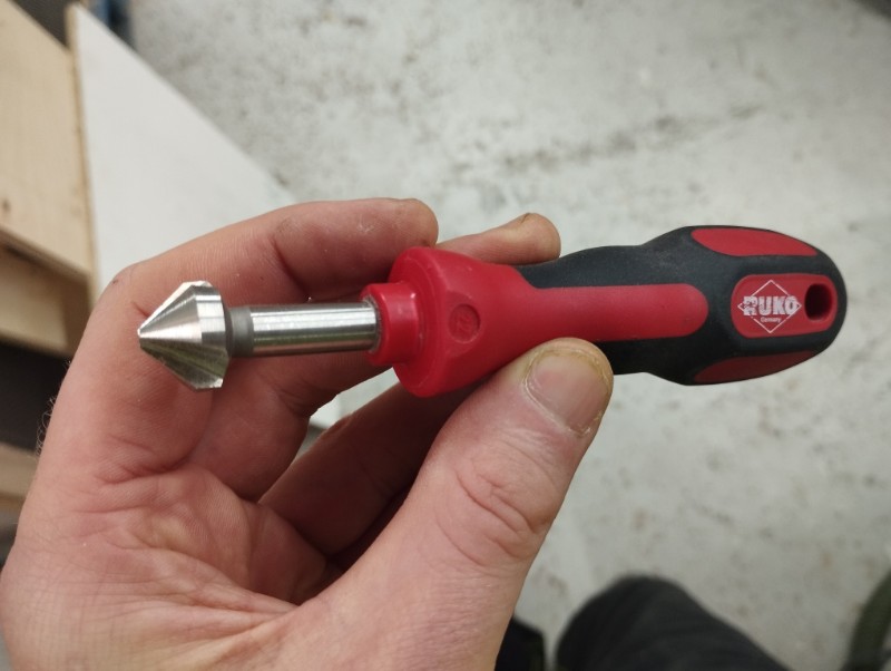

One constructive comment : some of your threads inserts for mounting the 10CL51s look like they're not flush with the material they're inserted into. This means the speaker won't be pulled completely tight against the baffle.
You can use a tool like this to cut an extra millimetre around the mouth of your hole so that the lip of the threaded insert sits inside the material and everything is nice and flush.
I use threaded inserts all the time in my cabinet making day job and this little step makes all the difference to how well they work (and how neat they look)
Hey Farty, thanks mate!
Ya I know, and I thought about this. I think it's ok though. We're talking a fraction of a mm and there's plenty of gasket on the speaker rim inboard of the inserts, that I'm confident has squished down around these small protrusions. The driver is fully seated down to the metal rim externally, and there's a void in the gasket at each hole anyway. I'll pull one and check though, and maybe just file the inserts down to be sure. They're epoxied in now.
Sounds like it's gonna be fine 😎
Looking forward to seeing the finished builds!
