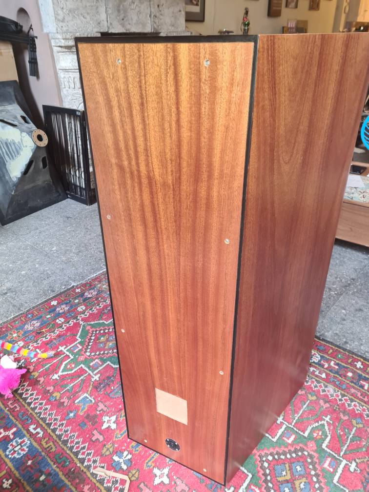

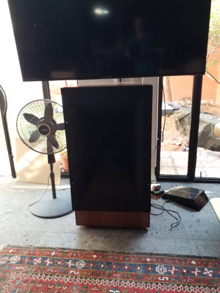

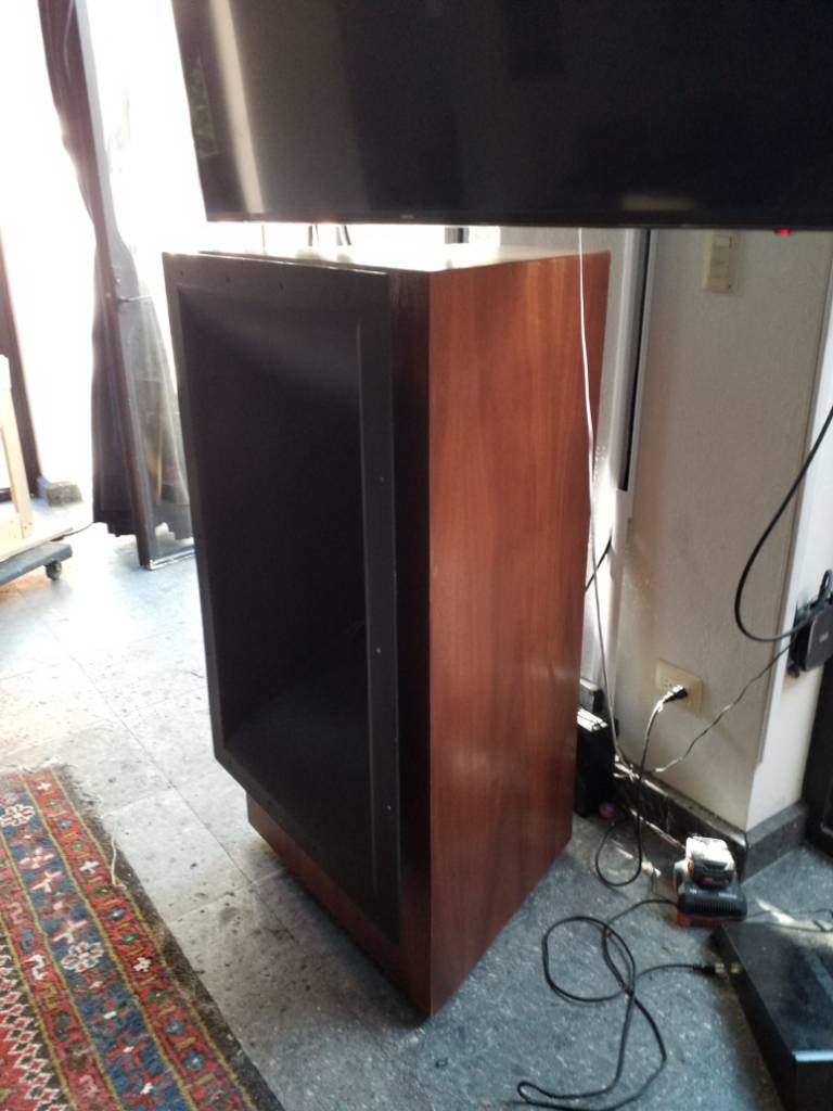

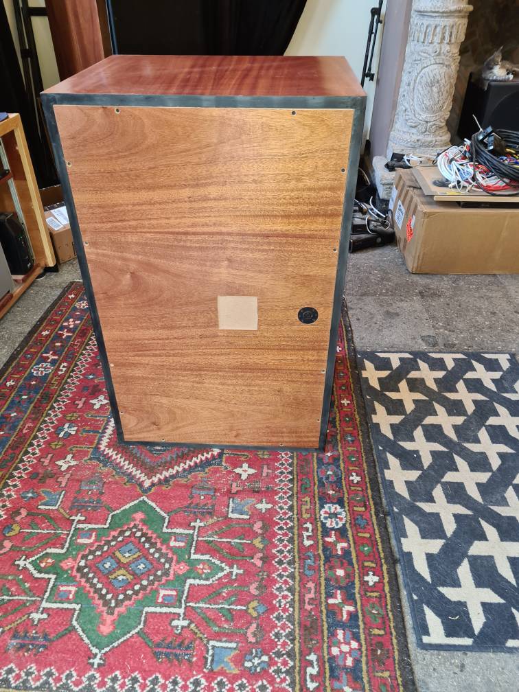

I decided to make a cabinet for the center (as I figured a cabinet would make up for the gain the left and right had by being in corners, and I was right...we will see how much better they get when they are completely tuned.), and I like the way it turned out so... I will be building a cabinet for the left and right channels too. I am currently waiting to get my amp built, and then I will have Chris A.. tune them for me. Right now I am using a partial tune that was done with them as a open back version. Even the way they are now sounds even better than the open back version did, and it sounded pretty good. I hope to have the amp done early next month followed by 2 more cabinets by the end of August.
Several updates not seen in the pics...
35 degree chamfer on the ports for the woofer size...which gives the angle about 1/8" from the horn to the face of thewoofer side of the pads. I will see if I can dig up a pic of this to make it clearer.
I lined the entire inside of the cabinet with 2 layers of 80 mil of Noiko mat, and then a layer or 150 mil Noiko Red closed cell deadening foam. I used 36sqft of the 80mil to get 2 layers, and then did 1 layer of the 150mil. I am also using the 150mil to seal the removable rear of the cabinet.
I am using a single Speakon 4 connector for the speaker connection, and hockey pucks with felt bottoms for the feet.
