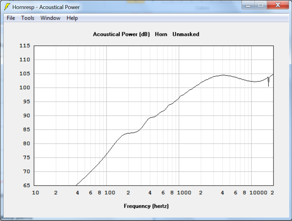

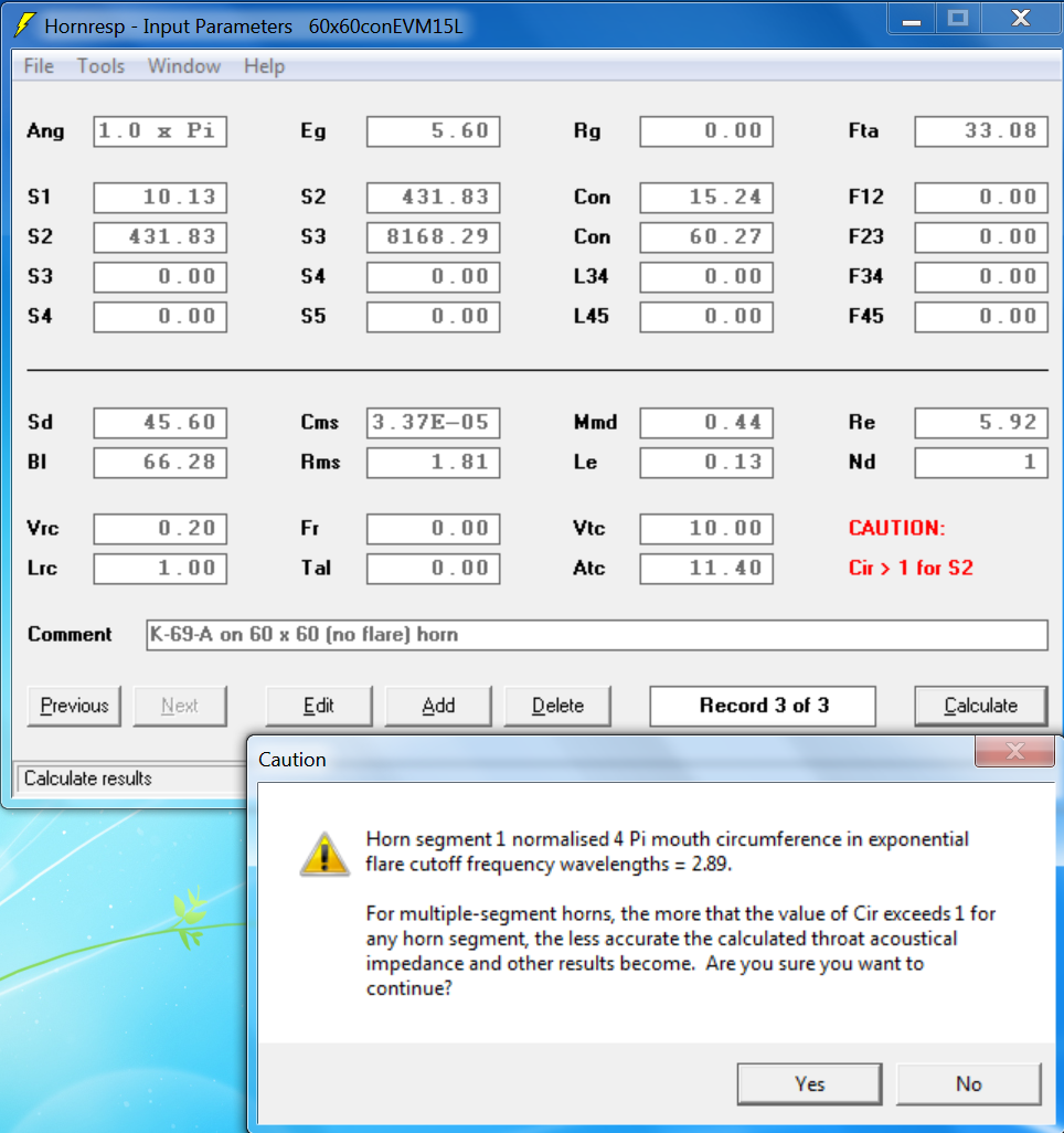

OK, this is what I have so far...
[URL=http://s1065.photobucket.com/user/ellisr63/media/calc%201st%20pic_zpsmemq1lce.png.html]
and for HornResp...
[URL=http://s1065.photobucket.com/user/ellisr63/media/hornResp1_zpsiqpqcexj.png.html]
Where can I find the info needed for hornresp for the EV DH1A that are needed for Sd, Bl, Cms, Rms, Mmd, Le, and Re?

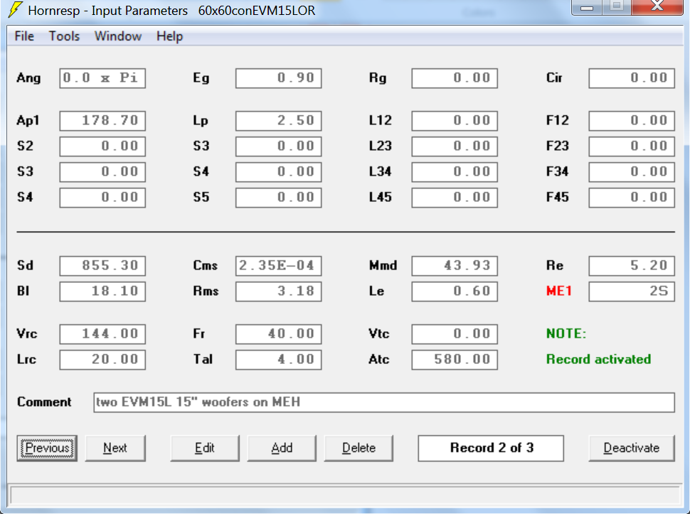

You have an S5 error in your Hornresp screenshot above. Remove the S4 value in the box circled red in the picture below and it will go away, you already have the S4 value included in the other box up and to the right

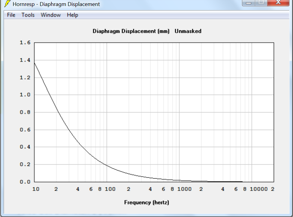

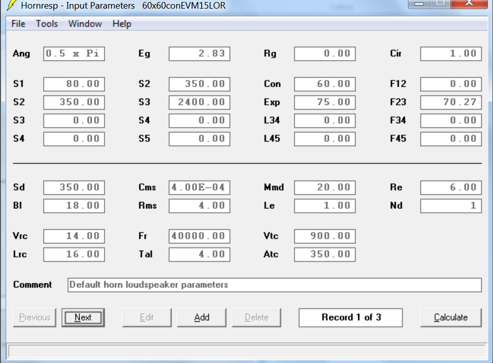

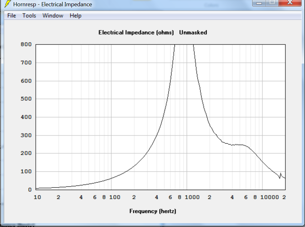

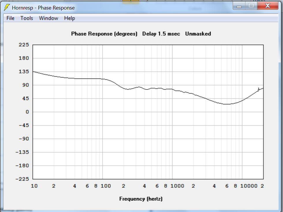

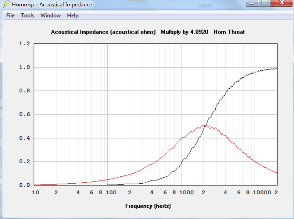

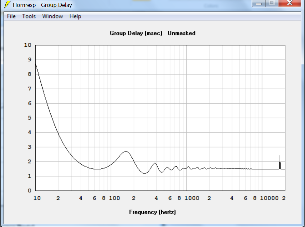

Here is what I have so far... Does this look right? Suggestions?
Here is a link to the SynergyCalc, HornResp file, and images.
Getting that simulation up is a great start!
I see you are modelling horn walls, or at least woofer ports, that are an inch thick. You don't need to do that for rigidity; .5" walls with bracing are probably better. In addition though, the shorter the woofer port length, the better because the needed port area scales with port length. Many of us thin out the area near the port holes - frustrums.
You will be able to see the effect of hole area and length if you do another simulation of the woofers as offset drivers on your horn. Then look at particle velocity and reduce the hole size until the peak velocity at max volume gets too high - like in a bass reflex vent. When I did this, I found that if I halved both the hole area and the port length, the velocity saved the same. If you make the holes too small, you will see the low end response suffer somewhat.
You have Vtc in your ME1 model set to zero. This is the volume of air trapped between the cone and the horn wall. There is probably enough air there to pull down the high end of the woofer below 800 Hz. You need to estimate that volume, then include it in the simulation. Most likely you will need to fashion a wooden plug to take up most of that volume to support a >= 800 Hz XO.
You can also vent the rear chamber of your woofers to bring up the low end. I did this and it looks like your woofers are good for a 40 Hz tune.
