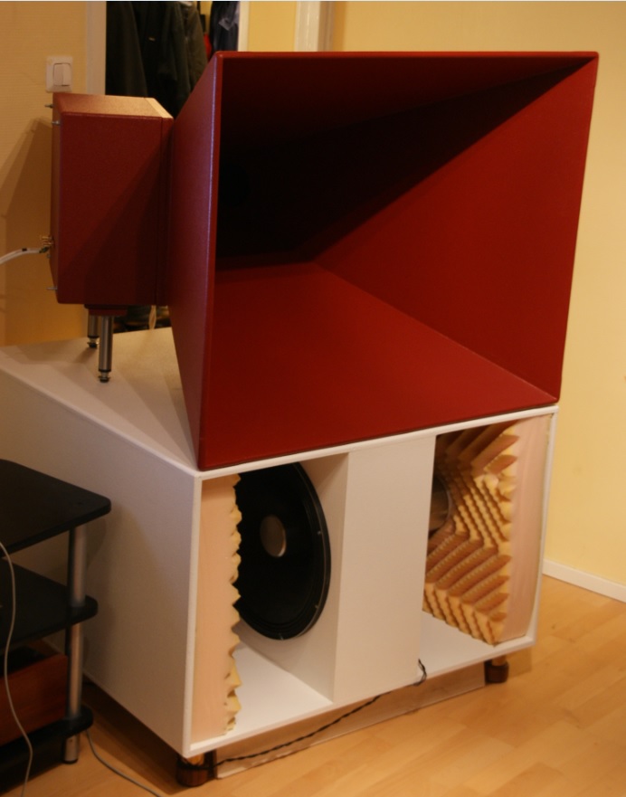

Here are 3 design possibilities I like... The first one is my favorite. The 2nd one I like, but I don't want to have to use a bass bin.
Questions:
Pic #1, I like the tower style, but will it have reflection problems due to the flare going to the ceiling and floor?
Pic #2, could this be a solution for me, without a bass bin, and getting down to 40-60Hz?
Pic #3, another variation of #1, but I would not make it out of plexi.
I would be making them out of MDF, and at most painting them a color for a finished look.
Suggestions?

I'd recommend downloading the spreadsheet and seeing what kind of dimensions and coverage angles give you what kind of performance. It just takes a few seconds to play, less time than typing in questions here. (If you don't have Xcel, then there is a freeware alternative -- see the first sheet of the pdf file for Synergycalc).
40 to 60Hz isn't going to happen within the range where the horn gives any gain or pattern control in a 36" horn, but you can still get output down there, where the assembly will then act like a sealed or ported box below the horn's pattern control frequency. True bass horns are monstrously large!
It is possible to feed the horns via a port/length, but you absolutely need to model it (in HornResponse or Akabak) before building. Just "winging it" would give about zero chance of working. Also, the feed port length should never go above or even near 1/4 wavelength at the driver's higher crossover frequency or you'll start to get resonant pipe effects from it (which might not show up in the models, btw).
