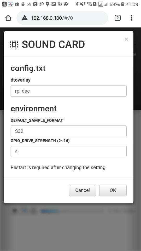

Hi vucv,
Didn't it work on i-sabre-k2m?
In that case, you have no choice but to use it as rpi-dac (DAC slave).
In case of DAC slave, /boot/dt-blob.bin plays an important role in setting up the PLL.
If you have renamed it, please revert it back to its original state.
Also, force_turbo=1 in /boot/config.txt is a big part of the performance design.
Make sure that force_turbo=1 is enabled as the default setting.
In the case of DAC slaves, the mpd volume control can only be set to a software volume.
By default, the volume control is set to "none" and the volume is always at 100% (-0db).
In the web UI, the volume is always displayed as "0".

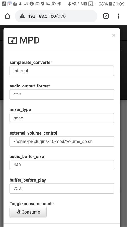

Open the MPD screen in the Web UI and change the "mixer_type" to "software". Press the OK button.

I tried rpi-dac before see your post which suggested to try i-sabre-k2m, so I did not try k2m.Hi vucv,

I will uncomment turbo setting, only dsd128 has some laggy, I guest because of buffer 640kb is small?

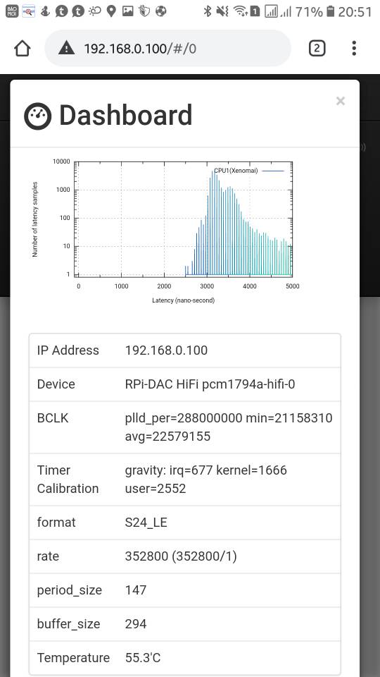

some pictures of my setting.
I do not stream music or using NAS. So I only want my pi connecting to wifi for remote control.

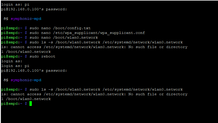

Following the instruction, but cannot create link.
Oh, sorry. My bad. command should be ln (not ls)
I changed the dac to i-sabre-k2m. 🙂View attachment 852543

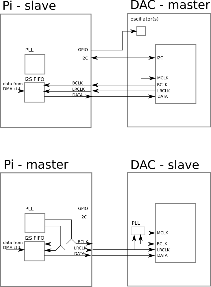

Hi M_Balou,
The I2S signals generated by RPi are BCLK, LRCK, and DATA.
MCLK is not used.
The DAC master/DAC slave switching can be controlled by the registers in the SoC.
That's the driver's job.
When the sample rate is switched between songs, the 44.1 KHz system and the 48 KHz system on the DAC side. The oscillator needs to be switched.
To do this, the DAC has an I2C interface that switches the oscillator used for the BCLK according to instructions from the RPi.
This I2C control is also the job of the driver.
If the DAC does not have an I2C interface, then what driver in dtoverlay will not allow you to run on a DAC master (=RPi slave). This is because the driver will not be able to communicate with I2C and the initialization process will fail.
If your FifoPi has an interface that can accept oscillator switching instructions, it may be possible to write a device driver for the FifoPi that will allow it to run on a FifoPi master (=RPi slave).
so, you can´t just use any existing master-dac overlay, because it needs to communicate with the dac.
thats unfortunate, but i allready suspected that...

Hi vucv,

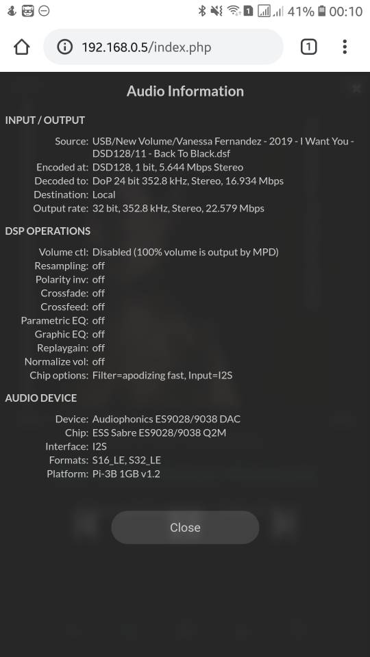

I'm glad to hear that the i-sabre-k2m seems to be working.
Please make sure that the BCLK column on the dashboard is labeled DAC Master.
Sorry for the inconvenience about the lag in the dsd128.
We measure the bandwidth by changing the RSIZE when setting up the NAS to estimate a reasonable RSIZE.
On rare occasions, there may be an environment where the measurement does not work and the RSIZE is not set to the correct value.
Enabling the USB port is deprecated and we have not tested playback from USB HDDs.
It may be possible to improve this by having the MPD in the web UI change the buffer size to a larger value, but few members are using USB HDDs and I don't have the know-how to improve this.

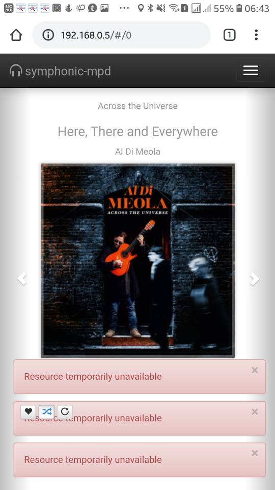

This morning I stuck at Timeout, resource temporarily unavailable. Cannot play any file. restart or shutdown button do not work. I have to hard reset, 2 times, but it still come up with the same.
Hi vucv,
Use the df command to check the free space on the SD card.
In v0.9.6 (RPi3), the expansion of the partition must be performed manually.

not full but I expanded anyway.Hi vucv,
Code:sudo raspi-config noint --expand-rootfs sudo reboot

Thank you for your prompt support.
I expanded the card and can play haft of a file then get the error again.
I collected log and sent. Please investigate...

commented direct_io in /etc/mpd.conf, but it's still has same error. [Timeout] and [resource temporarily unavailable].

the files are vary: m4a, flac, aif (dsd, 24bit 352.8KHz).
last night I can play for a very long time, but today I cannot. let me try with slave mode.
Hi vucv,
Open the MPD screen in the Web UI and set the audio_output_format to "*:32:*" .
Alsa-based playback software performs an implicit format conversion to match the format supported by the sound card.
Note that the symphonic-mpd playback software (aplay-rt) does not perform such format implicit conversions.
I'm told that the ES9038 only accepts 16-bit or 32-bit.
Therefore, I think it may not be able to play back 24-bit sound sources.
Hi vucv,
v0.9.6 (RPi3) does not work well with PCM conversion playback of DSD.
You can change the audio_output_format to "192000:32:*".
Fix the rate and convert to PCM on the SoX for playback.
If you want to play both PCM and DSD, v1.0.3 (RPi4) is recommended.
You can specify the normal PCM conversion format and DSD PCM conversion format separately.
For example, normal PCM can be converted as "*:32:*" and
DSD can be set to convert to "1920000:32:2".
(Of course, you can also specify DoP.)

It's not so clear how the master and slave modes work, so I made a diagram to try to explain it.
Upper diagram, Dac is master.
The Dac generates all clock signals. The picture as drawn would be for a pcm5122. There are two crystals on the dac board for the master clock (MCLK), one for the 44.1kHz group and one for the 48kHz. The driver in the raspberry controls which one is active via some GPIO pin. It also configures the dac chip to run at the desired sample rate. The dac chip then divides the master clock by suitable amounts to generate bit clock (BCLK) and sample clock (LRCLK). The Raspberry i2s interface runs as a slave, and outputs the next bit on the DATA line when triggered by BCLK. The i2s fifo is filled up as needed by the dma controller. The Pi PLL isn't used at all.
Lower diagram, Pi is master
The Pi uses it's PLL to generate a bit clock (BCLK) and sample clock (LRCLK = BCLK/64 in most cases). This BCLK triggers the i2s interface to output the next bit, same as above, and the dma controller also fills the fifo the same way.
On the Dac side, the dac senses what format and sample rate are being sent by checking the signals (the diagram is drawn with a PCM5102 in mind). If there is no MCLK supplied (which is the case for the RPi) it uses a PLL (built into the dac, not a separate device as drawn) to generate a matching master clock.
I believe it's correct, but please let me know if you find anything wrong!
Thank alot for your effords, Henrik.
that´s a really indepth explanation.
so, there´s actually no MCLK involved in the rpi´s slave mode, hmm...
is this a special feature of the PCM5122? Because it seems very unusual that BCLK and LRCK
switch from inputs to outputs.
and it´s quite disapointing, because i won´t be able to replicate this modus with the Fifopi.
