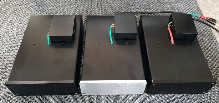

Wow... My jaw dropped, again, for the second time since when I heard my DAC with Volumio on RPi some years ago ! It really is mind-boggling that some smart software tweaks make sound this different, even more than changing the hardware gear. My big DOMOs to パパリウス san for this wonderful work, probably comparable to Max Kellerman san ! I heard this for the first time today, and will update this post after hearing some more days. A word for describing SMPD, it would be 'PRECISION'.
- samba : I moved my HDD to Mac and changed my NAS settings to Mac Share, and the problem is gone. Looks like smpd doesn't get along with Windows smb very well !
- Airplay : Well, something must have been 'lost in translation' on my audio settings... The sound gets a bit edgy and harsh and the result is less satisfactory when played over Airplay (ethernet, not wifi), to my ears. Though I'd much prefer Kodi UI and there's a tremendous advantage of watching video files in addition to audio files, I decided to stick to the native playing with Cantata front end.
For the reference, I use 3 diy DACs (1. Analog Device AD1865(R2R), 2. Burr Brown PCM61(R2R), 3. Asahi Kasei AK4495 (D/S), all run by RPi 3B via I2S. So smpd really is a custom-made solution for me !
