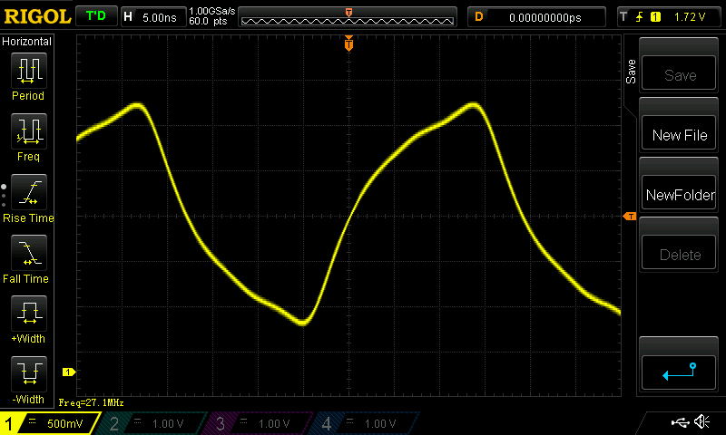

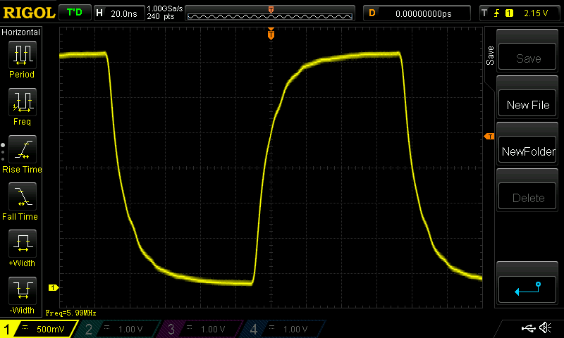

Automatically picked 54MHz crystal osc, no MASH, divider 2, bclk 27MHz. The trace is ugly, wires to my 100MHz scope are way too long. But the jitter is unnoticeable on the scope
Trace for 6MHz = 93.750kHz samplerate looks much better on the scope.
The test required trivial raising max_rate in linux/bcm2835-i2s.c at rpi-4.19.y * raspberrypi/linux * GitHub and using the same SNDRV_PCM_RATE_CONTINUOUS in linux/pcm5102a.c at e2d2941326922b63d722ebc46520c3a2287b675f * raspberrypi/linux * GitHub to allow any integer rate. The very basic I2S dtoverlay=hifiberry-dac
