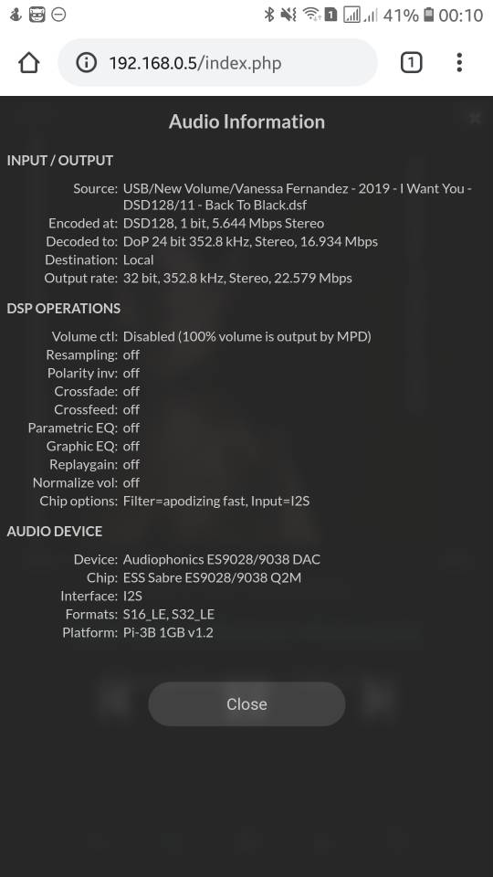

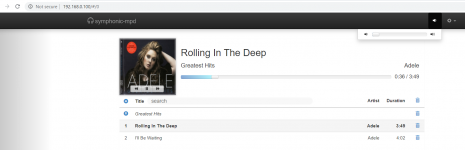

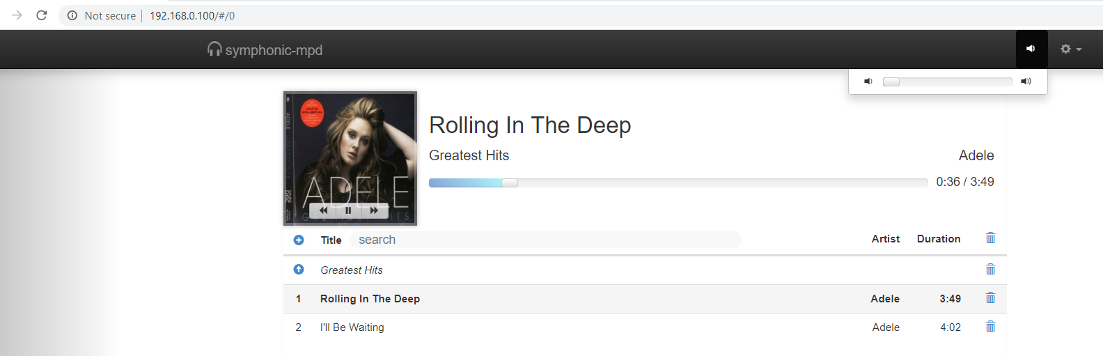

Hi Papalius, I'm trying to configure dac hat es9038q2m, using v0.96. I've checked at smpd forum, and it seems that you do not support es9038q2m, aren't you?
I also have pcm5122 dac hat. I will give it a try (slave mode), swapping dac hat a little bit weird because of housing.

Thank you, Papalius.
My Dac es9038qm2 has master clock similar to dac boss. (cloned one from China). I'm using normally with Moodeaudio.
I feed pi 3 by board lt1964 (max 1.5A), my external hdd in orico box has its own walwart ps. So I do not think the issue is ps.
I was suspected the micro sd card, because I flashed it by balenaEtcher, once finished flashing, at the last step, verification, my Windows got BSOD. anyway I was still able to boot with it. Let me try again.
Hi vucv,
Thank you for contacting me.
After configuring I2S in moode, check the dtoverlay in config.txt
We will try to support that driver.
If you have trouble booting, try these two things
1) Rename the file /boot/dt-blob.bin
For example, dt-blob.bin.bak
2) Comment out force_turbo=1 in /boot/config.txt
Please try these changes to see if they make a difference.
I have received reports of an error in checking the balenaEtcher.
(I've also heard that it works fine.)
I also use balenaEtcher, but I'm not sure how to reproduce it.

Hi vucv,
In v1.0.3 (RPi4), i-sabre-q2m is supported.
In v0.9.6 (RPi3), try specifying i-sabre-k2m.
It's a k, not a q.
It's almost the same behavior, so it may work fine.

I've tried rpi-dac, and it's worked. The volume setting made me confused (always at 0 level) but there is a sound output.
