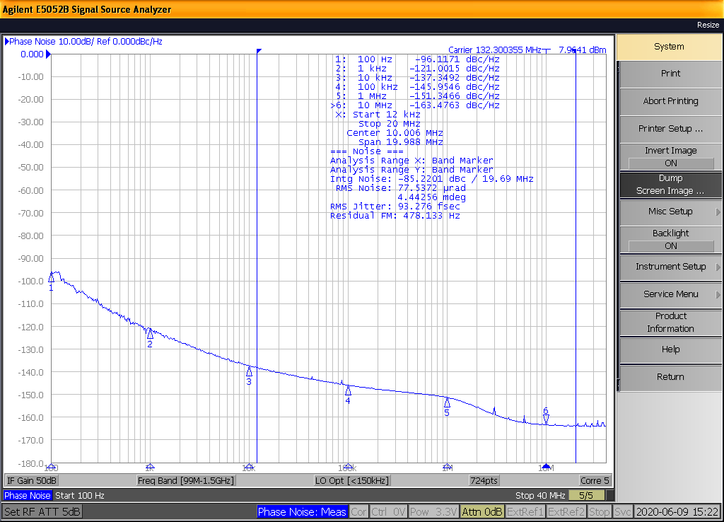

The sigma-delta modulator in most oversampling DACs ₍the actual place where DA conversion occurs) runs at master clock frequency, multiples (e.g. 8x) of the bitclock of I2S. Either the DAC (board) has its own master clock (then RPi's I2S is running in slave mode), or the DAC (chip) can/must PLL its master clock from the incoming low-frequency BCLK generated by RPi's I2S (or PLL an external clock to run synchronously with the multiple of BCLK). The PLL may produce a very different jitter than the incoming BCLK. This signal is not available on DAC pins.
IMO measuring the effect in the final analog signal is a valid method, especially for comparing various setups to find the one with best result in the analog domain.
Measuring clock jitter directly takes "just" a proper device, I just received a measurement report from Silicon Labs measuring rms jitter of 93fs.

See, here is the problem, that chart starts at 100 Hz, how about 30 Hz? or 10 Hz or maybe even 1 Hz? Thats where many clocks fall apart. They look nice at 10kHz (thats the most common frequency where a time (ps, fs) is given for.
But it's the close in noise that is also a problem. It causes sidebands. And this is what is so dangerous with "femto-seconds" figures...
To measure where it really matters is a really hard task and requires serious equipment and knowledge.
If your are a designer you need to be able to measure clocks, if you are a "customer", you are interested of the analog side i.e. sideband, distorsion, noise etc.
Then there it seems to be music correlated jitter that creates the biggest problem - random jitter not so much. To add to the complex, different D/A topologies (R2R, D/S...) have different sensitivity to jitter and just to end the whole thing... different chip products have sometimes built in strategies to clean out jitter as mention above.
It's a mine-field...
I would like to end to say again that the behaviour of the Pi hardware ert. clock (MASH?) is a pathological behaviour and is most unsuitable for serious audio equipment. If one has any ambition to create a well behaved product and to not start the whole project with a big problem - I would avoid Pi as the Covid19. The make excellent execution platform for signal processing but don't connect them to any audio HW.
Actually the Silicon Labs technicians modified my clock chip configuration to reduce the output integer divider for the DAC/ADC master clocks to get above 100MHz where the measurement does not drown in the instrument noise, from the required 20-40MHz.
Did you get phase noice reading for say 10Hz of your clock? Have you read Andreas thread about low jitter clock? - its often on the front page!
