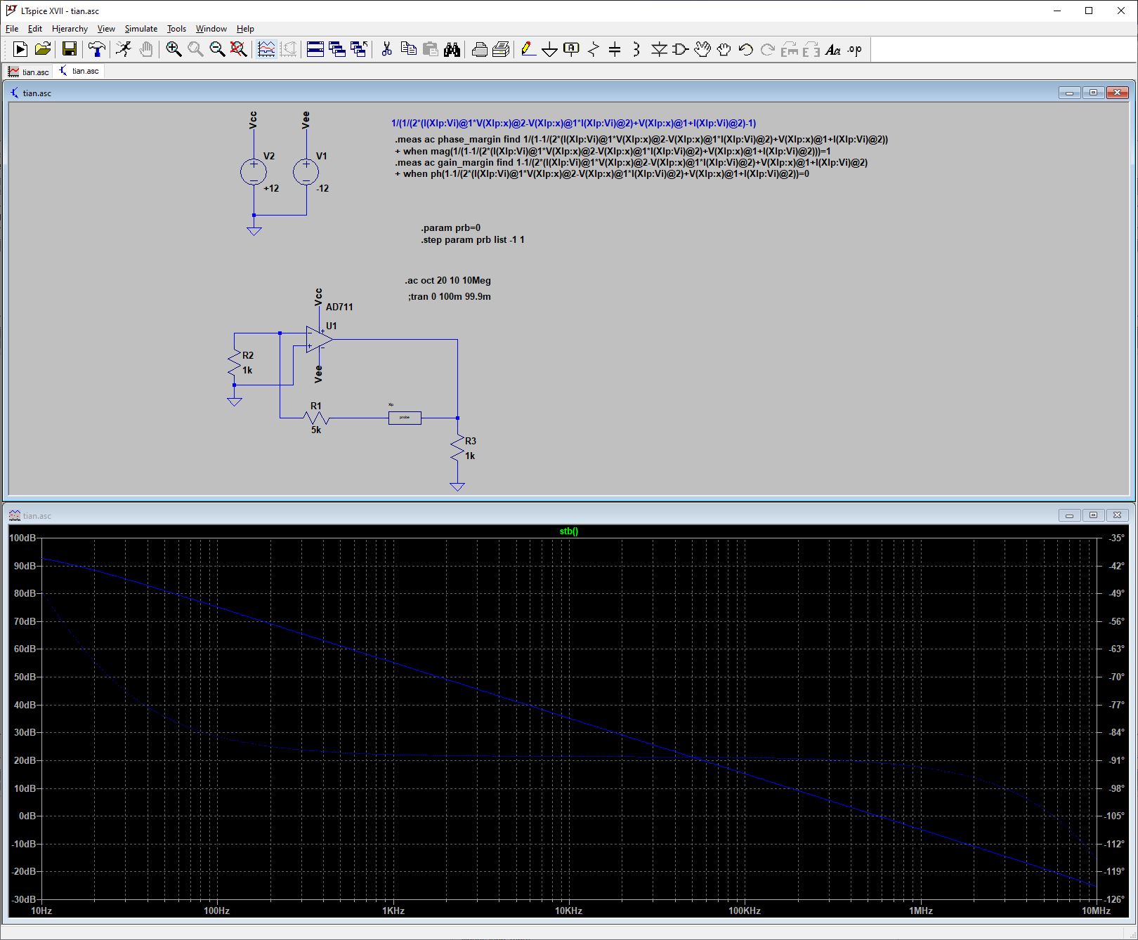

Here is another way to use Tian probe. It also tries to find the gain and phase margins (see View->SPICE Error log).
  • tian.zip
    tian.zip

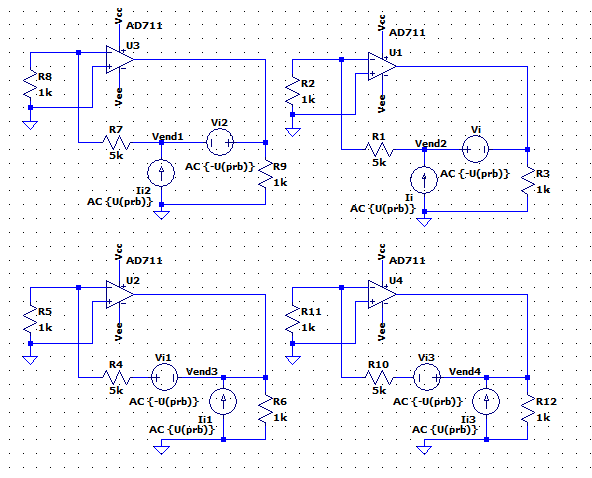

I have a basic question on the configuration of the probes. I see different setups, looking from the circuit to be measured output to the feedback network.
See attached. All 4 setups give exactly the same result. Which makes sense as the measurement sources are AC so there's no difference in 'polarity'.
Am I right?
Jan
You need to extend the AC analysis to 100MHz. Phase goes to -180 at around 50MHz.
Yes, 100MHz, now it's OK. Thanks for a great tool!

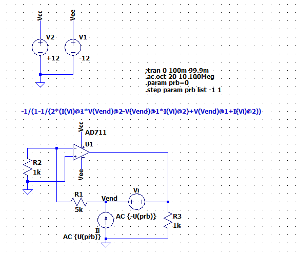

Another issue I found: if I use your method, with the probe subcircuit, the result is an open loop response that drops below 0dB at high frequencies which I guess is realistic.
When I use the method as shown in the attachment, the open loop gain doesn't drop below +27dB, which must be in error.
But I can't find any difference between the two setups.
What am I missing?

No that doesn't change anything. The .step overrules it anyway, and it is a handy way to exclude the tian stuff when you want to do a .tran or .noise.
I now see that the actual calculation formula between your subcircuit probe and the one I picked up from Russell's post is different. Hmm.
1/(1/(2*(I(Xlp:Vi)@1*V(Xlp:x)@2-V(Xlp:x)@1*I(Xlp:Vi)@2)+V(Xlp:x)@1+I(Xlp:Vi)@2)-1) versus
-1/(1-1/(2*(I(Vi)@1*V(Vend)@2-V(Vend)@1*I(Vi)@2)+V(Vend)@1+I(Vi)@2))
Edit: they both give the same result ...
