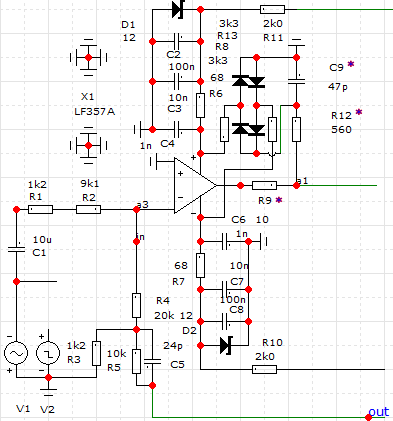

Hi everyone. Minek ,in the scheme of the first post, there is an unsuccessful diode limiter. It is necessary to change its circuit, to make it on 4 diodes with an offset from the power supply buses of the op-amp.
Maxim, check post #69, diodes D7/D8 do actual clipping control.
D5/D6 don't really prevent clipping, but they do remove some ringing while
clipping happens.
Максим, чек пост №69, диоды D7 / D8 реально контролируют клиппирование.
D5 / D6 на самом деле не предотвращают обрезку, но они удаляют некоторый звон во время происходит отсечение.
The op-amp output signal is very low - I was unable to make simple limiter between op-amp input/output to work correctly...
Выходной сигнал операционного усилителя очень низкий - мне не удалось сделать простой ограничитель между входом / выходом операционного усилителя, чтобы он работал правильно ...

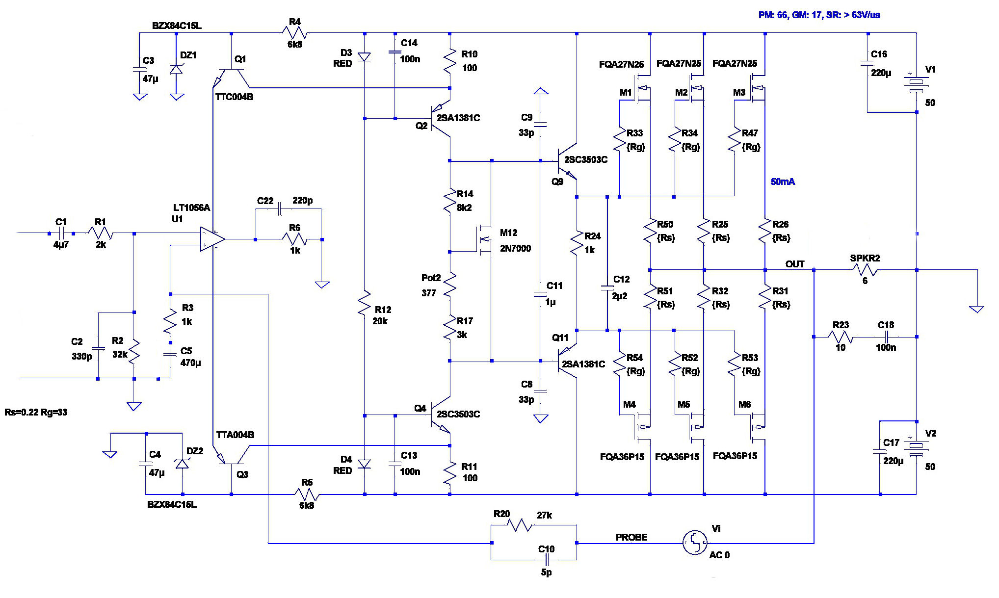

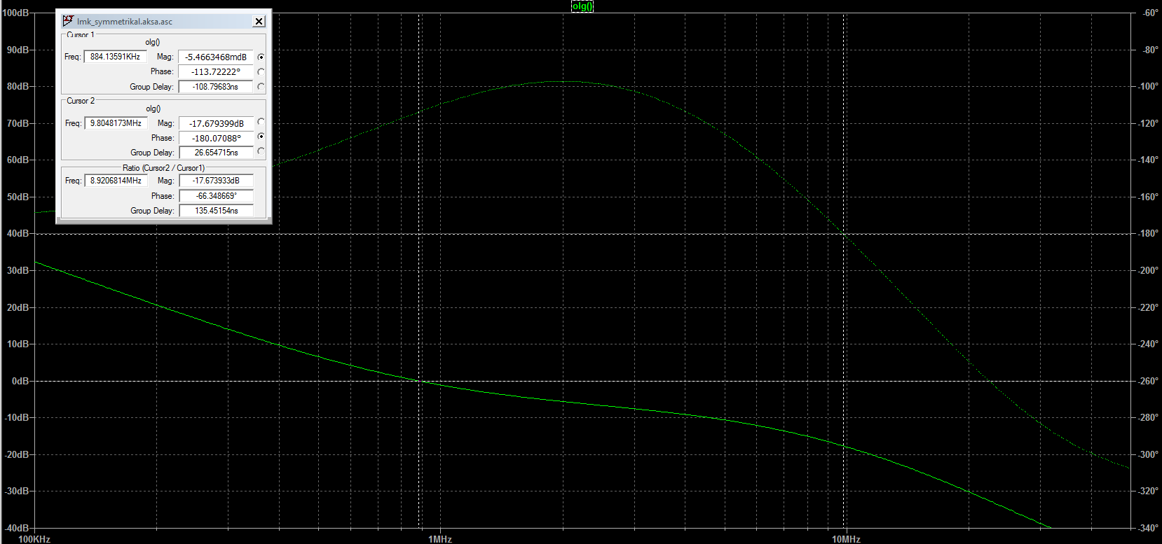

Following Hugh's suggestions, I finally manged to find time to make this design stable (rock solid it is), with very simple compensation.
Phase Margin: 66
Gain Margin: 17
SlewRate: over 60V/us
It's also very simple.

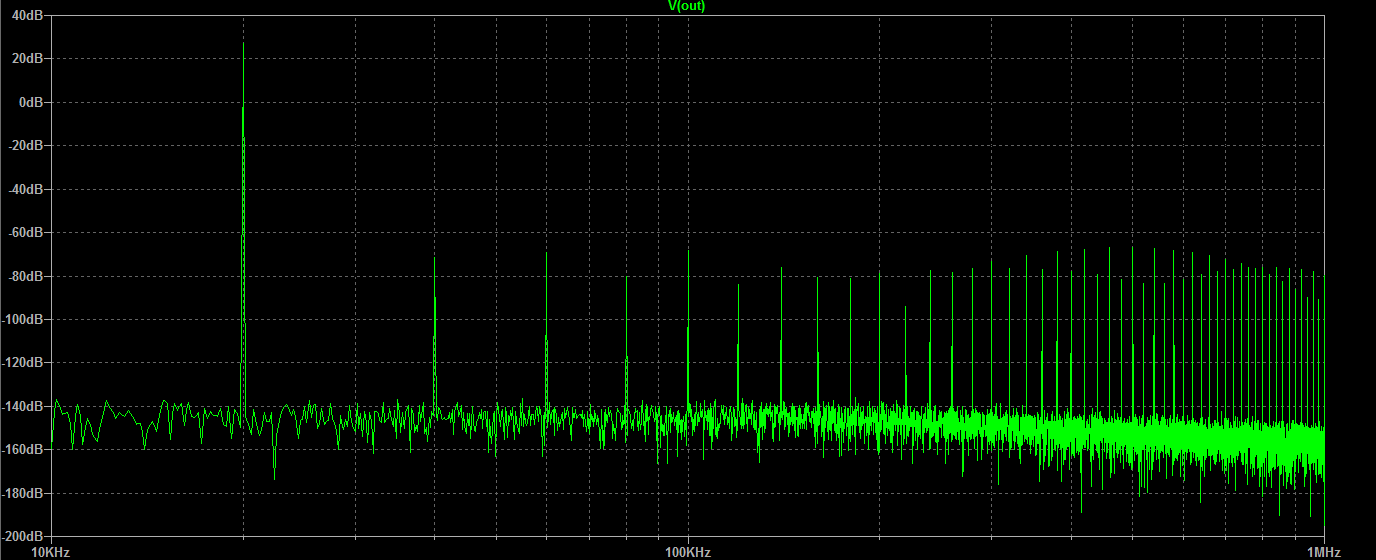

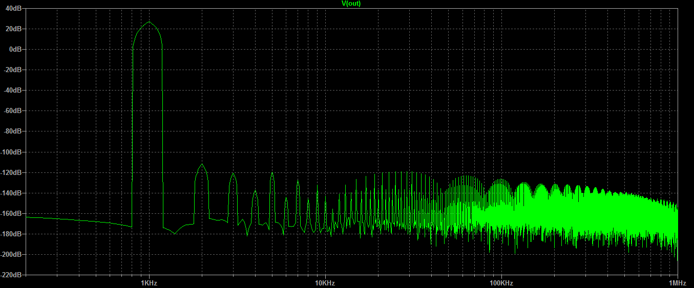

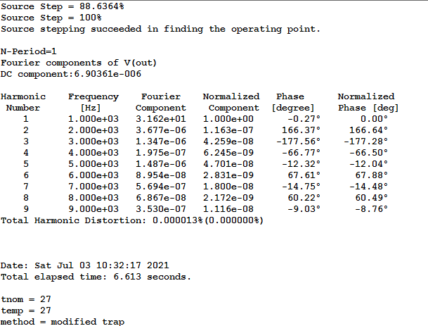

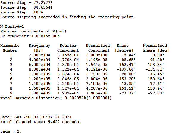

Thd and FFT plots are done for 1kHz and 20kHz
Hi Minek,
I reduced the counts part, changed to the Toshiba bipolars and IRFP240 series at the output. With 58mA quiescent it gives you VERY low 1KHz distortion with relative simplicity.
I dropped the shunt fb cap. If you use the 1056 IC it should control the offset very well.
This is a very good way to build a power amp at low cost. Thank you for showing it to us!
Hugh

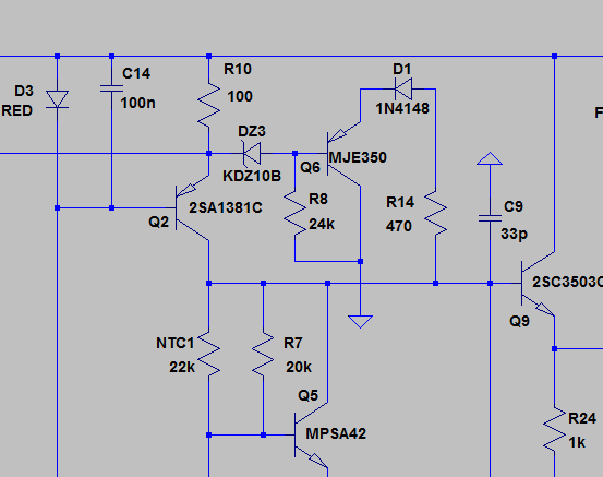

Here is clipping protection added. It clips nicely, and doesn't add to Thd.
By changing Zener voltage, we can choose how close to the rails we want to clip (in this case 10V below rails).
Op-amp is still sticking to its rails for a quick moment. Not sure how to prevent this.
All standard clipping protection circuits added the input/output of the amp, are making Thd number much worse, and they don't really clip nicely...
Perhaps current limiter can be added to the rails of op-amps?
