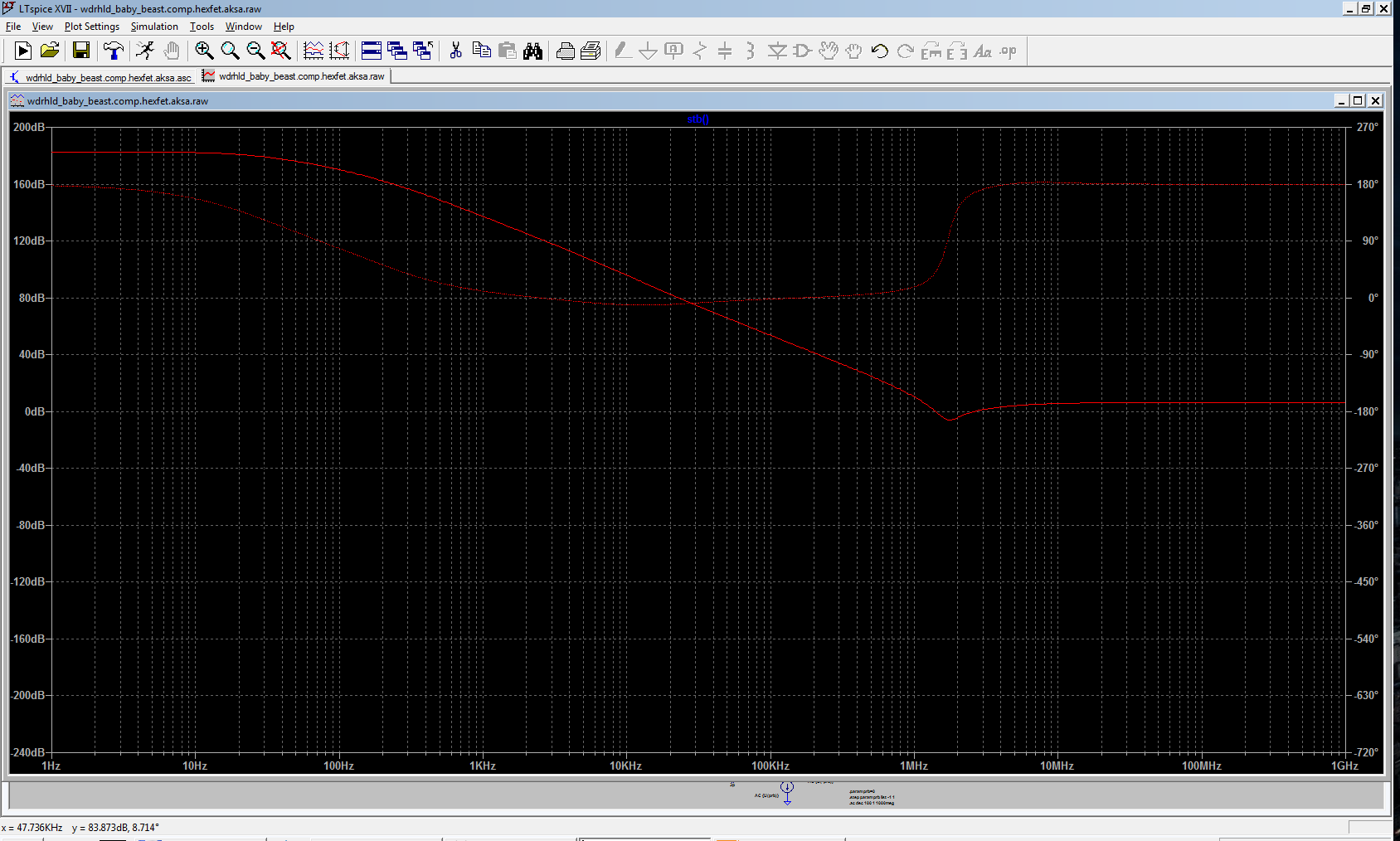

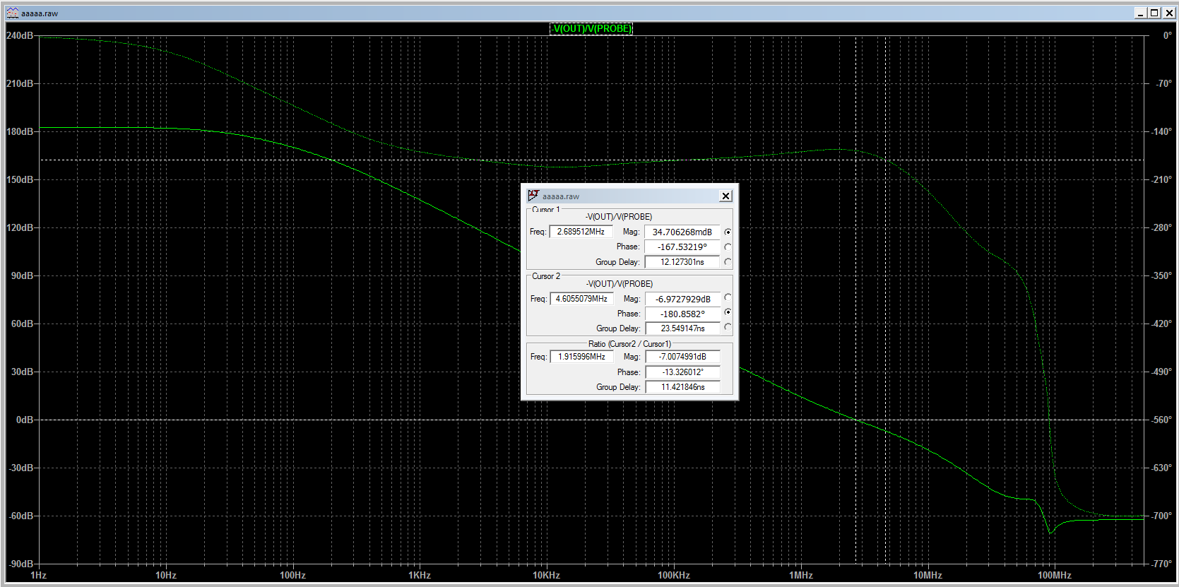

Not sure if this plot makes sense.
GM seems to be minimal, while PM huge..
Different than Damir's last plot.
Judging from Damir's plot from post #43 (with C10=7pF) PM already improved to 18 degrees.
The latest sim (post #40) has C10=3pF and C8/C9 also lower, so I would expect further improvement..
Still experimenting..

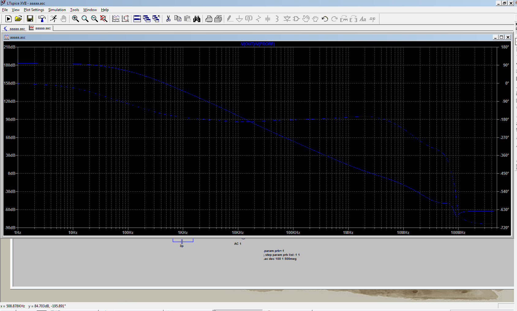

I realy don't know what that plot represent, this is not correct LG plot. Why do you not do the plot like in my post #43?
That's what I get if I try method from post #43.
Sim attached how I did it.

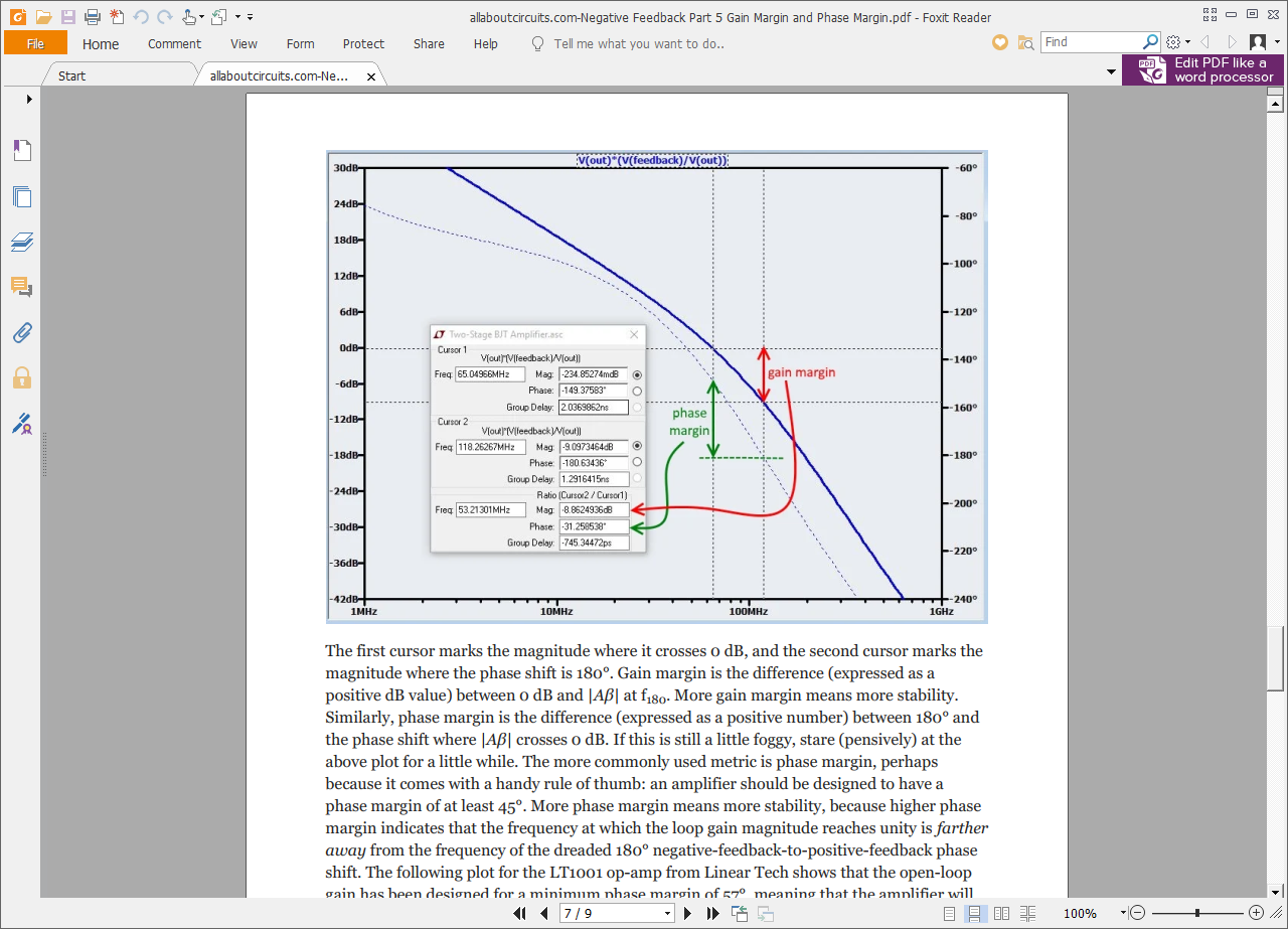

What are the acceptable values for GM and PM, for an amp to be considered stable and build-able?
Looks like PM in perfect world should be > 45 degrees, right?
My goal is to get PM more than 60 degree and GM more than 10 dB.
Mostly I've got PM between 70 and 90 degree and GM between 20 and 30 DB, and that with CFA.

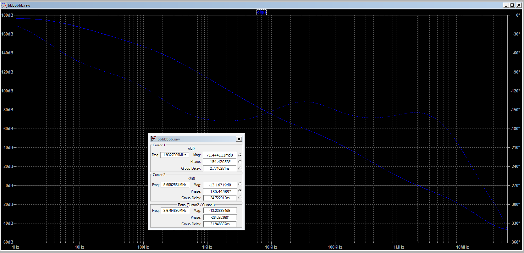

OK, this is the latest plot, that at least looks like Damir's plots,
so I guess it's more or less OK.
PM: 26 degrees, GM: 13dB
Far from OK, but better than yesterday...

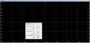

The thing is I'm getting different plots from Tian method, and from simplified method.
This one here is from simplified method. Plot from post #48 is from Tian.
Update: attaching Tian plot here (2nd atachement).
They look different, and of course produce different PM and GM.
For full transistor implementations, PM has to be > 60 degrees. Loads and speakers can be weird and amp testers like to hook up dangerous loads, so I shoot for > 65 deg.
GM, I normally shoot for > 10 dB. My lastest design shows 8 dB GM, and I reckon I'm happy with it.
