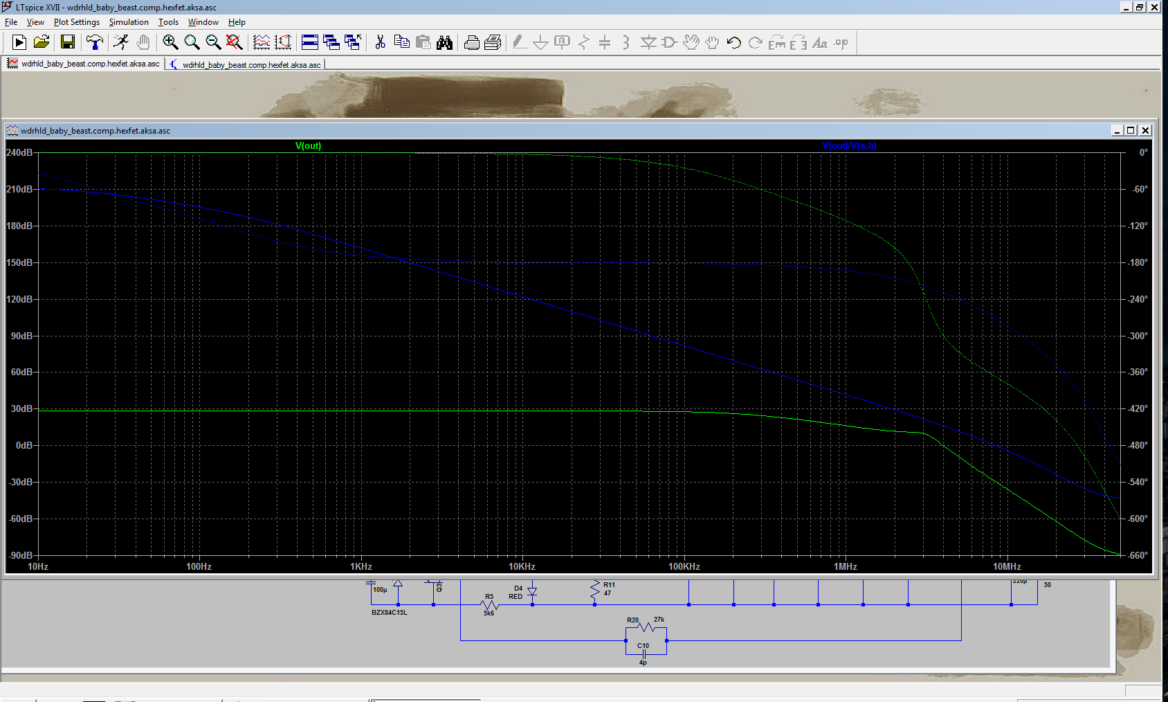

Not very stable, just 11 degree of PM and 2 dB of GM🙁 but very low distortion.

I did not really look closely at the first loop gain plot you showed. Your original loop gain plot agrees with Damir: you have about 11 or 12 degrees of PM. That's life on the edge, for sure. However, that is loop gain/phase from the original circuit, before you removed Q5 and Q6 at the input.
The main loop compensation is in the LT1056, compensated for unity gain of 5.5 MHz. That sets the dominant pole of your amp. The next pole that you add it needs to be no lower than 2 * 5.5 MHz / 28 = 400 kHz. (28 is the CL gain of your amp.) The higher you can make that pole the better.
The first pole is set by the LT1056. C8 and C9 are setting your second pole. You probably need to lower those values to increase your overall PM. I could be wrong.
Then you can adjust C10 to get a little more PM, maybe 5 degrees. Any more than about 5 pF is probably too much. Usually this can only cancel the input pole of the amplifier. I bet C10 doesn't help you much in this amp.

I run OLG plot for a new version (driven from op-amp rails) - looks exactly the same as the 1st one..
High values of C8/C9 are because of the square waves overshooting... These values can go lower, but square waves will look
'less perfect' 🙂

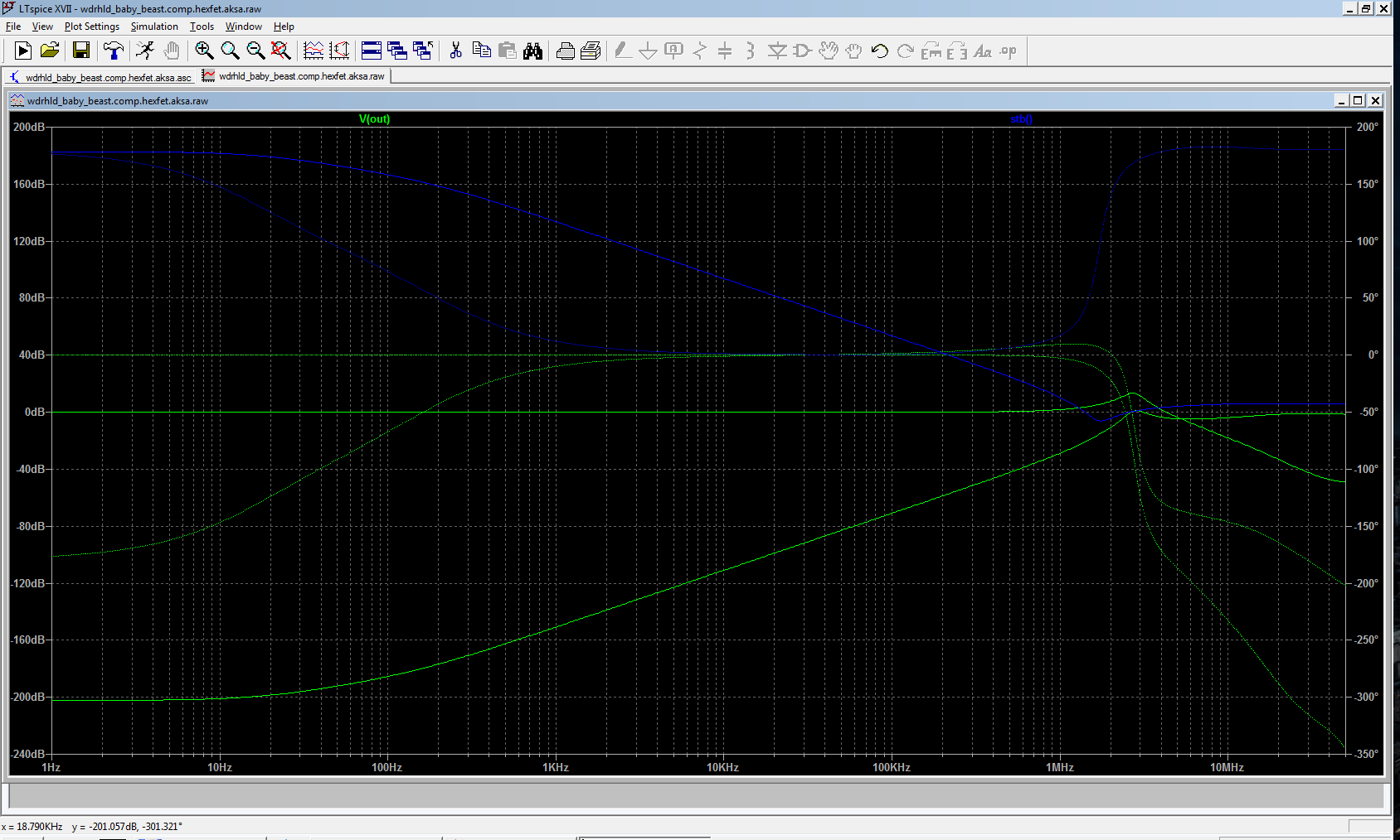

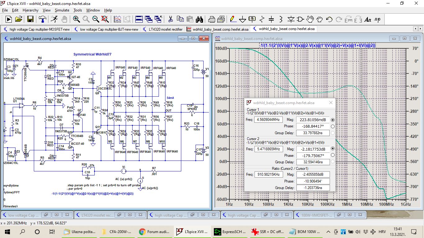

According to that gain-phase plot, your amplifier is not stable. That plot doesn't make any sense, because it is not consistent with your closed-loop gain/phase. Maybe you can use the Tian loop-break method that Damir is using to plot loop gain/phase, and it will make more sense.
Tian loop-break method for Bode stability analysis
In Damir's testbench you can see the Tian probe between the feedback resistor and the output. It's a voltage source in series and a current source in shunt. You need to add those to your schematic. They don't affect other simulations.
1)Set the voltage source to DC=0, AC={U(-prb)}
Set the current source DC=0, AC={U{prb)}
2) Add these lines to your spice directives:
.param prb=0
.step param prb list -1 1
3) Add this to your plot.defs file in <USERNAME>\Documents\LTspiceXVII:
.func stb() -1/(1-1/(2*(I(VI)@1*V(PROBE)@2-V(PROBE)@1*I(VI)@2)+V(PROBE)@1+I(VI)@2))
4) Make sure all your other AC sources (input source for instance) are set to zero. Only the Tian sources are allowed to have AC.
5) Then, run an AC analysis. In the plot window, right click and choose "Add Traces". In the "Expressions to add:" at the bottom, type stb()
Good luck.
I like to run stability analysis at several points in the signal swing. Here are some details on how I do that.
Tian Stability Plot at multiple points across the Output Swing
