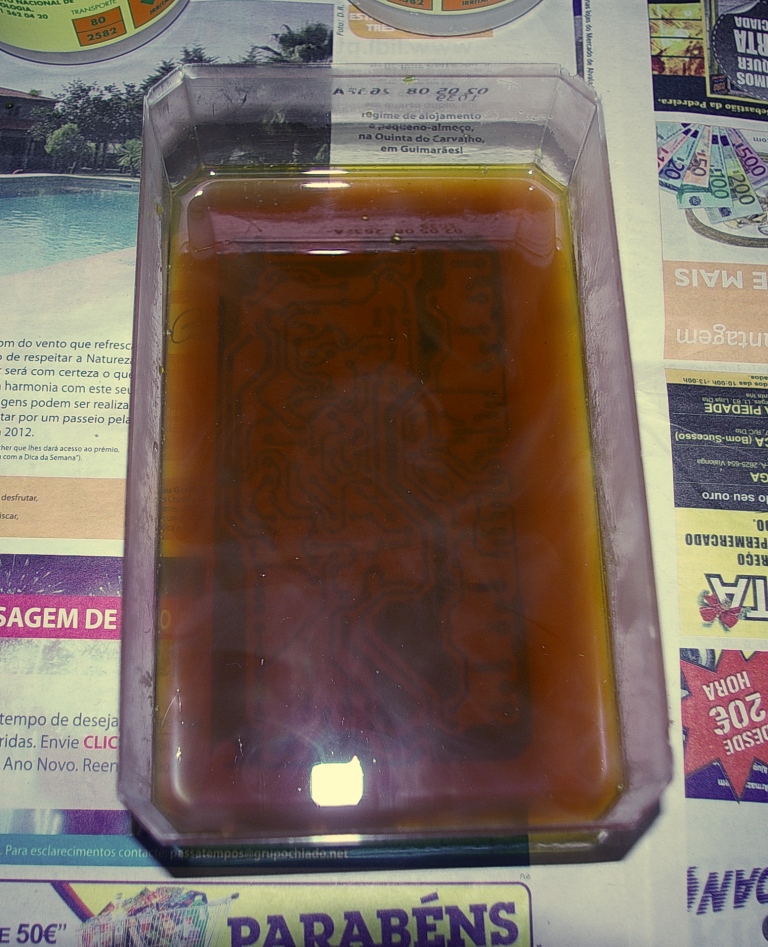

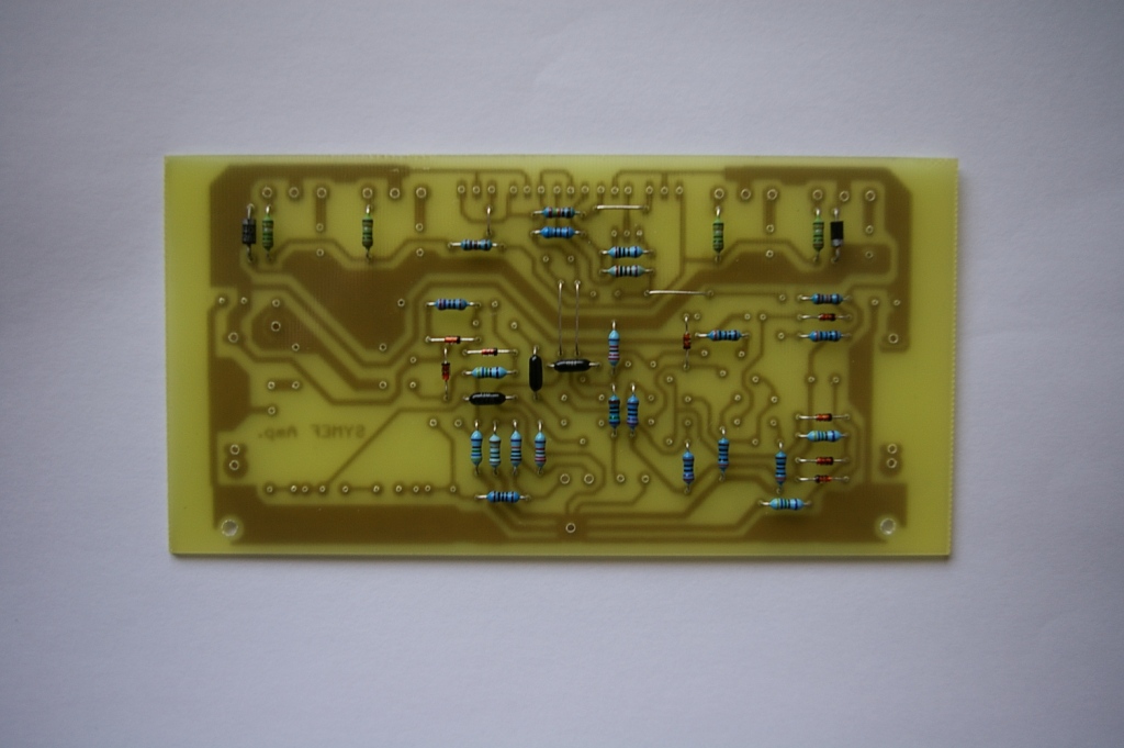

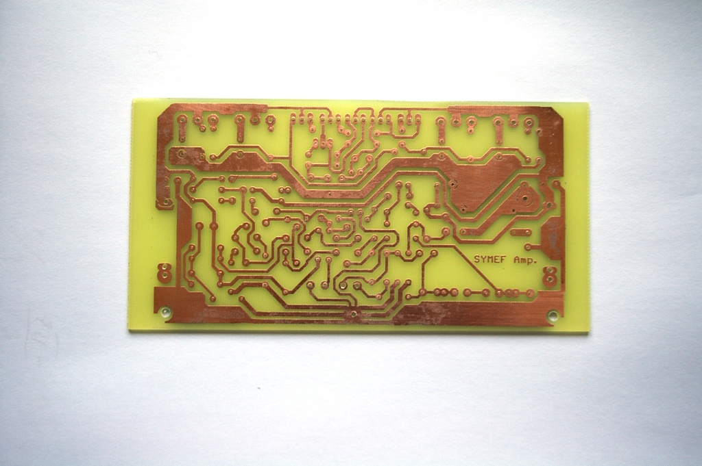

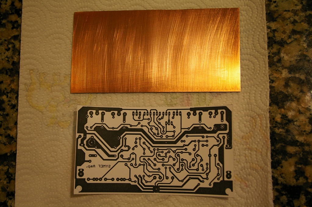

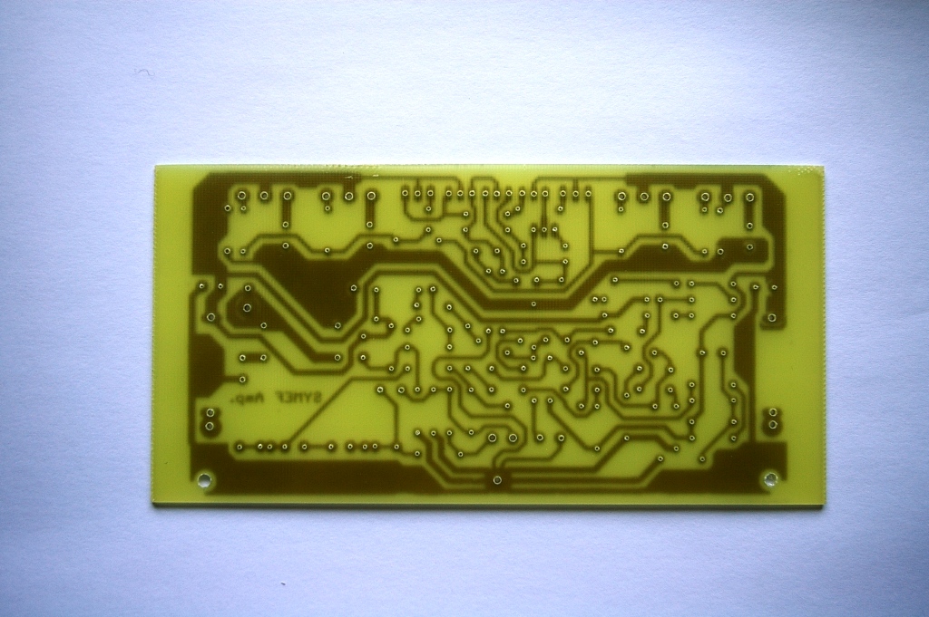

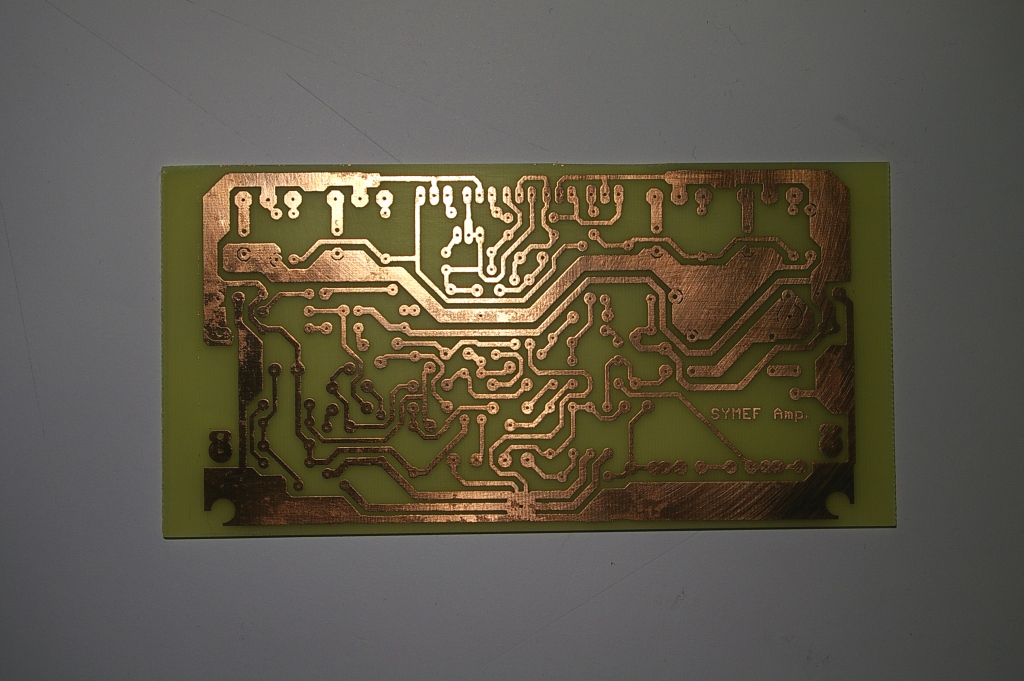

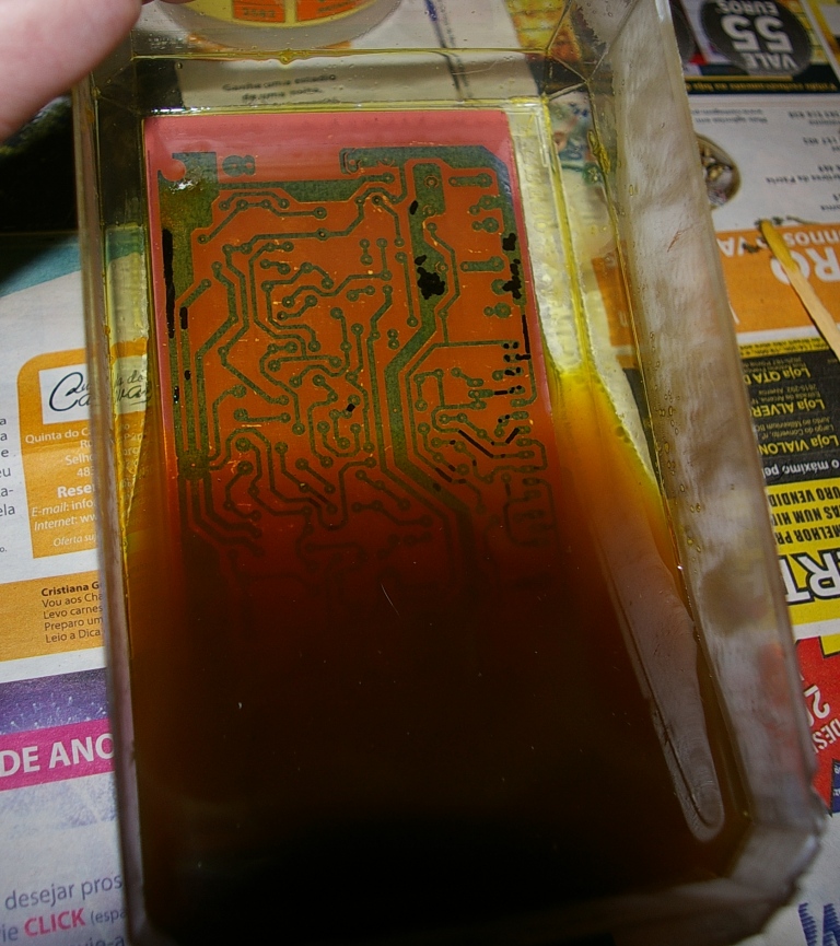

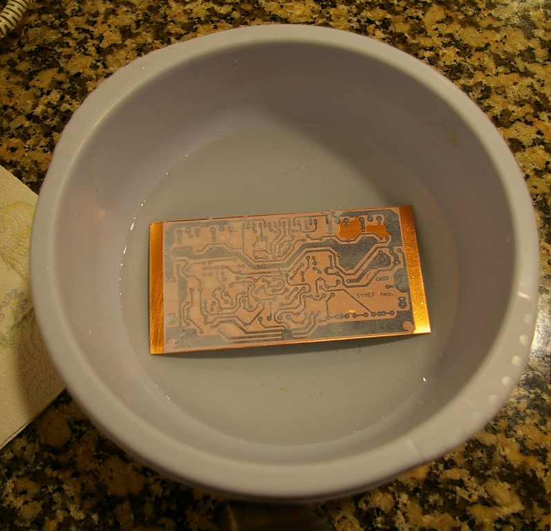

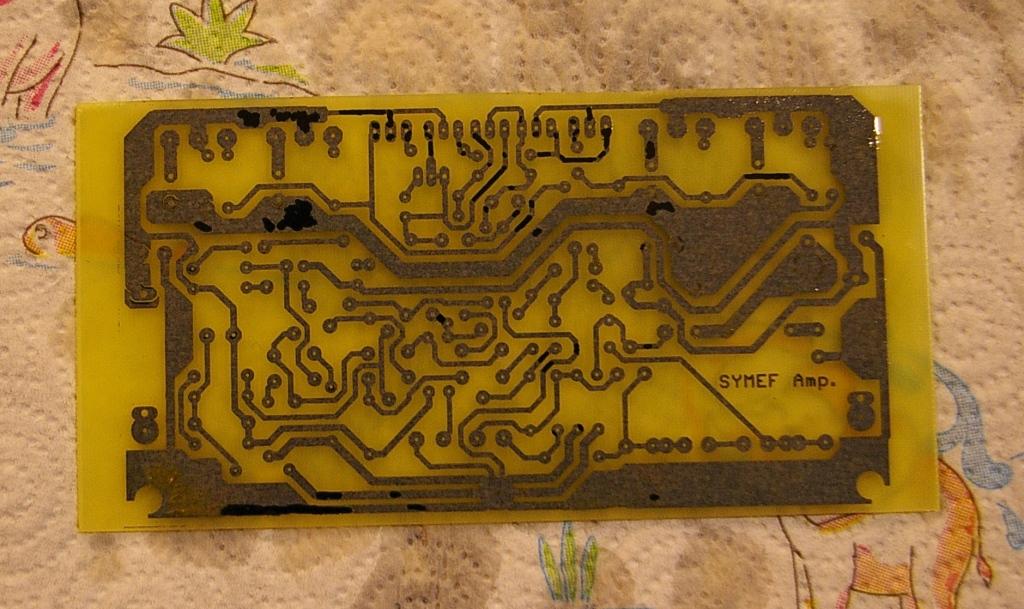

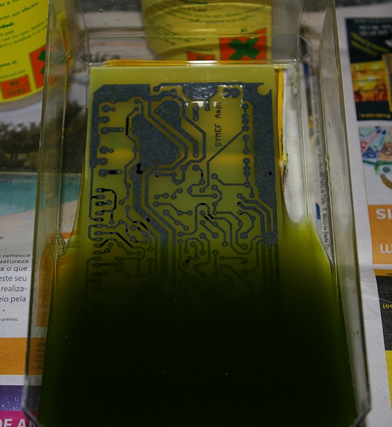

Hi guys!

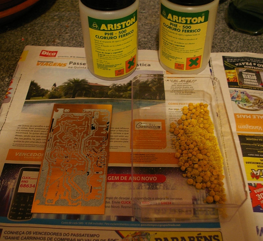

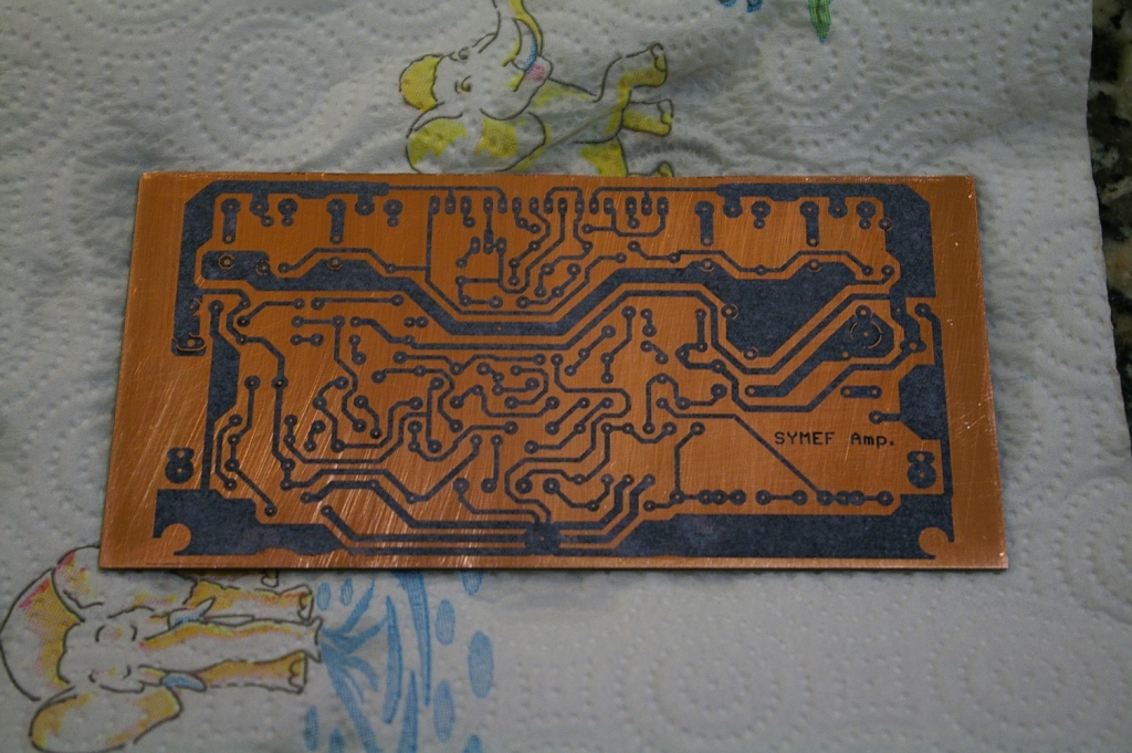

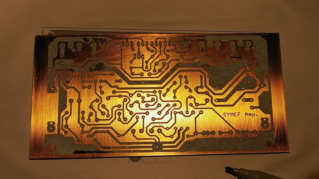

Today I've been doing the pcb. I decided to take some fotos of the process. Here they are:

very nice work!!!

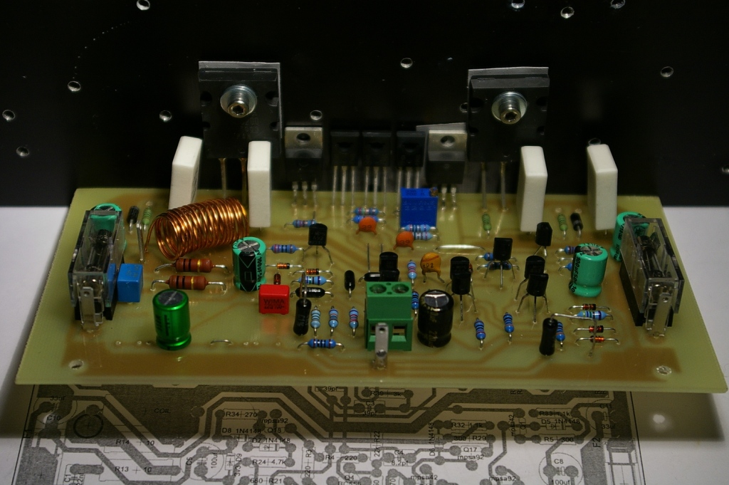

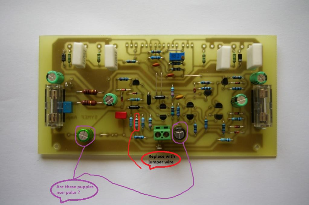

your tracks and pads looks very sharp.I'm sure you will be fine.my most common errors usually wrong value mostly resistor.when I finished populating it I always check value using lens for repairing watch.its very cheap and very useful.
About my coil, it came from sloan amplifier.its winding and turns are standard for 1uh.(18 turns,16awg-thickness in 1/2" diameter) in parallel with an eight or ten ohms resistor.have it confirm also to Harisson if this is ok.
about the two resistor I have told you(4.7k) make it 1/2 watt, it will be hot.

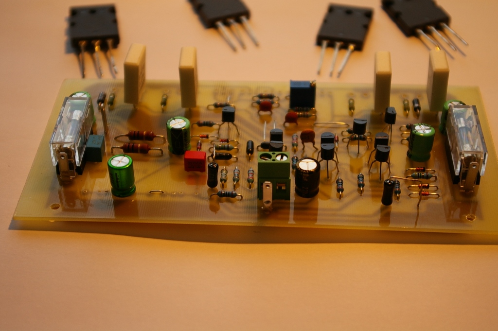

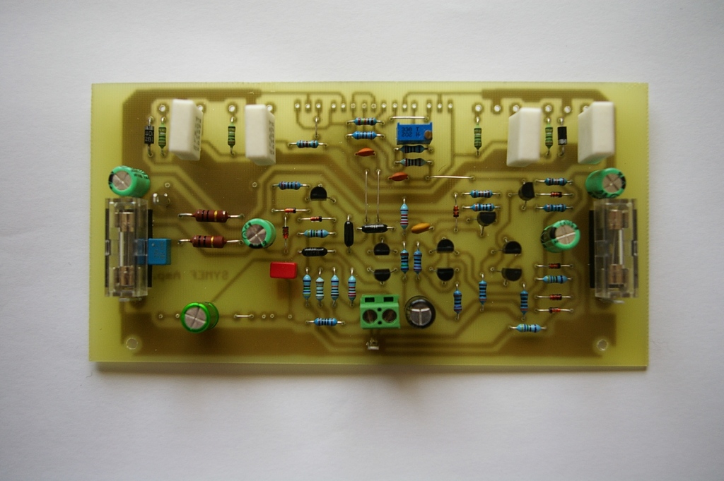

You forgot to screw...
screw those driver transistor specially the bias transistor or you will have thermal runaway.use bulb when powering up andconnect in series with the transformer.
about the trimpot did you set it on the middle before soldering it.?and dont forget to check components value.

check also driver and power transistor for possible contact on main heatsink.I see no insulation on driver and bias transistor
