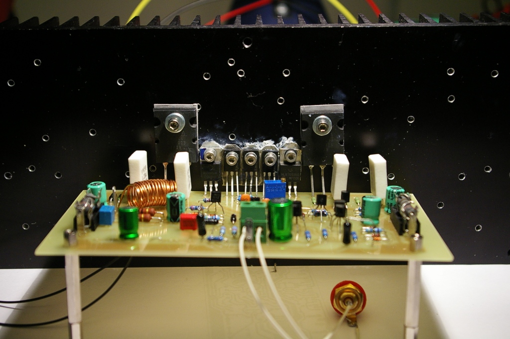

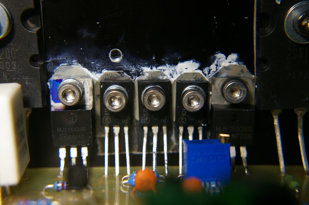

Sorry guys, I shouldn’t have published that last picture. The amp was almost ready for testing but not completely ready. I wouldn’t power it without first attaching all the transistors to the heat sink. As Joel said, that would result in thermal runway and flames. It has happened to me before in other projects and I learned my lesson. Also I never test an amp without a speaker protection circuit connected and one 10R 2W resistor in place of each fuse for current limiting. The trimmer is set to lowest quiescent current, fully turned clockwise. When testing I will connect a multimeter across one 0.22R resistor in milivolts scale to measure de voltage drop that should be 23mV. I also checked for electric contact between the transistors and the heat sink and found they are isolated.
From the picture bellow you will notice I’m only using a pair of outputs. I will power the amp with 36V rails. I think it’s safe for now. In a final build I will use two sets of outputs even if I decide to keep the 36V. You also notice the coil is not very well made and that I’m using ceramic caps. I will replace the ceramic for silvered micas when I find the values.

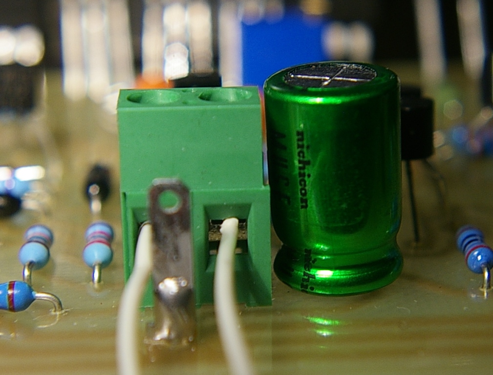

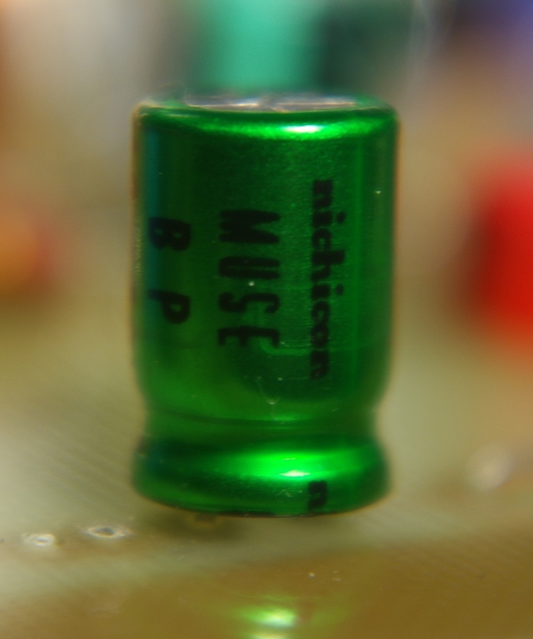

Thank you Harrison, I took out the 10R resistor and linked with a jumper. The input cap is a Nichicon Muse bipolar and the other puppy was a Panasonic FM polar cap. Took it out and replace with other Muse BP, 100uF 25V. Perhaps I should increase this value…

Listening test:
I have my pc soundcard directly connected with the amp. I also linked out the input cap.

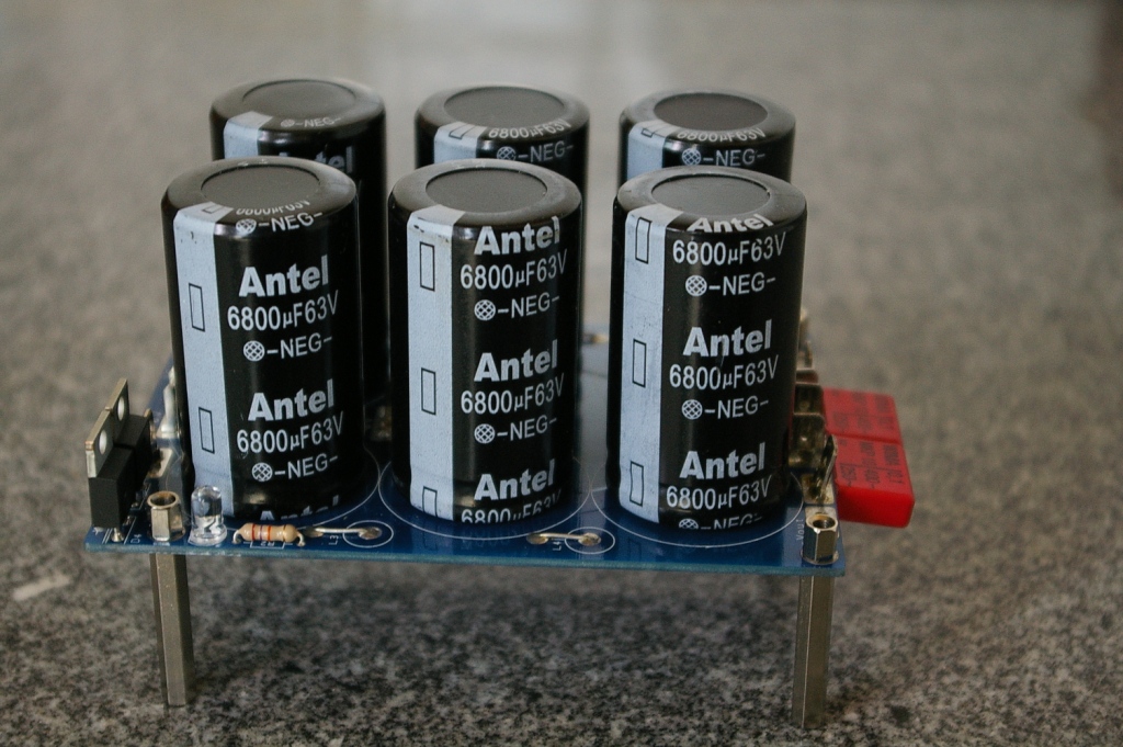

The power supply is made of 3 x 6800uF no name capacitors bypassed by 100nF Wima MKP10 for each rail. Soft recovery diodes are used.

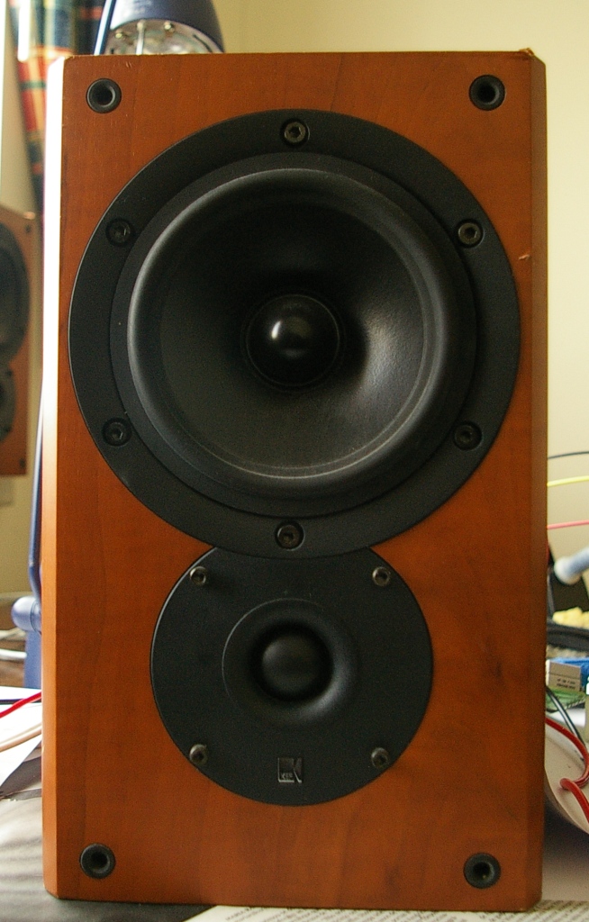

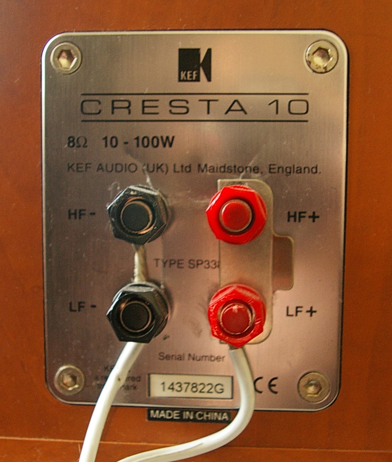

The speaker is a modest Kef Cresta 10 (previous series).
When connecting power the voltage across 0.22R rose up to 50mV and I disconnected the amp. The trimmer was full clockwise. I decided to put a 750R resistor in series with the 2k trimmer and that worked. Bias voltage is now 23mV stable.
So, how does it sound?
It’s a very enjoyable amplifier with a lively presentation. The mids are lust, particularly with female voices in a euphonic way that easily seduces. The bass is present with great control and is very well defined. The highs are rich and detailed (you can hear the little details and articulation of the voices) but are somewhat rough. This might very well be the psu’s fault or noise pickup by the wiring. It’s really the only thing I can complain about and I believe is not the amp’s fault. Other than this I think this amplifier has a beautiful presentation and deserves much more attention than what is getting here at Diyaudio. This is a very very good amplifier! Indeed the formula works. Now I will build the other channel and try to build a better psu.

Just inserted two paralleled Wima MKS2 4.7uF as input cap and the roughness I reported in my previous post is compeletly gone! 🙂 Most beautiful music I'm listening now! How can the ausence of input cap be the blame? I was though it was a power noise issue...

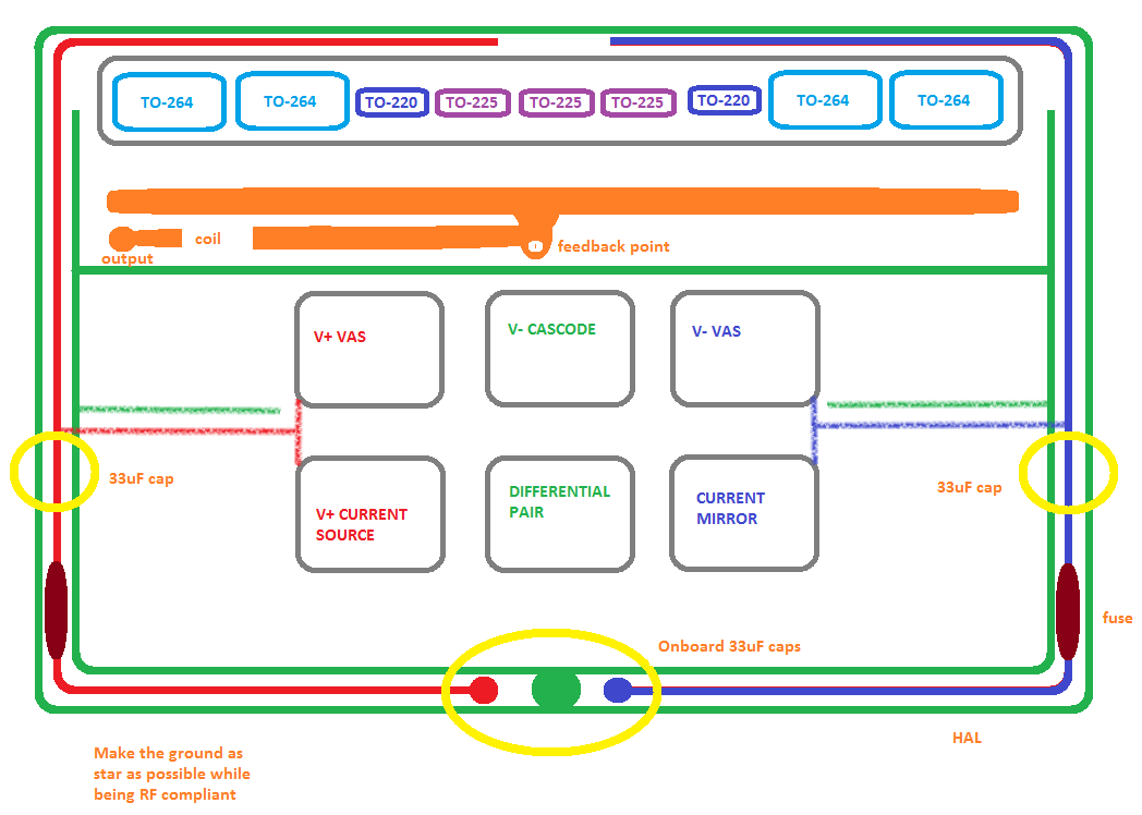

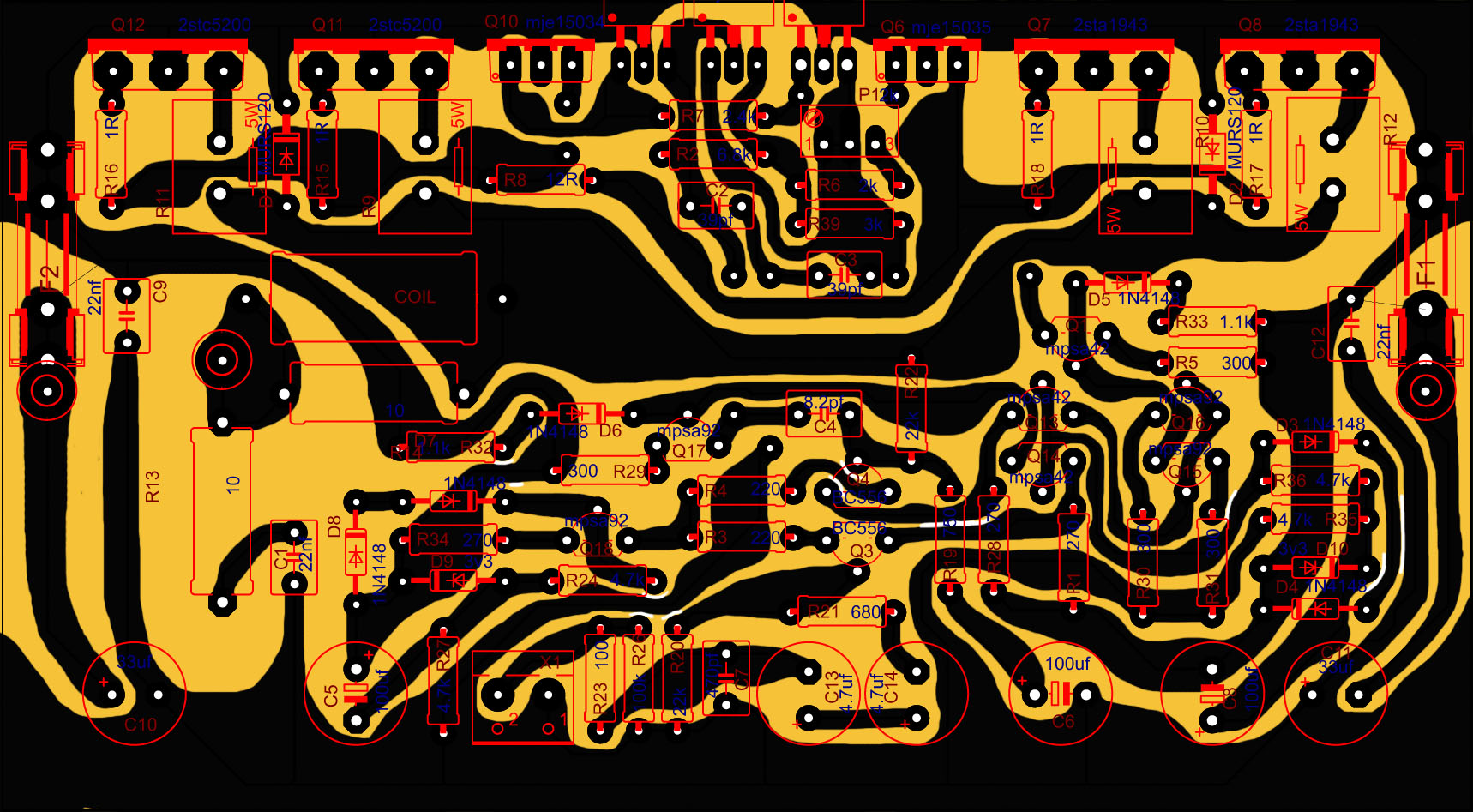

do you like this one.
Hi Harrison,
playing with my computer and come up with this one its not final but do you prefered this instead of straight line?Im just wondering if this kind of style can be done in computer(referring to my capability).thank you for the block diagram and this will serves as guidance through upcoming pcb.

Hi Drow,
Creativity is highly encouraged 😉 :up:. What I have in mind is to implement a ground plane that ensures that the board does not become an RF antenna.
I want us to merge your previous star ground system together with some RF protection techniques to come up with one fabulous board.
kind regards
Hi Joel and Harrison,
I prefer the straigh line. This round lines were used before computers were available and the boards were hand layouted.
That's an excelent ideia! :up: Joel, could you use Nico's sugestion and separate the VAS supply from the output transistors supply?
About the input cap: I will take a look at your polypropylen, Drow. Are you happy with it? I think the treble is very much dependant of the quality of this cap. But good 10uF cap might be very expensive. Harrison, is possible to rise the input impedance so a lower value, less expensive, better quality cap be used?

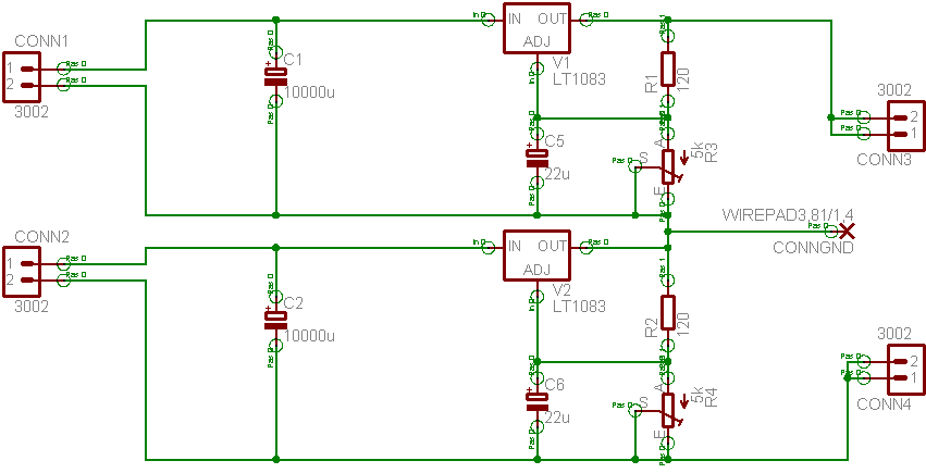

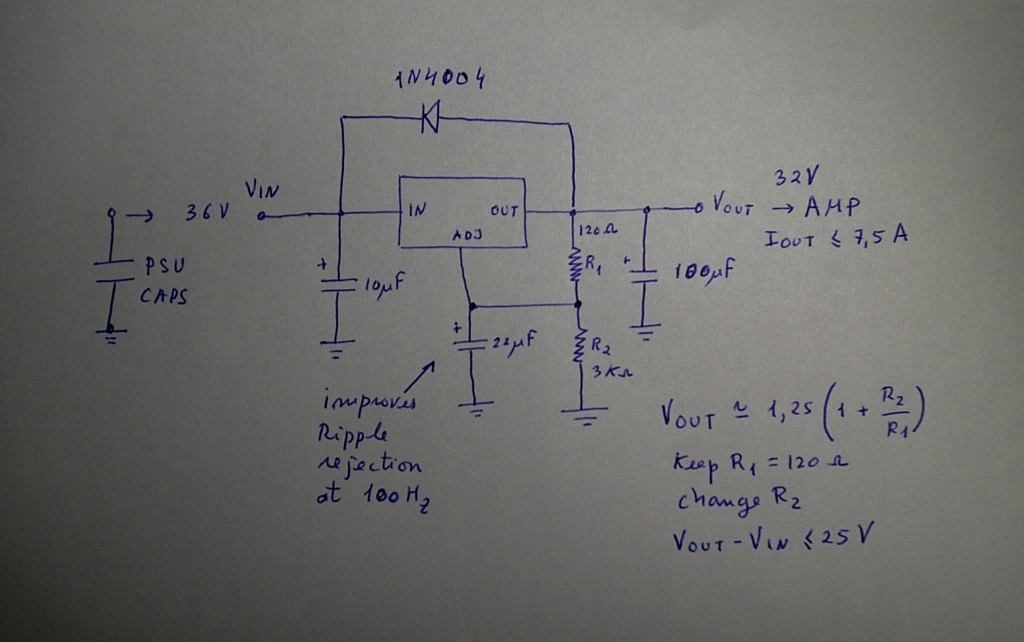

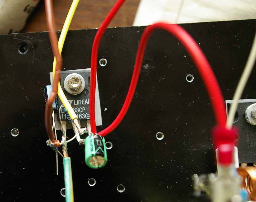

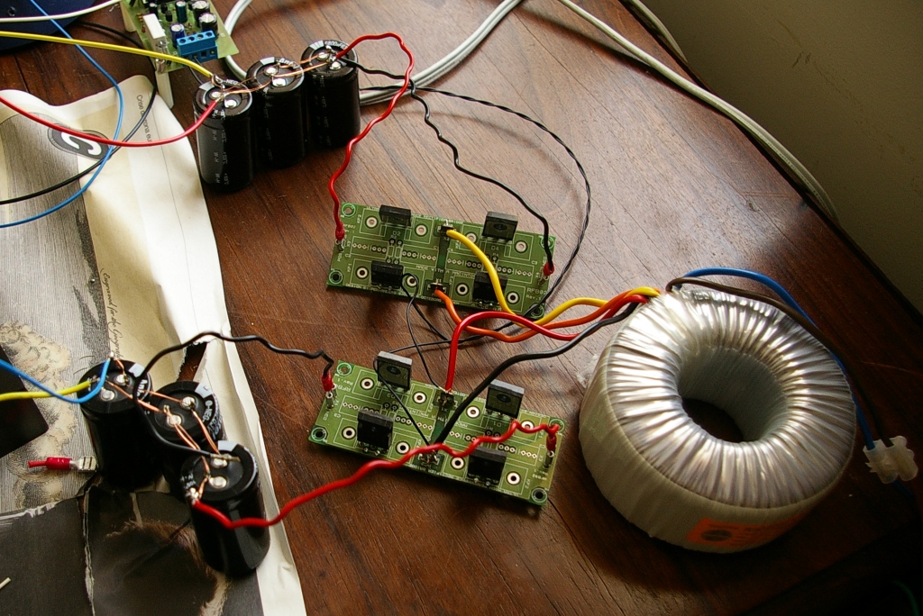

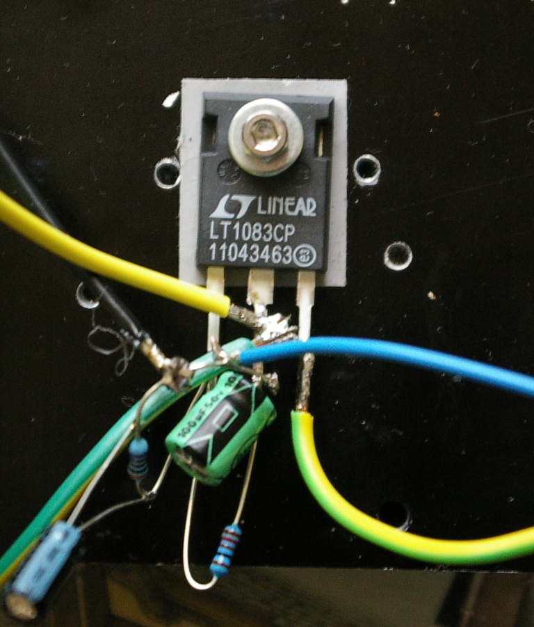

I just tried regulating the power supply with Linear Technology's LT1083 chip regulator and you guys must try this to!!! It's amazing - the midrange became so cleaner that it's unbeliveble!
The shortcoming of using this chip it's that it only regulates up to 35V, it's not possible to use 40V rails and up, and it requires two ground planes, each with it's own bridge rectifier. I built a quick power supply as in the pics atached.
Harrison, is it possible to regulate only the VAS and input stage? (as I believe the outputs don't (shuouldn't) need to be regulated). Is there a way to put such regulation circuit integrated into the amp's pcb?
You can use a 4.7uF cap.
What about bass roll off?
What about the 33uF - should I rise them?

Hi Paul,
Such kind words :hug: .
Thanks again for contributing to the state of the art 😉 .
The amplifier was designed to blow you away even with an unregulated power supply😉
There are pros and cons of having the stages on separate supplies, but do experiment.
The regulated supply is helping the amplifiers power supply rejection, blowing you away again 😉
Adam was working on something related to the power supply rejection, also waiting to hear from him soon.
