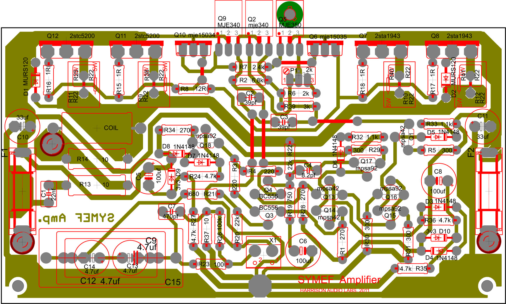

with those resistor I can still make the boards smaller and besides there are still some flaws on the latest,just minor like tracks on decoupling cap., not straight. while Im still making the boards just gather the parts.

"QUOTE=drowranger;2907482 I made this last night and much smaller.if you can make a new layout much better because it suits your taste.
goodluck:😉
regards,
drowranger"

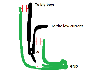

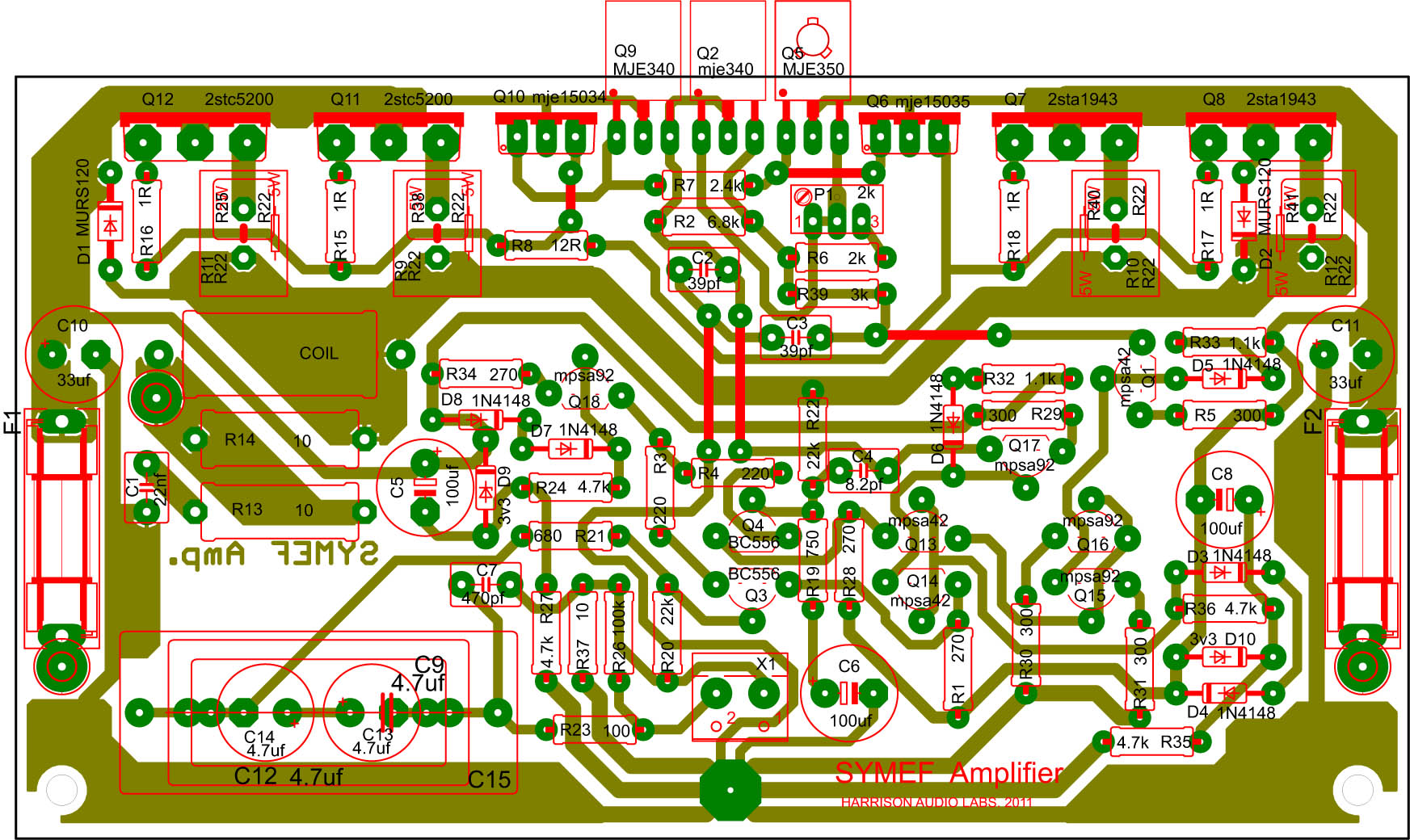

The two layouts (yours and Alex's) will have quite some difference in sound since your VAS transistors power supply is modulated by the power transistors which could cause a muddied or smeared sound. I would try and rearrange or separate the VAS supply from the output transistors supply.
goodluck:😉
regards,
drowranger"

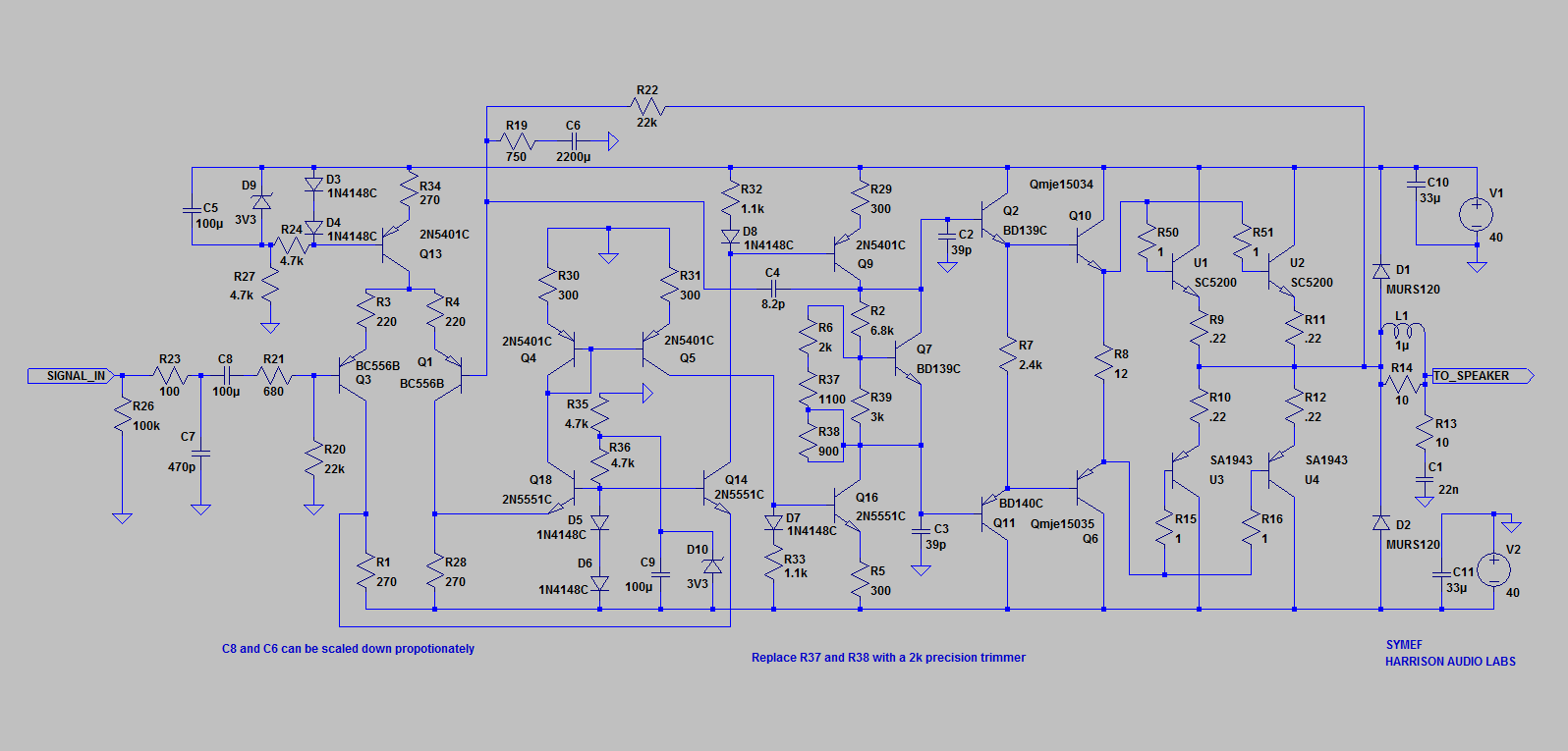

Hi Nico,
Other than the packed muscle onboard the Alex version, both are topologically close.
Attached is a twist of what you maybe looking for 😉
However probably due to the formula, the amplifier is not likely to sound muddy, despite some inferred layout non optimizations. Lets say the formula could be several light years ahead of even the simulators math.
As Joel put it, its quiet and beats quite a few others out there 😉

Harrison, you have the idea regarding supply to the various sections. As it is with that particular layout every instant the power section passes current into the load a volt drop will develop across the VAS supply. The two amps of identical schematic will be audibly very different.

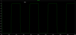

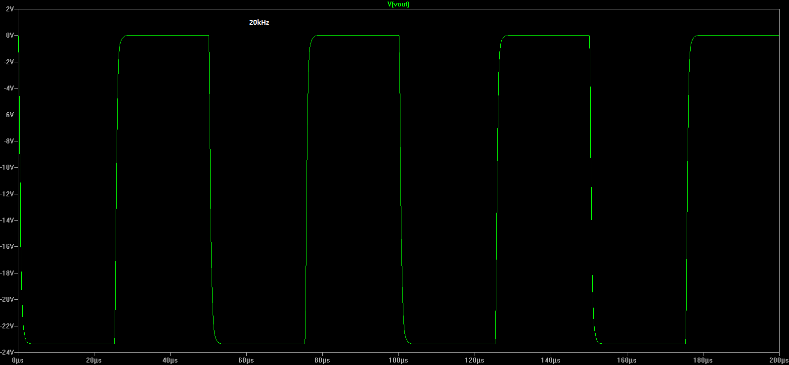

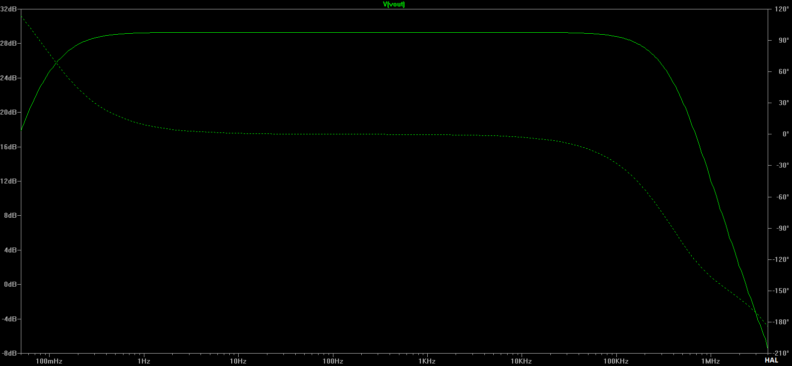

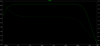

Hi Paul,
Here are a few sims of your proposed build.
Waiting excitedly at your experience, lets hope its love at first note even before warming up and breaking in
kind regards,
Harrison.
kind regards,
Harrison.
Hi drowranger,
That's a very nice pcb! 🙂
There's one little thing: the pin spacing for the 0.22R 5W resistors is 10 mm, it's a little small on the pcb. Otherwise, it's a beautiful pcb. Good work!
Many, many thanks drowranger! 🙂

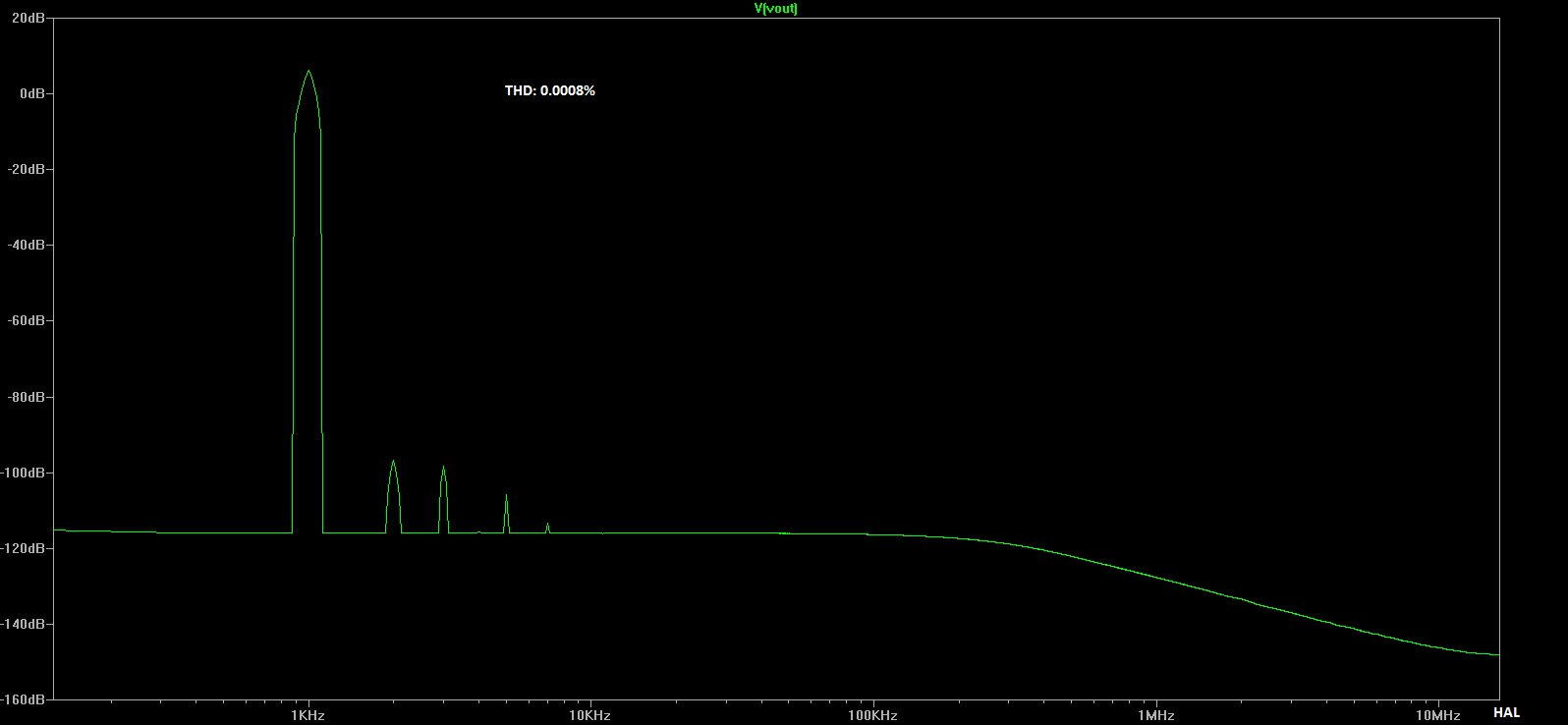

Hi Harrison,
One thing I noticed is that the 2nd harmonic is dominant at 1kHz and the 3rd is dominant at 20kHz. Is this accidental or comes from the formula? High order harmonics are almost completely absent. 🙂
I did some simulations my self. It's a very promising harmonic distribution! 🙂Here are a few sims of your proposed build.
