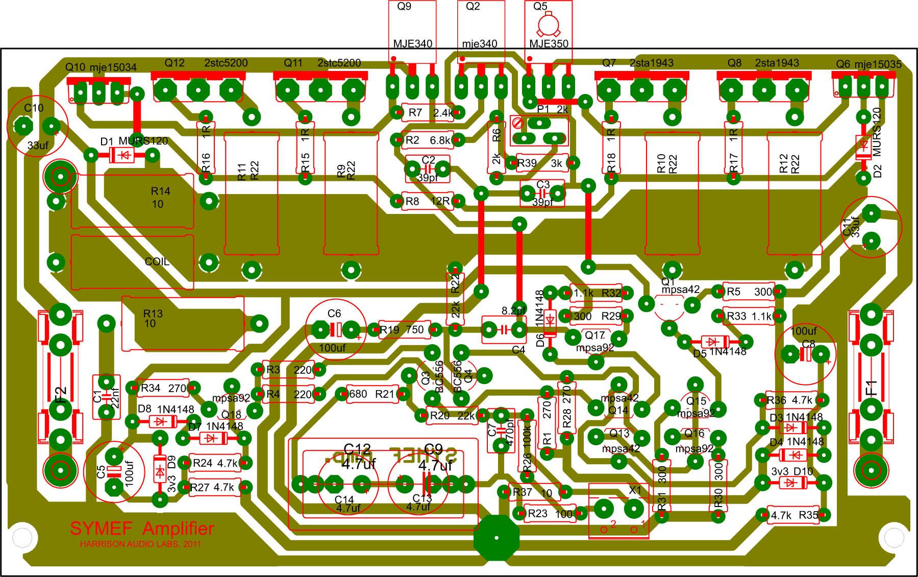

size is correct.
you can use alex mm if that is big for you but the output is not a flat pack.If you gonna use my board no need for L bracket.I use L bracket co'z my heatsink is divided into three.and beside it,board is already tested😉
regards,
joel
p.s. just print it.I uploaded the correct and exact size.right now I could not give you the size its in my room,tomorrow.
check this one.
I made this last night and much smaller.if you can make a new layout much better because it suits your taste.
goodluck:😉
regards,
drowranger
p.s.
check layout if it is correct

Something I like in your layout is the big pads.🙂 Are you using Eagle? If you are, how do you get the nice pads? I use Eagle and the standard pads are way to small and the drill almost eats them remaining only a smal portion of copper. The way I work around this is by placing bigger vias on top of the parts pads but this is not a nice solution. Your pads are very good!

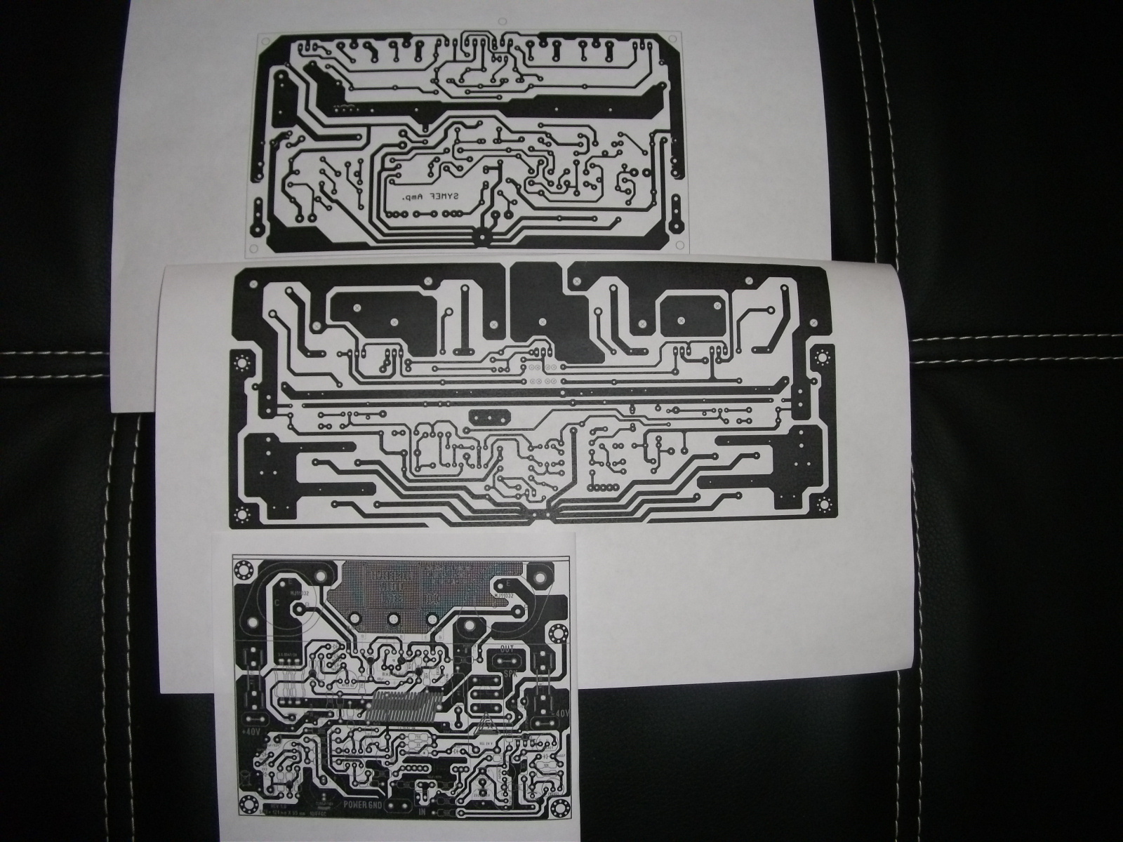

a picture
Hi Paul,
Here a picture. The top one is Drows, the one he has tested and is using. The middle is by Alex with TO3s. The bottom is 1DIFFQC by Alex.
By thermal compensation I meant that the predrivers and drivers could be rearranged to squeeze in the PCB, however a way to thermal track will be needed.

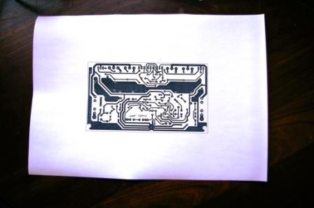

Hi OnAudio,
Your printer is alright . Take a semiconductor and try to place it in its location on the paper It should fit.
Yes, you're right! 🙂 Thanks!

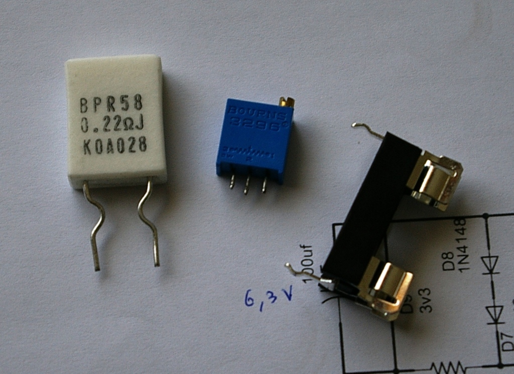

Hi drowranger,
If is not to much trouble could I ask you to do a little redesigning in order to accommodate the 0.22R power resistors, the inline pins trimmer and a smaller fuse older as in the picture, please? Thank you.

If is not to much trouble could I ask you to do a little redesigning in order to accommodate the 0.22R power resistors...
Sorry, I shouldn't have asked you this, it's up to me to do my work for my parts. Maybe it will be a good learning exercise of Eagle. I have only designed very simple boards and it's time to evolve and learn more. So far I have drawn the schematic with my parts and tomorrow I'll start layouting the pcb. I'll use your board as reference, the idea is just to replace the parts that have a different layout (KOA resistors, trimmer and fuse holders). Everything else will be as in your nice board. 🙂
ok...no problem
Hi Paulo,
I used RE 5watts that was in my board because that was easily available in my country.In my latest board check pin configuration of trimmer co'z I already change it with diff.pot, pin configuration is in triangular form like in you picture.
I will change the resistor(emitter)and and fuse holder to suit your taste.
