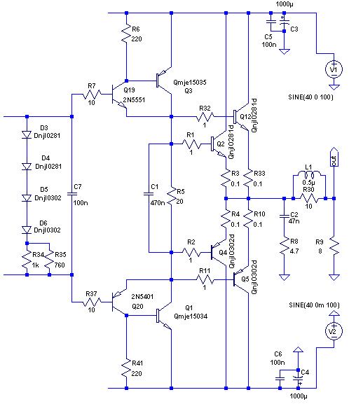

This output stage is stable with symasym
Hi Piersma,
I'm looking at the MJE15030 /MJE15031 devices. Emitter resistance is about 0R5 and the collector load will be a bit less than 47R. Therefore the device has voltage gain unless I'm mistaken. It's just wrapped up in a larger feedback loop.
Am I missing something?
-Chris
