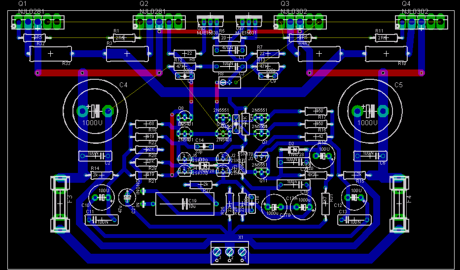

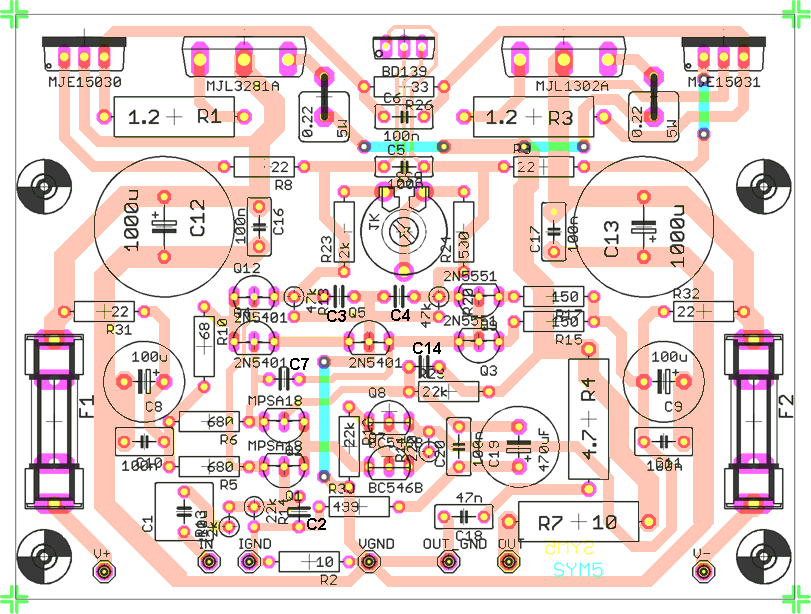

Yeah. The problem I'm currently having is based around the overall size of the pcb and the way it gets laid out in a real chassis. I might split off the output as a separate board, that way it will make it more practical to fit on a standard heatsink. It also means I might be able to fit the PSU on the main board as well, to make it totally self contained.
Bias pot is in already. 😉
Pinkmouse.
Is there anyway you can post the eagle schematics and Brd files Then I can have a go also.
I'll then make some small modifications. and redo the layout just for the compaireson
I have a little trouble seeing your highcurrent traces going through vias.
Michael Børresen
Michael, the red traces on the top are links, so no power will be going through vias.In fact, all the power and output rails will be beefed up once I have a layout sorted, at the moment they are just placeholders for the real thing whilst I get component positioning organised.
The layout is way too big to fit in the freeware version of Eagle at the moment, and I still have to optimise some cap sizes as well as add all the output network, so I wouldn't be happy to post Eagle files yet. The way I work it would be far too easy for someone to go wrong with what I have done.
